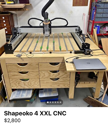

There is an option for a barely used 4x4 Shapeko 4 for sale locally that has a beautiful cabinet with 6 roller drawers tools, accessories, laptop, and bits for $2,800. While not the quality of the 5 or the Laguna, it’s probably perfect for me?
How well does the 4 handle 3D wood carving?

I don’t miss using my V wheel So3 now that I have linear rails and ball screws but it’s still a very capable machine in wood. That table is damn nice though and you could always DIY some linear rails in the future. It depends on how serious you plan to get with doing CnC work. If you plan to just tinker around with it here and there go the budget route. If you plan to invest real time into learning Cad and Cam like Fusion 360 and want to mill aluminum then a rail/screw machine is the way to go.

If this will be your first adventure into CNC, I would stick with a Carbide 3D machine. I cut large amounts of aluminum with my stock Shapeoko 3. I have upgraded it with linear rail and can agree with @Able that I don’t miss v-wheels. However, the Shapeoko 4 has much improved v-wheels over the 3. A Shapeoko 4 can cut anything a Shapeoko 5 or Laguna machine can, just slower. Still plenty fast for a hobby. With a Carbide 3D machine you get the huge advantage of software, support and a forum that are all oriented towards helping people get started and learn. The Laguna is also significantly more money even with the discounts you are talking about. If you can afford to put down that kind of money, I would take a close look at the Shapeoko 5 with a spindle or the HDM. Or you could save yourself a bunch and get that used machine with all the extras or a Shapeoko Pro.
