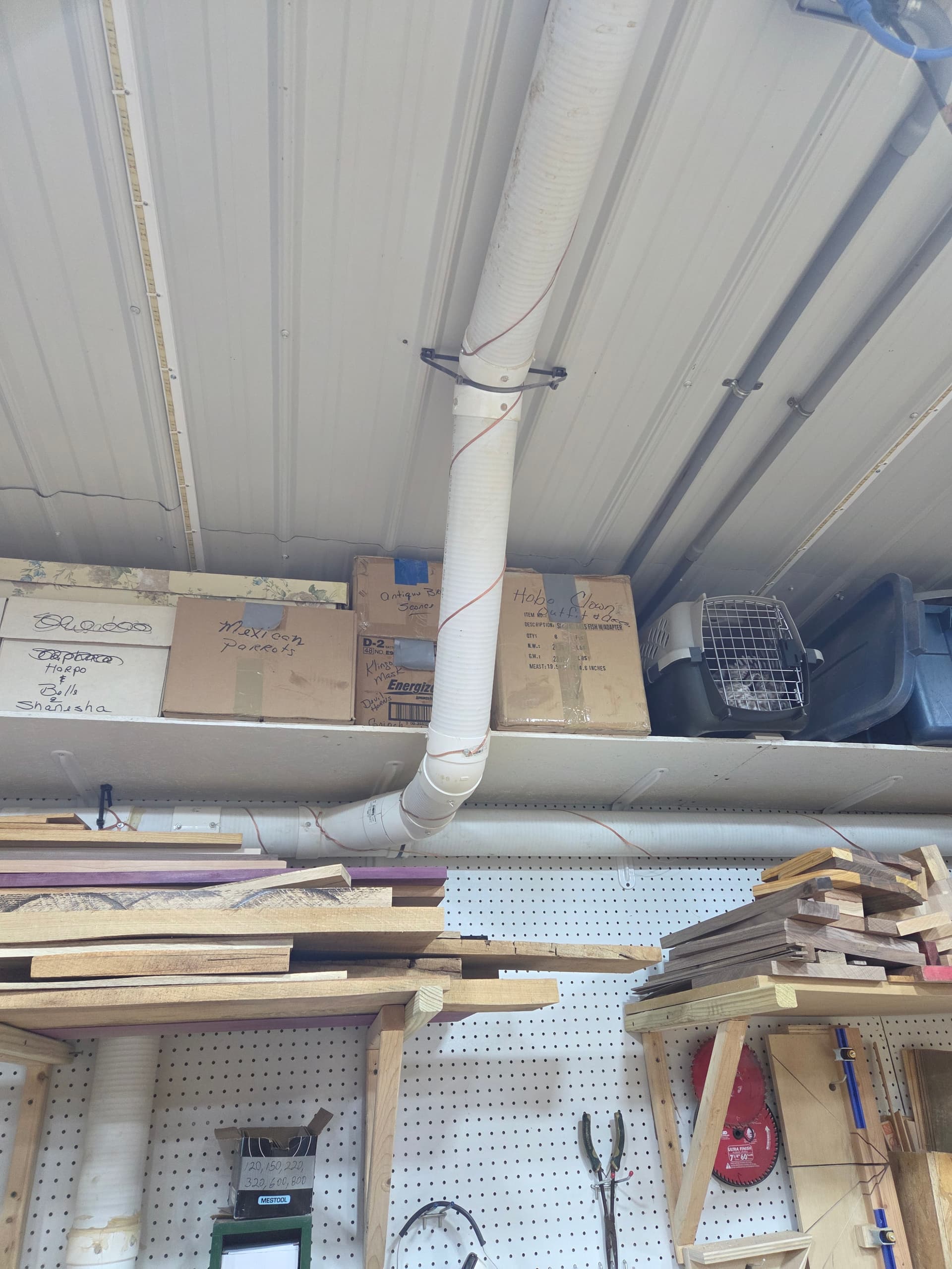

Rick,
You can see the copper wire wrapped around the pipe. Secured with screws at joints with a turn of slack in the wire incase I need to split the joint.
At the machine end of the 4" I have a magnetic couple and can swap out other tools as needed.
The battery alligator clip was what I had on hand,
