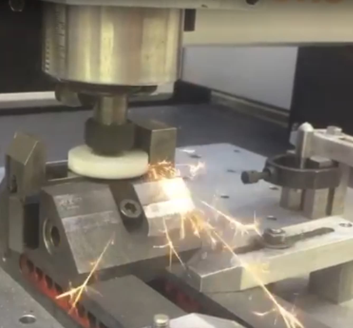

Rubber (Machining)…Before coming an Engineer/Scientist at NASA I was a Tool and Die Maker for General Dynamics…and other than making tools…we (the team), got to make (or try to make) the weird stuff needed for the submarine…I mastered machining rubber and made a LOT of parts…the secret was grinding…before I came along parts were frozen and quickly machined while frozen hard…worked ok but hitting tight sealing tolerance was hit of miss (you only had one shot before the part defrosted (locally), whereas you could grind the part soft all day long. Holding was usually done with contact adhesive (Engineers call glue adhesive…chuckle). Grinding wheels (stones) work GREAT on the Shapeoko…
