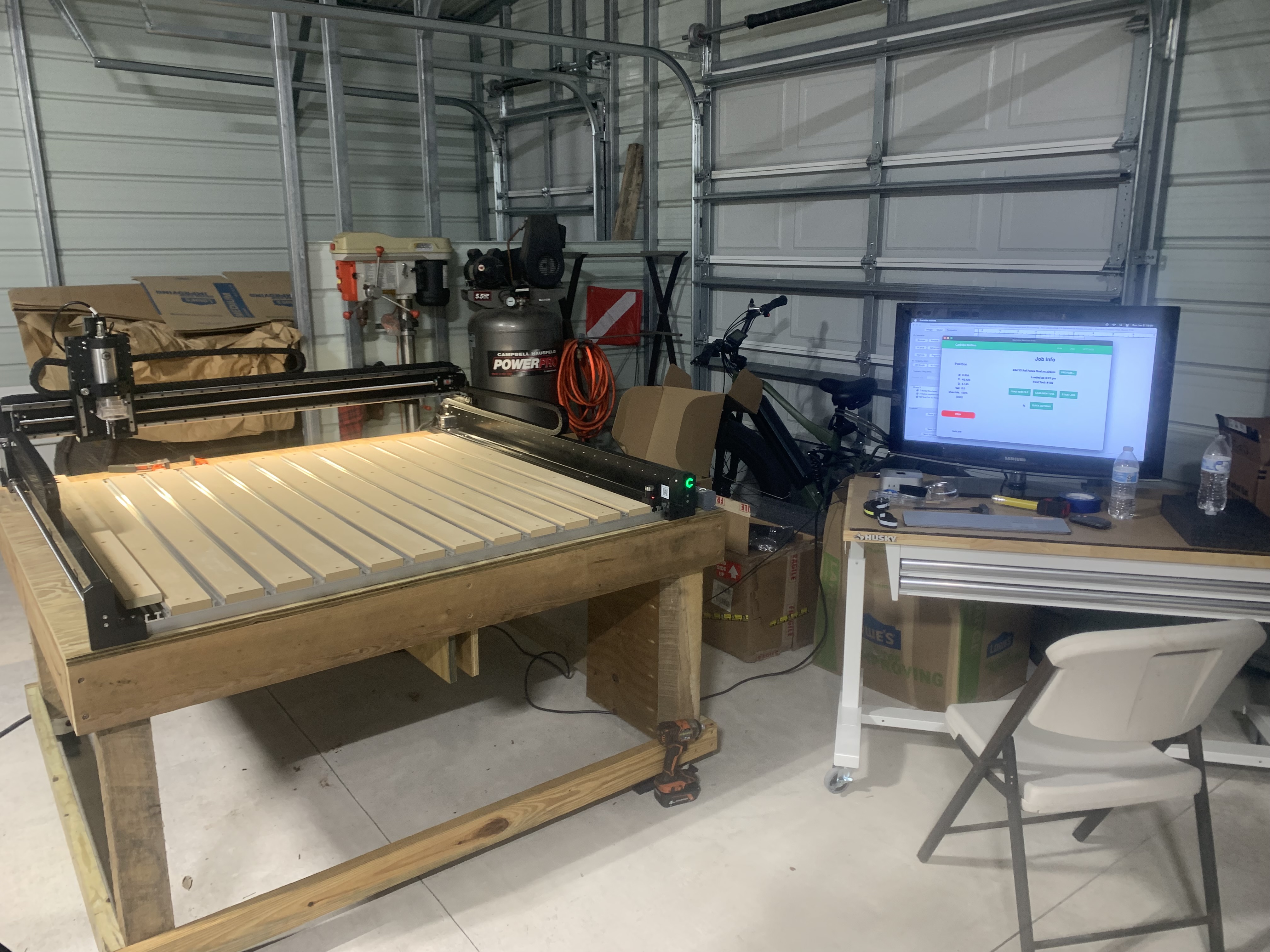

I built mine at 65”wx62”d. I have both controllers mounted beneath, I still need t make the front drawers for bits tools etc. I’ll mount the Mac mini underneath the table to keep the dust off/out of it. When it’s in its final location in the shop I’ll mount the old LCD tv on the wall behind it.

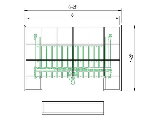

I designed the table to accommodate a post mounted vacuum arm to come over the top and pivot within the 4x4 area from the right side of the picture. I will be tiling 4x8 sheets so I will need to keep the back of the table open to slide the material thru. When I need to I will pull the table out for those operations.
If I ever needed to I can add an enclosure to the face of the 2x6 table top frame and clear the front of the machine and all side and of course account for the harness to the control boxes.
