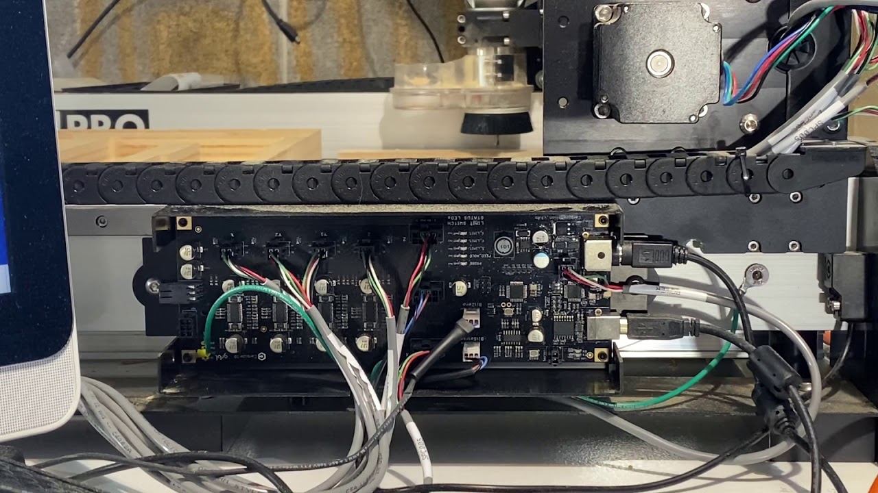

Does anyone have a shapeoko pro that they can send me a picture of the cable connections for the touch probe on the plate end. I have a wiring issue and im not sure if the mis connection is on the cable from the controller board or the connector coming from the touch probe.
Ground is typically black. If that convention is being followed, it looks like the cable connected to the board is wrong - another forum post has the GND pin on the opposite side of the X Y Z sockets.
Not sure if this will help, but I was asking someone for some remote troubleshooting of my Shapeoko Pro XXL and tried to document all the cables and wires by the control board
Not a fancy video, just trying to be practical
Thanks everyone. I was able to reverse the connector behind the plate where the probe plugs into the cable from the controller. Now the bit setter works.
