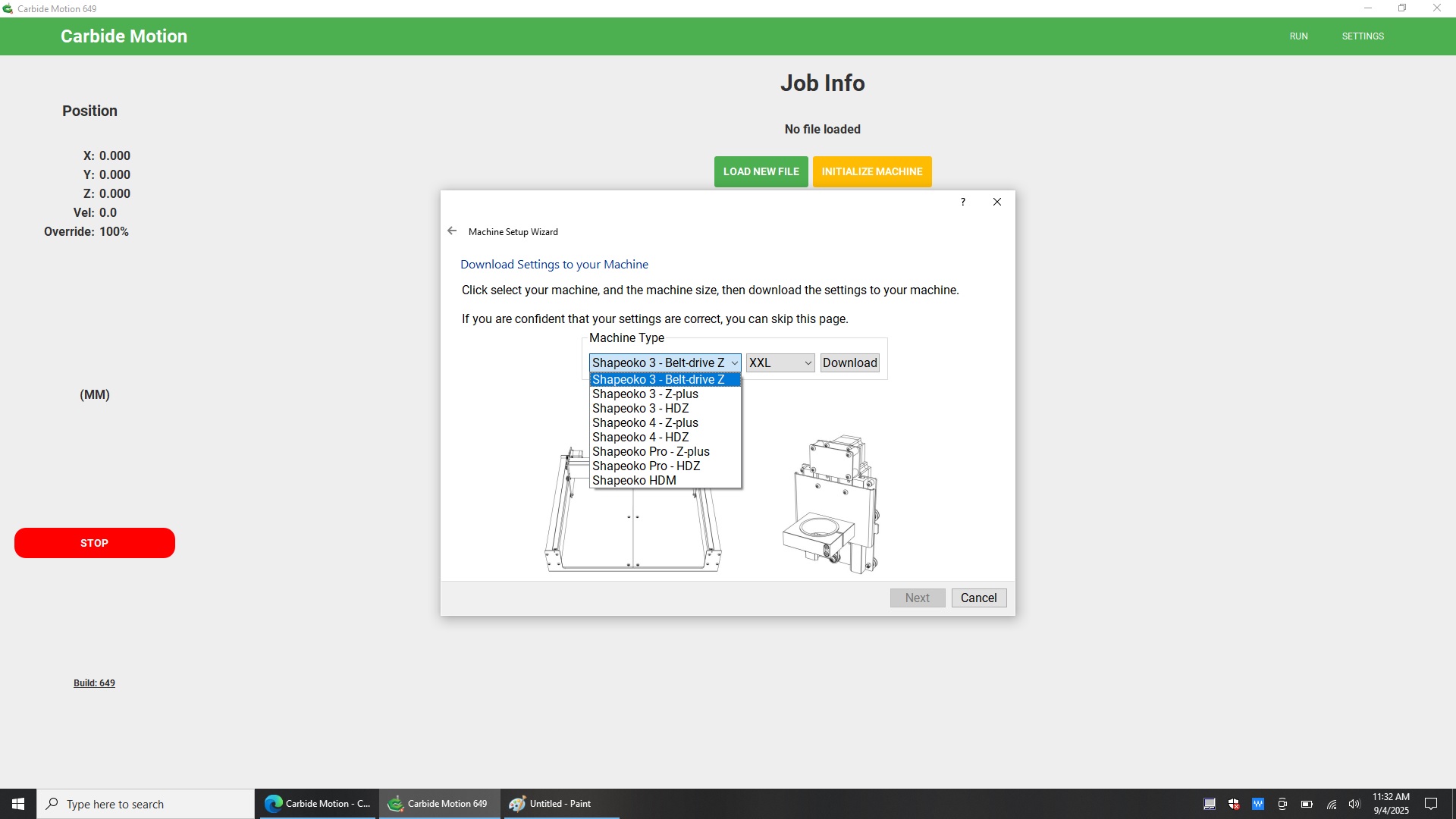

I just installed CM and am trying to configure the machine. The assembly manual is different from how CM behaves (wasn’t able to just connect to machine, had to click “Setup New Machine”, etc) and it let me choose the machine type from one dialog, but then another dialog popped up that wants me to select my machine again (???) and this dialog doesn’t list my machine as an option to choose, a Shapeoko Pro XL.
What should I do?
select “Shapeoko Pro - Z-plus” for Machine Type, then choose the XL size — unless you’ve purchased the optional HDZ Z-axis, in which case, choose that configuration.

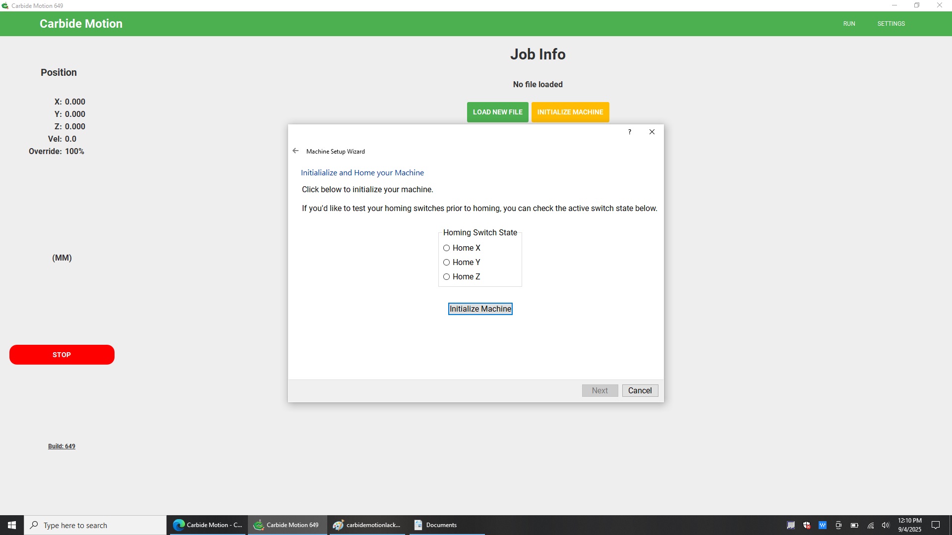

OK, I hit “Initialize Machine” on the homing dialog that appeared and the Z-axis just traveled down until it started making grinding noises and errored out with an alarm, as though the stepper motor is wired backward. I connected the cables accordingly, X to X, Z to Z, etc…
Now what?
Please see:

I just downloaded Candle to see what happens when I jog the machine around. All of the axes are reversed.
There’s nothing on the homing troubleshooting about the machine moving in the opposite direction that it’s supposed to.
I am pretty sure that that only happens if the Settings haven’t been sent — please send the Debug information to the folks at support as requested and they should have you sorted out presently.
That’s the situation though, is that I couldn’t do anything until I clicked the yellow button at the bottom to setup a new machine. I don’t know if that sends settings or not, but I had no other options like it shows in the assembly manual. The “Connect to Machine” button at the top was grayed out, and disabled. I think that the Setup New Machine dialogs ended up sending settings to the machine but there’s no way to know for sure.
Actually, after the machine alarmed out then the Connect to Machine button was active, but I wasn’t seeing much in the way of options, let alone menus, for doing much. The only time I had any kind of option to choose a machine was during the Setup New Machine, so if that didn’t send the proper config then it didn’t do its job I guess.

I figured out what the problem was. I didn’t click the “Download” button next to the machine selection. I just clicked “Next”. I didn’t even notice the download button the first 2-3 times I looked at that dialog. I made the mistake of assuming that clicking next would automatically download settings to the machine.
Doh!
It looks like the travel distances didn’t change though, but it set the correct direction invert mask.
