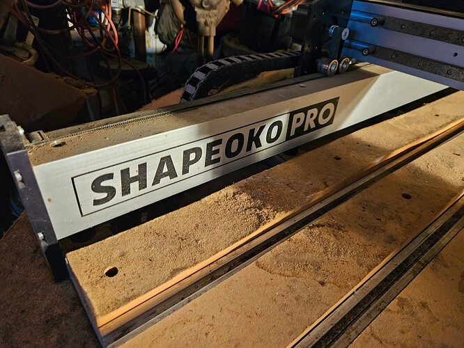

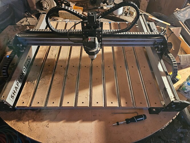

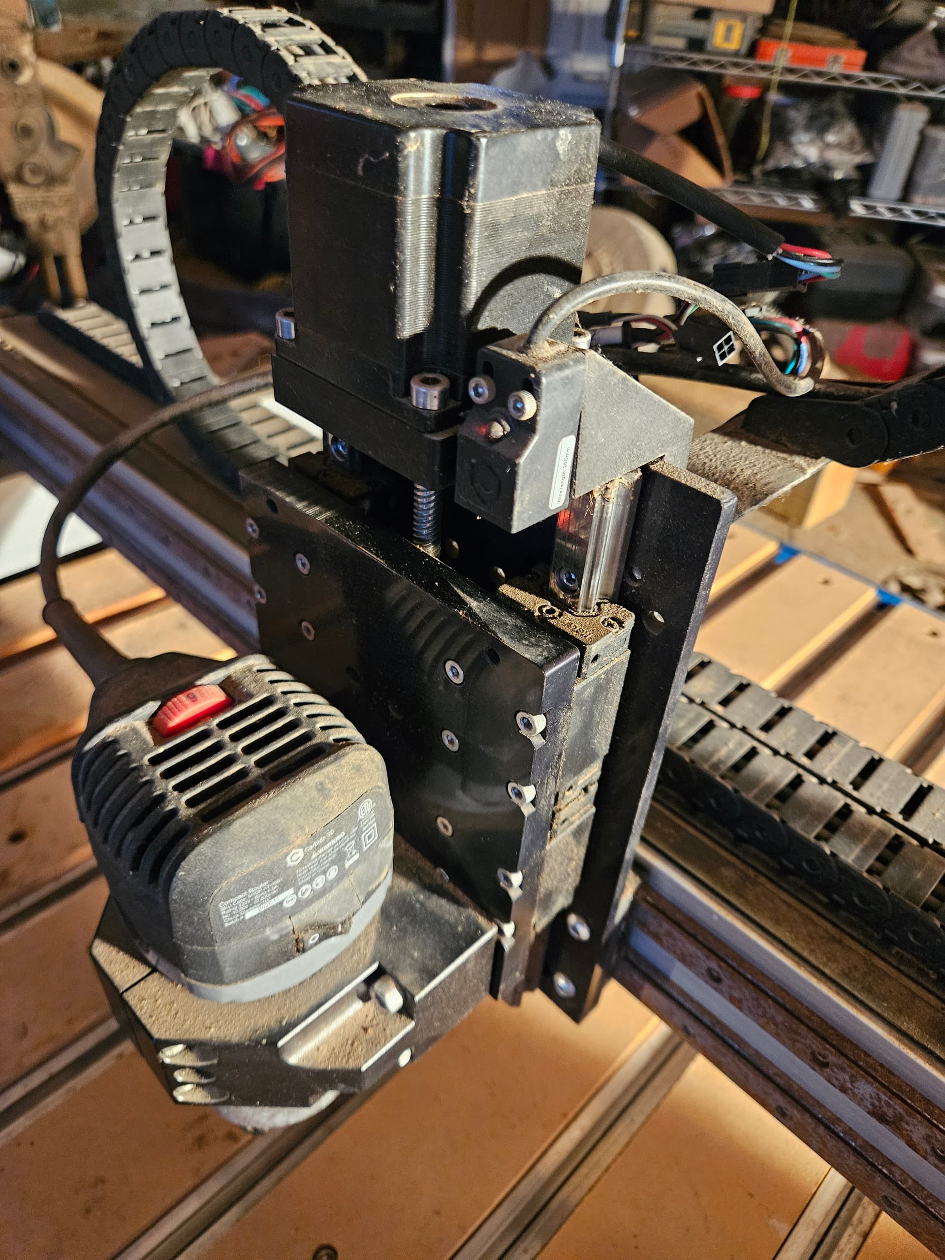

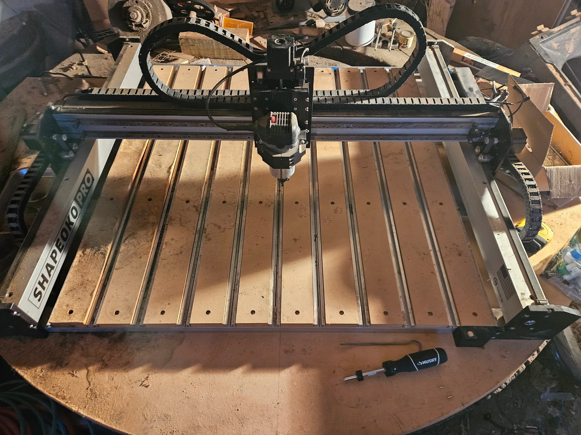

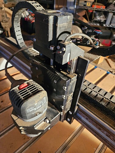

Post a photo of your machine and a detail photo of the Z-axis?
Thanks for quick reply, getting puctures…
That is a Shapeoko Pro.
Please run the Setup Wizard entering the settings for a Pro.
I did run with shapeoko pro with z plus router mount
Power down and slowly/gently move the machine to the center of motion for all axes — for the Z-axis, move it all the way to the bottom, then up to the top, then down low enough that you have access to/can see the Z-axis homing switch.
Power up, connect to the machine, go to Settings | Debug — are any switches stuck on? Test each switch — does each show as the correct axis as an Active Input?
