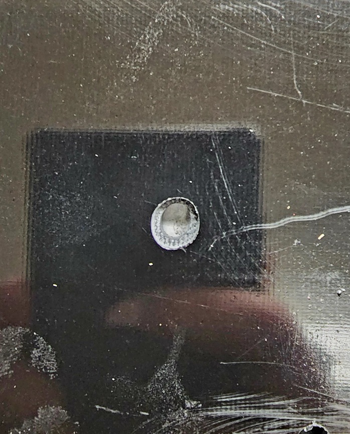

Well, I wish I had some good news… After all of that I loaded up a new piece of test material, and ran a file. The first tool pass is a 1/8" carbide composite bit, doing 30 through holes, and 20 of those have a counterbore inside them… After about 8-10 holes i could see the circles were skewed and oblong drastically.
Before running this pass I adjusted and tightened the belts, which were not loose: but i went through the process nonetheless.
I have double checked every screw structurally and everything is secure, outside of the play in the YL motor, which I think is the suspect. Waiting for support to contact me. Definitely a learning experience relying on one piece of machinery for my business, never saw that coming. Hopefully it gets resolved soon.

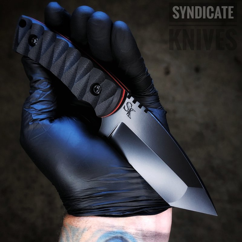

Just for reference - these scales (handles) were done on the machine, so it did work fine at one point.
4 Tool paths -
  1. Holes/counter bores
  2. Fluting(grooves on the face)
  3. Profile with tabs
  4. Chamfer
    Pretty straight forward. Here is the completed product.
