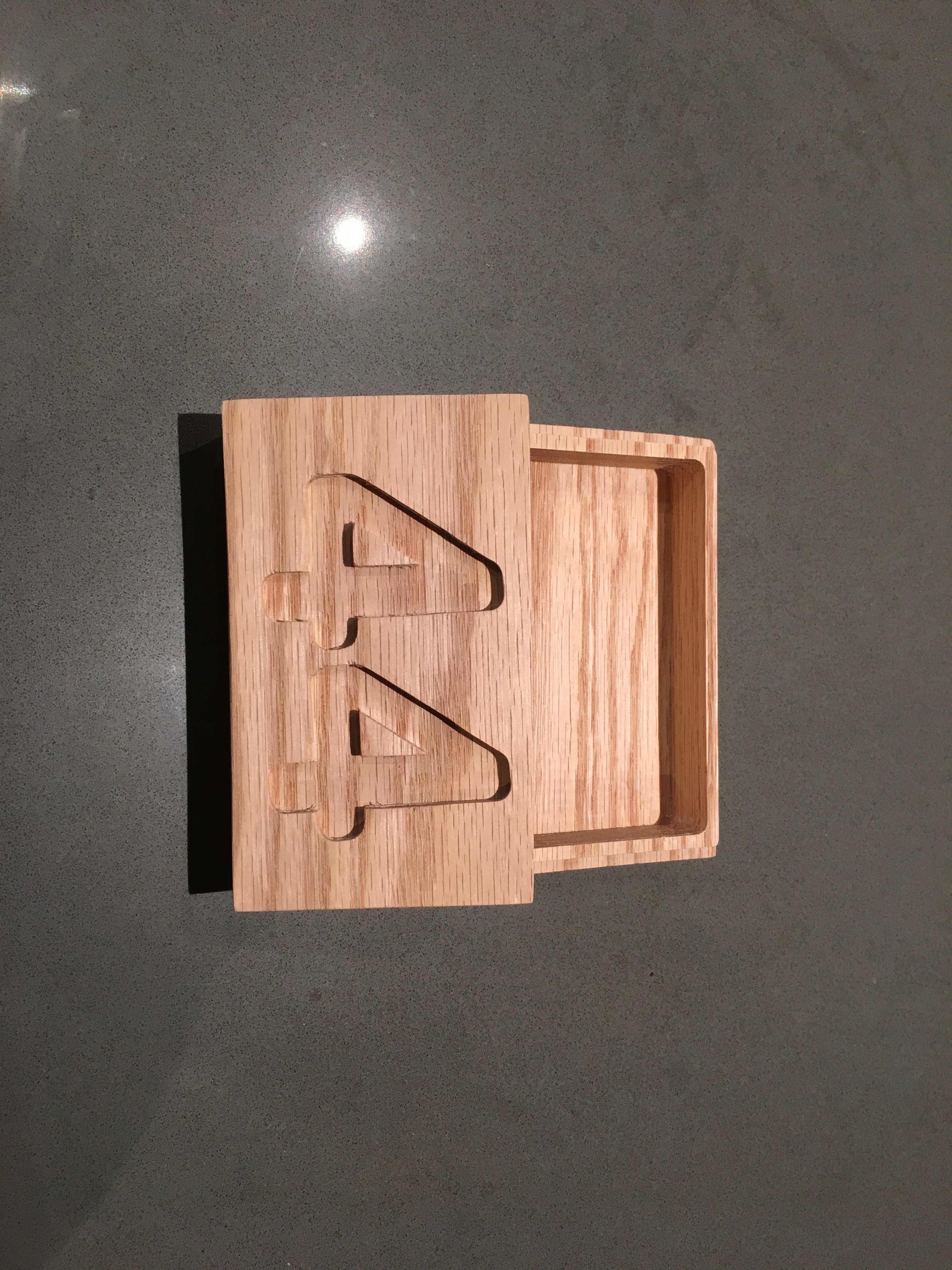

I’m up and running now, after some missing parts. I, too smashed my Sharpie but decided that I was never going to reach Z nirvana with a Sharpie, so moved on to a small box. I was too nervous at first to cut up my precious wasteboard so I just used some double stick tape. It worked OK, but slipped a bit at the last minute resulting in a thinner lip than designed on one side of the box. Luckily I had my shopvac right there and used the nozzle as the hold down for the last few cuts.

Thanks! I actually drilled the wasteboard and used inserts following a plan here on the website. It came out pretty well and now I’m not worried about my stuff flying around!
