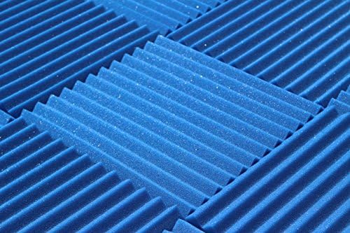

Nice enclosure. Building an 80/20. Where did you find the blue sound deadener foam at. Does it clean up well in regards to chips and dust that the vac system does not get.

This is the foam I used:
I have found it surprisingly easy to keep clean. When it gets particularly dusty I just wheel it out into the drive way and give it a blast with a blower :slight_smile:
Ben, did you find the foam to be particularly effective? There’s another thread on here (somewhere) that spells out many ways to reduce the “noise”, and that application wasn’t supposed to do much. Curious.
I don’t have any proof that it does help, but I figured it was worth a shot… A lot of the cabinets I found on Instagram\Pinterest had something similar…
I used a very thin High mass white rollable vinyl material for the lining of my cabinet. It takes no space ( 1/16" thk ) applied easily , cleans well & reflects light and most importantly seems to work really well. I never tried the machine without it , but when I open the door it’s much louder. My vacuum is louder than anything coming out of the enclosure. Here is the link; https://www.fabricmate.com/shop?search=sound+sentinel
