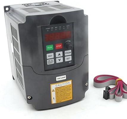

VFD:

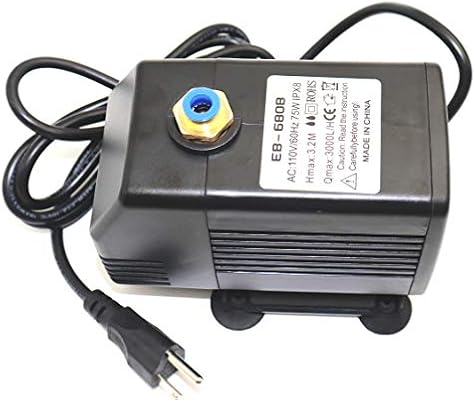

800gph aquarium pump
I had to get a separate 1/4" reducing barb for the pump from Lowe’s. Can’t find it on the site, but it looks like this:

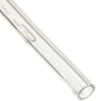

Tubing:

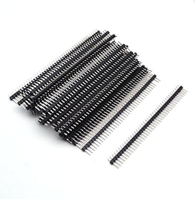

Pin header connector:

did my upgrade to a the same type a while ago. I would suggest not to use a Aquarium pump rather go to a PC water cooling pump res combo ( there are good ones from EK waterblocks or thermal take) with g1/4 ports. There a lot of barb adaptors for g1/4 or even push in fittings. I even put in a radiator in my loop. I was feeling much more comfortable with such a closed loop as with the one with just the pump and a water reservoir. But at the end such a setup may be more expensive.

Aquarium / pond pumps are a very poor match for the flow / head profile of a spindle. There are lots of “solar circulation” pumps and similar on eBay and Amazon with flows and heads much more suitable.

Is there any information on the VFD or in its manual about how much power/current/kVA the VFD can provide to the spindle and how much input power/current/kVA it requires to do it?
What did you enter for the VFD’s PD142?

Oh interesting, I’ll have to take a look at that! I was told an aquarium/pond pump would be fine, as long as it was 800gph at minimum. But I’ll definitely take a closer look at PC pumps.
Can’t remember offhand, I’ll take a look next time I go out to the shop (kinda snowed-in today!)
If yours is flowing water through the spindle then it’s probably fine.
Dependent upon how long the small pipes are you could be down at 2-3 litres / min, which is fine for these spindles, so don’t expect niagara falls.
The issue is the pond / aquarium / fountain pumps are designed to operate at < 3 metres head and a much higher flow rate, hundreds of litres / min. This means on the head / flow of the spindle they’re basically stalled which means the wear on the impeller shaft is much greater due to vibration and they’ll wear out faster than normal.
The warning is that the pump will start to make quite a loud rattling sound when running, that’s worn out “shaft bearings” (nasty bit of plastic on nasty bit of not very hard steel mostly) and it needs a new impeller. That tends to go on for quite a while and give you plenty of time to source a replacement.
You should however, figure out a sensible way to check for flow each time you power the system up as these pumps don’t always start reliably, this goes for any water cooled spindle setup though. I can hear the return water hitting the “reservoir tank”.
