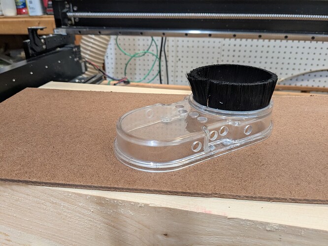

I tried the Short Sweepy and it collapses the hose due to lack of air flow.
The difference between the units is 1 sq in at the transition between inlet and outlet.
You can hear the vacuum working harder with the Short unit, as well as being louder a the spindle.

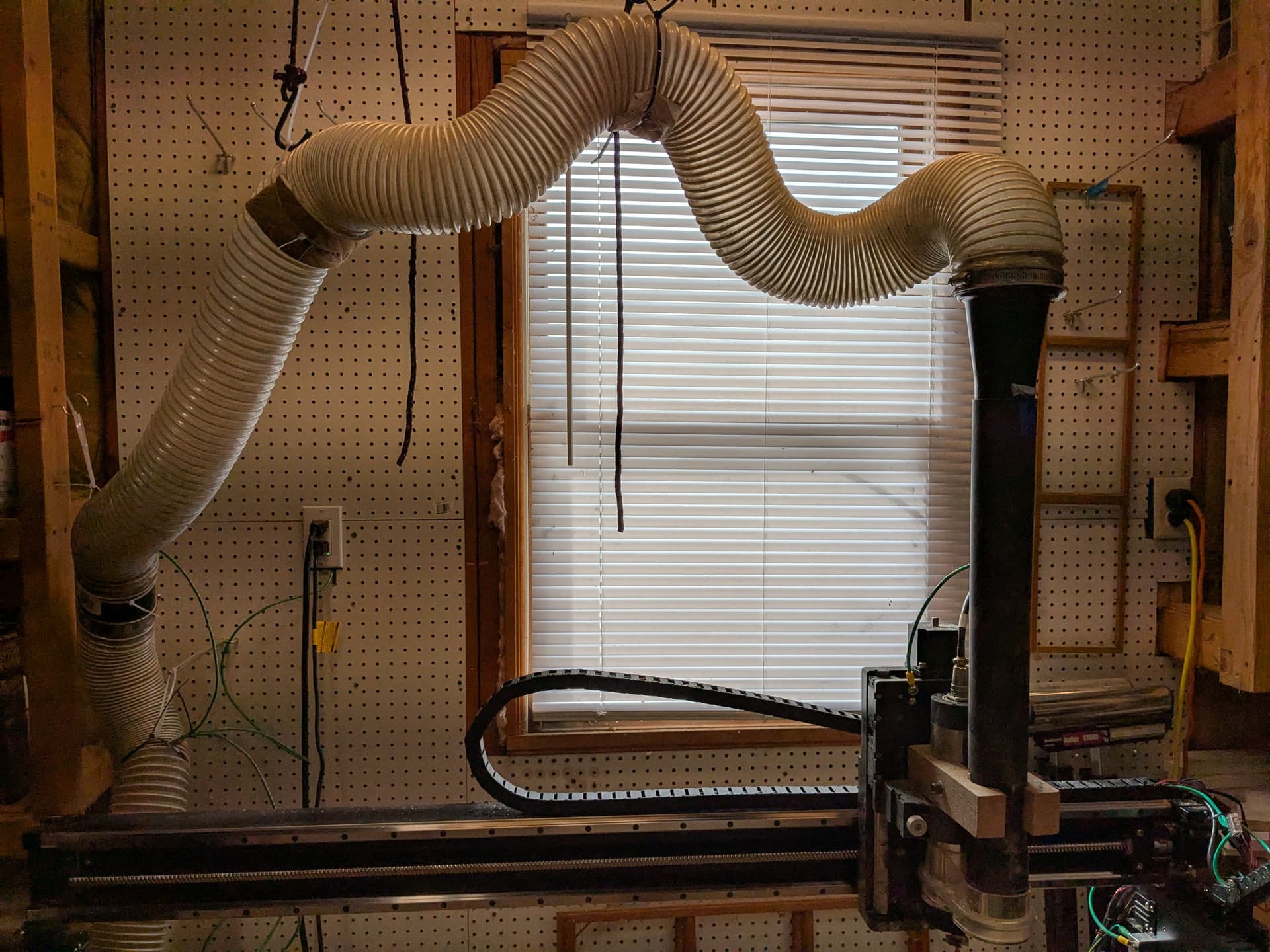

So I drilled 12 ( eye balled with one eye ) .330 diameter holes ( that was the drill currently in the drill press ) which gives me another 1.02 sq inches of are for the air.
Here is what the Short unit does to the hose if I mask off the new holes.

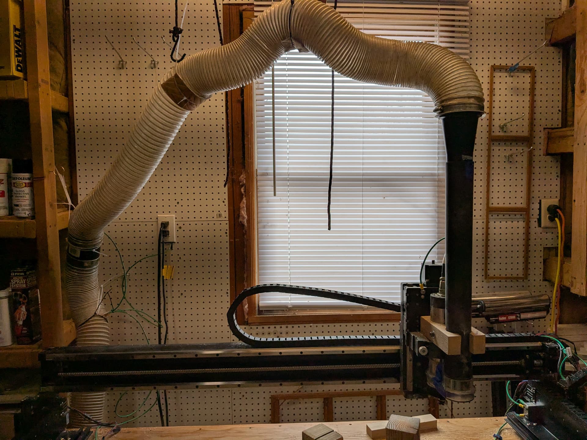

Here is what 10 holes did for the Short unit. I have added two since.

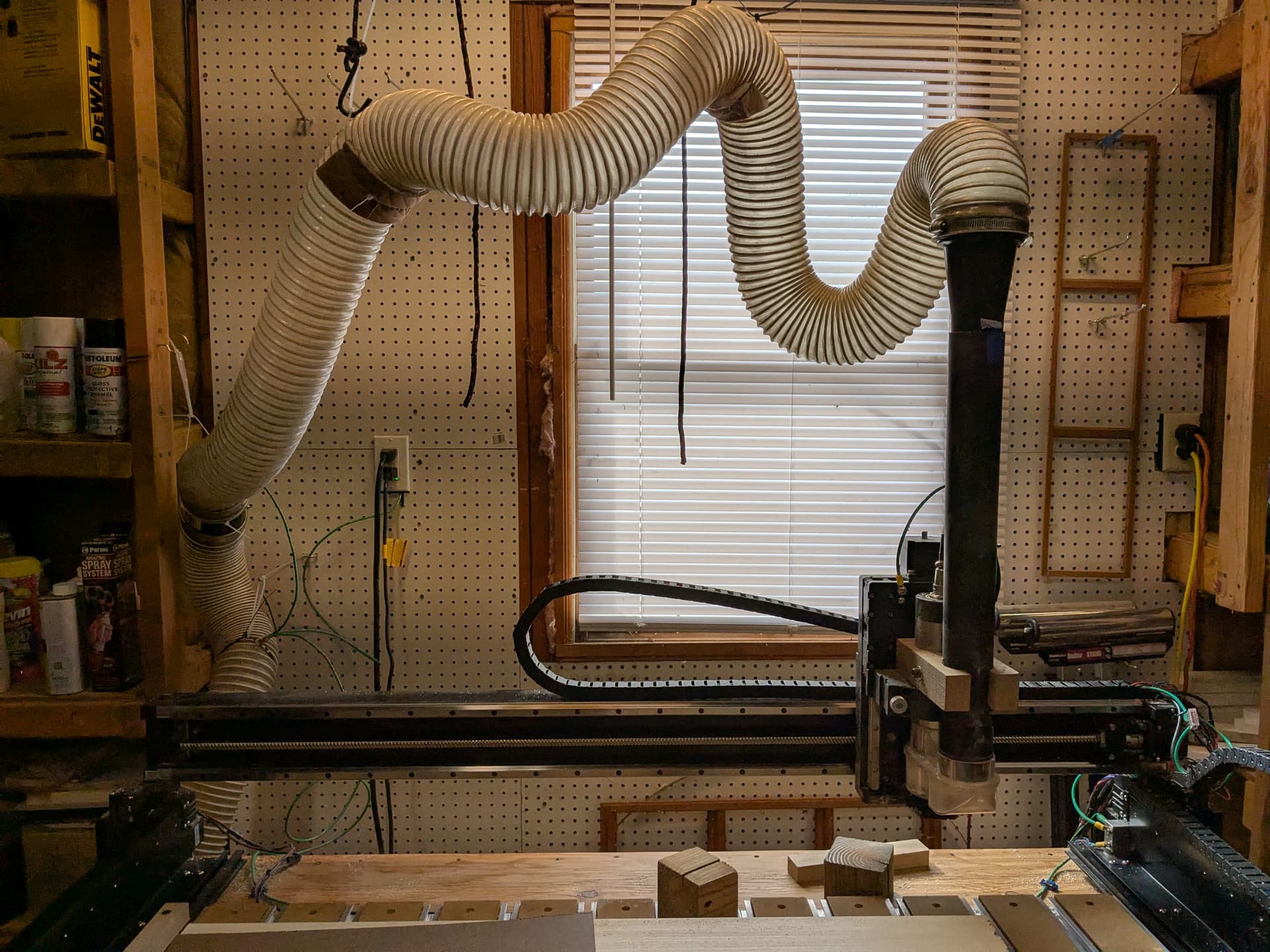

Here is the Deep unit.

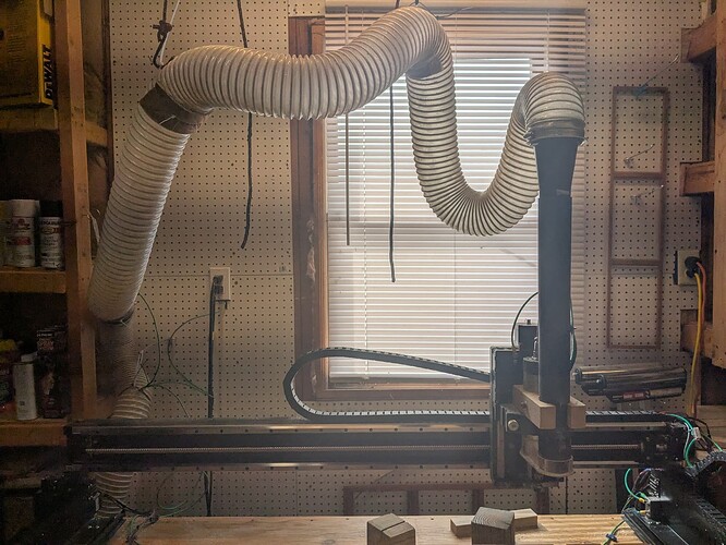

Here is no Sweepy.
The ultimate trade off with higher static pressure vs total SCFM to actually carry the dust/chips away from the material. I have had to adjust port openings on several different pieces of equipment to maximize press vs flow as well.
