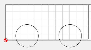

Below are the two files used to create the pieces in the video. In the files there are two circles, one with a slightly deeper pocket as an experiment. Both plugs are the same size.
Deeper Inlay Pockets.c2d (56 KB)
Deeper Inlay Plugs.c2d (48 KB)
Is this amount of play when dry fitted normal? I don’t think it should be and it makes for very inconsistant inlays.

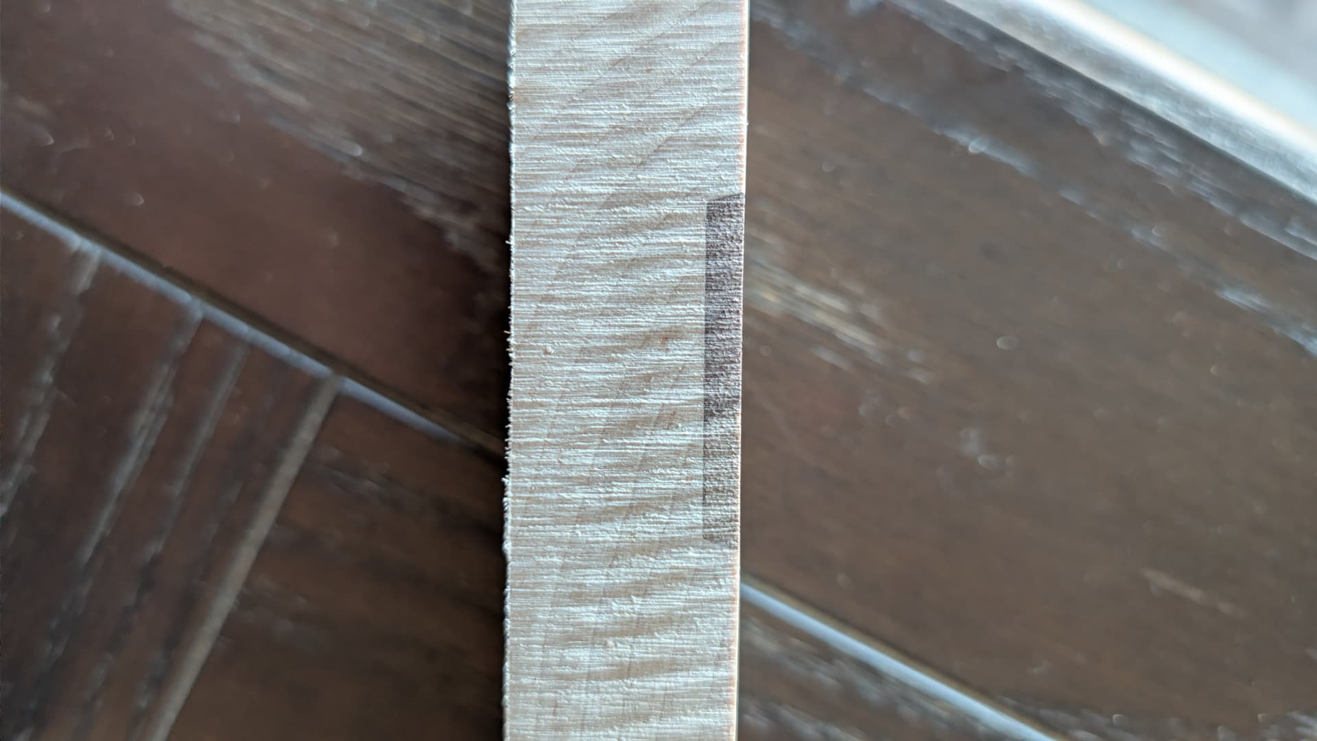

It was kind of hard to measure since the round plug was wobbling around on top of the pocket, so that 2.5mm might have been off. I’m going to cut a pocket and inlay using that offset. I’ll glue it up and then cut it in half to see what it truly is. I’ll report back tomorrow afternoon.
I’ve done a couple tests like this, where the pocket & plug are visible and intersect the edge of the stock so I can see & measure

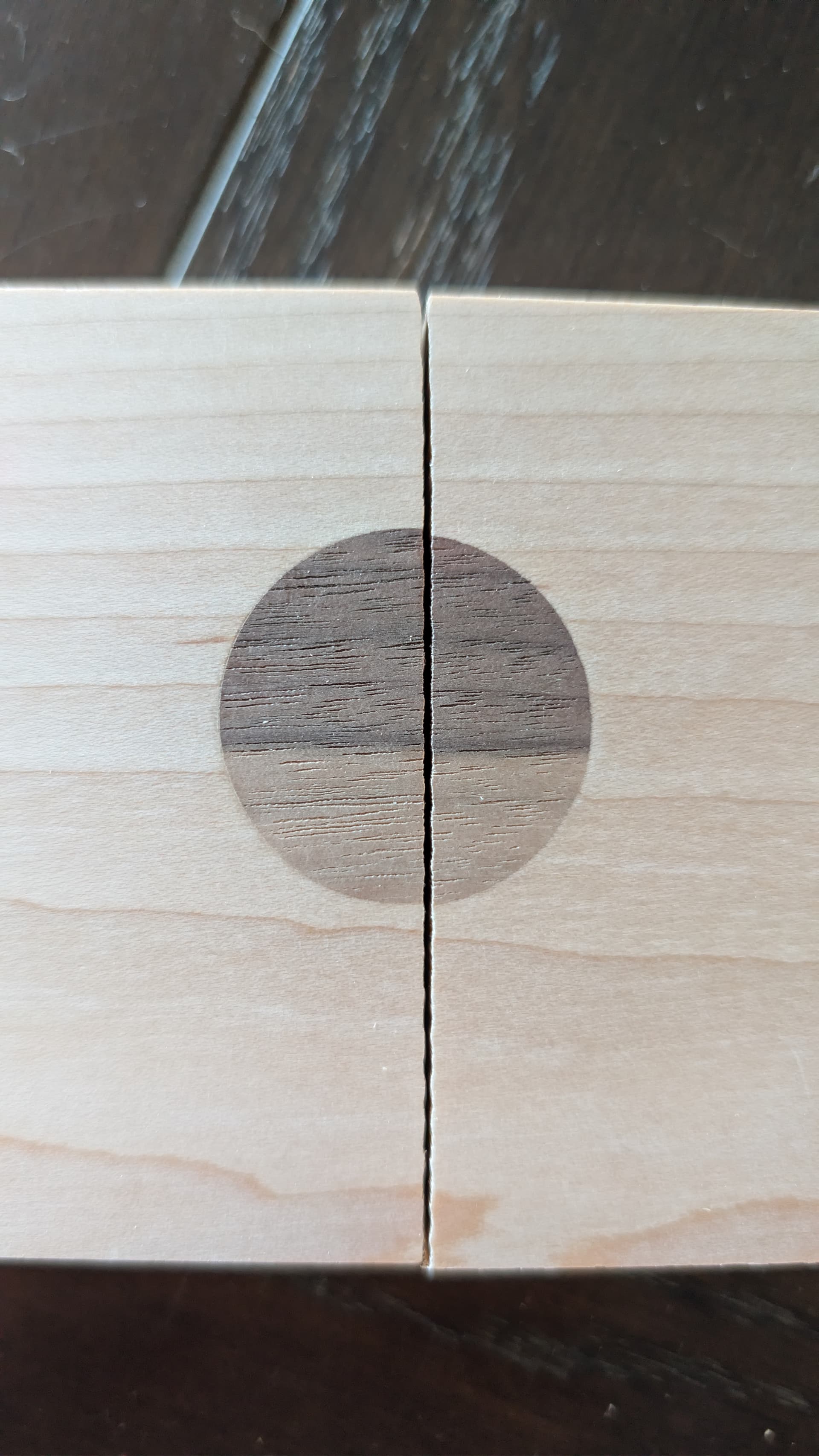

Here is what I got with these settings:
Inlay plug depth 1mm
Inlay plug Top Gap 3.5mm
Pocket starting depth 0mm
Pocket Max Depth 3.5mm
I did not take a pic of it before I cut the plug body off, but I think I need to increase my top gap amount. I use a press to clamp the plugs into the pocket and there was almost no gap left between the pocket and plug faces.
