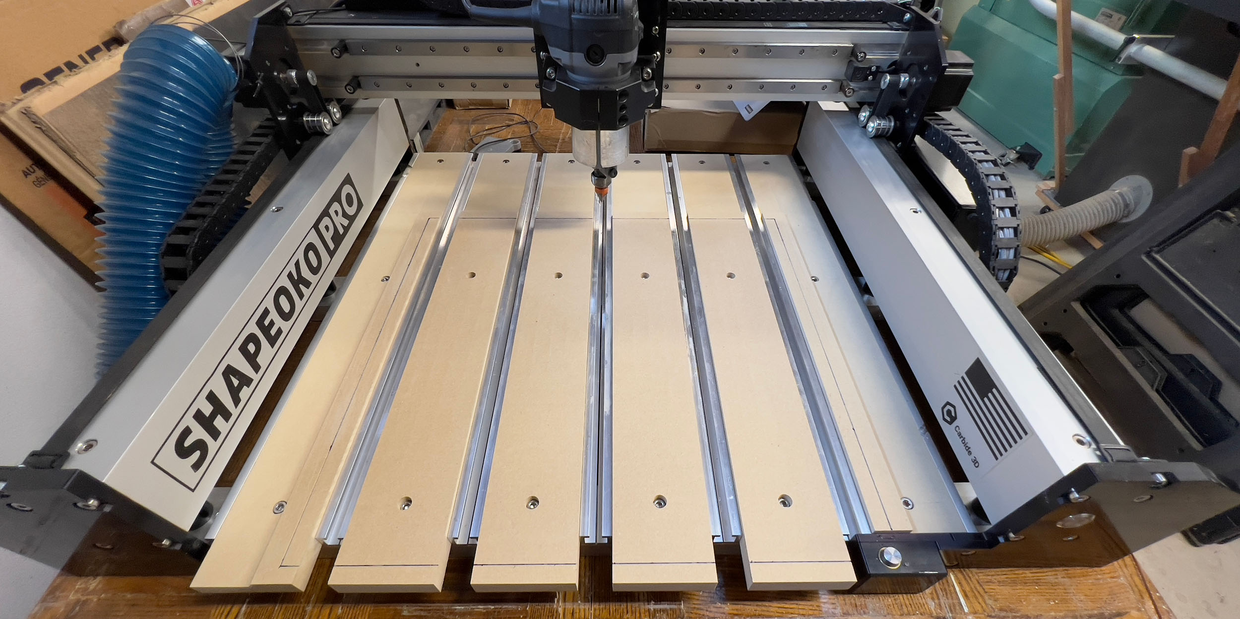

FWIW, I also just went through this. My Standard was setup with -445 and -444 by default, which was too tight for X and not tight enough for Y front.
I ended up at -451.55 in X and -436.75 in Y.
And decided to install my 3rd spoilboard, with pre-flattening removal of thickness from areas not reachable, flattened with a 1.25" fly bit, and then engrave a shallow center line of the max travel in all directions (avoiding the BitSetter, of course). Note that this time I decided to extend the boards forward since that’s where some of my Standard’s precious space is. Should I do some vertical board milling, I’ll just remove the MDF panels and install some others.
