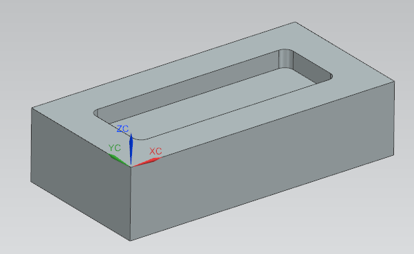

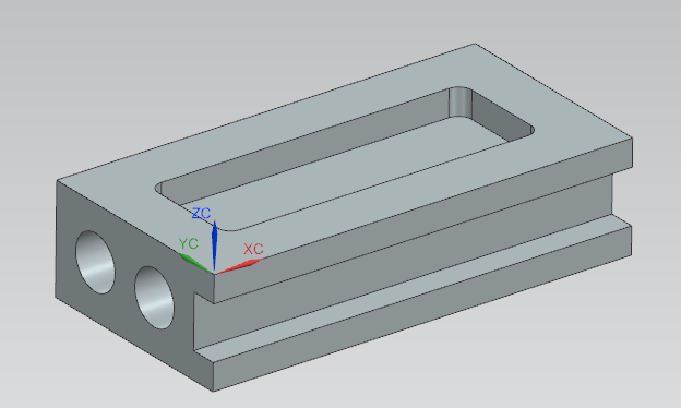

You can (kind of) do this now. It’s a 2D drawing system, so there is no 3D model for 2D machining, so you would have to draw the additional views in separately anyways.
For example, if I want to draw this part

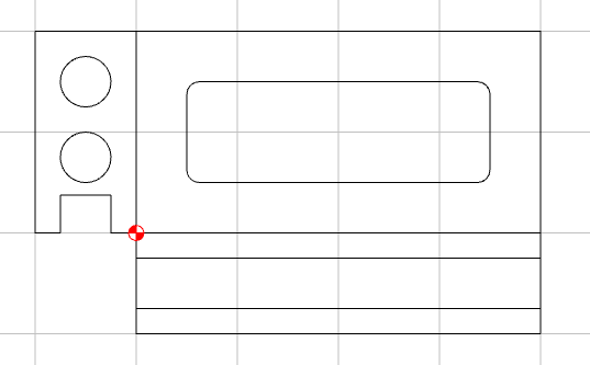

You can flip the front & left view outward and use the same “J” corner to index the cuts with each rotation/setup on the machine.
Not sure what you might gain from separate views, other than maybe independent zero points?

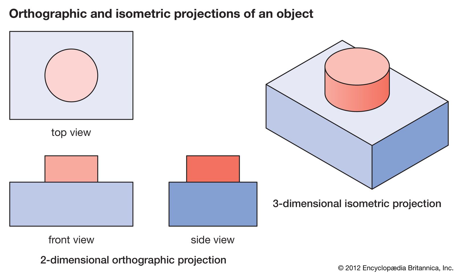

My request doesn’t ask for a solid model representation, I’m looking for the side and front projected views just like in the image in my post. It shows 2D orthographic projections of side and front views. Those are straight lines using the X and Y coordinates from the edge boundaries of the top view and the Z height taken from the job setup for the stock material thickness. In the 2D version of CC, this is a fixed value. Together this information can draw an orthogonal projection. I’m not interested in a solid model. If I wanted that, I would spend the money on 3D CAD software.

Where is it getting the Z values from? In the top view in your original post you have 2 ‘features’, a base block, and a round boss. Setup defines the total height, but what defines the base & boss height?
The 3D model (in the Pro version) or the 3D preview of the toolpath — which creates the problem of how to handle ambiguous designs such as your example — @jadlp3742 could certainly be made to work, but represent a very small subset of the sort of parts which folks make.
