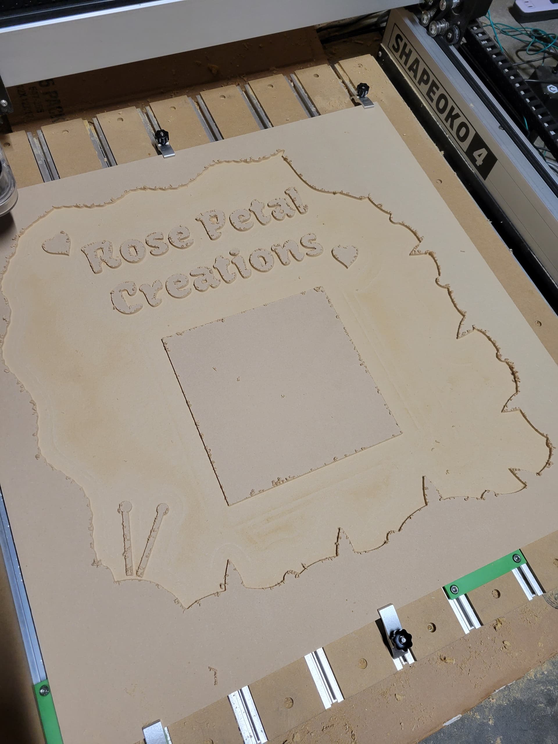

Does anyone know why my signs keep end up looking like this? I’ve tried different bit sizes, different bit tightnesses, speeds. I always get these weird steps around the borders and letters of any sign I make

  4. I’m thinking this is the likely culprit. The cuts seem to be uneven across the entire piece but they are localized in areas where the toolpath starts another rapid. I am doing some DOP test cuts to see if that’s the issue. I’m thinking this is it because I never seem to get this weird unevenness when I do one pass for my preferred depth. It only happens when the depth is too deep I have to do multiple passes to get down to where I need. I might’ve gotten too ambitious and its causing lost steps

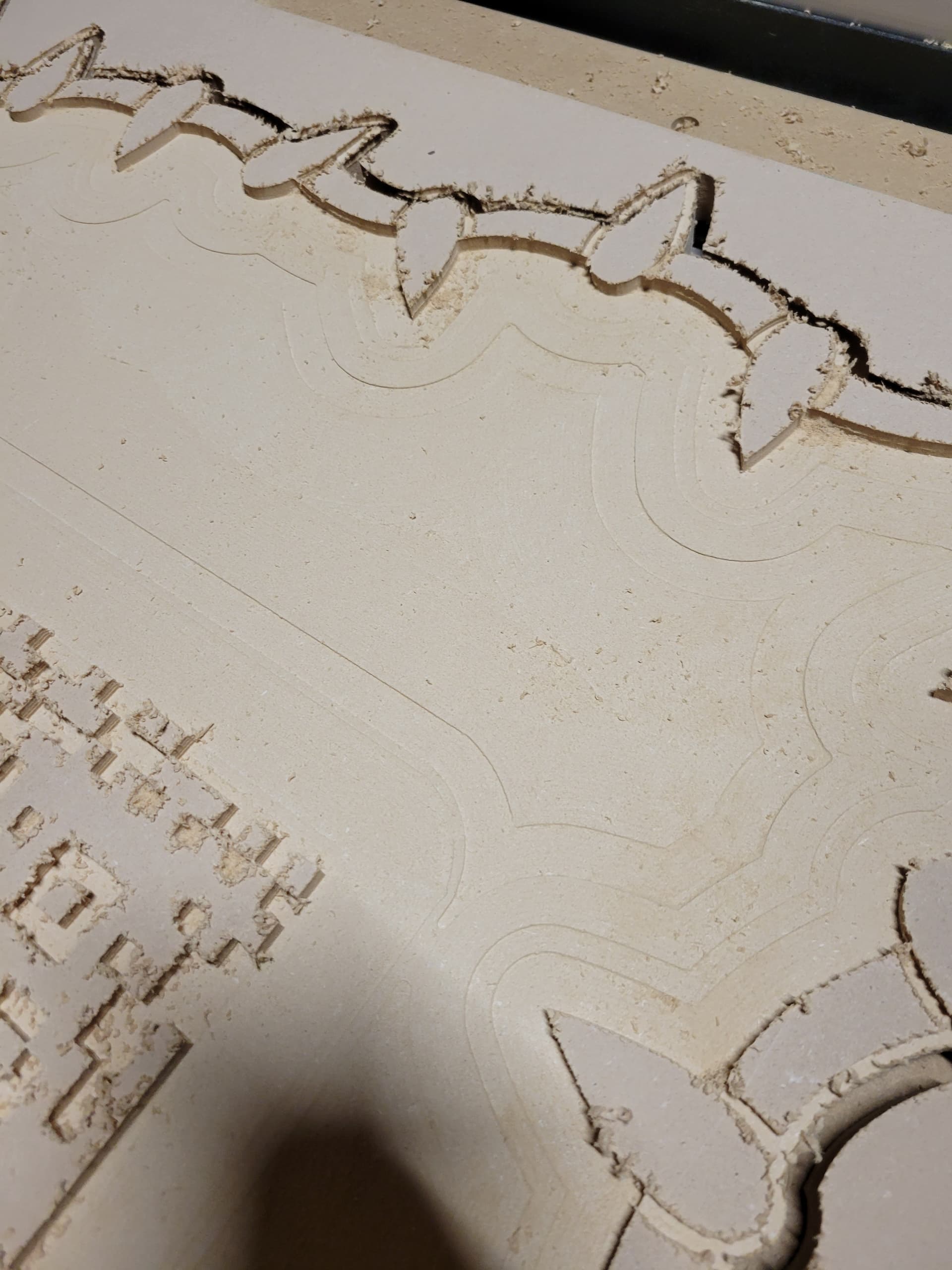

I did some depth of cut tests to see how surface finish looked. Smaller depth of cuts led to cleaner surface finishes and no missed steps and larger depth of cuts left a rougher surface. I started to see the steps happening, albeit on a much smaller scale, with the larger depth of cuts. I am attempting my sign again with my new smaller depth of cut.

Can longer carbide create steps result in loss of steps or glitches in gcode generation? I carved again at a smaller depth and ended up with the same exact stepping occurring in the same places. That particular carving step is 10 hours long, and about 4 before the change.
