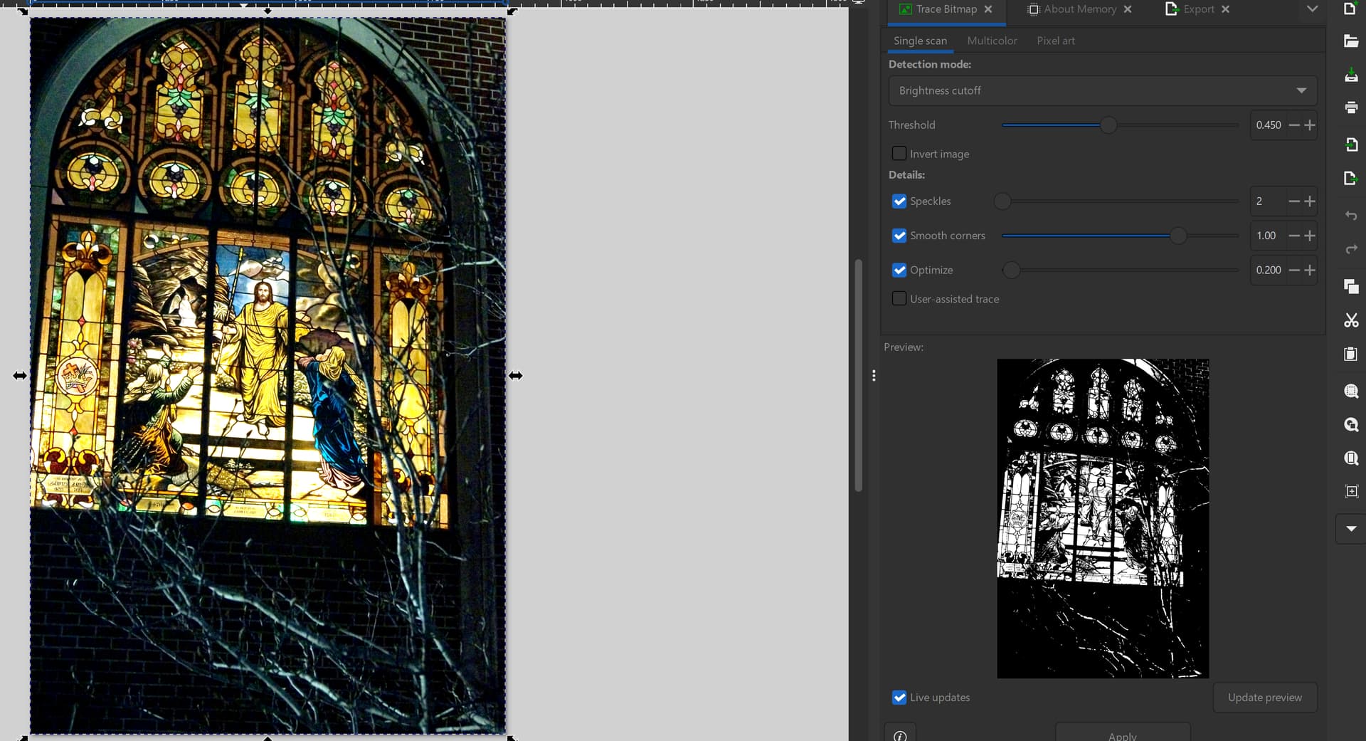

The answer depends. As @WillAdams asked what format did you receive the logo. If already an SVG not much to do just import it. If you get a bitmap (jpg, gif, tiff) then there are online converters. I personally use the free Inkscape.
In Inkscape you open the bit map image. Be sure to highlight the image. Then go to Path menu and select Trace Bitmap Image.
On the right side of scren you get a preview and you have a bunch of controls to change how your image looks. When you are done apply and then to to File Menu and Save As Select Plain SVG. This saves an svg at 96 DPI which is the native DPI for CC.
Now sometimes when importing into CC you get a message that the file is not importable and asks you to trace. Just say no and see what you get. If it does not work then you can just import again and trace the image but I am not a big fan of image tracing in CC. It works but is a lot of work.

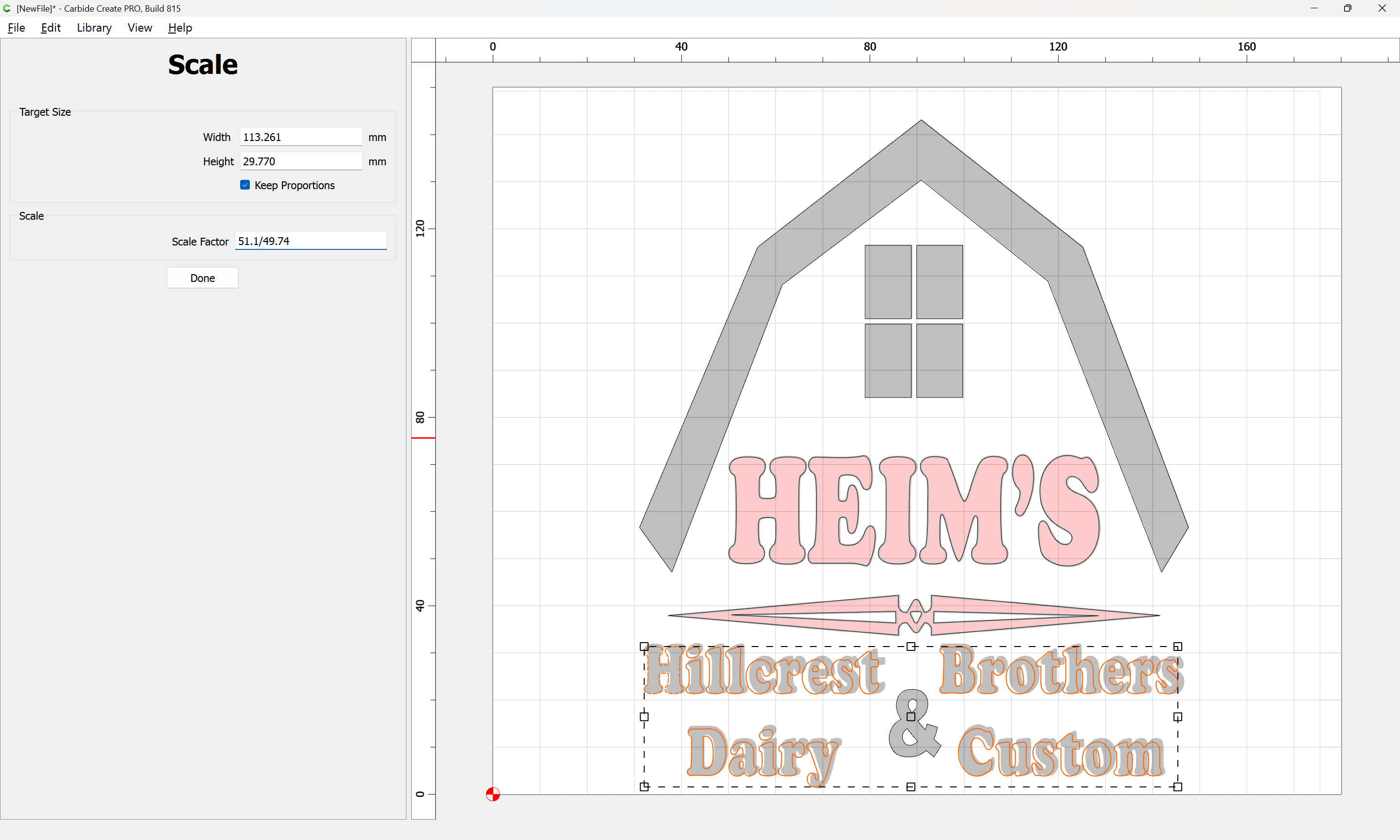

I was thinking of it being 28"x28". With using black and red epoxy to make a nice inlay.

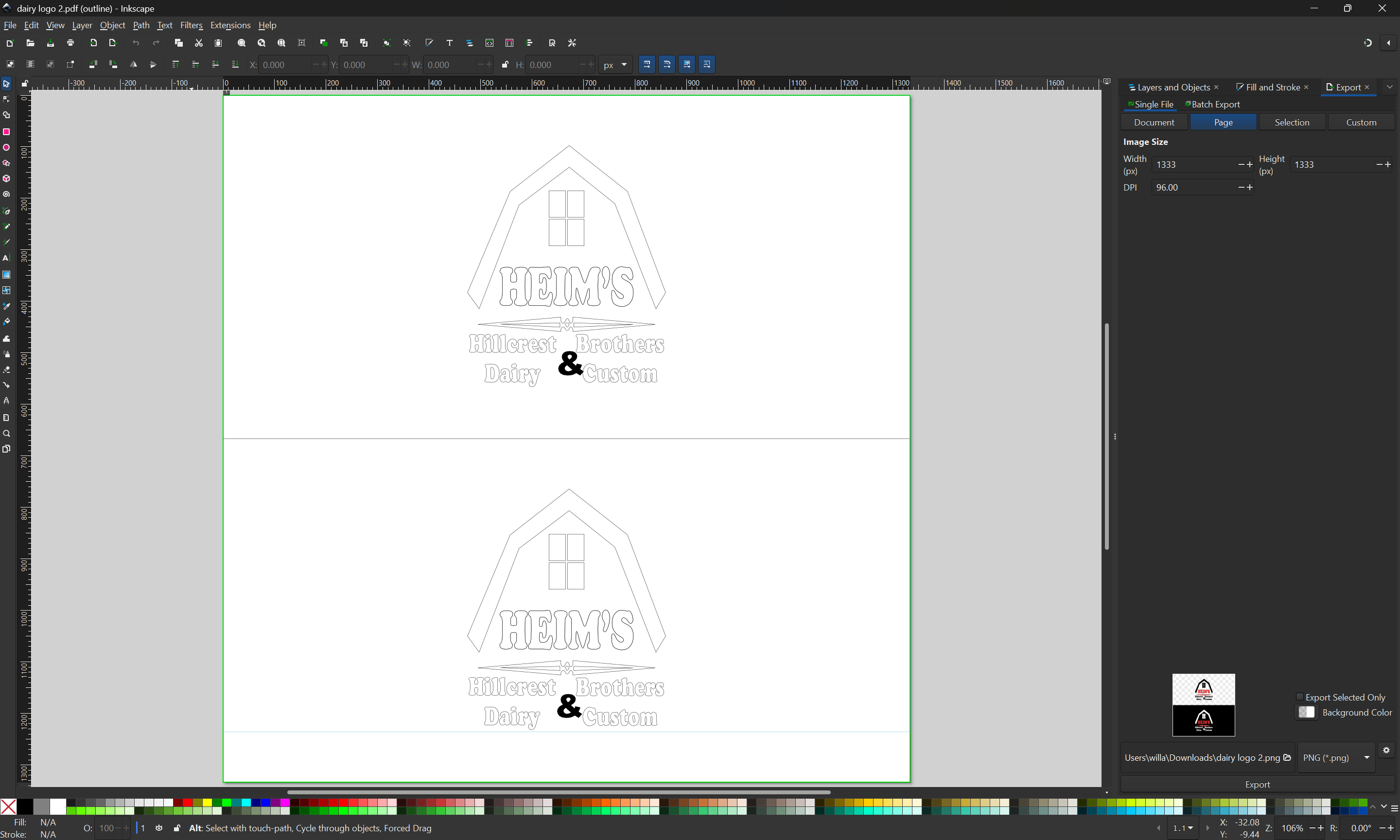

The PDF opens as a vector in Inkscape:
save for the ampersand, which is a text character, so will need to have the font and be converted to curves (or re-drawn).

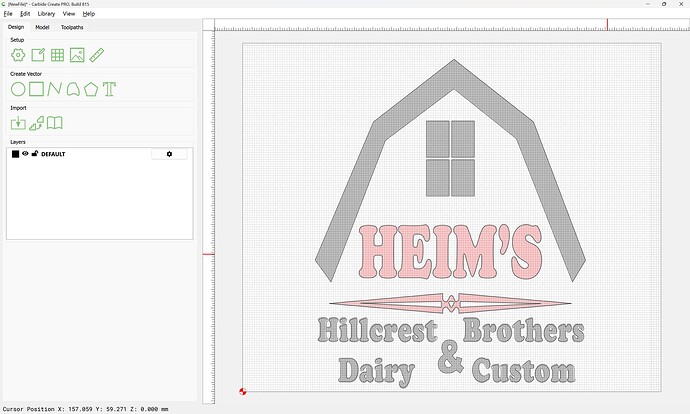

Grab a PNG of the image from a PDF viewer:

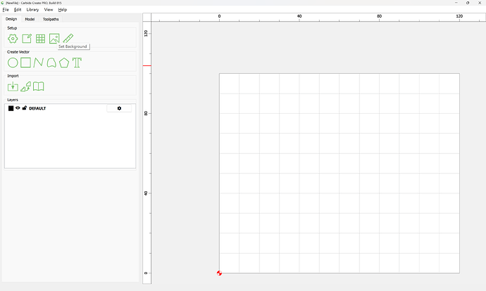

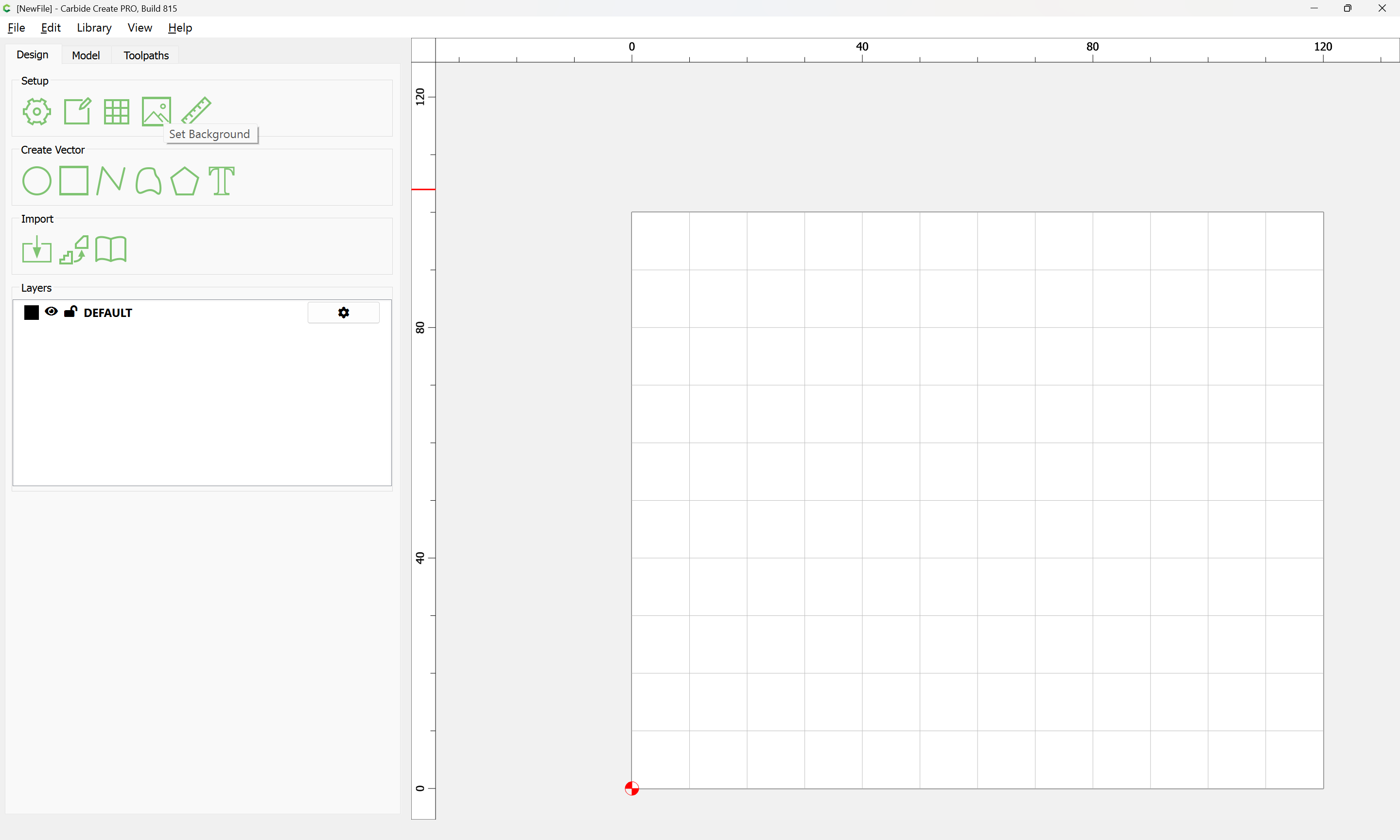

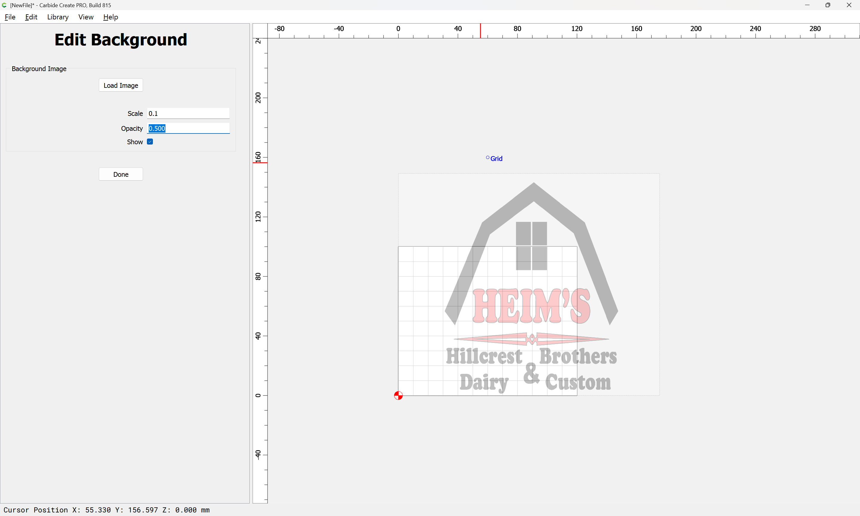

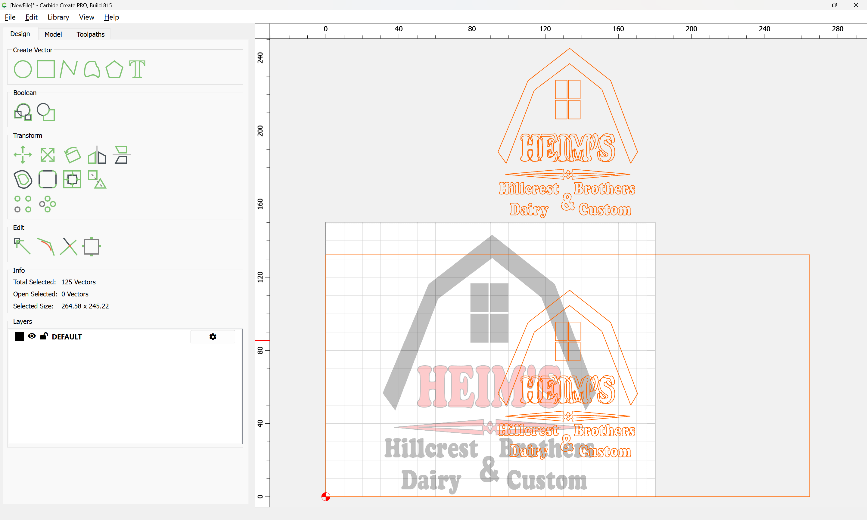

Place that on a background layer:

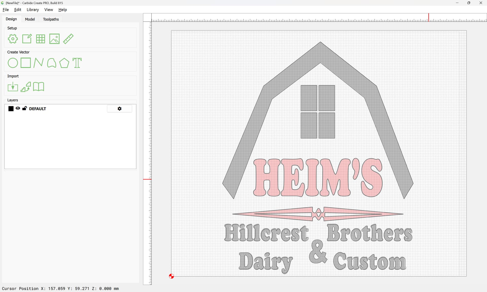

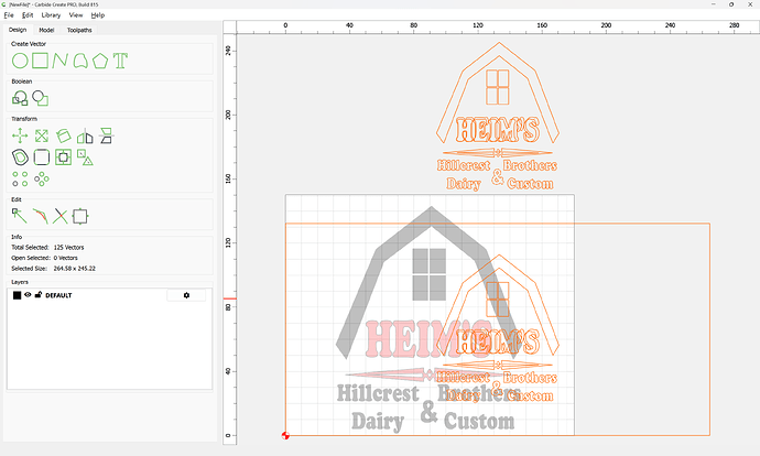

Re-save the vectors as an SVG and import:

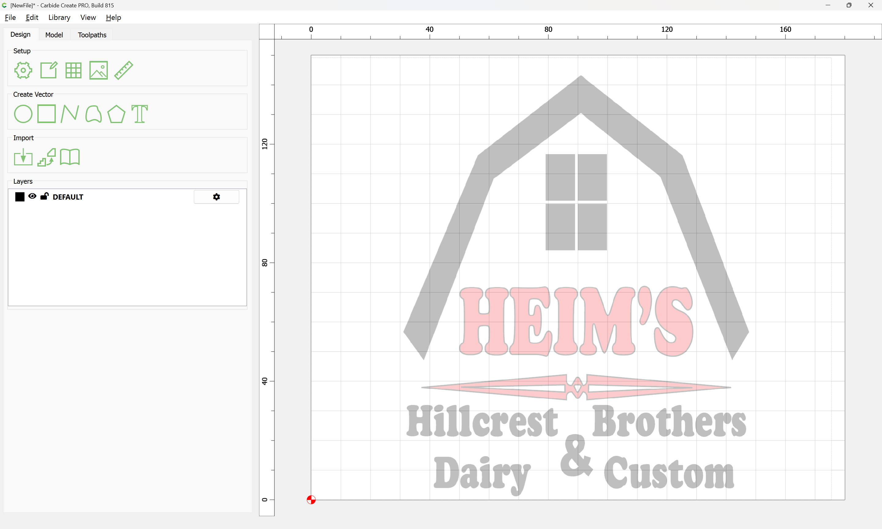

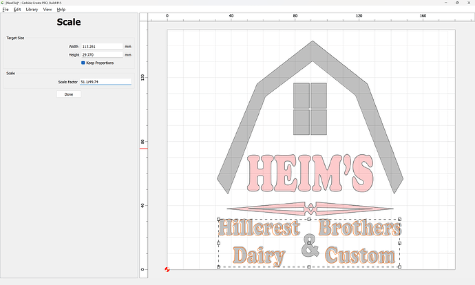

remove the duplicate elements, re-size, and re-position relative to the background image:

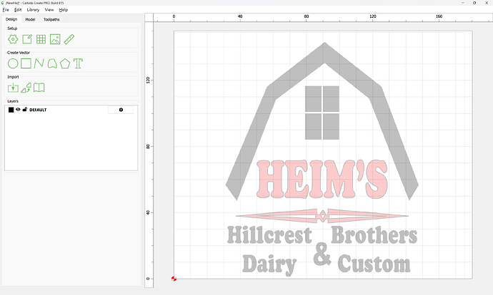

SVG attached:
dairy logo 2_v8
and a .c2d:
dairy logo 2_v8.c2d (220 KB)
