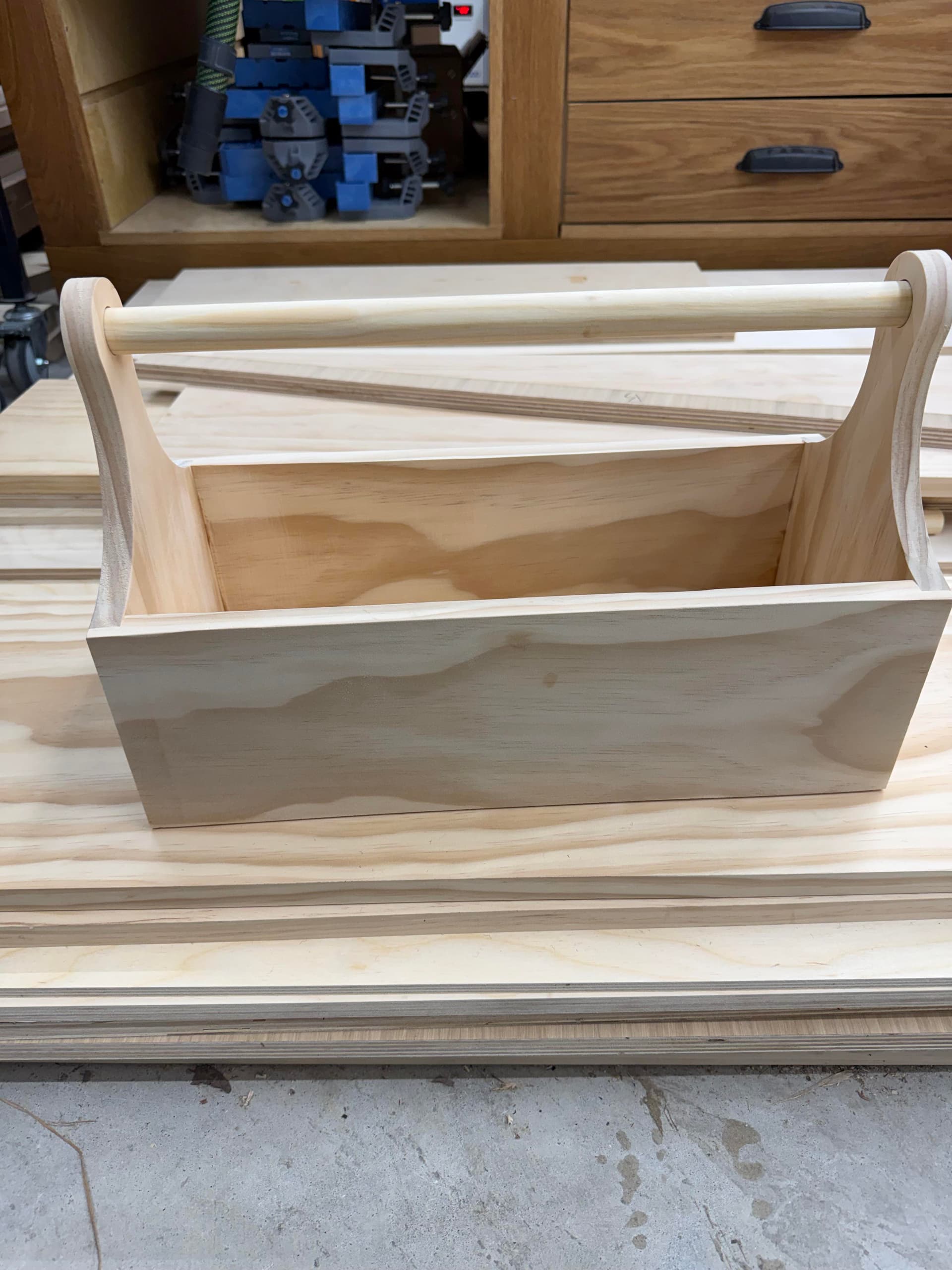

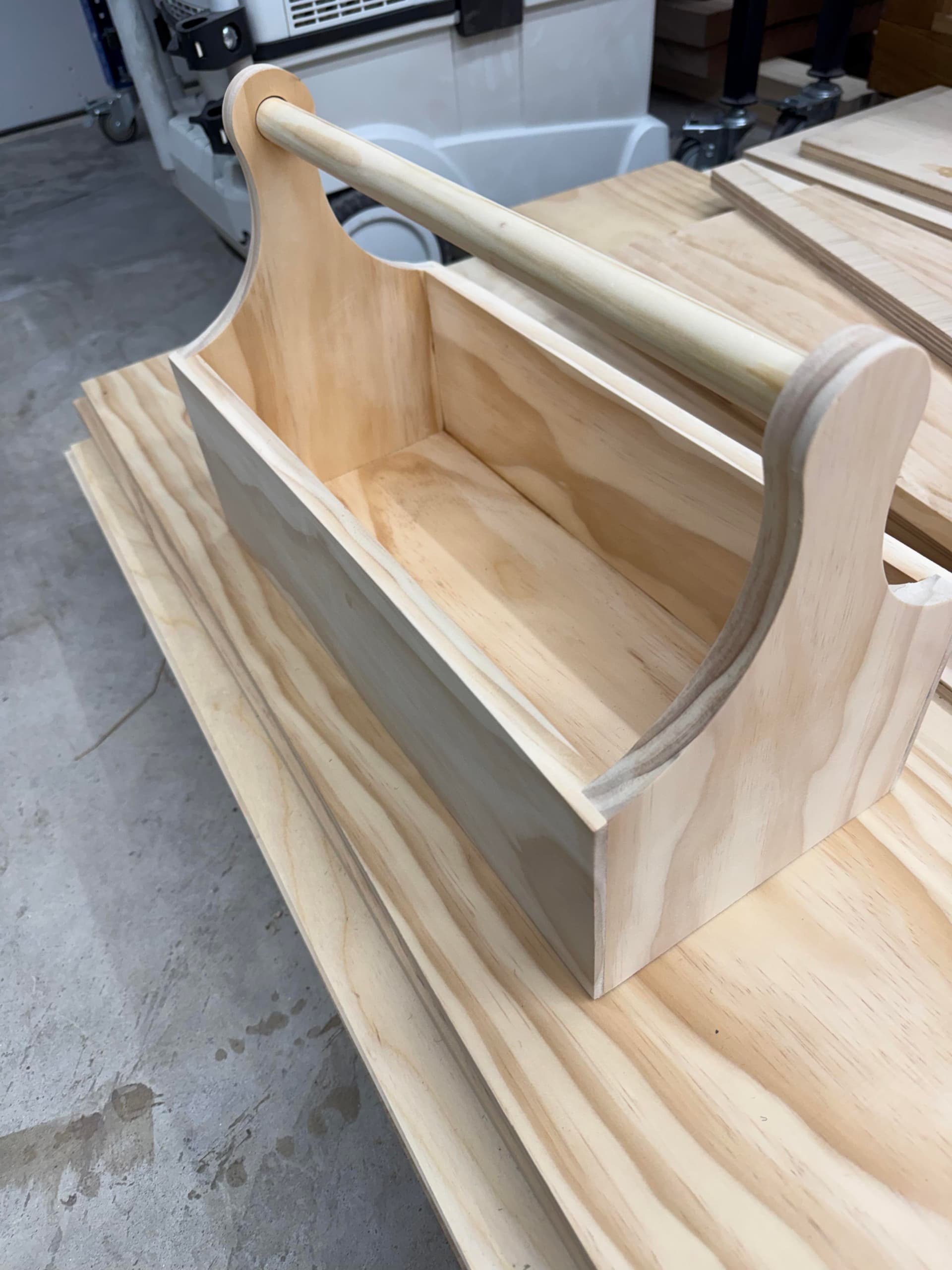

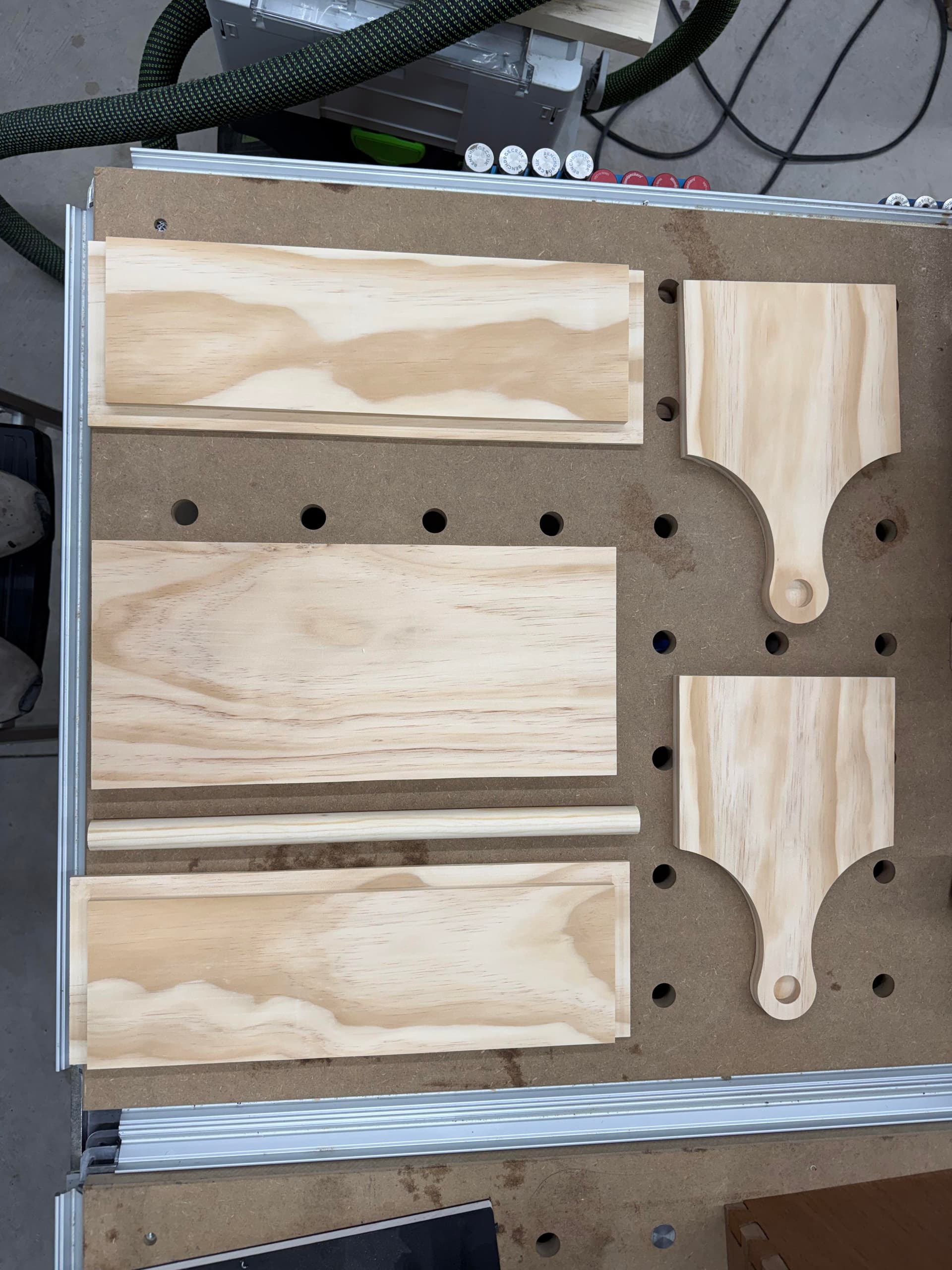

Simple Garden Caddy on the CNC
My wife has wanted me to make her a Garden Caddy fashioned after a wooden tool caddy to put small plants in. This is what I came up with. Very simple and easy but made the Mrs. happy!

One option would be to put an intricate garden related design and her name on the sides, some interesting curves on the boards, etc… Etsy is great for finding nice design features. That is the fun part of a CNC machine and the thing that turns nice into amazing.
Good point, Jim! This was my first attempt, but I like your idea! Maybe we’ll make a version 2.0 with a cool design!
I like the design. What are you going to use to seal/stain it. I made some swing seats and used teak oil. it has lasted for years.

Oh wow, very cool, Jim! What bit did you use to do the artwork?

I used a Vcarve tool path with a 1/8" bit for the pocketing and then a 60 degree Vbit for the final carving. I carved her name with a 60 degree Vbit also. I went one step further and filled in the carved out spaces with an epoxy resin for contrast but that would be unnecessary.
