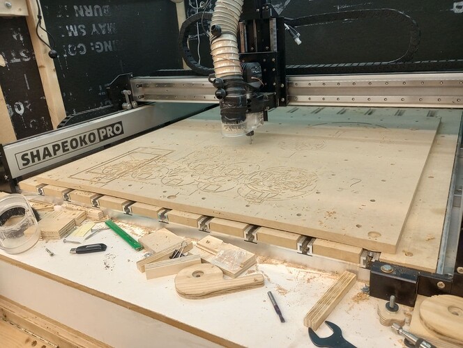

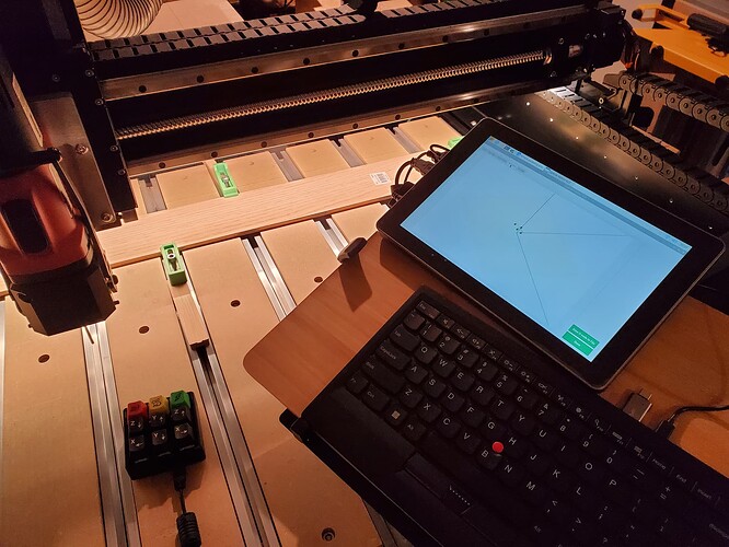

Positioning my machine similarly and setting the origin:
I do not get an error on loading that file:
I then click done with loading the file. Then I hit the run button, and the error comes up.
