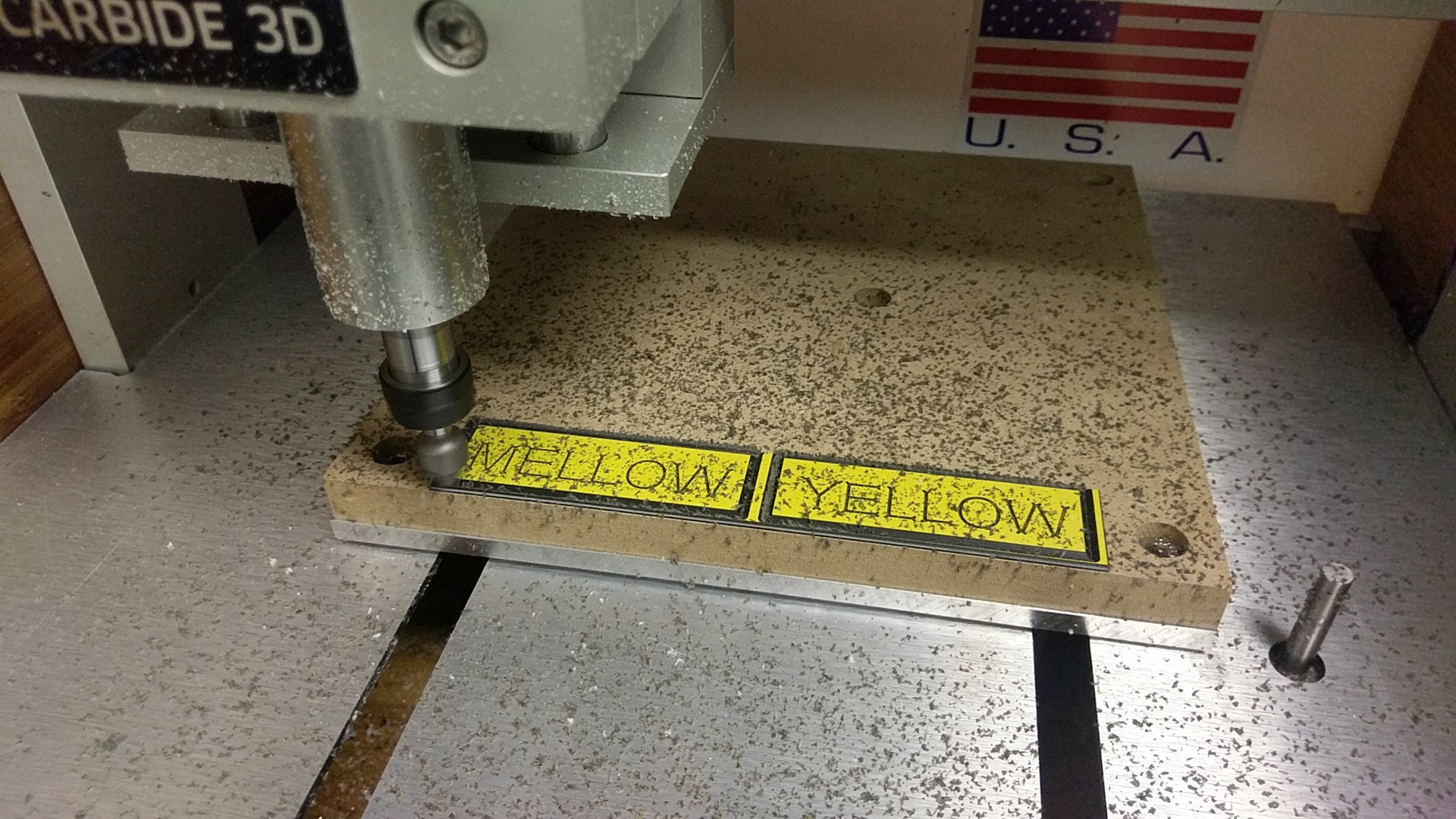

I Just ran a test with the V-bit cutter we carry in the Nomad with some Signage stock.
My Samples are 1" by 6" x .060" thick but I was able to test the beveled edge and Font with the single cutter.
Below you will find the results and the Carbide Create file for your reference.
Because I created the Text in CC, I was able to select it as 1 item.
If your importing an svg or dxf, you may have to select each letter (press cntrl to select multiple items)
Toolpath 7 is the smaller rectangles, and although I am using the V-bit cutter
V-carving pass
Toolpath 7 cuts on the line to a depth of .059"
MELLOWyellowTEST.c2d (5.6 KB)
MELLOW YELLOW.egc (12.8 KB)

Hey @ApolloCrowe, why did it make those little dog bone looking things on the ends of the letters? That doesn’t seem to be what your toolpath shows. Is that due to the v-carving? Can you avoid it, if you want to?
Probably caused by the serifs on Goudy’s Copperplate Gothic being exaggerated by the cutting:
https://www.linotype.com/1549209/copperplate-gothic-family.html
Thanks so helpful Apollo! We’re getting closer, we got some that are usable and working on getting more dialed in, playing with settings still, got the “bones” and ordered some different end mills. Switched to a mac a couple months ago, so to select multiple objects with ctrl-Click wasn’t working, but command-click was (doh) don’t know why I didn’t try that sooner.
@MrHume
Good Point.
The Text layer toolpath was set to be a Vcarve style toolpath, that is why the letters have “dogbones” at the ends.
A pocket style toolpath for the Text layer would be a better choice for that font.
