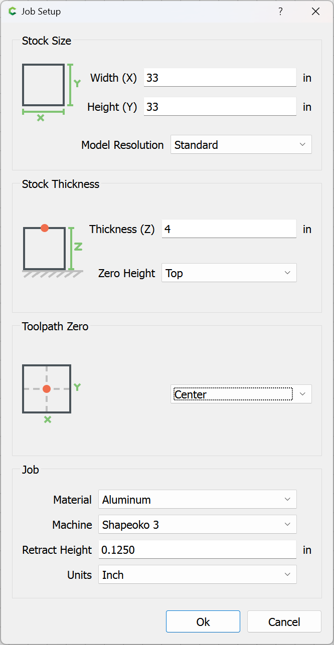

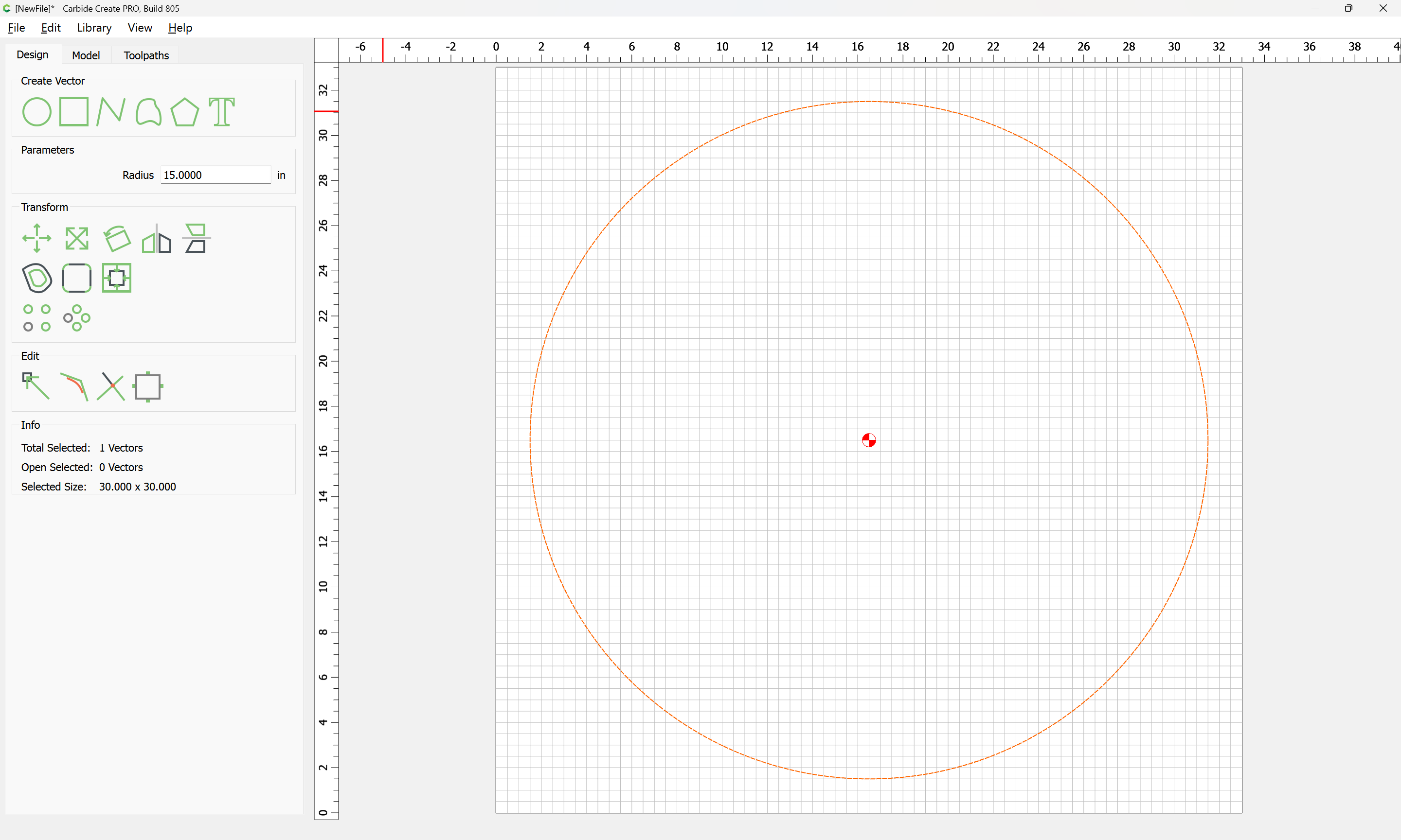

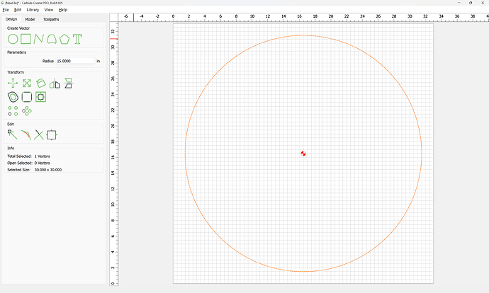

Are you sure it’s not an ASCII file? Only binary is supported:
Try opening in a 3rd party tool such as Microsoft’s 3D Builder and re-saving?

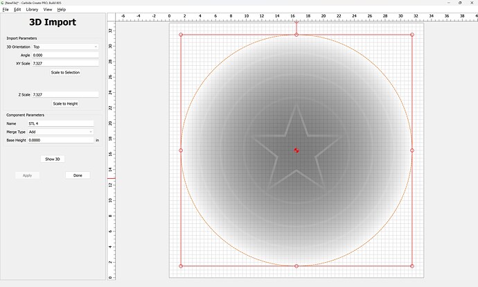

Here is a free file which seems okay:

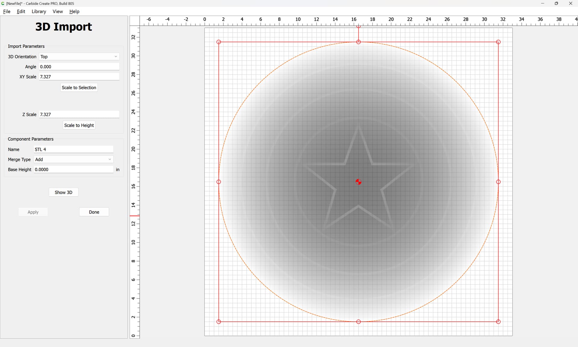

We set up a file:
which seems to import as expected:
(though the lines seem somewhat exaggerated)

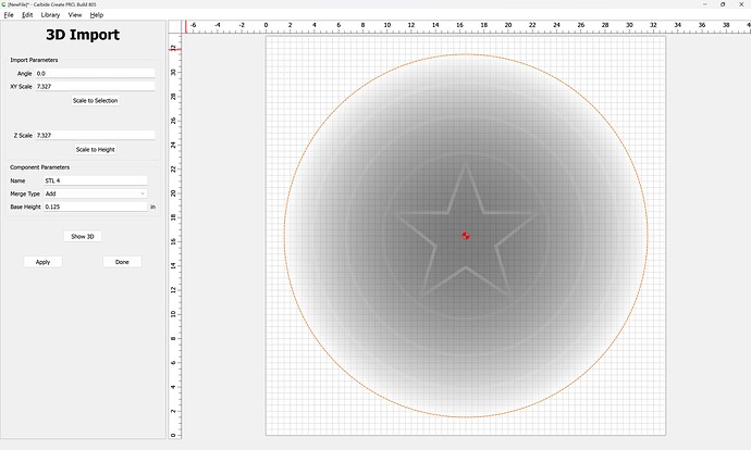

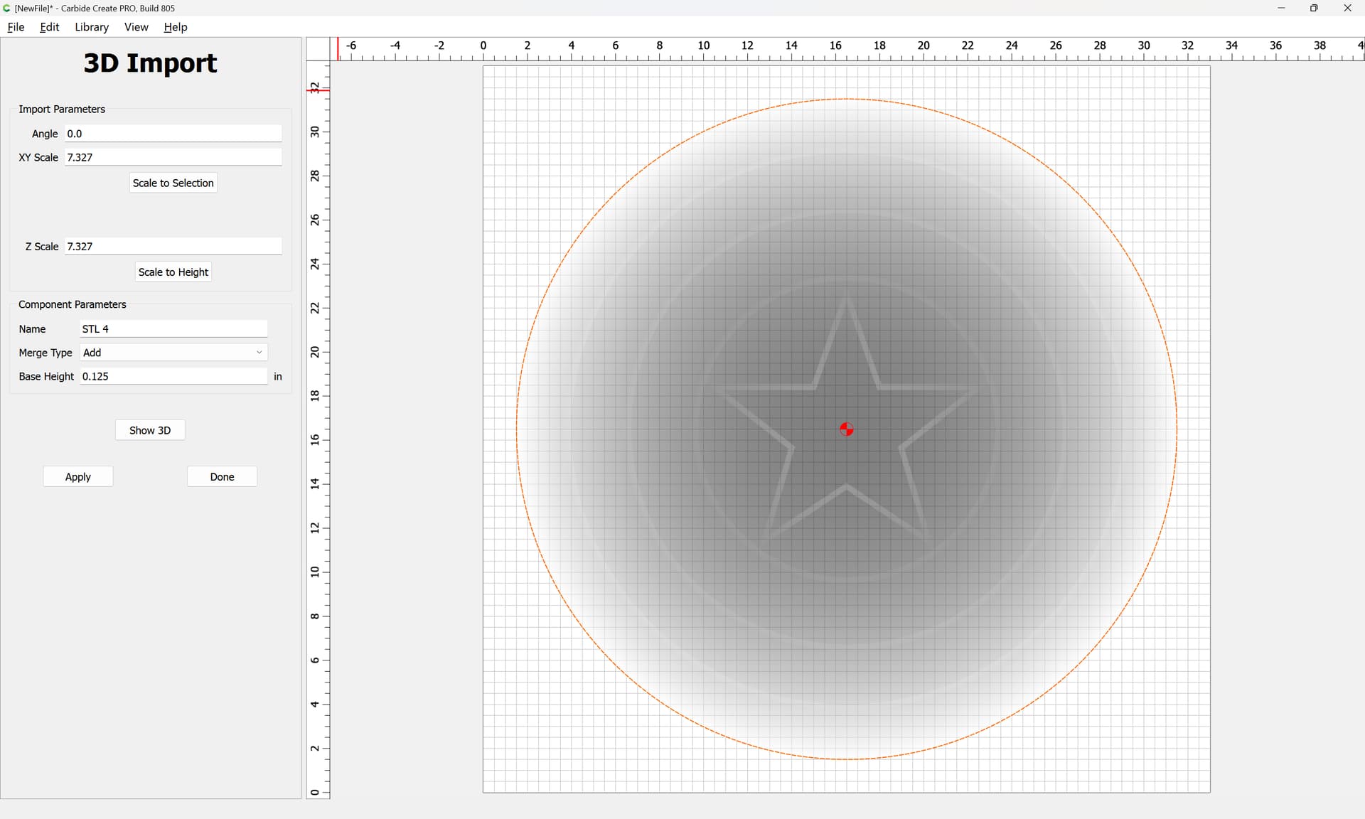

Probably better with a bit of a Base Height to ensure that it doesn’t taper to nothing at the edges:
This file seems to be a very good compromise to work with, thank you.
