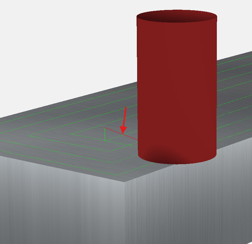

In the Tenzin Surfacing file, when you step to the last retract, it draws an extra rapid line back to the zero point?
