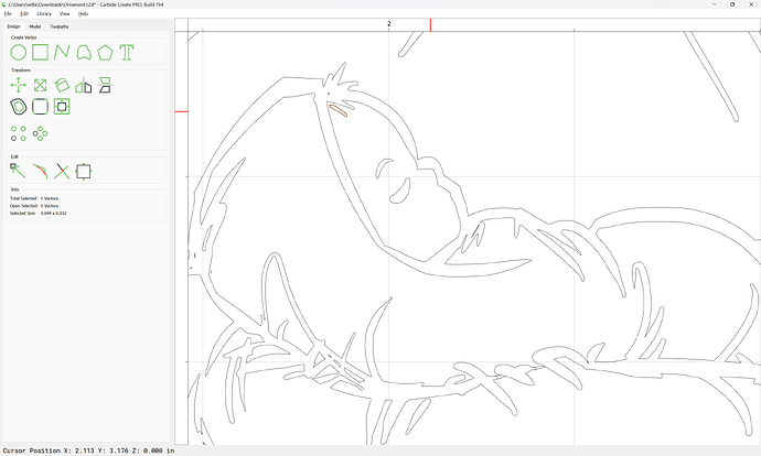

I created a Christmas ornament but the simulation takes a very, very long time to do. There are 104 vectors in it. I have attached the file.
Is there something I can do to change this?

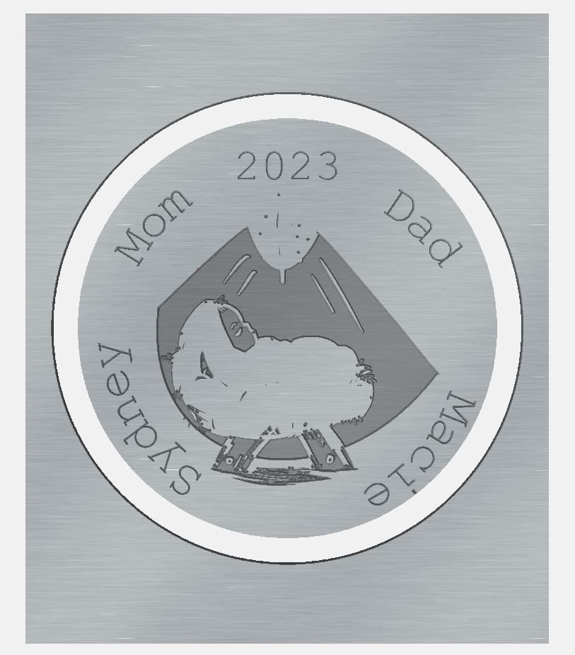

Here is the simulation with #122 1/32" end mill and a 15 Degree v-bit.
Guy, thanks for the reply and debug. I do not have either of those tools. I think I will just look for a different SVG to carve the ornament.

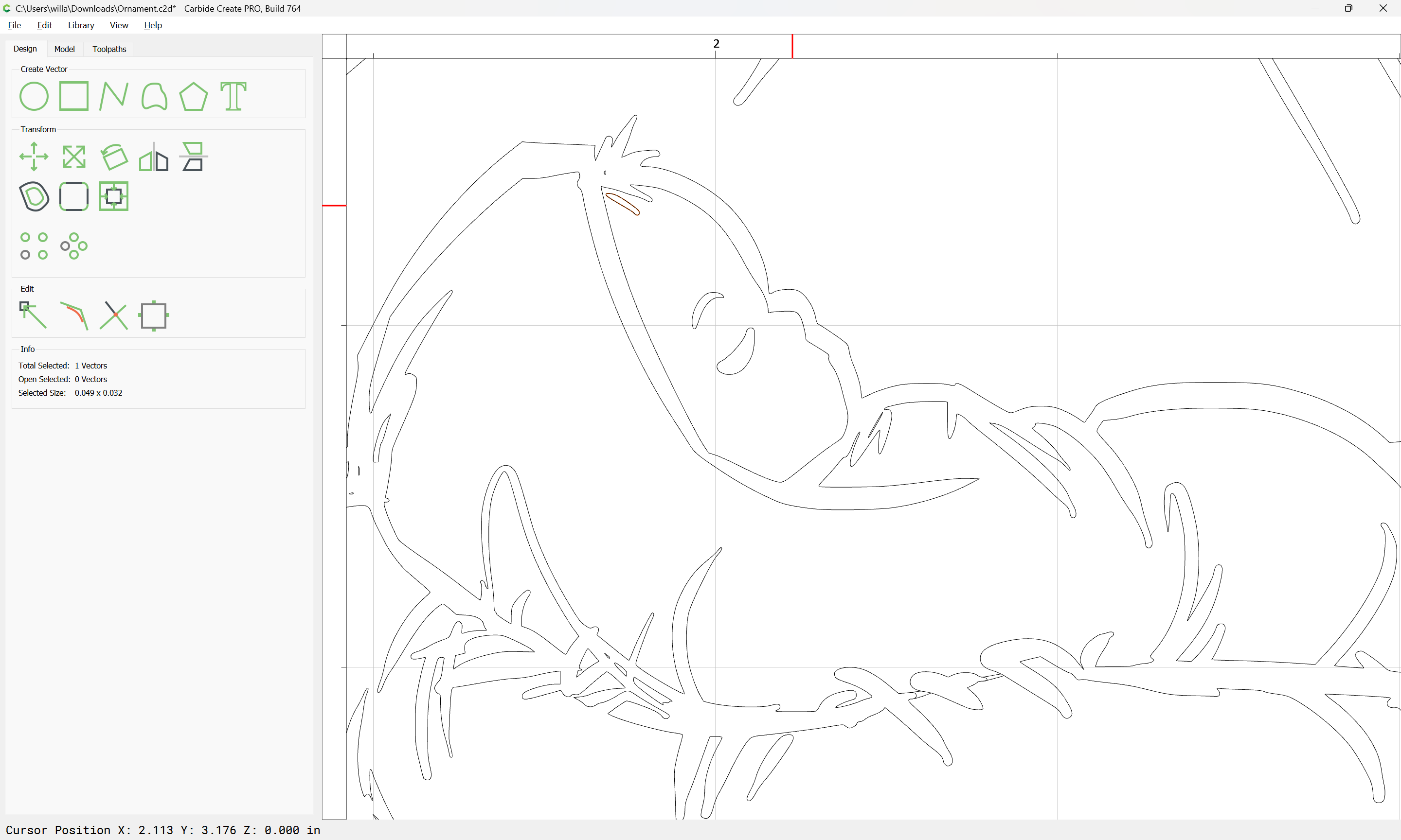

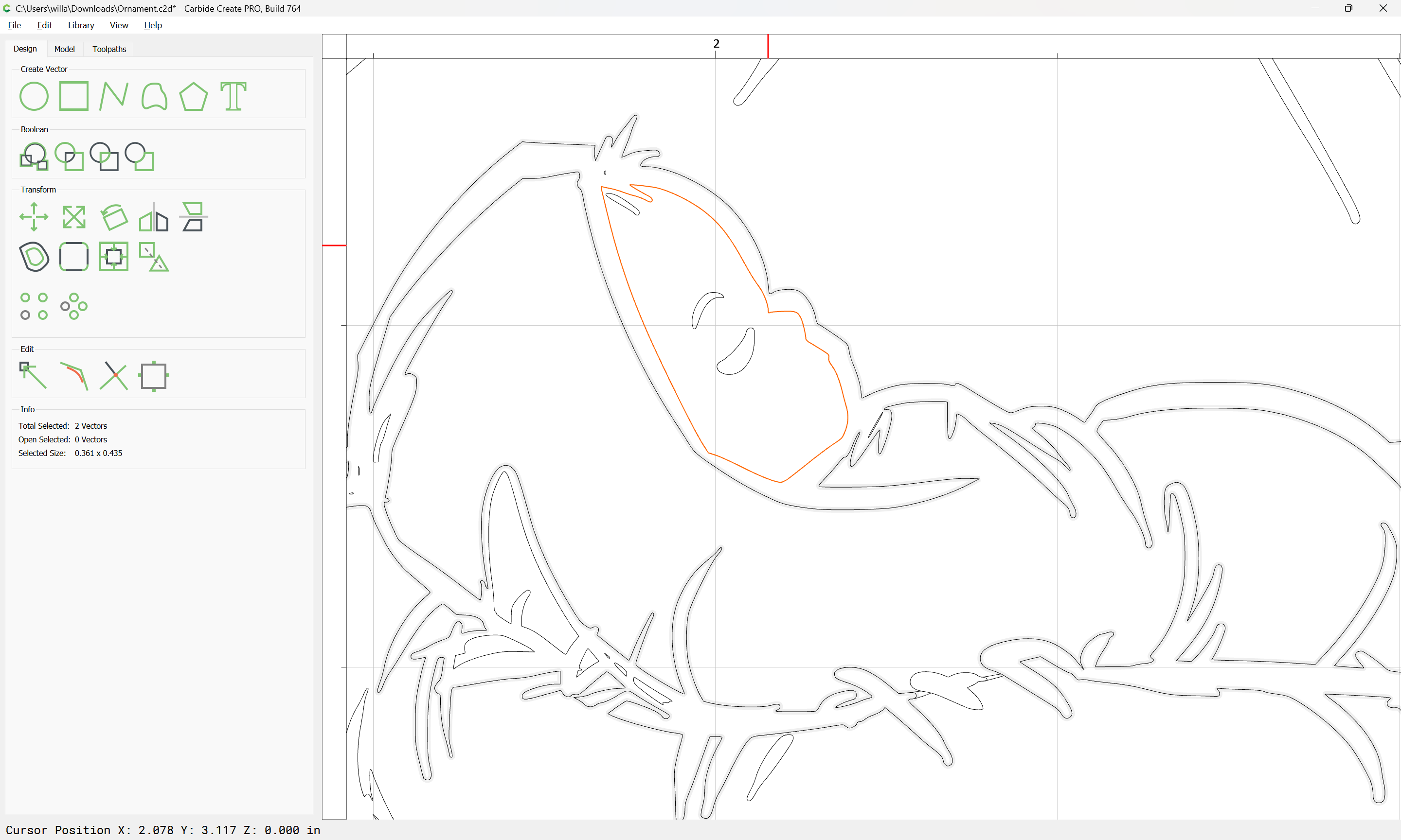

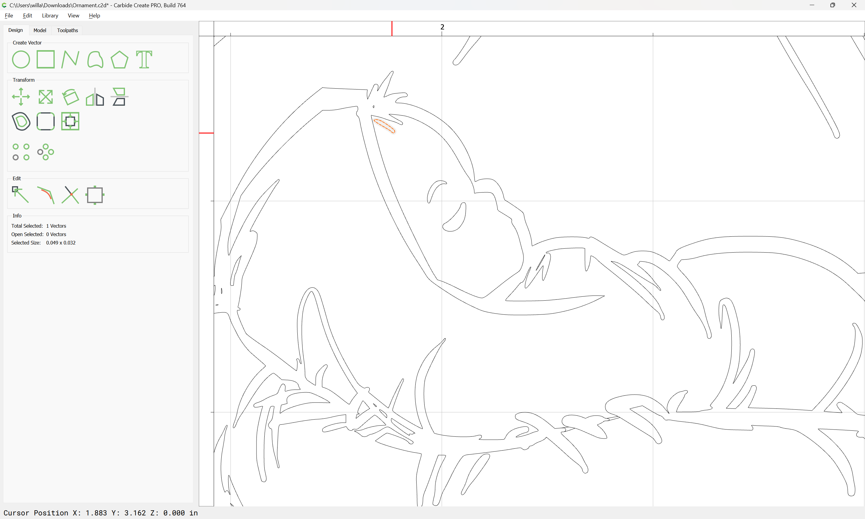

Part of the problem is you have doubled-up/stacked vectors:
I doubt that the 1/16" tool you are using is capable of a 1" plunge cut though, and Iād suggest verifying/checking/testing your tool definitions.
EDIT: The tool definition seems to be part of the problem ā could you post a screen grab showing how the tool is defined?
