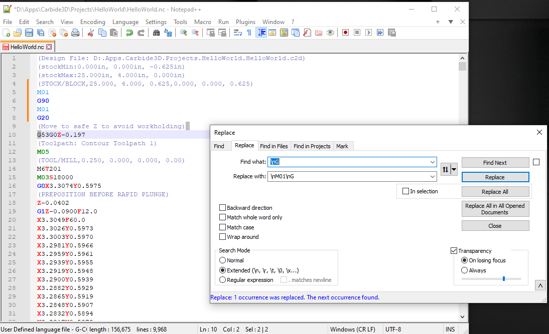

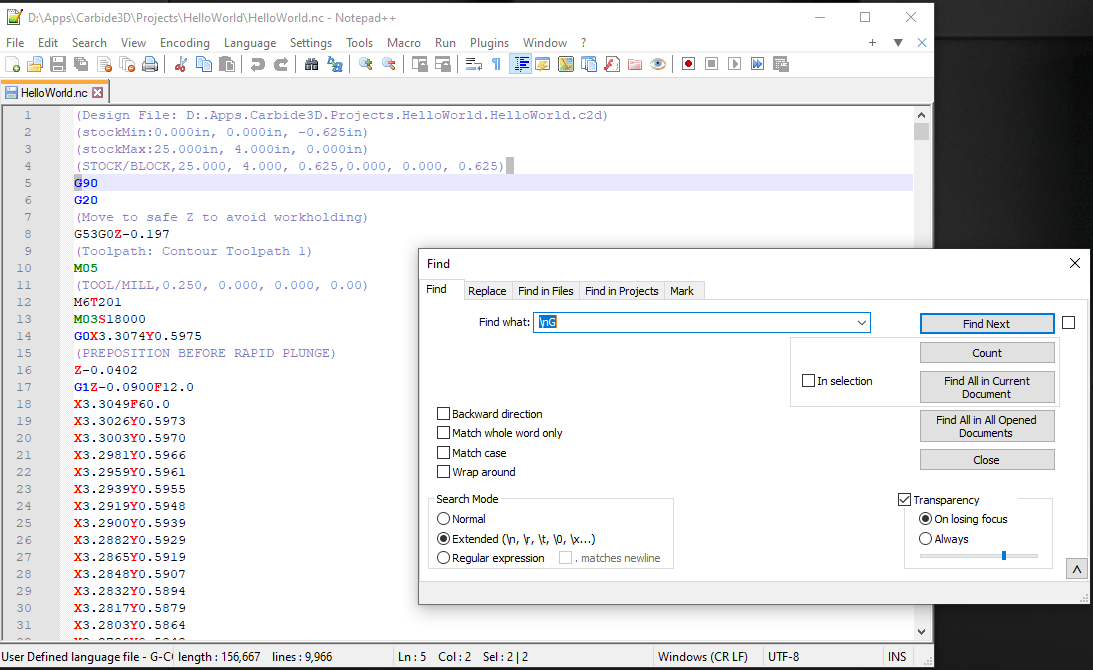

I use Notepad++ for text manipulation.
Here is an example of finding a newline then a G character
This is a replace newline G with a newline M01 then newline G
