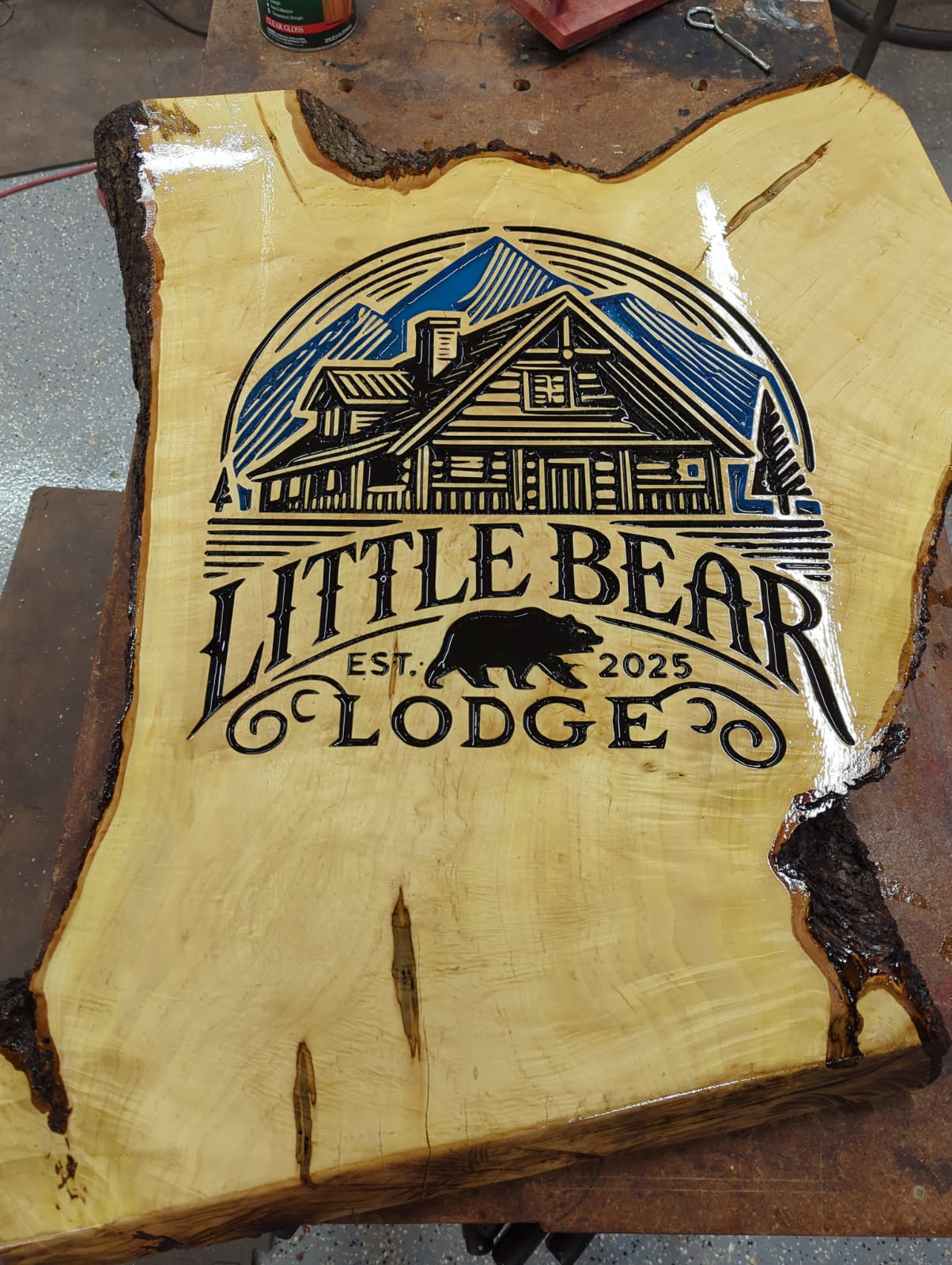

This is my first carving done for someone other than me. Any idea what I should charge for something like this?
BTW, the carving was 20" x 20".

I would think it is worth $100 at the minimum.

Well, you should have worked that out first. I’ve been giving customers a price range.

I do material x 2, & $75.00 per hr for Design, machining, and finishing. Also if your not sure just give a labor rate like the car shops do and leave the ticket open :slight_smile:

What did you use to color this? Was this epoxy?

More simple than that. After the carve, I gave the entire thing one coat of Varithane Spar Urethane to prevent any bleed through. Then I sprayed Rustoleum in the VCarves. Then, sanded away the overspray and gave the entire thing a couple more coats of the spar urethane.
