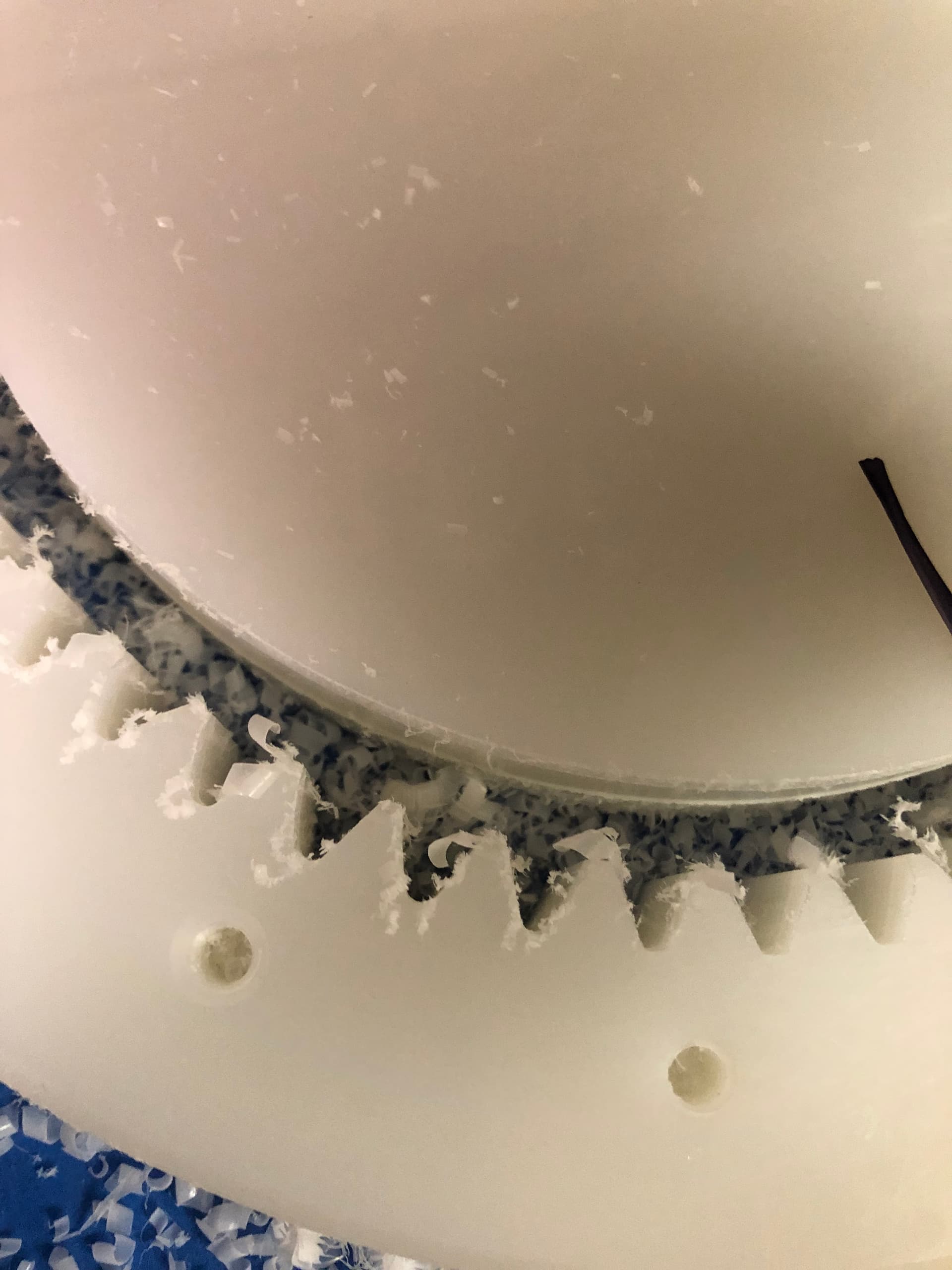

I don’t get to share much on here due to the work thing with non disclosers and waiting on patents and all that stuff. I needed a 12"od slewing ring bearing for a project, however, I couldn’t get the company I normally deal with to return my calls. So, I found another that could get me what I needed but it was a 12 week lead time (I only have 14weeks to finish the prototype that all revolves around the bearing) He did however send me the drawings…His mistake.
I modeled it up in Solidworks, tossed it into V-carve pro and made one in about 10 days.

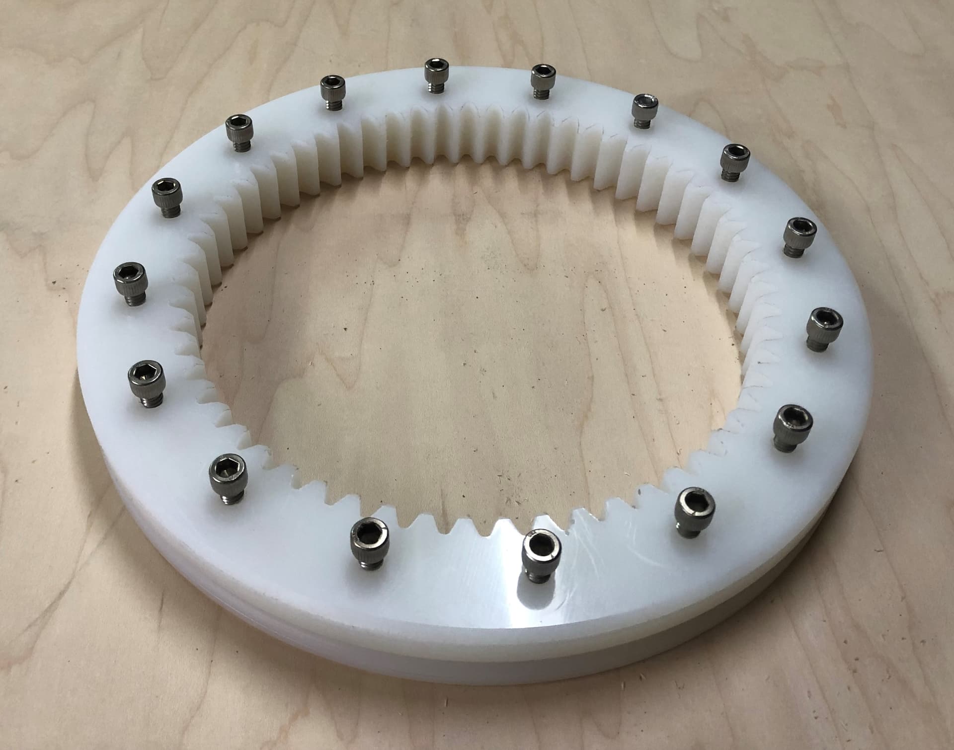

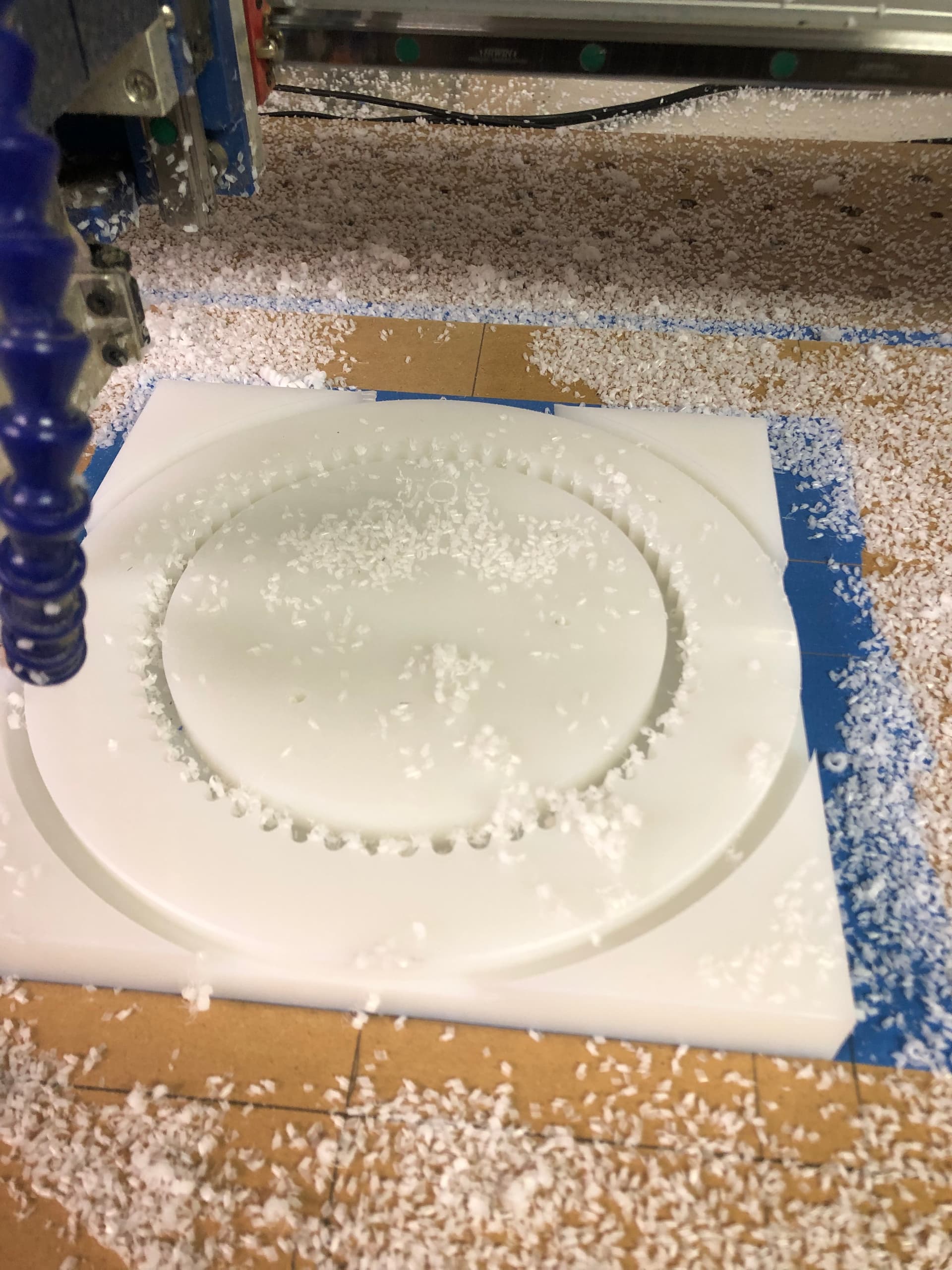

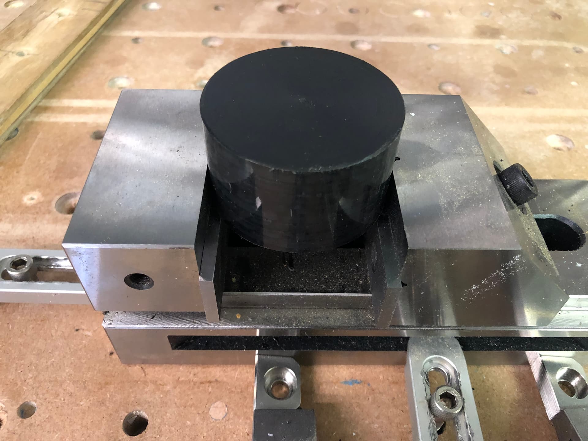

Inner Ring

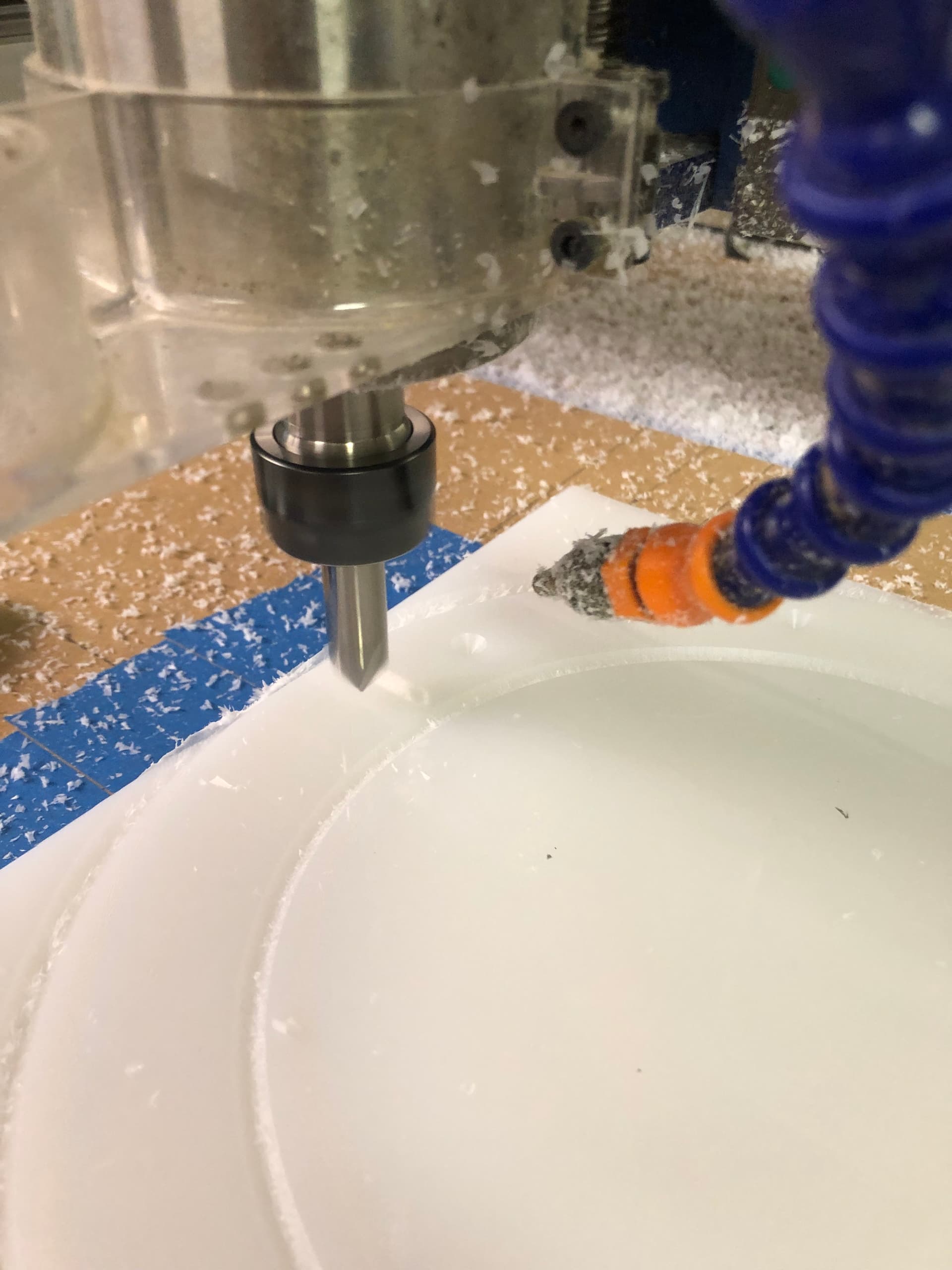

1" UHMW

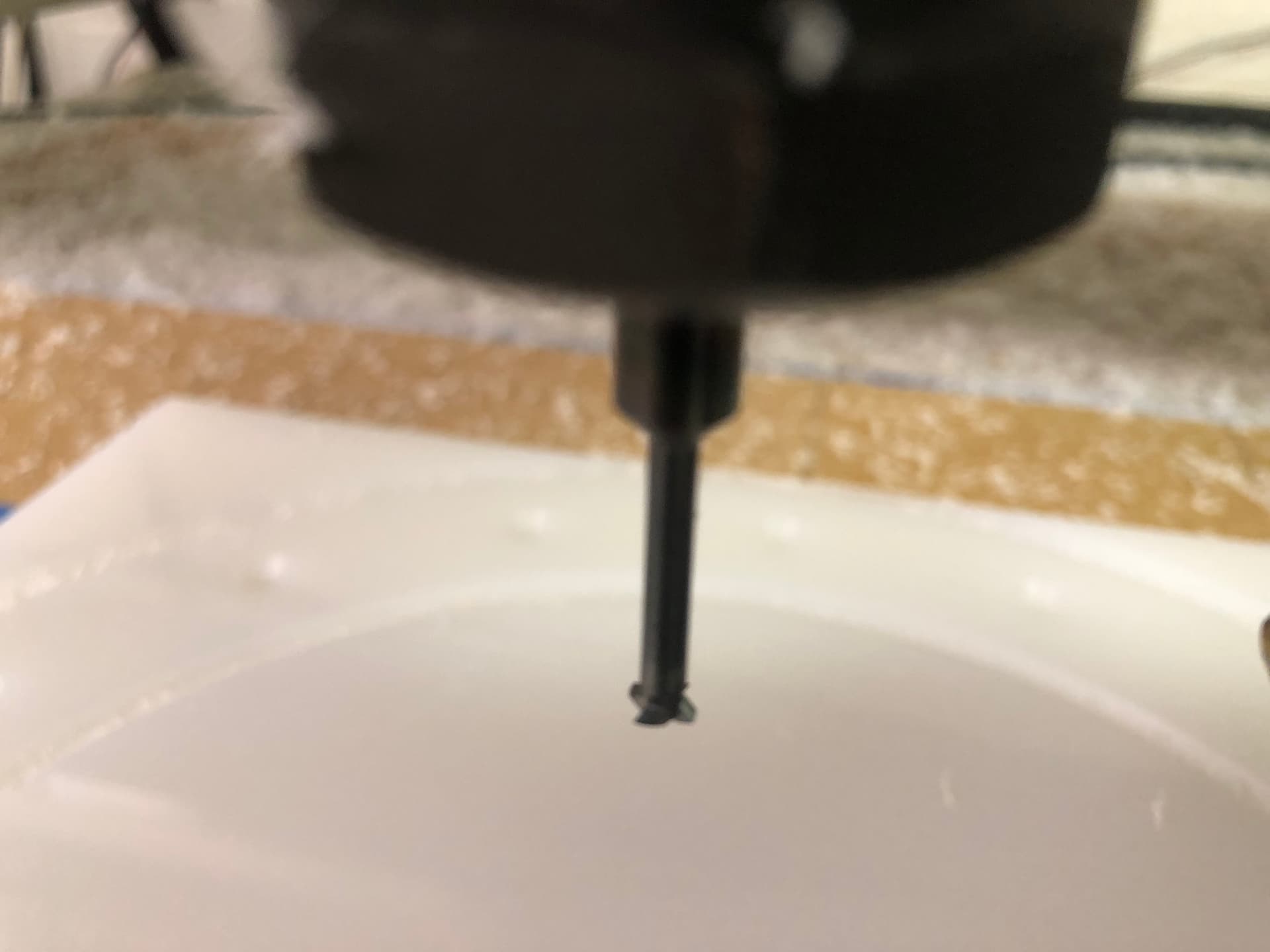

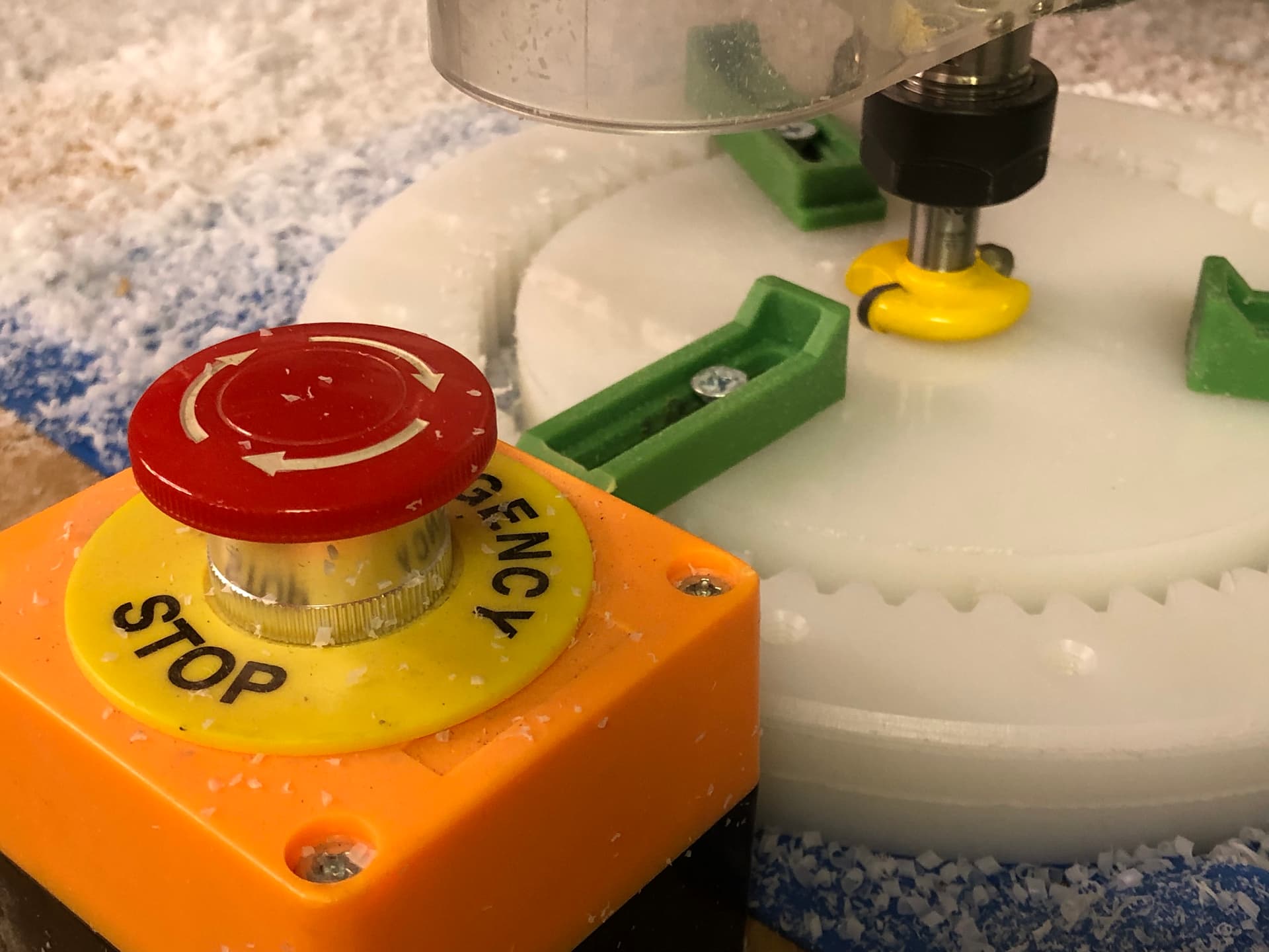

Cut side 1 with 0.25 0flute
Followed up with an 0.0625 long reach. Was originally going to try and do it all from one side and decided to go just past halfway.

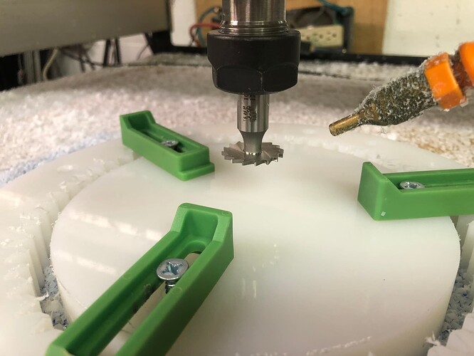

82deg chamfer

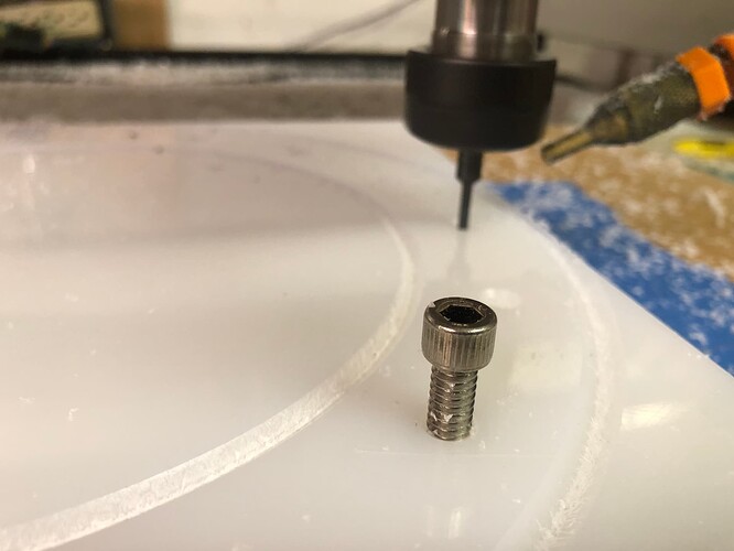

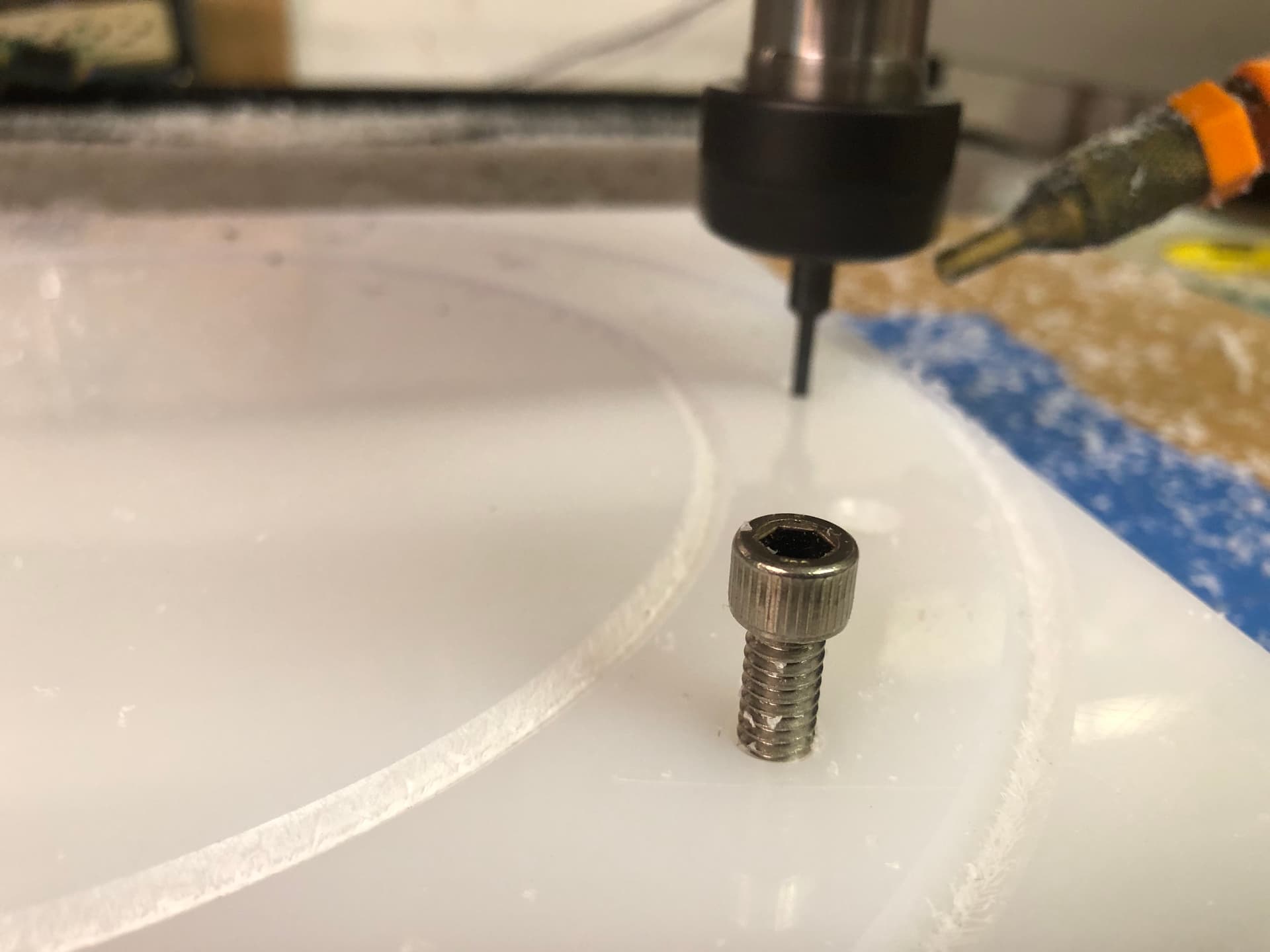

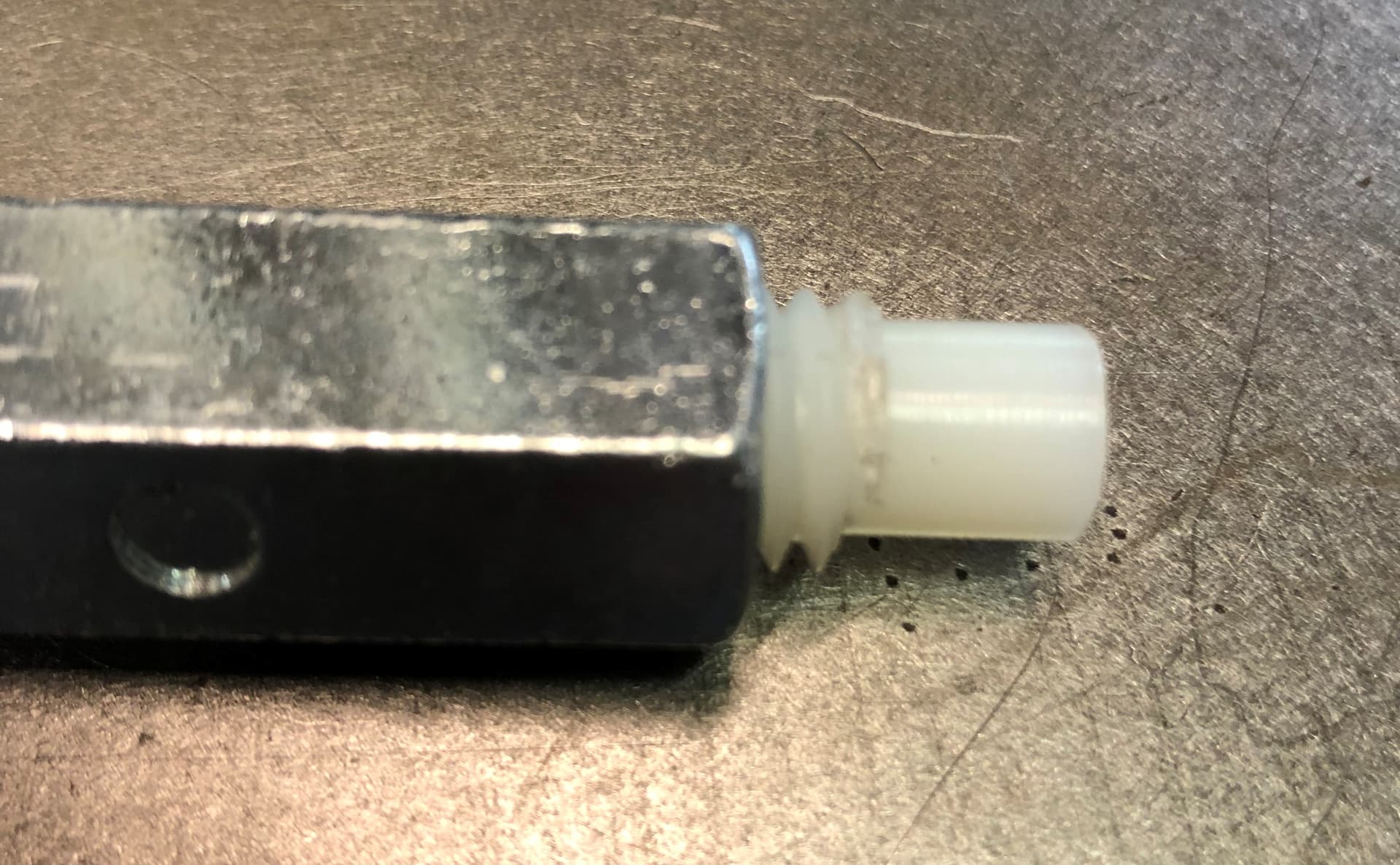

Single point thread mill for 1/4-20. Pre drilled with an “F” bit
Testing along the way

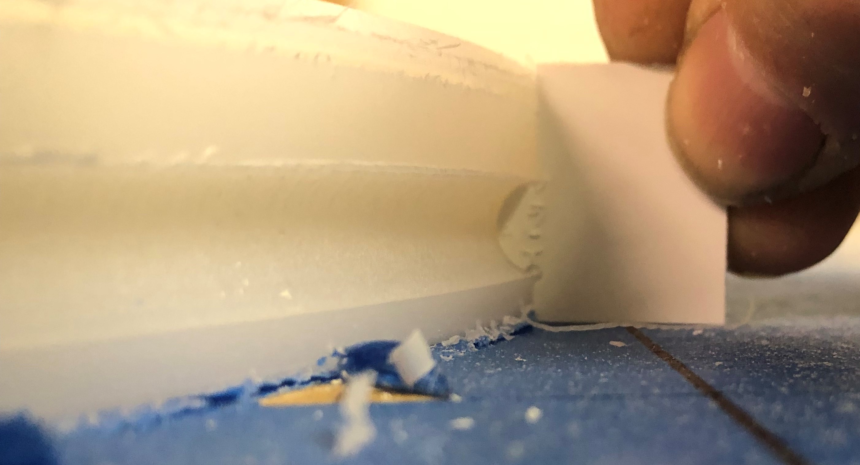

Cut all the way through. Fuzzies cleaned up really easy.

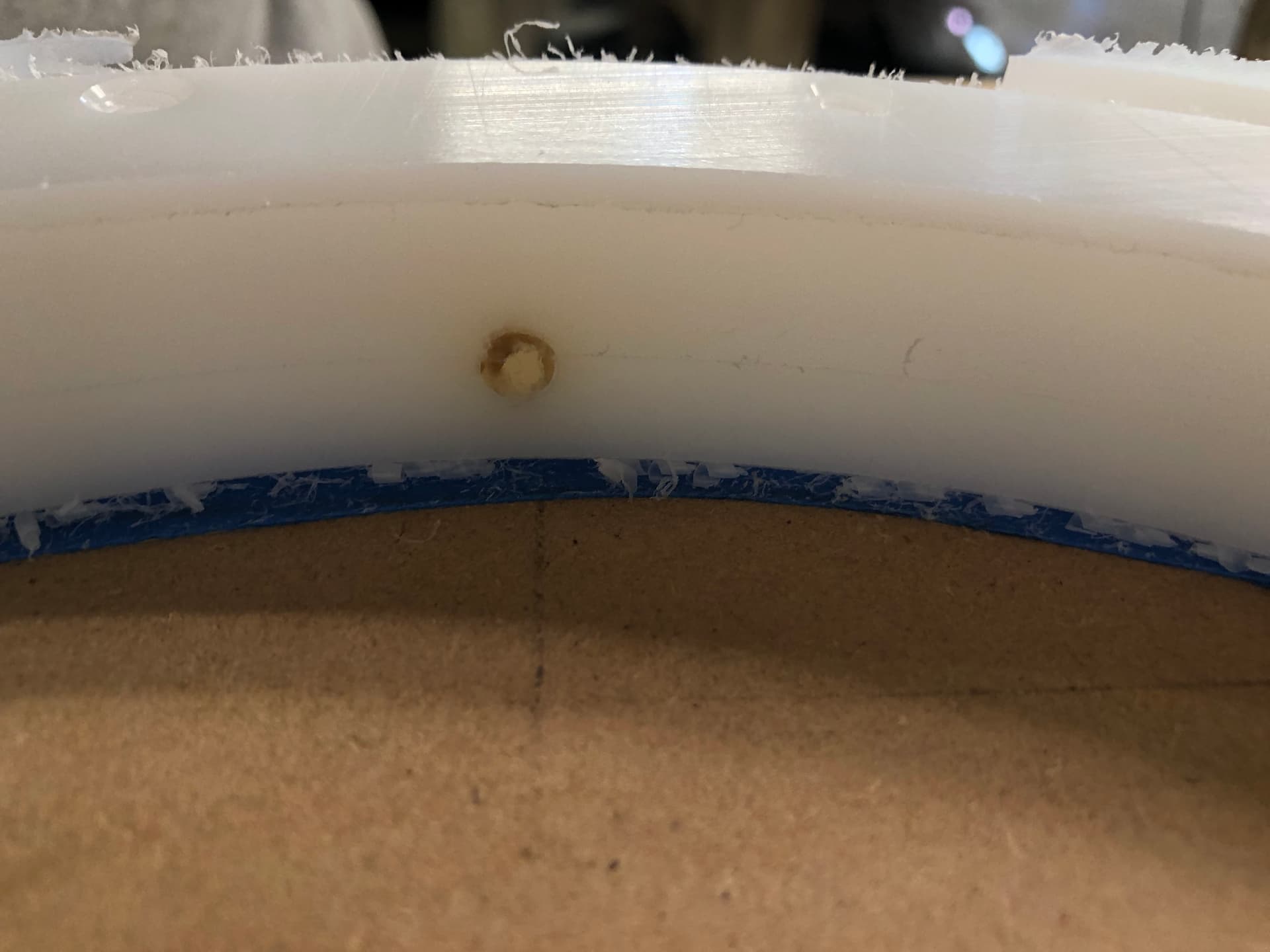

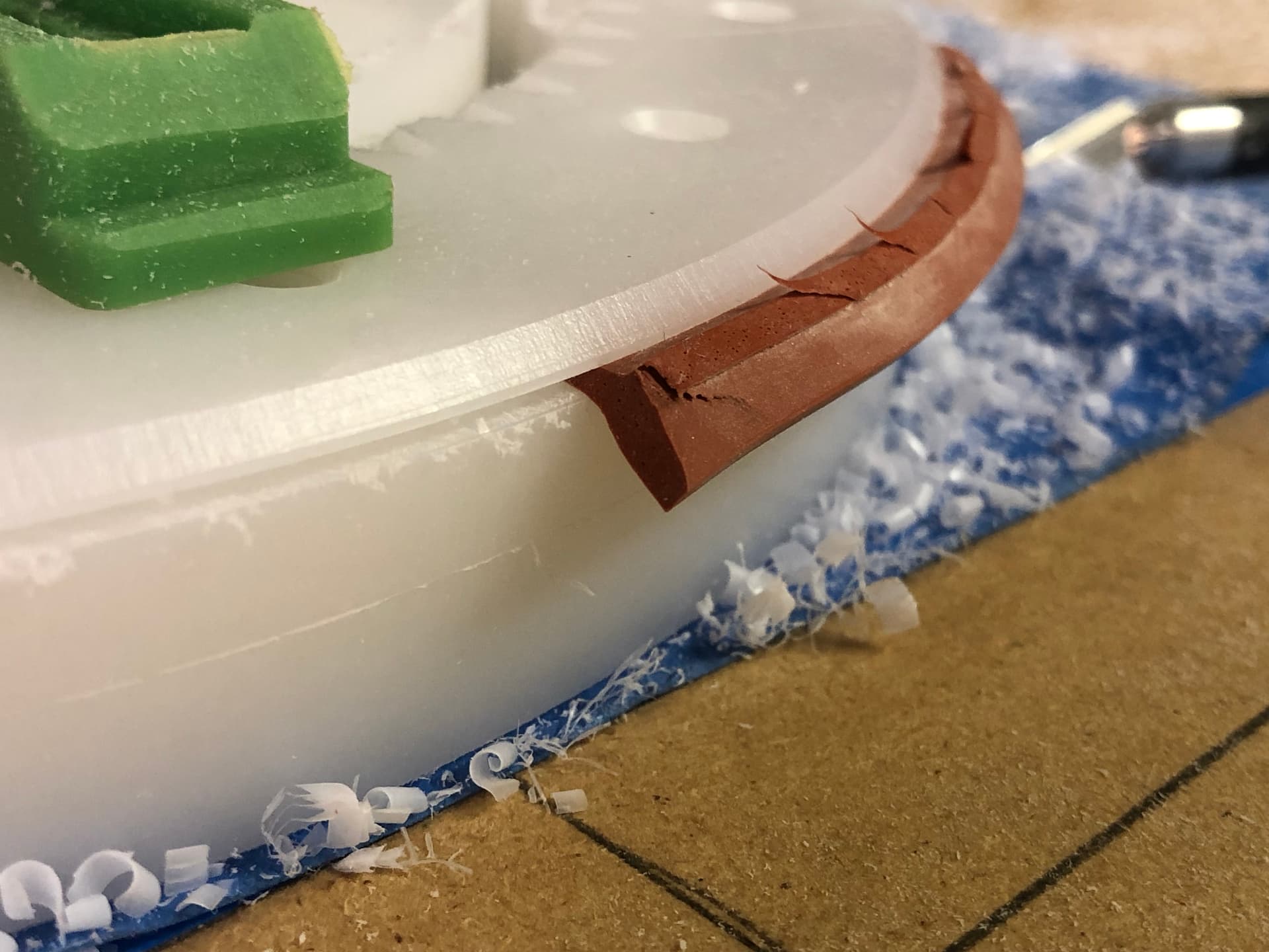

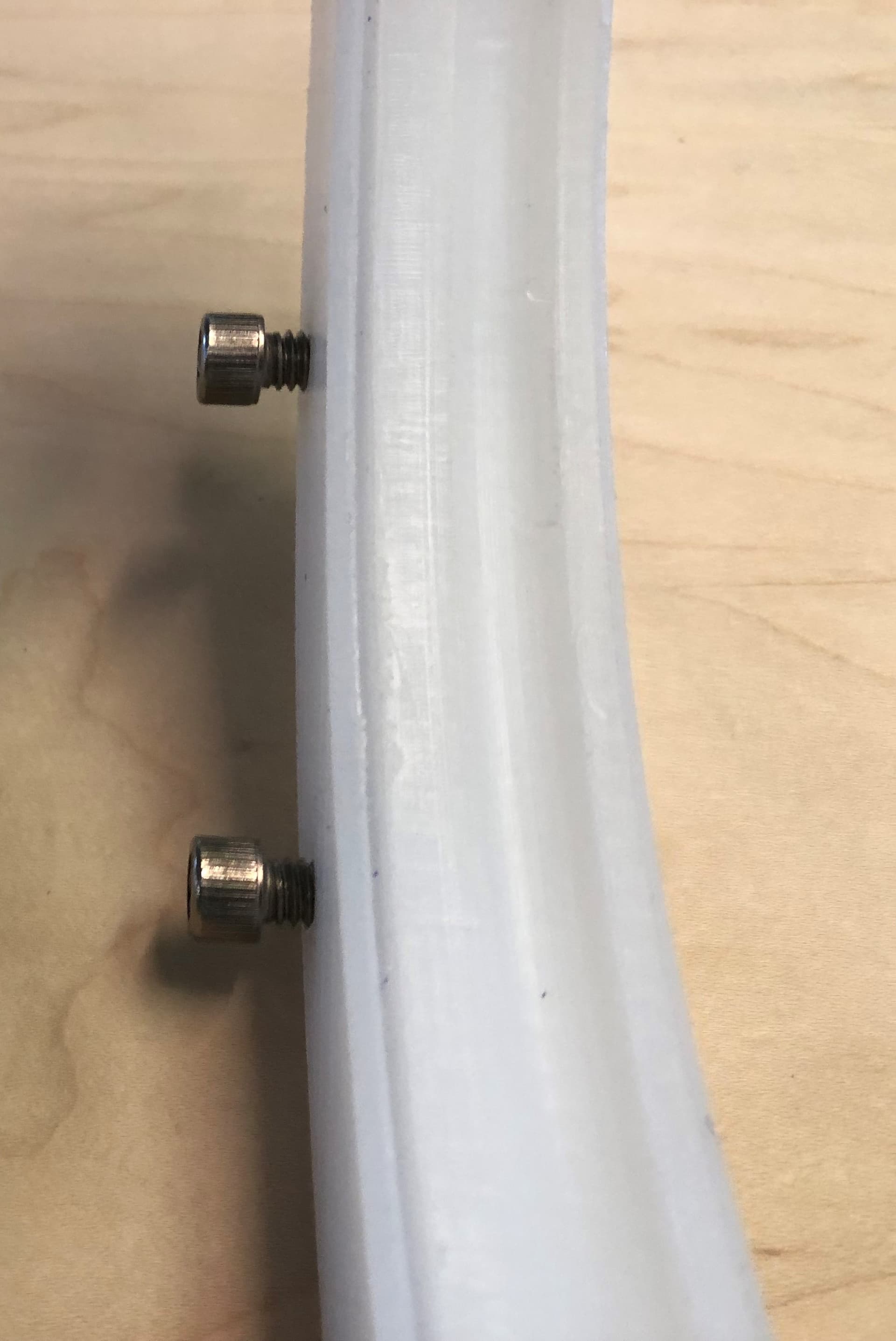

1/16 slit for seal
Hach and slashed a stock seal

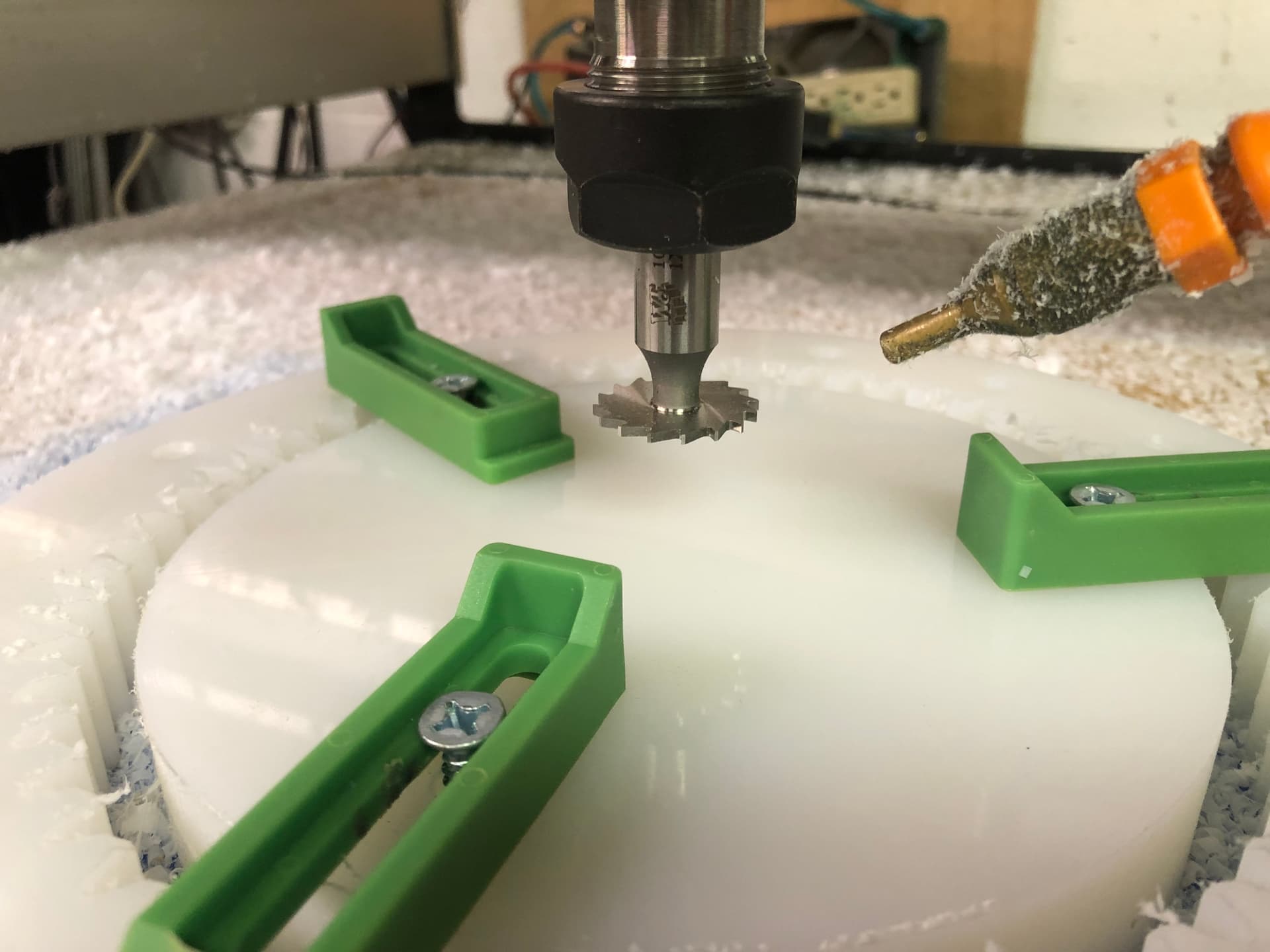

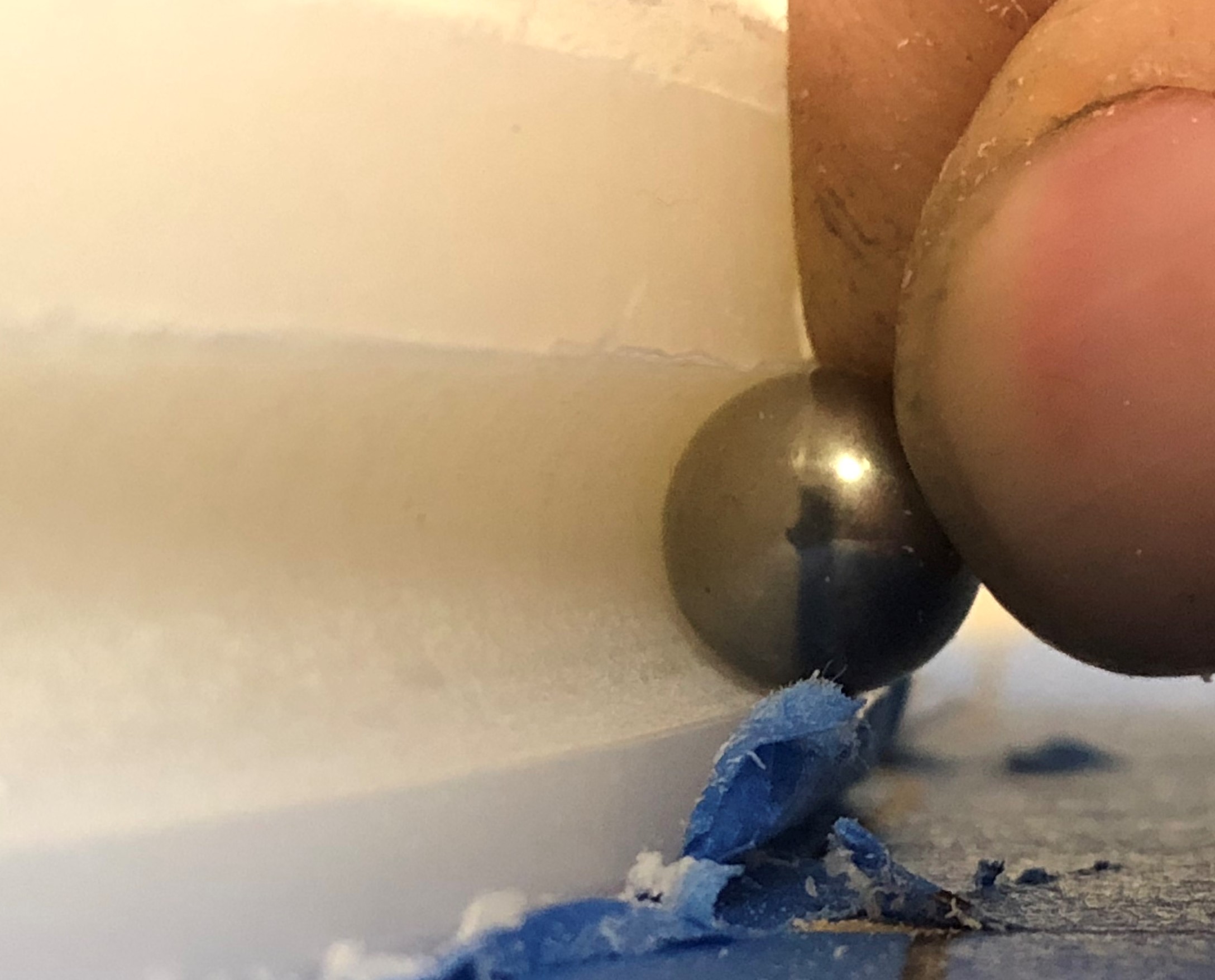

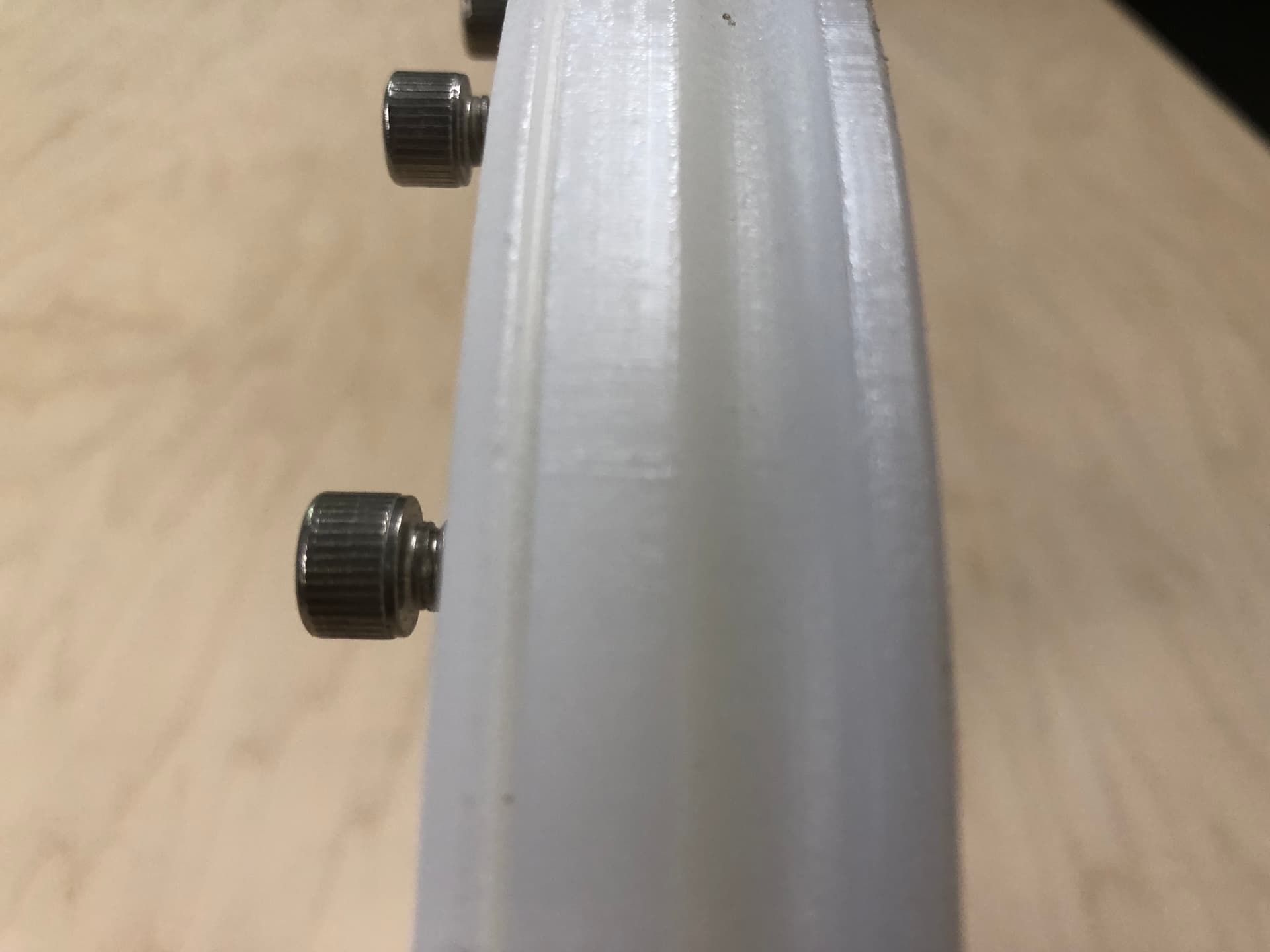

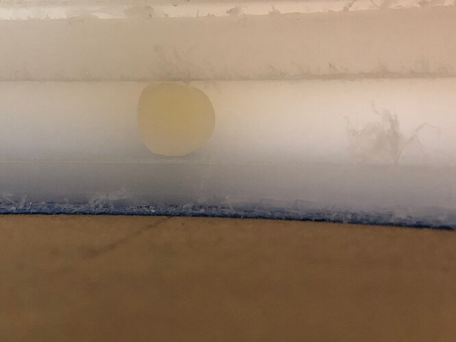

Raceway cutter. 0.375
Test jig to check 0.15" deep

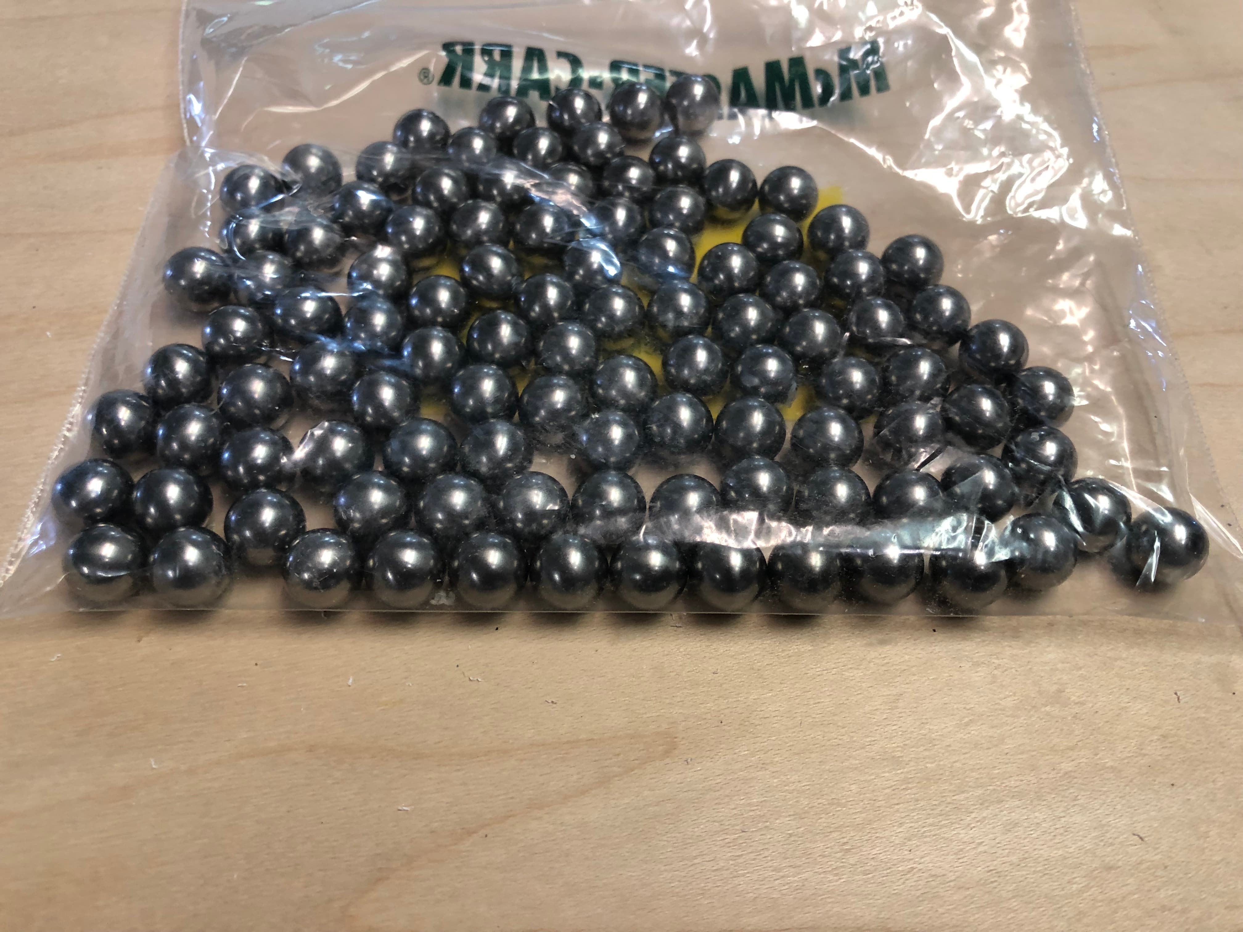

.375 ball bearing
All cleaned up.

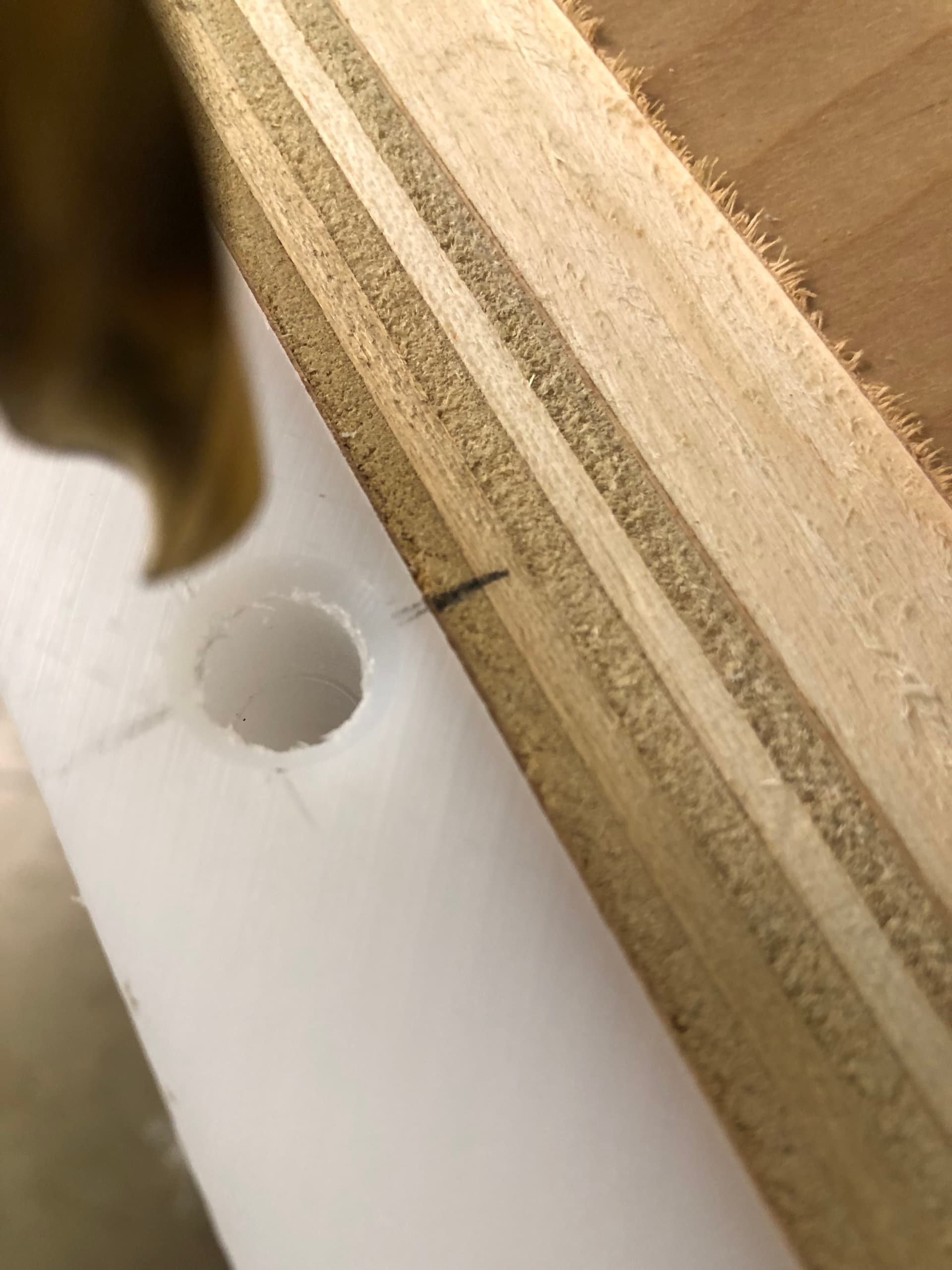

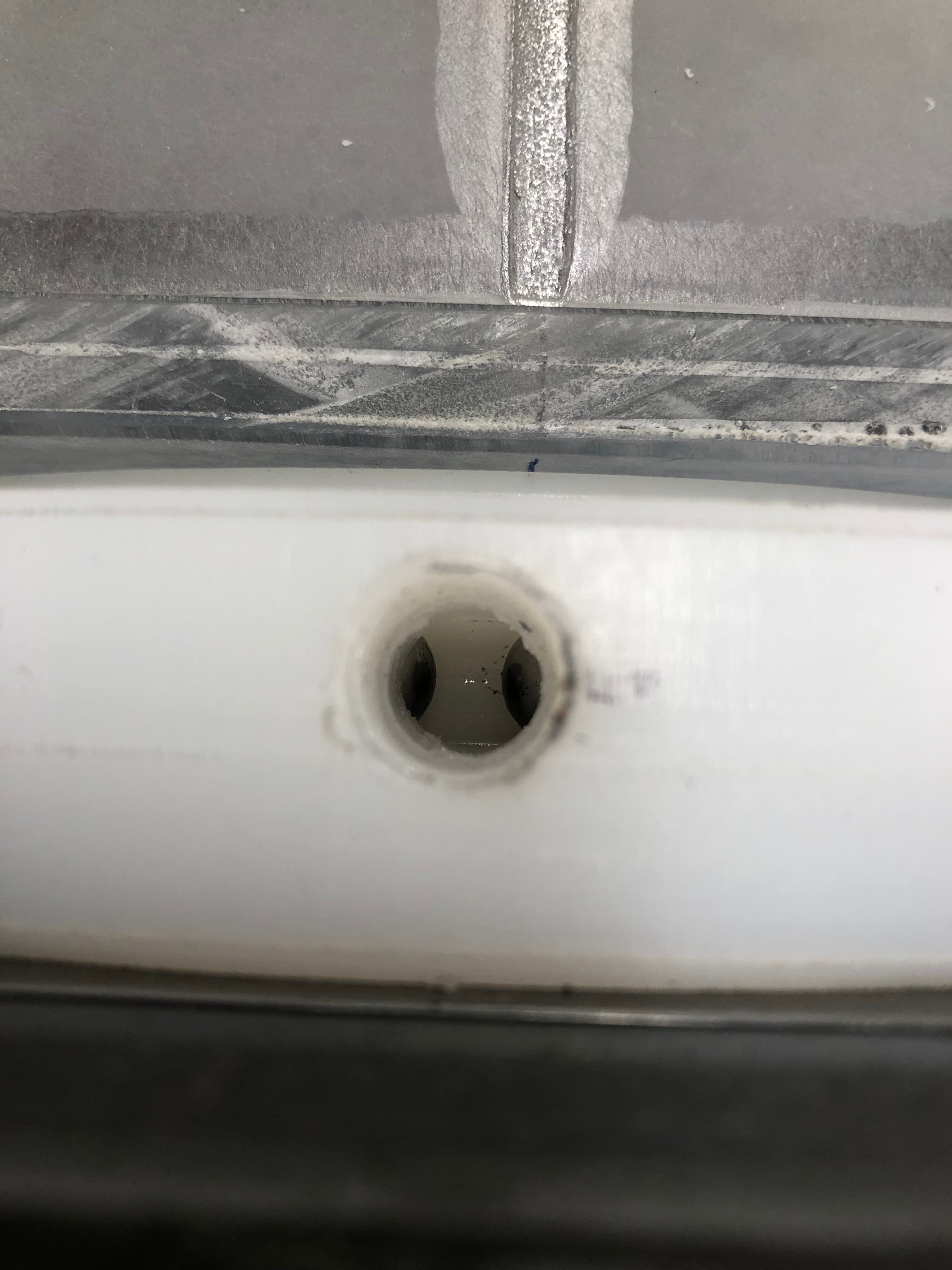

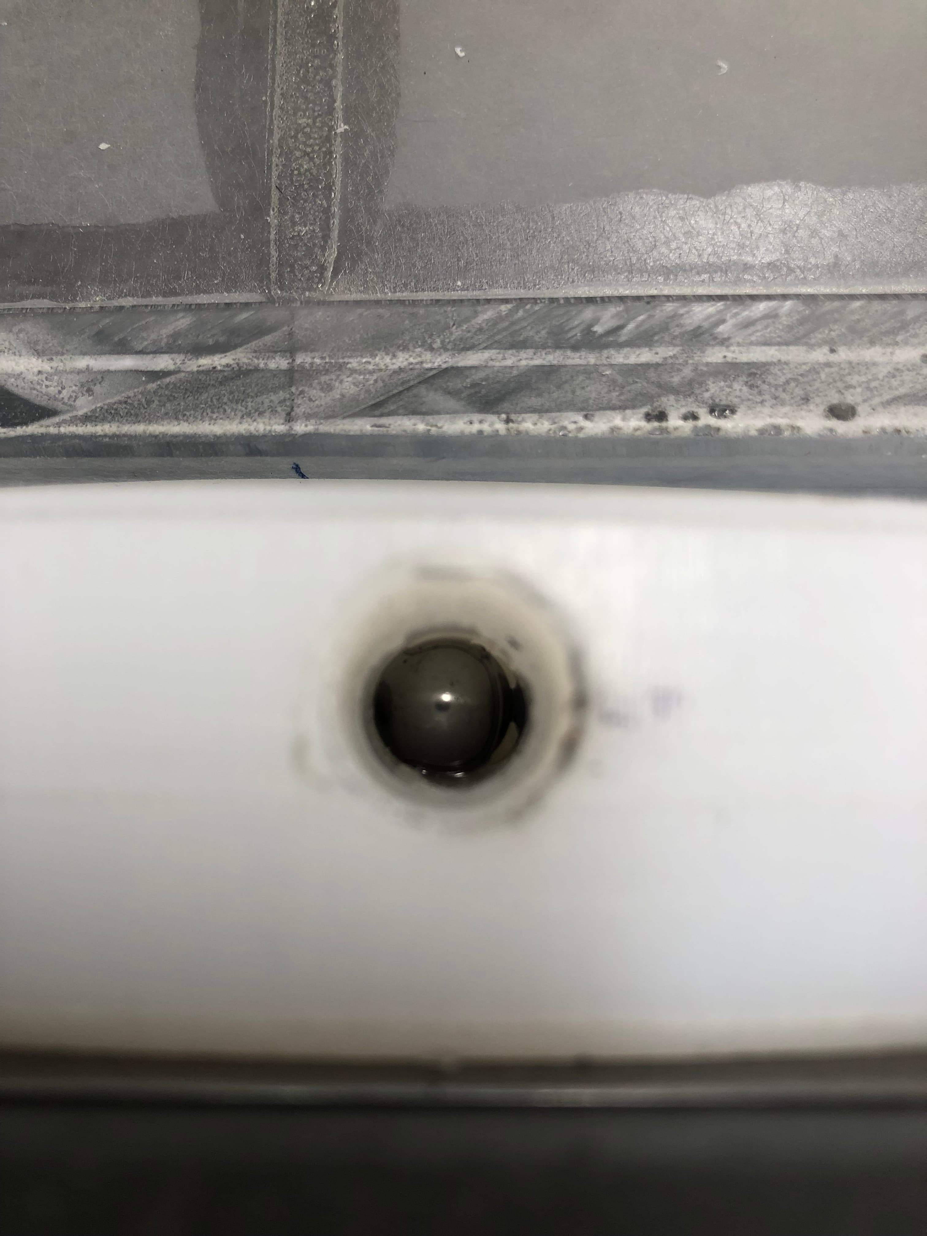

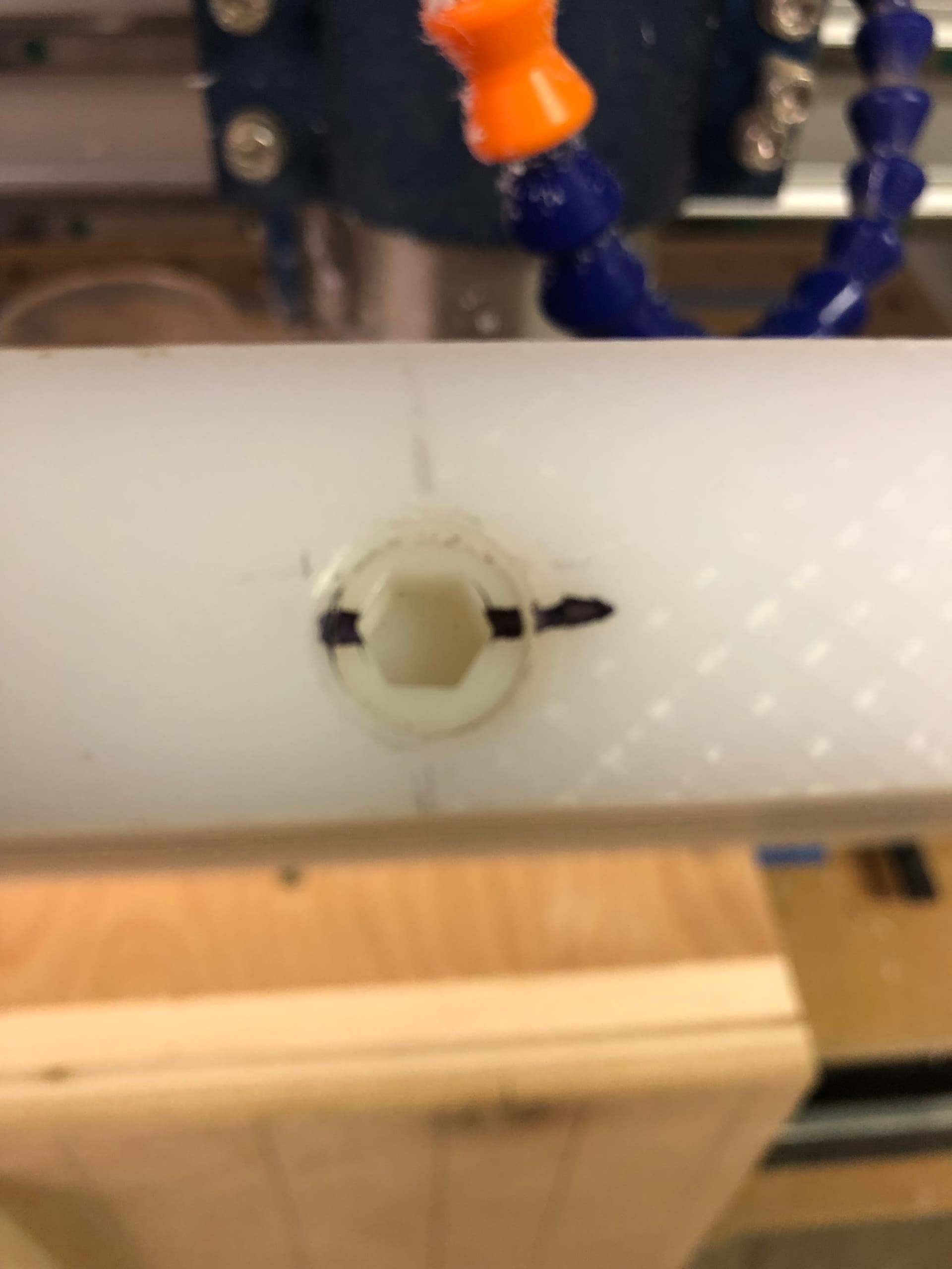

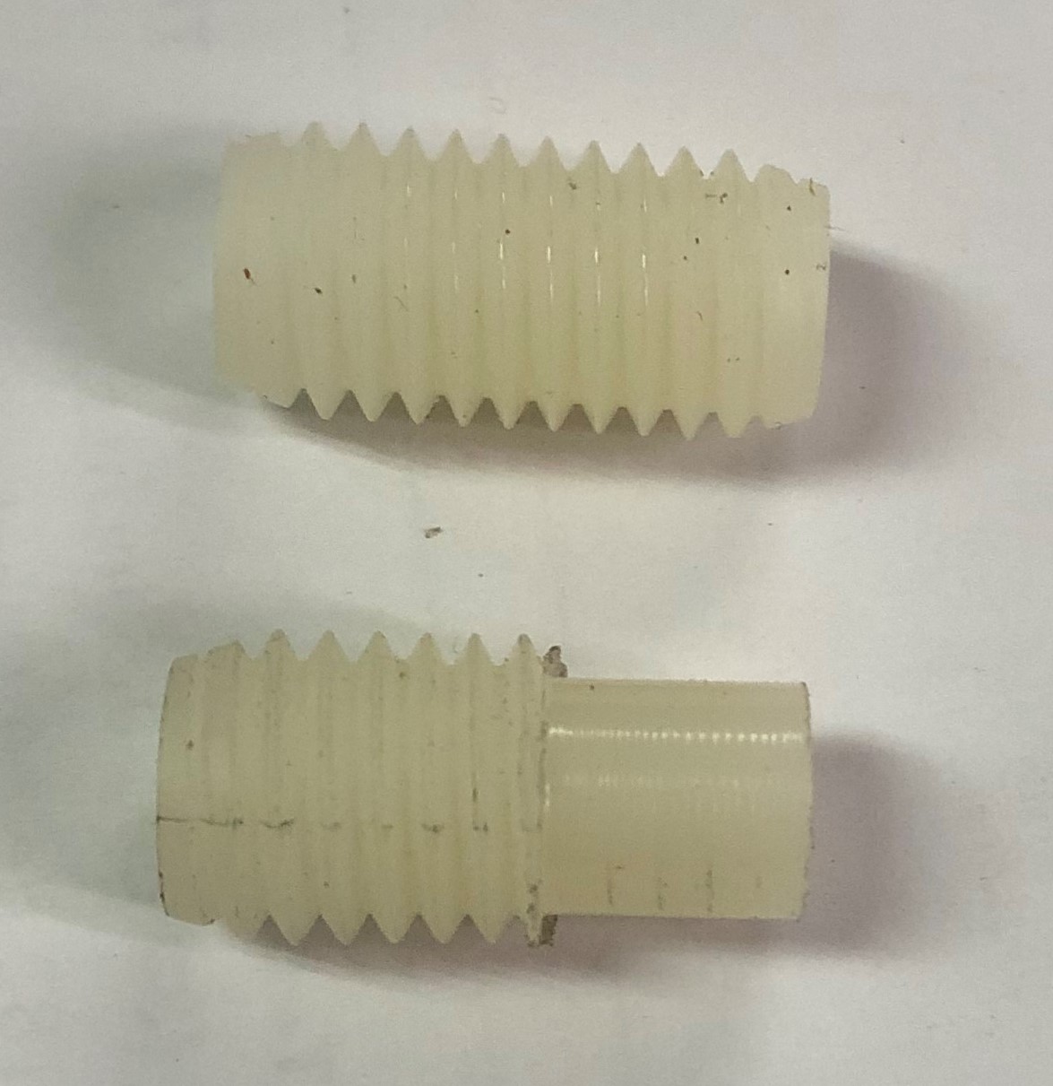

Plug
Not done on the S3 but need before continuing

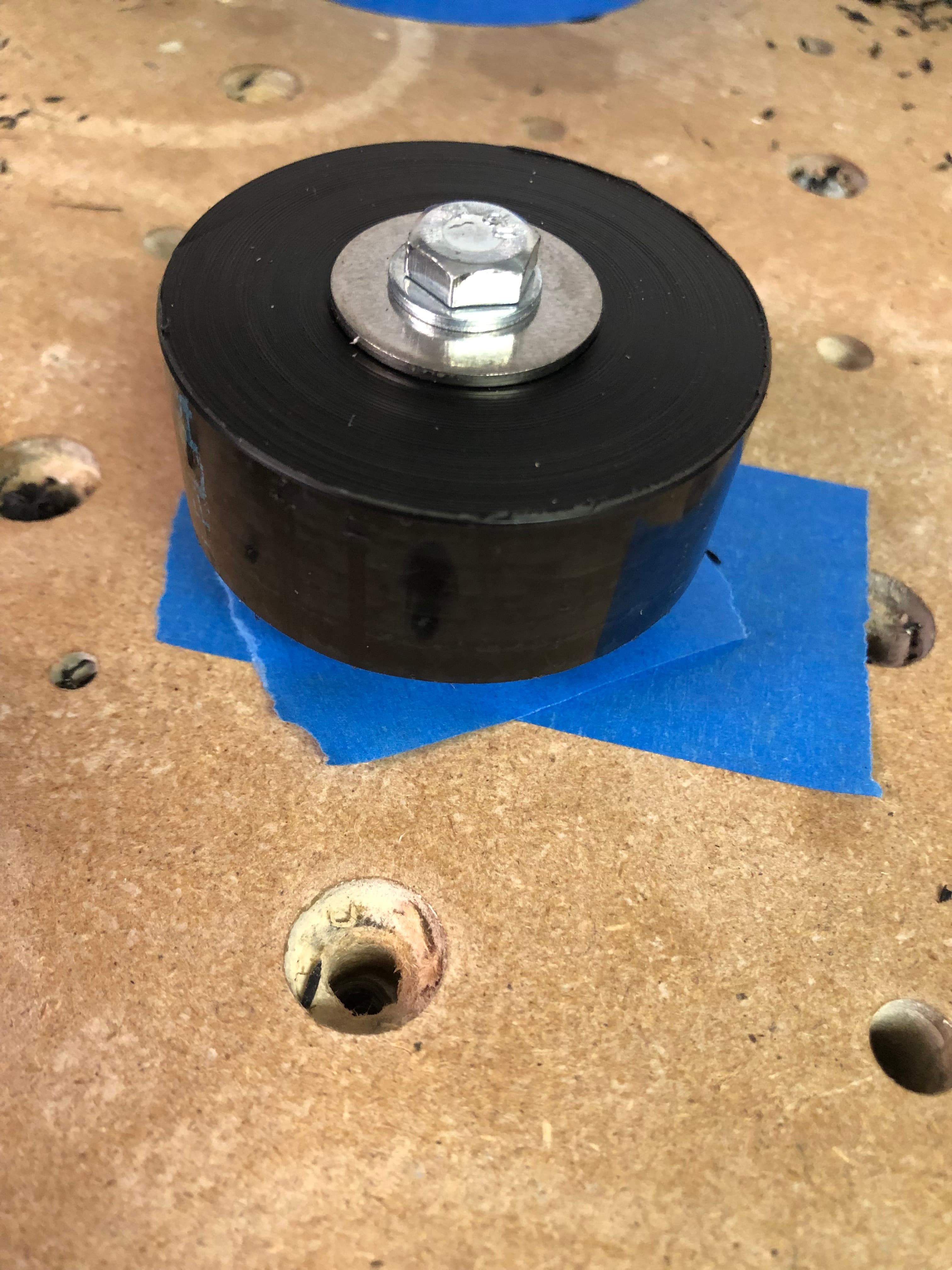

Outer Ring
1" UHMW

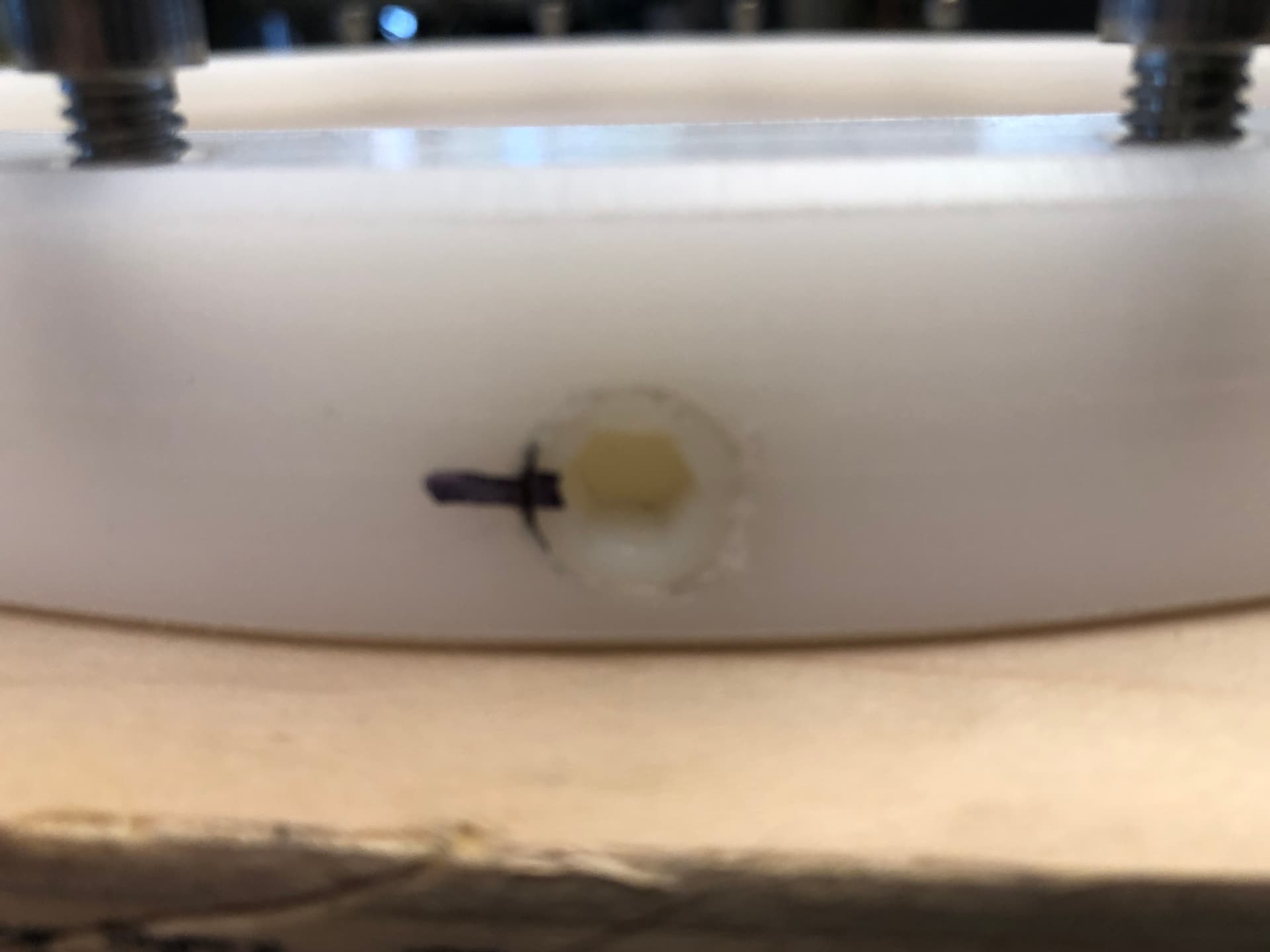

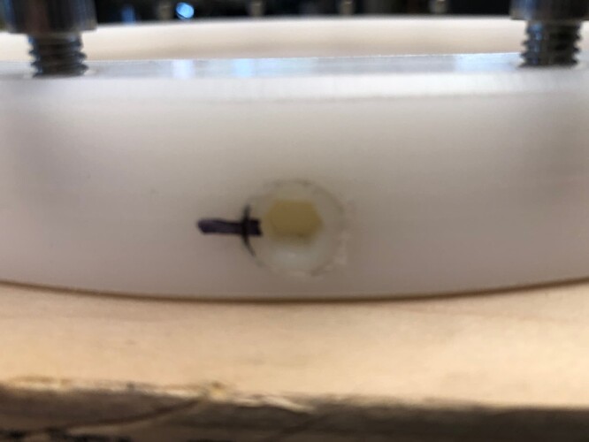

82deg chamfer, “W” drill bit and followed up with a 27/64
Plug inserted

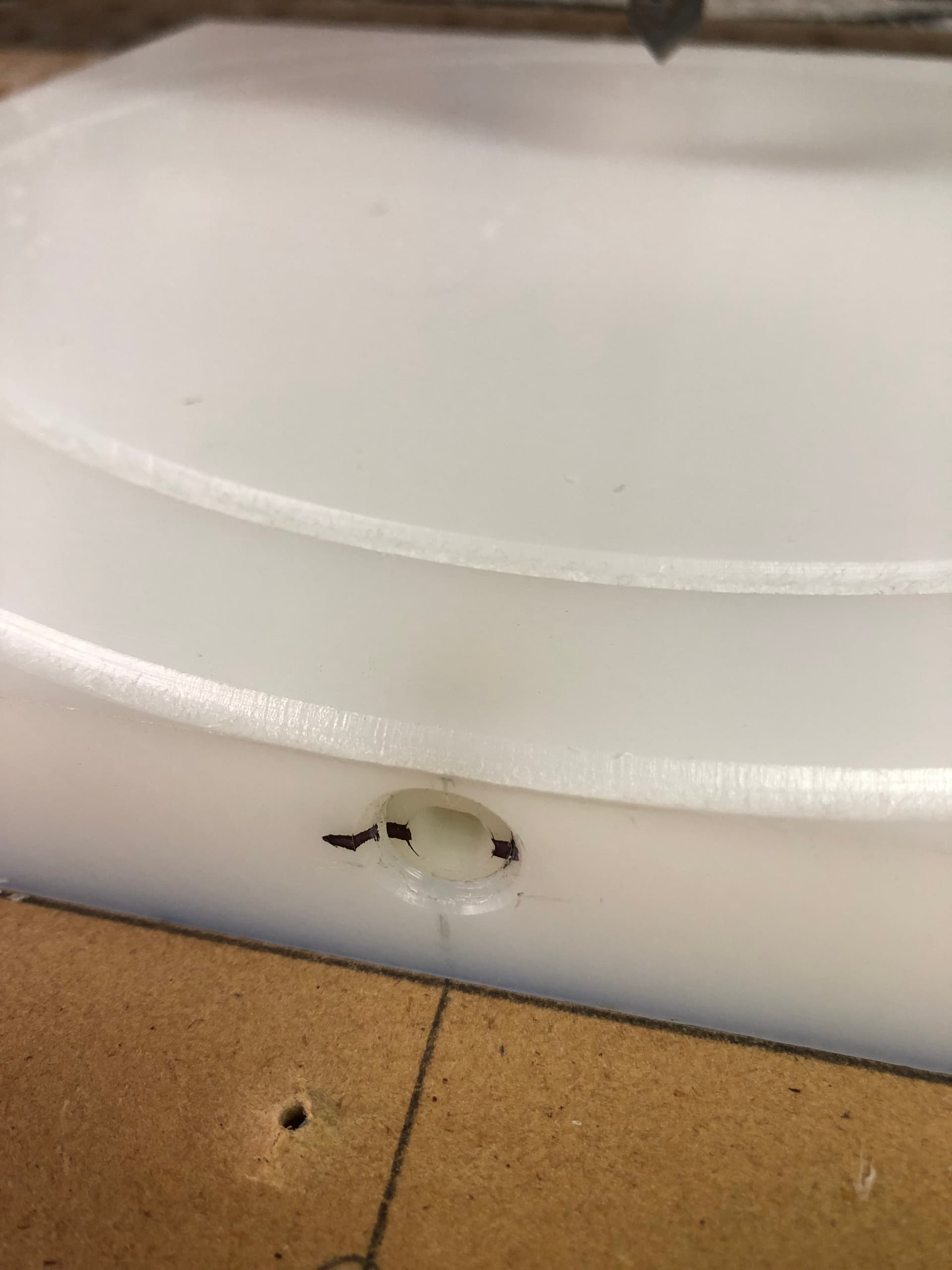

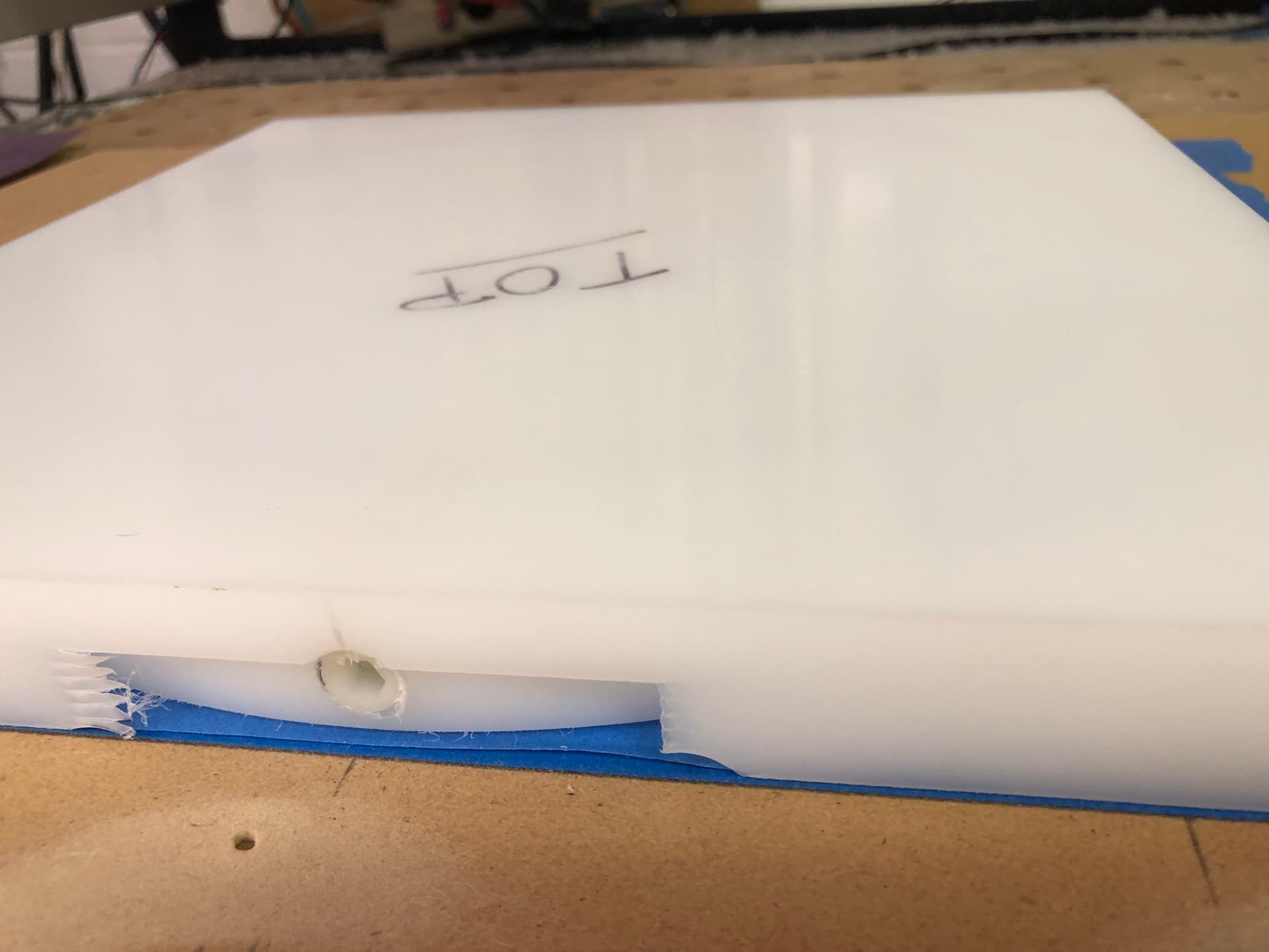

Side 2
Plug from the inside

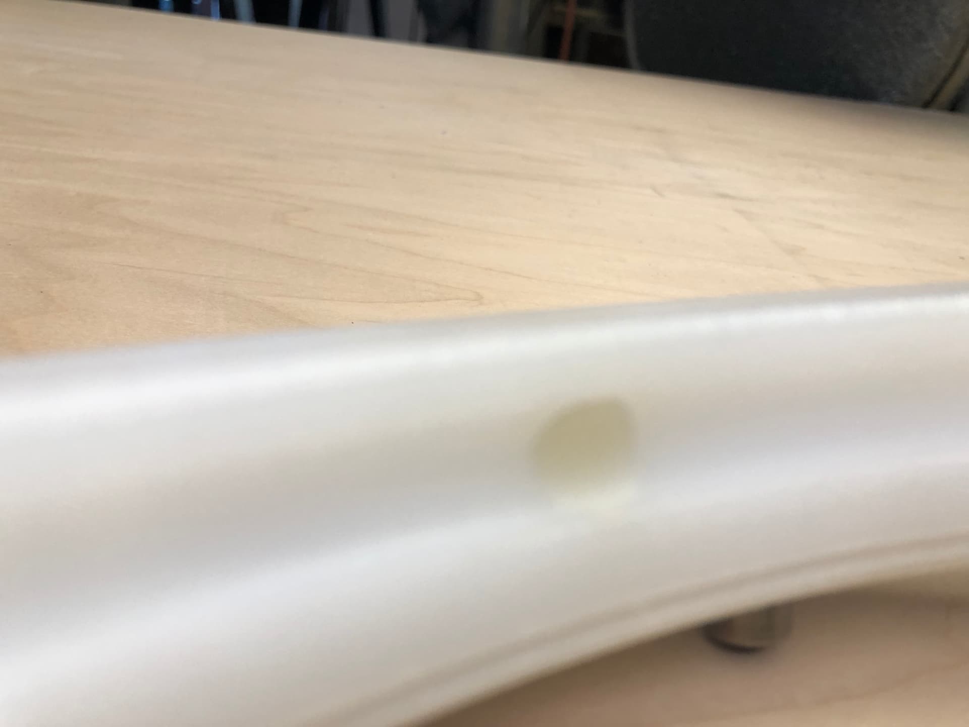

Plug after .375 canoe bit
cleaned up

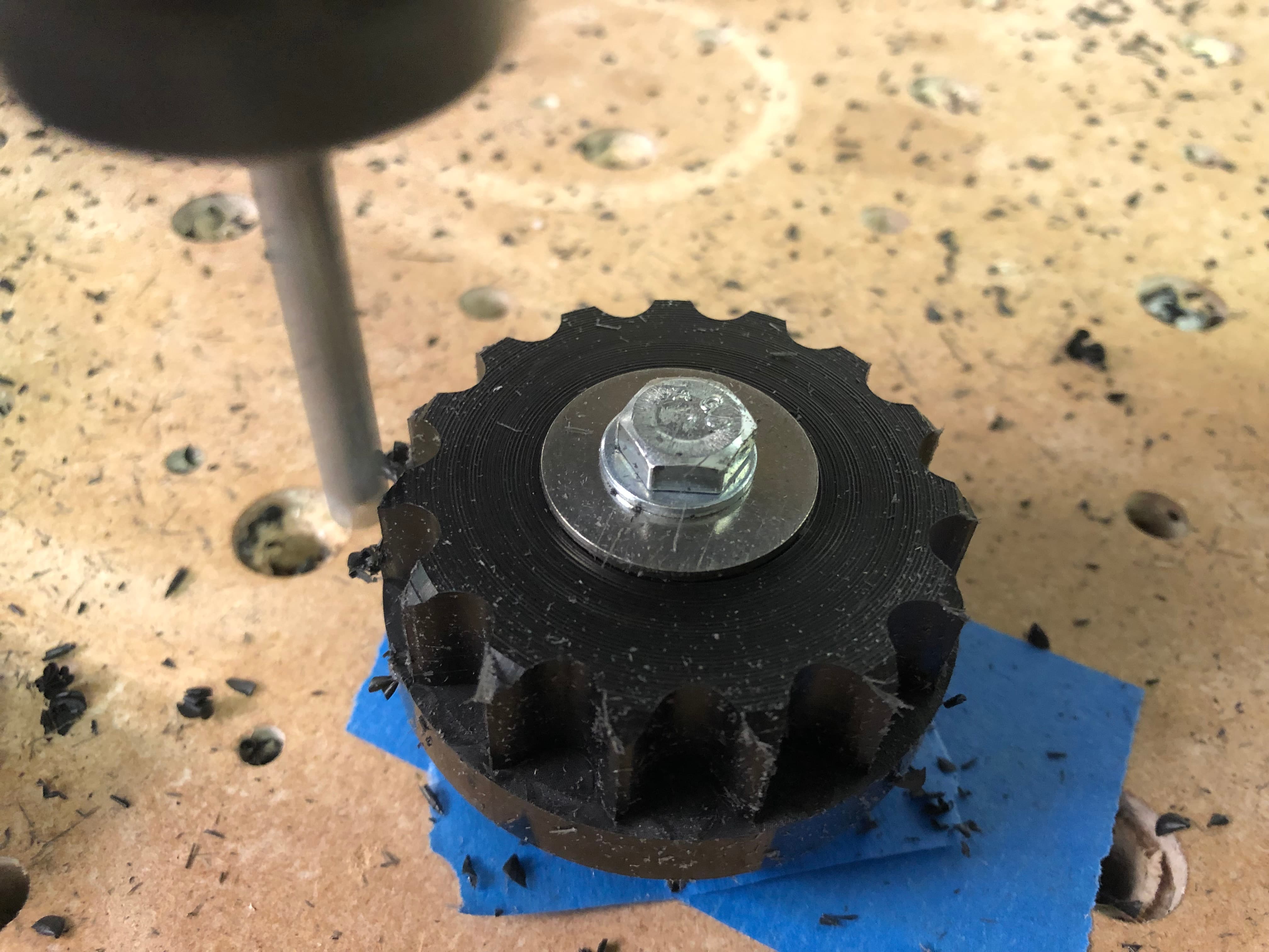

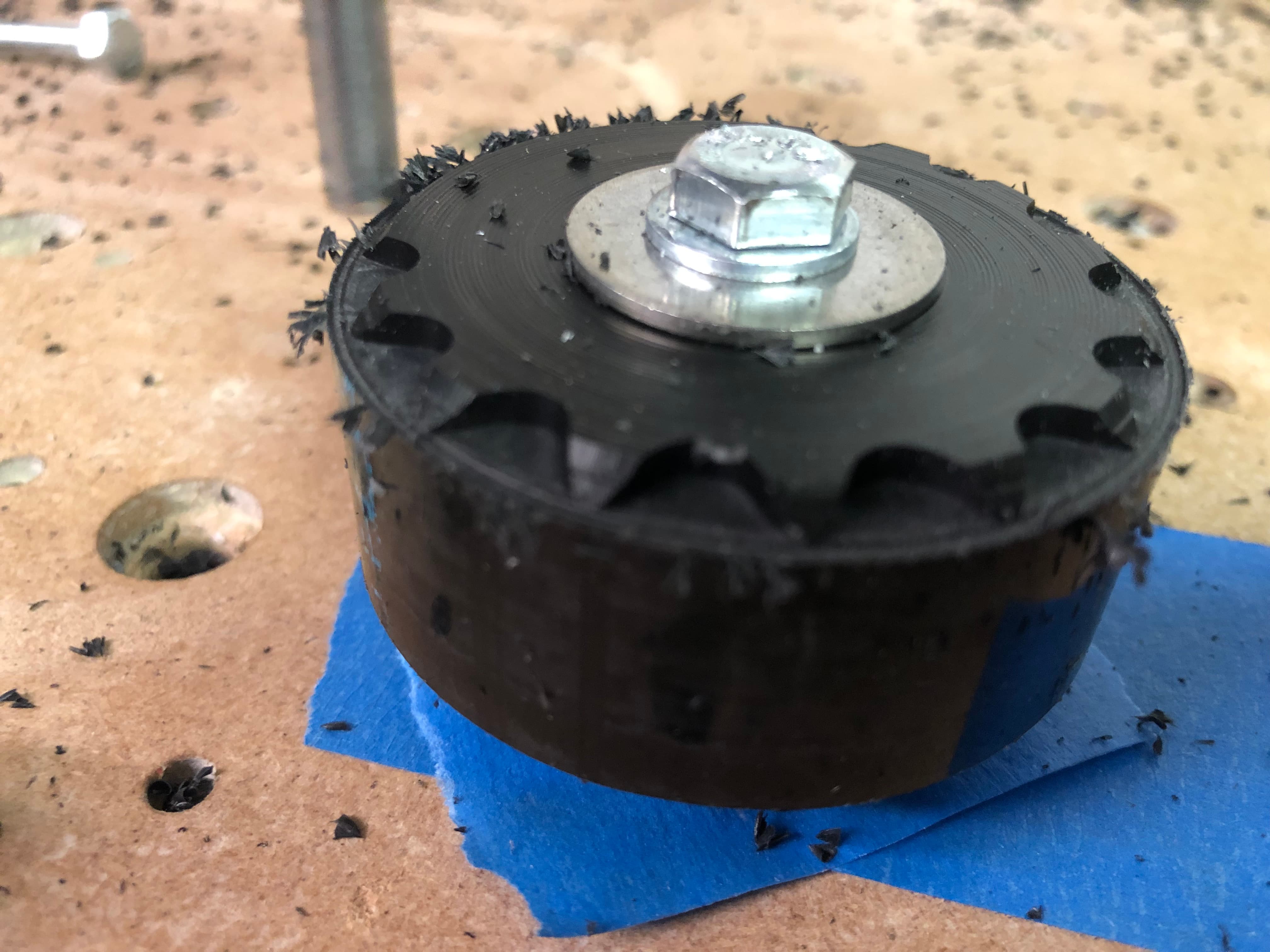

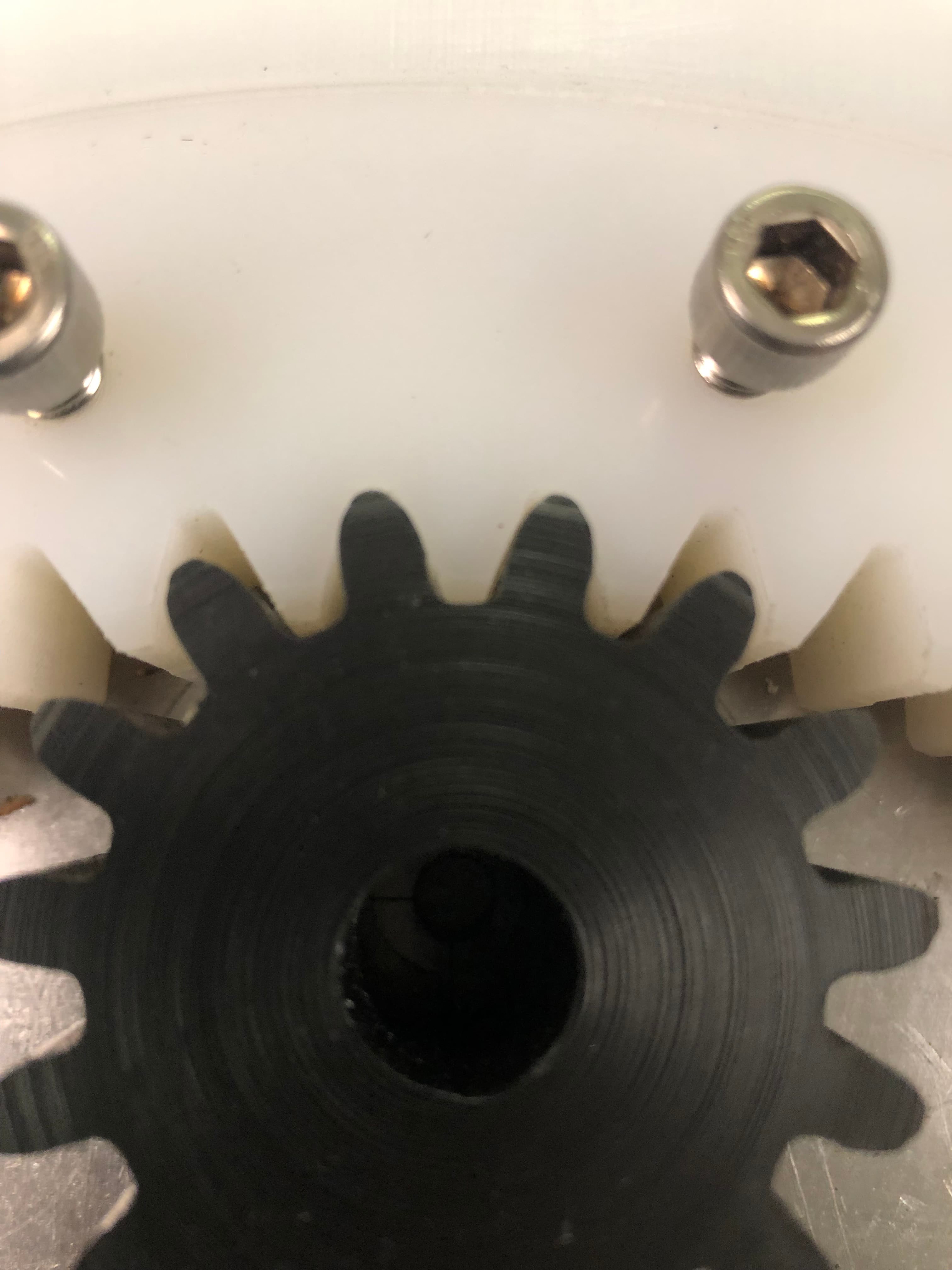

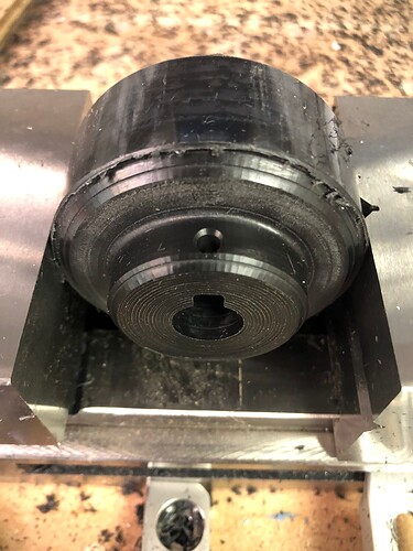

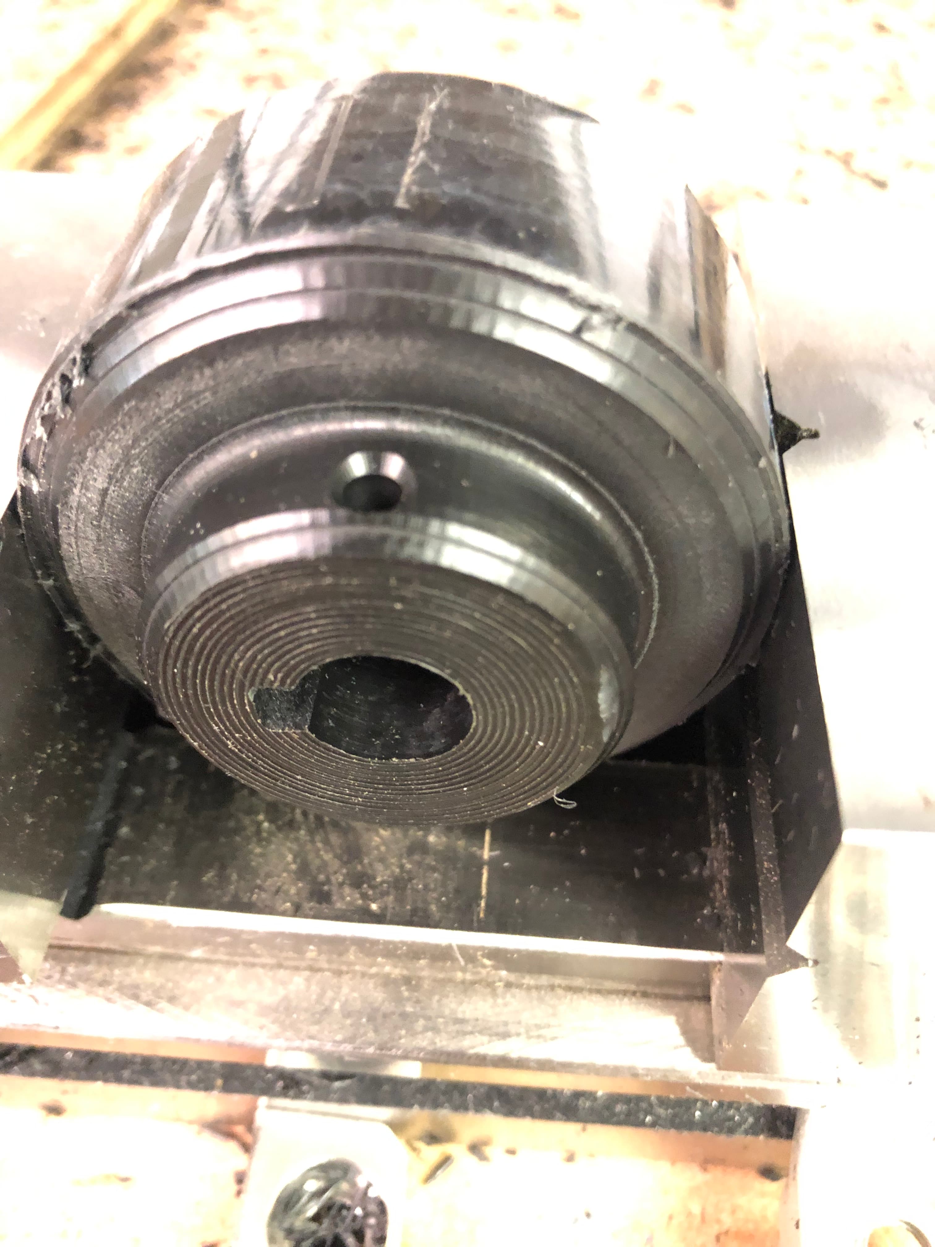

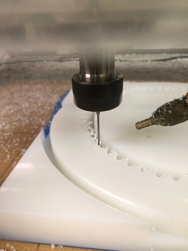

Pinion Gear
1.5" UHMW rod
Not enough meat to grab onto with the vise. Popped out a few times while tightening.

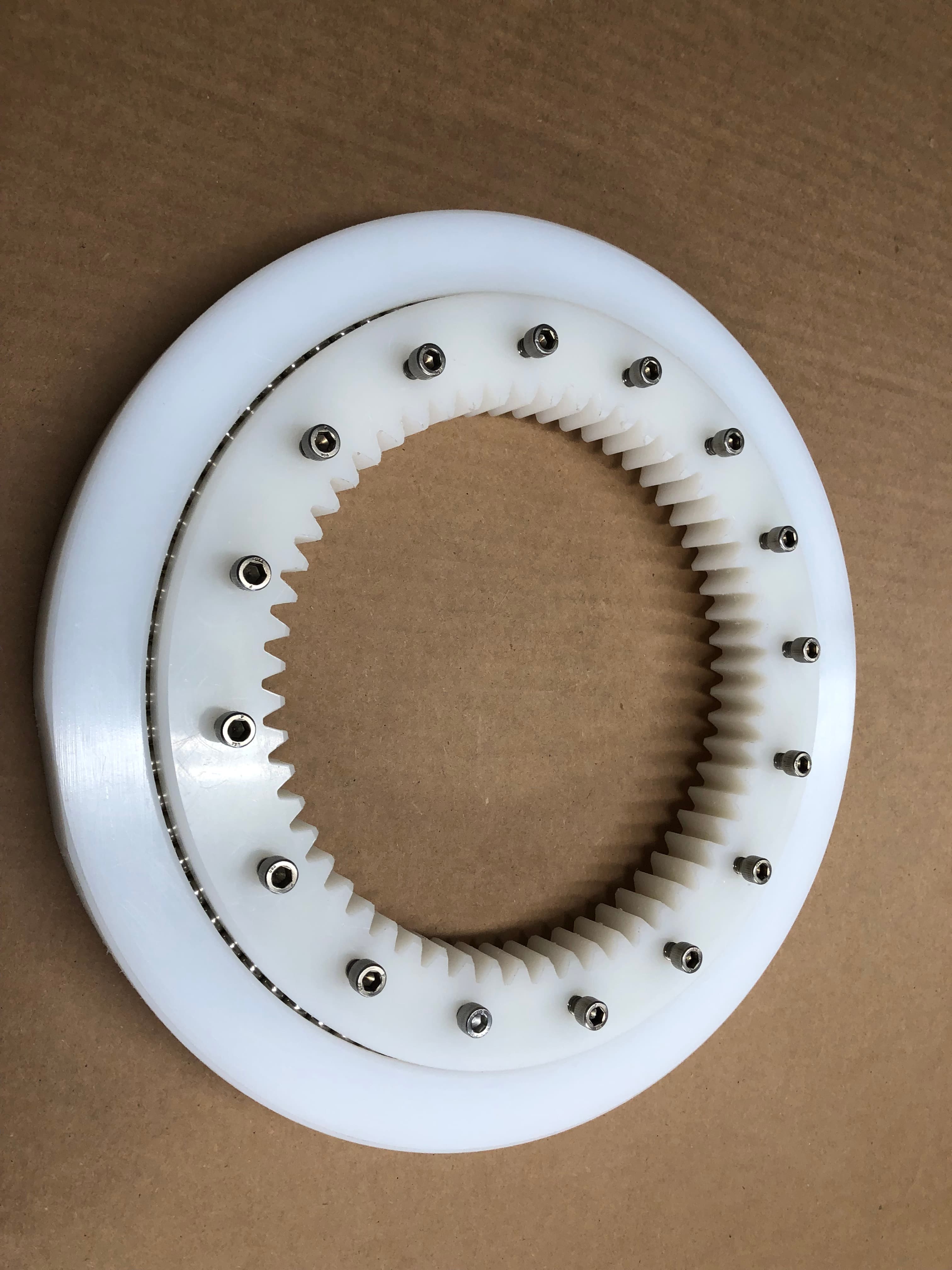

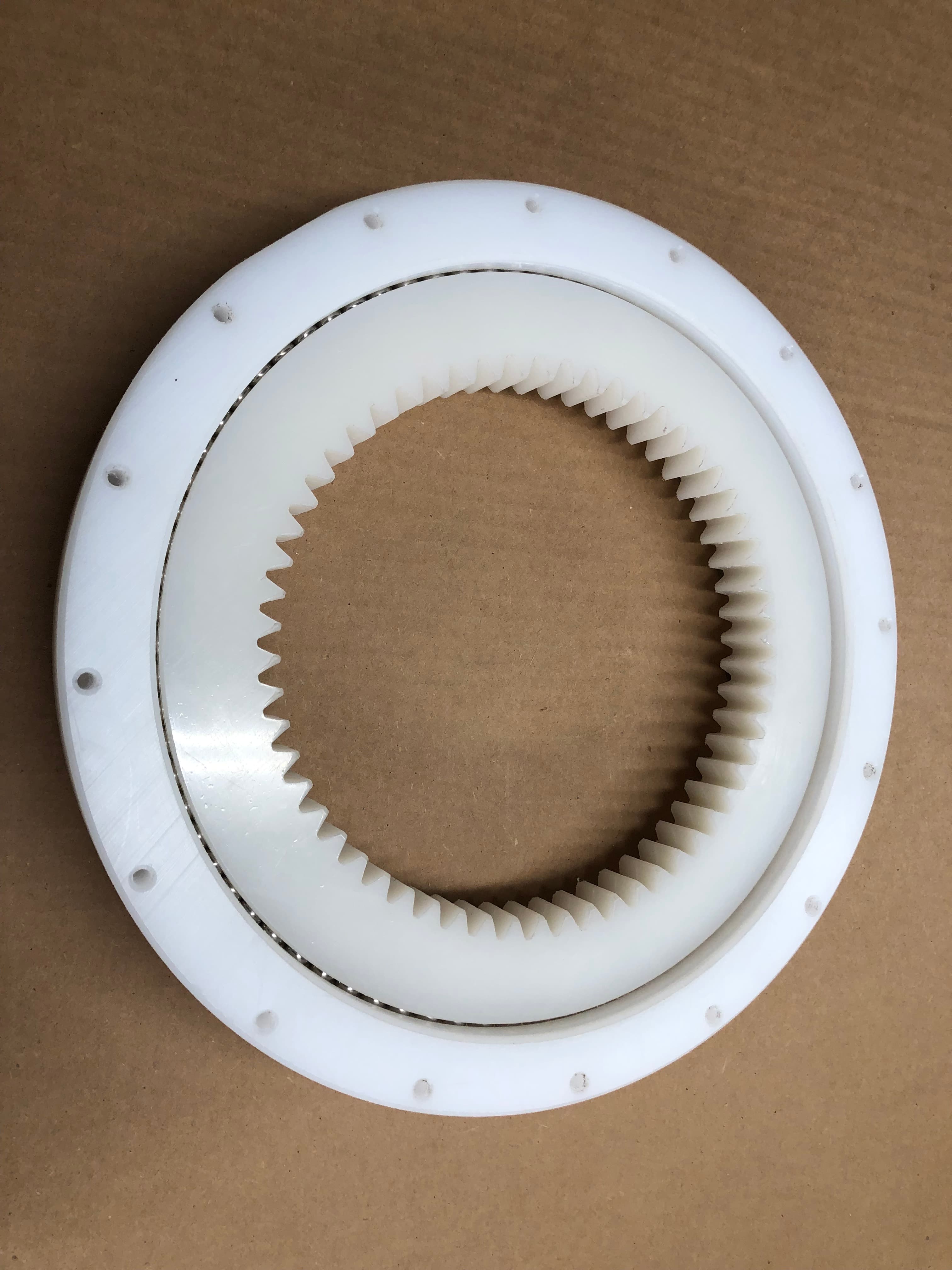

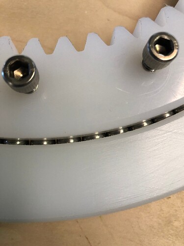

Assembly
78 - 0.375" ball bearings
Modeling all the parts took 4-5 hours
CAM was the pain - 18-20 hours - plus I went over everything 10x
Machine Time
Inner Ring w/Gear - 5.5 hours
Outer Ring - 4 hours
Pinion - 3 hours
Plug - 0.5 hour
When I started this I wasn’t sure how it was going to turn out, I thought the ball bearings would be too tight or worse, loose. I couldn’t be happier with the results or my machine.
