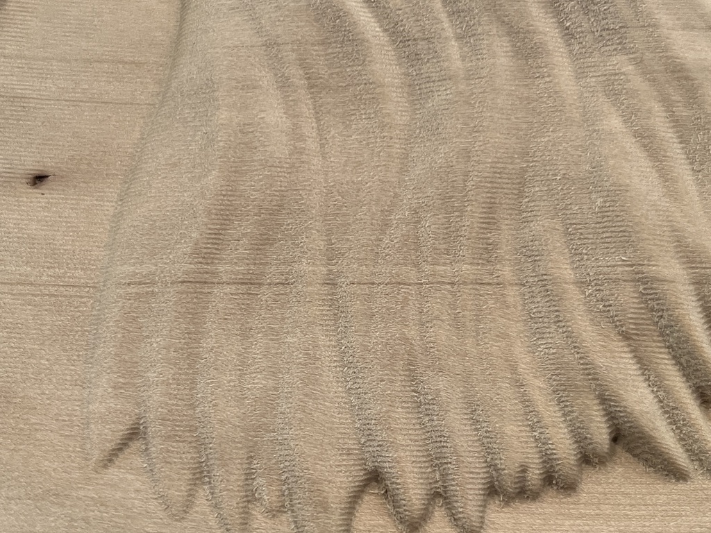

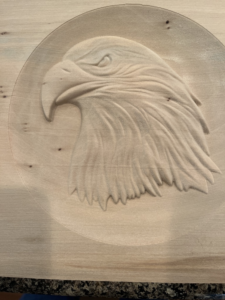

I’m running VCarve Pro to Carbide motion on a Shapeoko 5 Pro. I love this machine, HOWEVER, I get very small changes in Z height while the carving is in process. Usually after several passes the Z height return to the proper level. This could happen again - maybe, maybe not. This occurs when flattening, stock removal, or during a 3D carve (2 images attached).
2 images - one is a large view and you can see this occurred

Thank you for the responses. I check all wiring & harnesses for any discoloration or signs of heated conditions, tightened every last bolt, screw, etc… and did a full maintenance of the machine. I then ran a test and got ZERO changes in height. I will watch and see if this occurs again and maybe I can narrow down the ultimate issue.
Please note that poor connector connections do not always give a visible indicator. The connectors are susceptible to vibrations during machine use & different vibrations can cause sudden intermittent loss of steps in a connector that is just barely making proper contacts. You can easily check your stepper motor connectors for issue by simply jogging an axis & then fiddling/gently flexing/stressing the connector a bit while it’s in motion. If the stepper stops/grinds/reverses from just slight stress on the connector, then it’s most likely causing lost steps during operations when vibrations or a dust colleciton hose hits it. Some users have found that zip-tieing the 2-sides of the connector together works. But securing the connectors in positions that protects them from being strained in any way during operation is adviseable.
Folks -
I believe I found the problem. The placement of my dust hose! During a carve, I watch the dust hose follow insync with the spindle, not touching or interfering. Twice the hose appeared to cause a slight drag to the Z axis. When all was finished, that was where 2 inconsistencies were on the flay bottom. I removed the hose and left the Sweepy - perfect!! Ran 2 more jobs - perfect!!
Now to figure our a new, improved vacuum hose plan.
