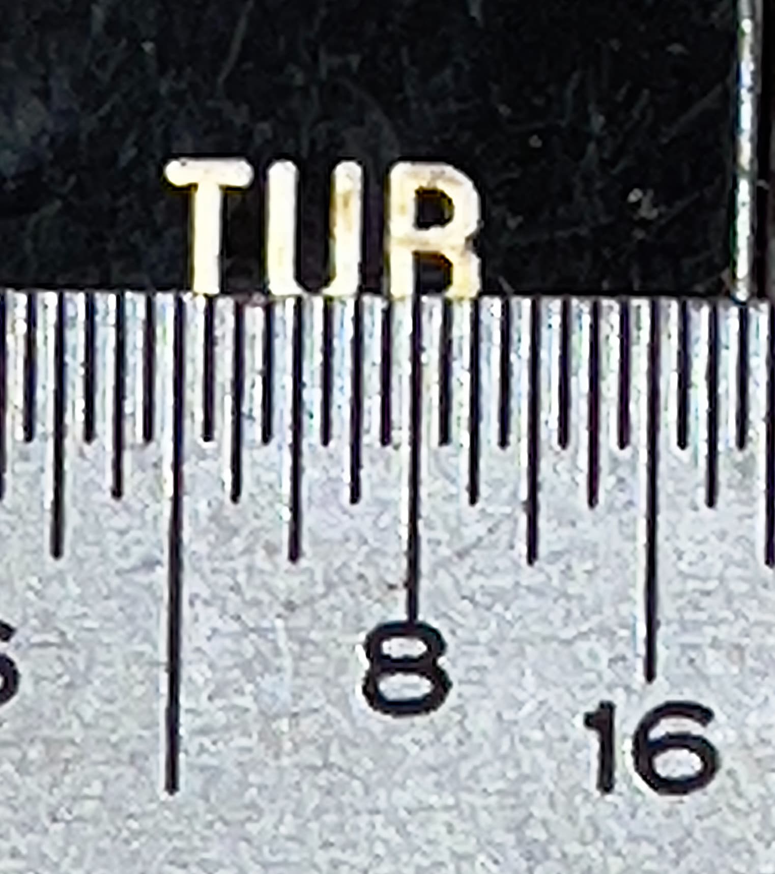

I have an 3 decade old smart lighting system with low voltage keypads instead of normal switches. The company is long out of business, but I can reprogram the software and have bought parts on ebay to not just keep it going, but to modify/expand the system.
My problem is that I need new button labels. Here’s what one of the original buttons looks like:
That’s a decent Shinwa ruler above it, with markings every half mm. So the lettering is about 0.37mm thick and about 2.1mm high.
I secured several blank buttons, which are black through and through. What’s the best way for me to engrave those buttons with lettering that matches fairly closely?

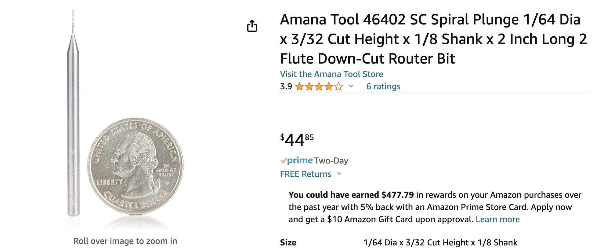

A 1/64" bit is going to be 0.397mm, just a smidge bigger than your 0.37.
I think I would go with a good downcut Vee bit.

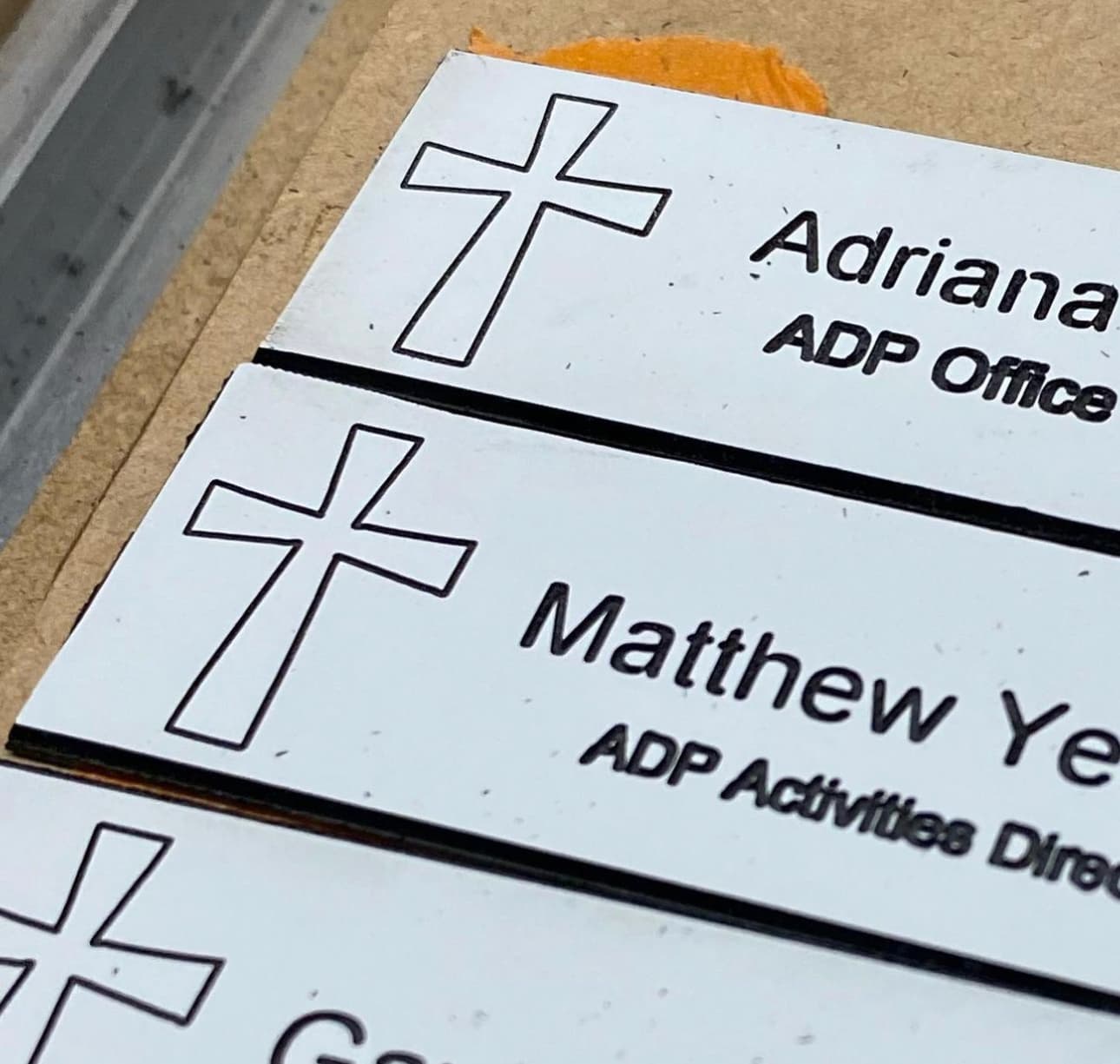

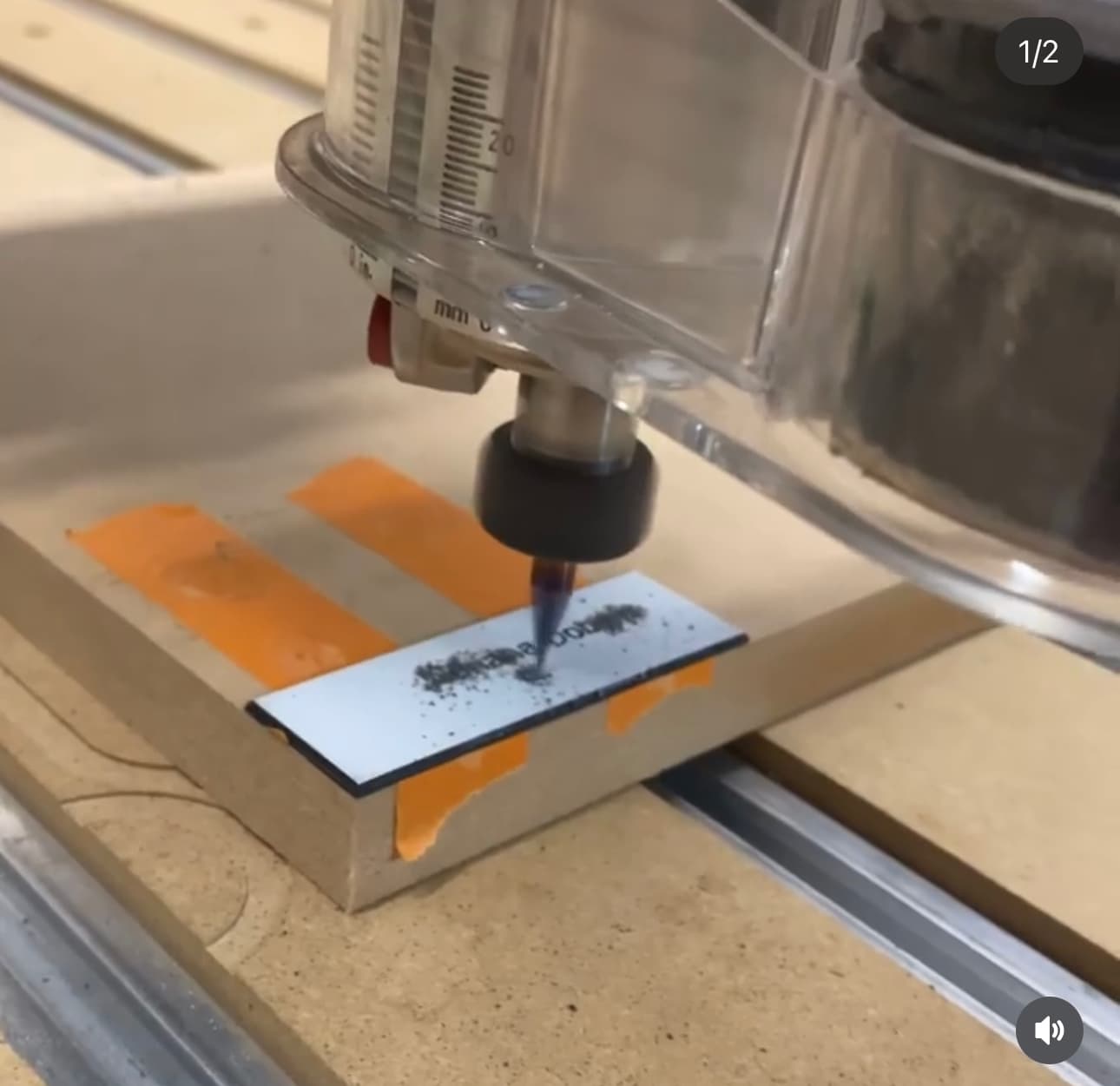

I’ve done a similar type of project, engraving name tags for a local church. Maybe not as small but pretty close. I initially used a .015 endmill like you posted but found it way to fragile. I ended up using a 30 degree engraving bit.
I’m with @brentgrizzle . Even a 1/16" bit is fragile at least once. You’ll need more than one.
I’ve used a 30° Engraving bit just for that purpose. Works fine.

I couldn’t find a ball tip with a small enough (1/64") tip. Does anyone have a source? I ordered the 20º bit since it was pretty cheap and I’ll see how that goes.
Thanks for all the suggestions on doing the infill. Going to try a couple different ones on some spare buttons I have.
I don’t believe you need 1/64, Amana makes a 1/32. Beware if it’s Prime or not as some companies don’t take returns on 1/32 and smaller because they break.
