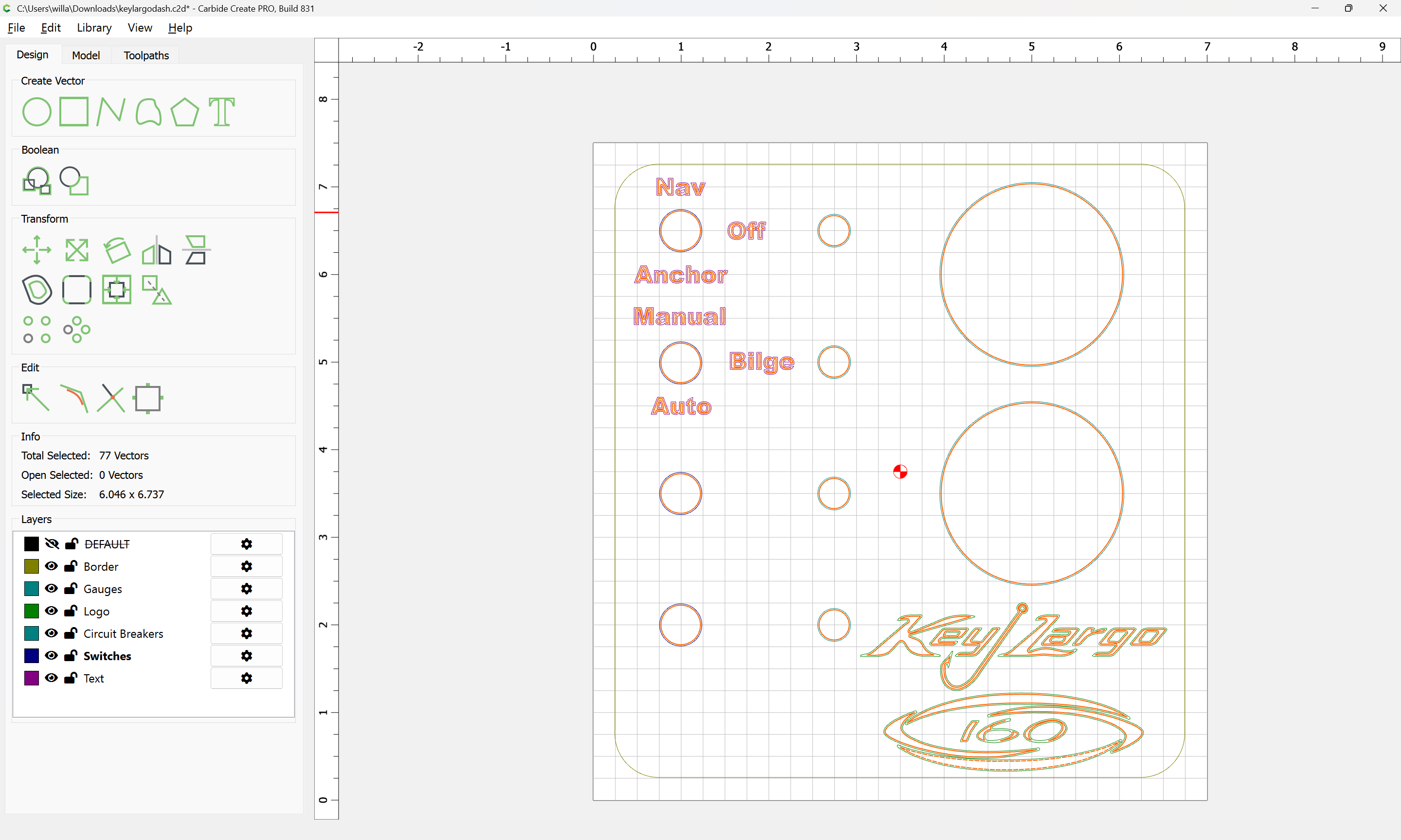

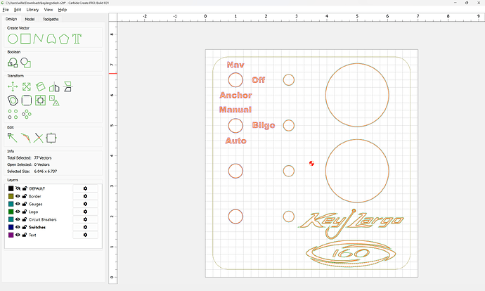

Also the use of layers due to the different size bits and depths.

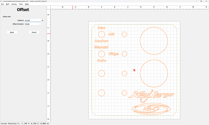

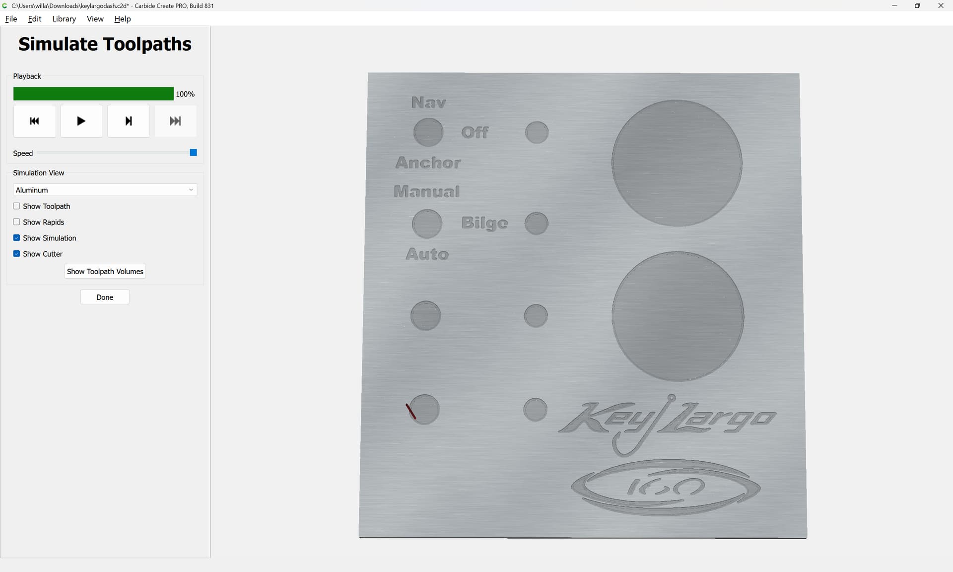

Here is the file for the current project. I was trying different things to solve the text issue so it’s not turn key.

Also that you can change the order of the tool paths to minimize tool changes.

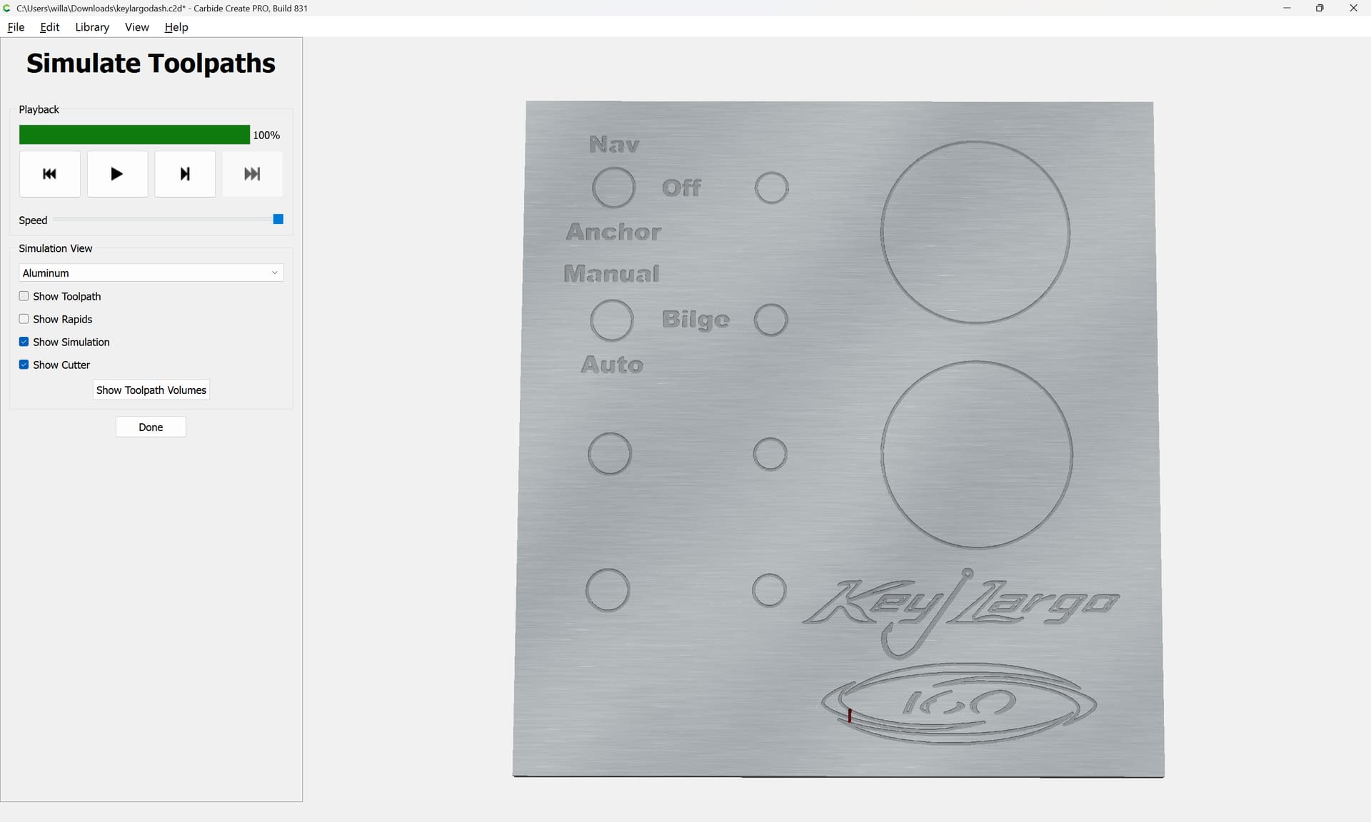

Part of what is taught and recommended is to test your files on scrap wood to dial it in prior to using the good stuff to learn on. This has saved me from producing very expensive wood for the fire pit.

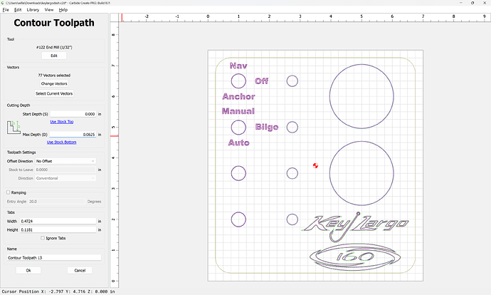

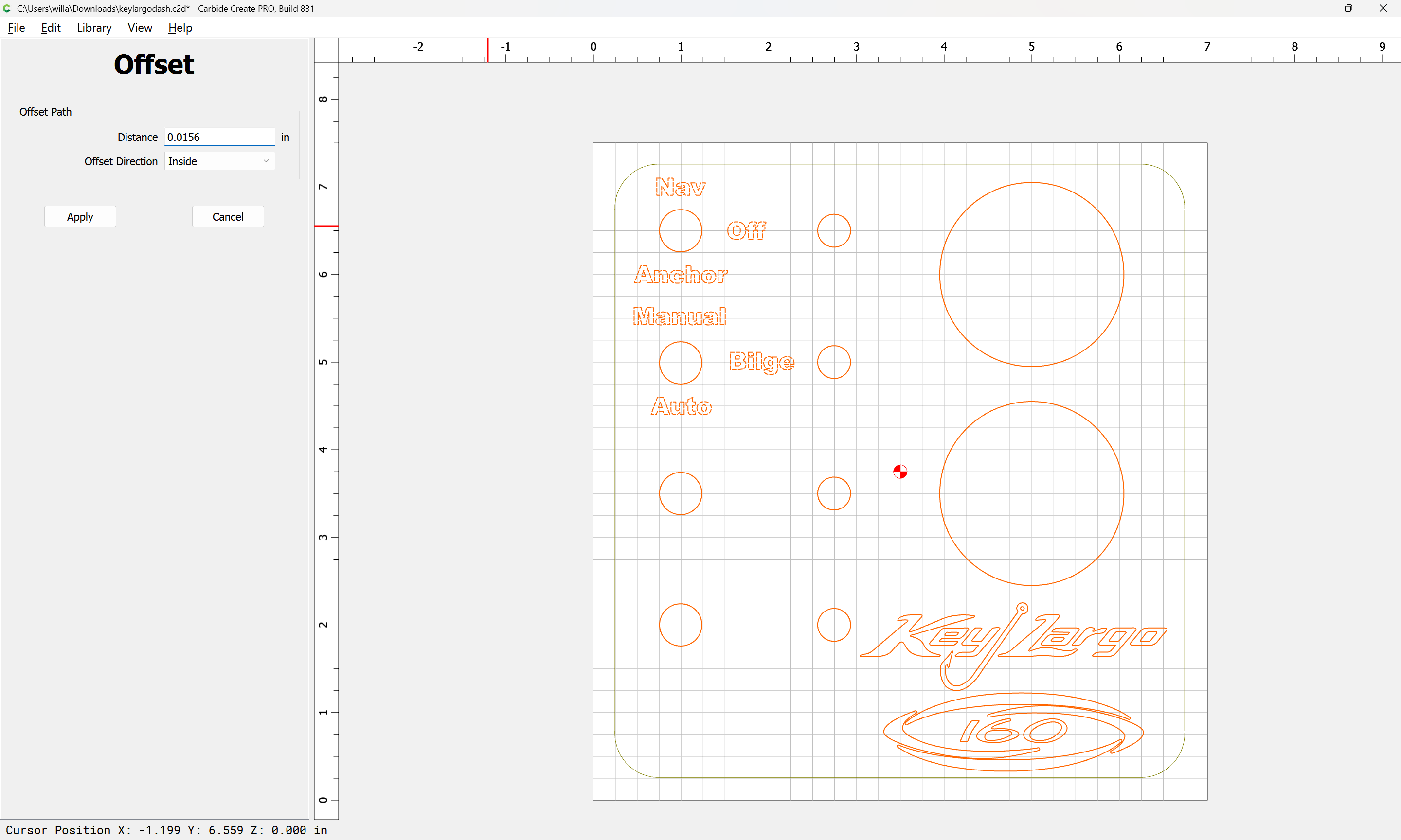

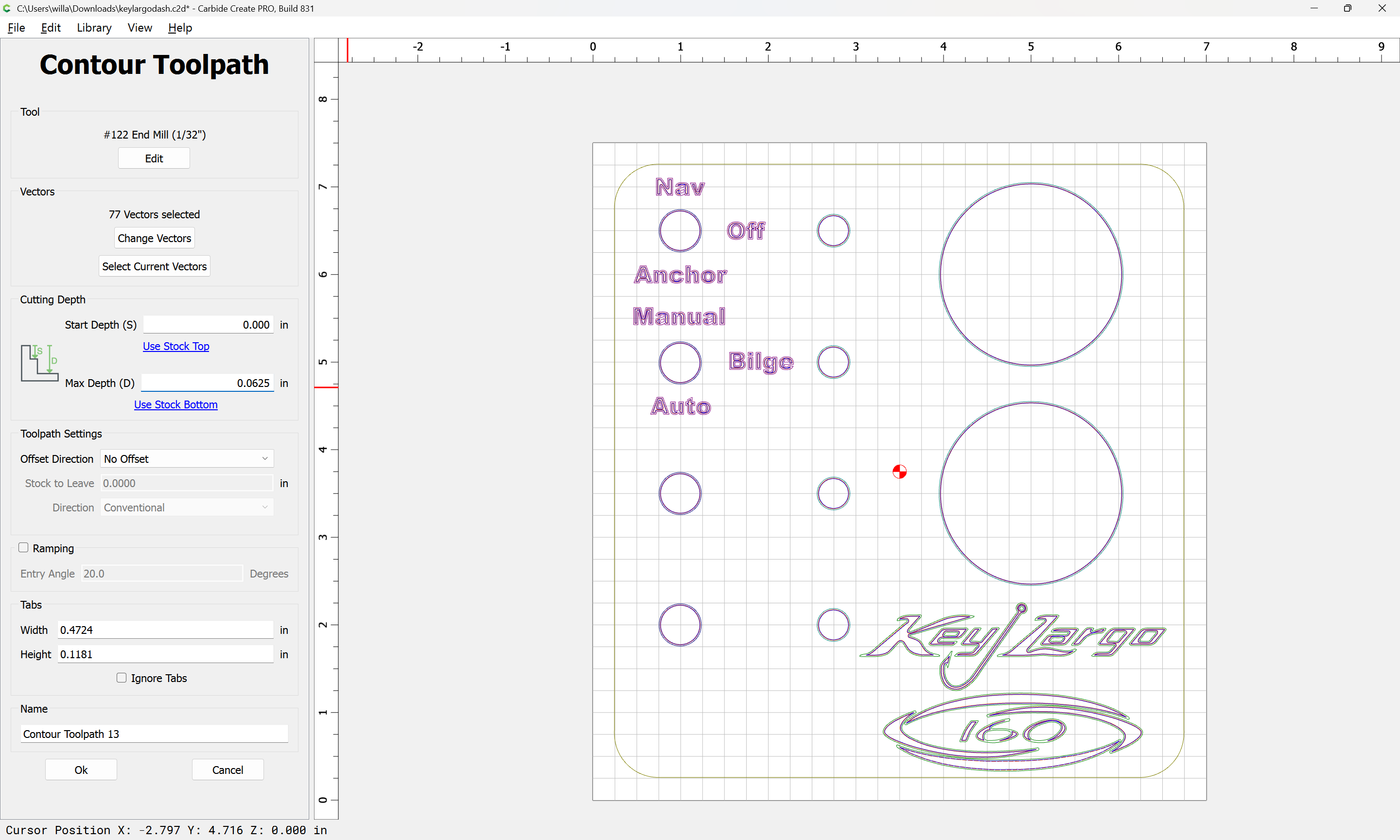

Your toolpaths are all No Offset Contour — why not do insets which are the radius of the tool? (where the tool is small enough)
Or, just do an Engraving toolpath? note that this is a Pro feature)
(note that some characters are too small for this to work with that dimension — some adjustment for them will be necessary)
adding a pocket toolpath gets one to:

If they’re all no offset, this is an earlier version.
The gauges were 2.0 so in order to cut it, it would have to be inside offset, same with the switches and circuit breaker holes. The border would be outside offset to maintain the sizing. Took awhile to learn all this. Exposure to photoshop helped a lot with the learning curve.
