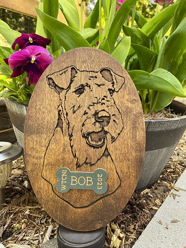

1/2" is quite large, I have has absolutely no problem with both VCarves and straight end-milling text way smaller than that.
For example, the text at the ends of this ‘dog-tag’ is about 1/4" tall, milled using a 1mm endmill.

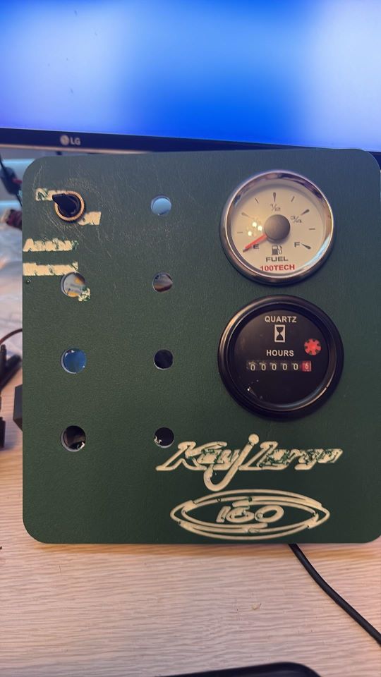

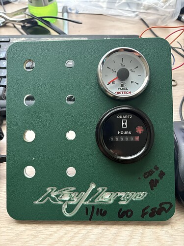

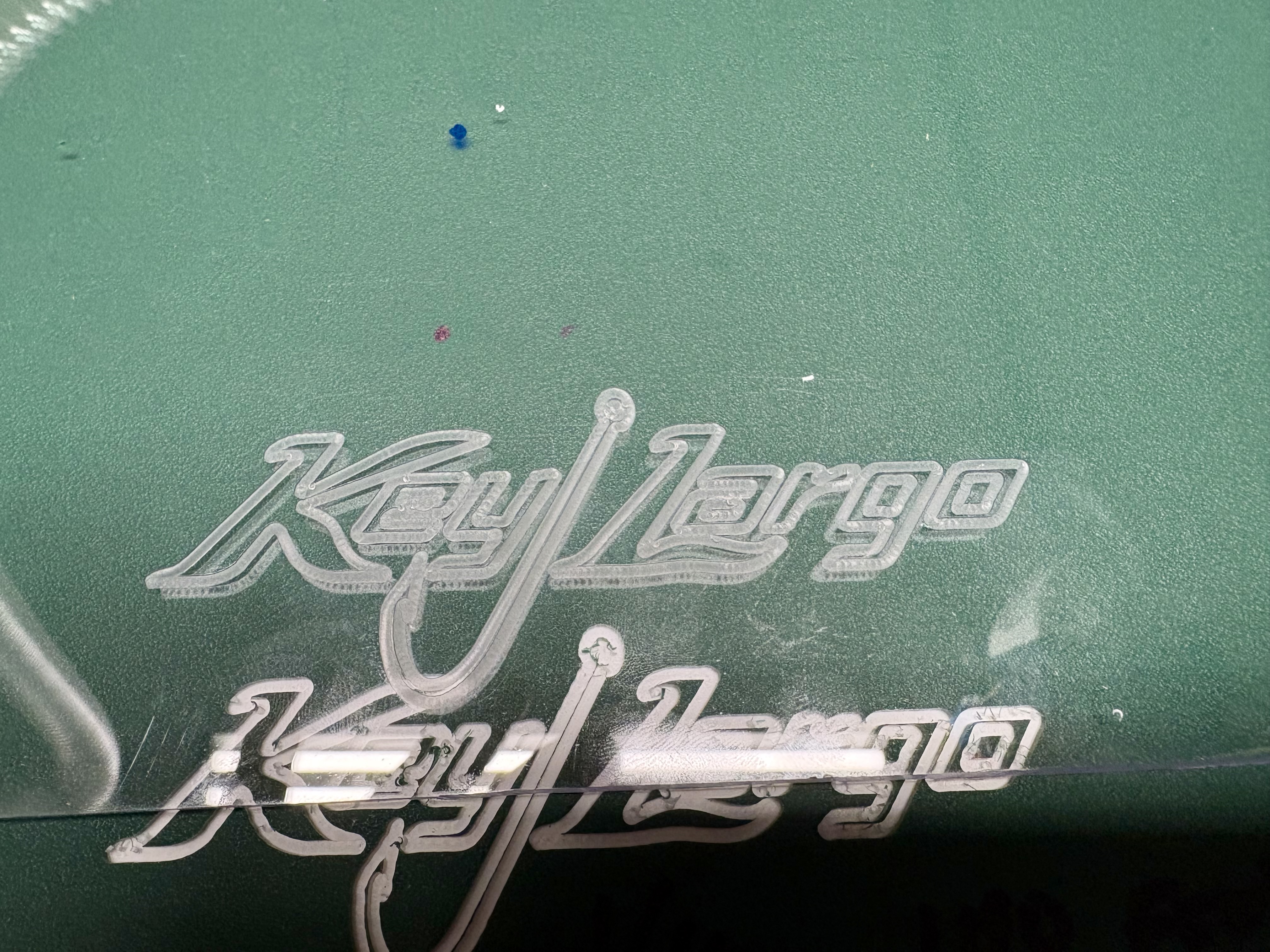

Here is a shot of the what now is just a scrap piece see the logo how it tore out? Thats with the IDC 1/16th. Ive tried 10000, 20000 etc and slow and fast nothing changes. On larger stuff like the border and the gauge cutouts it’s with a 1/8 0 flute upcut and its sharp. I moved things around as not to use a good sheet, but the top left is remnants of trying to do .3 font.

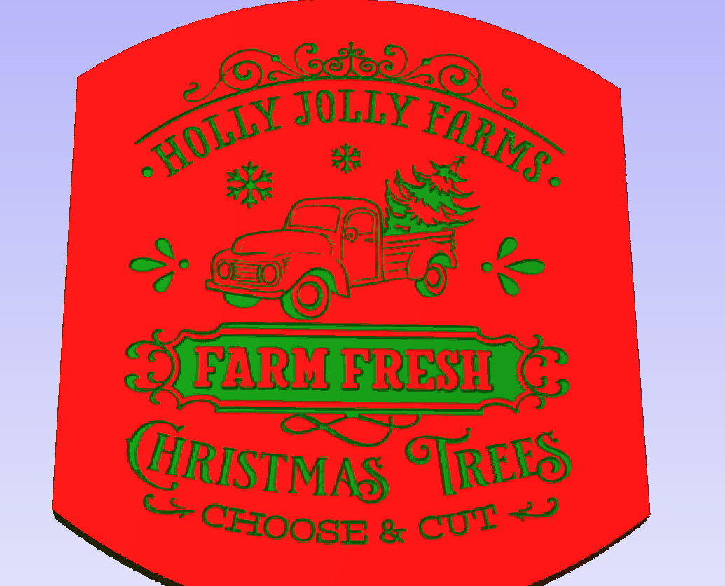

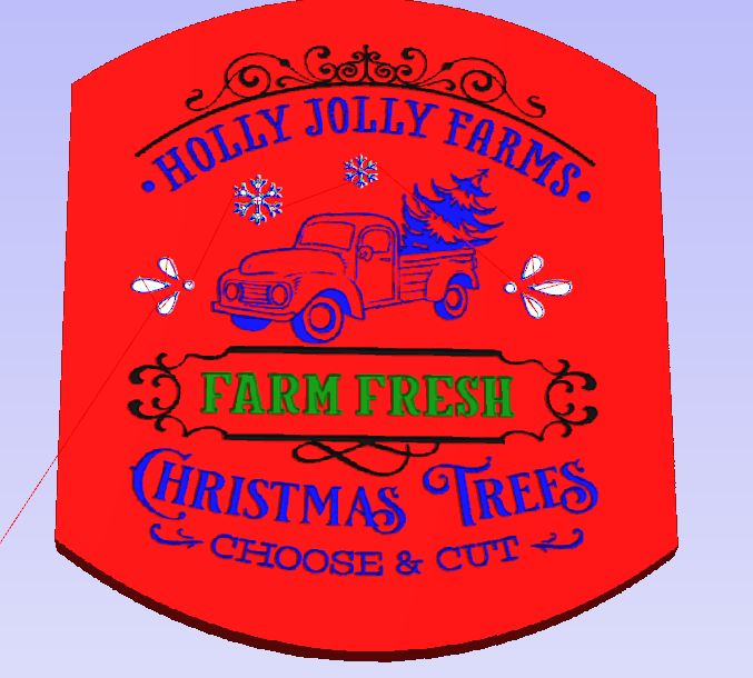

Does that match the 3D preview in Carbide Create?
The issues with the logo carve will not be resolved by different software. I would drop down to 1/32 in. zero flute if a 1/16 in. zero flute did not give a good result. I don’t see any zero flutes less than 1/8 on IDCs website so you may have to switch sources. In plastic, I have stopped using all except zero flute bits.

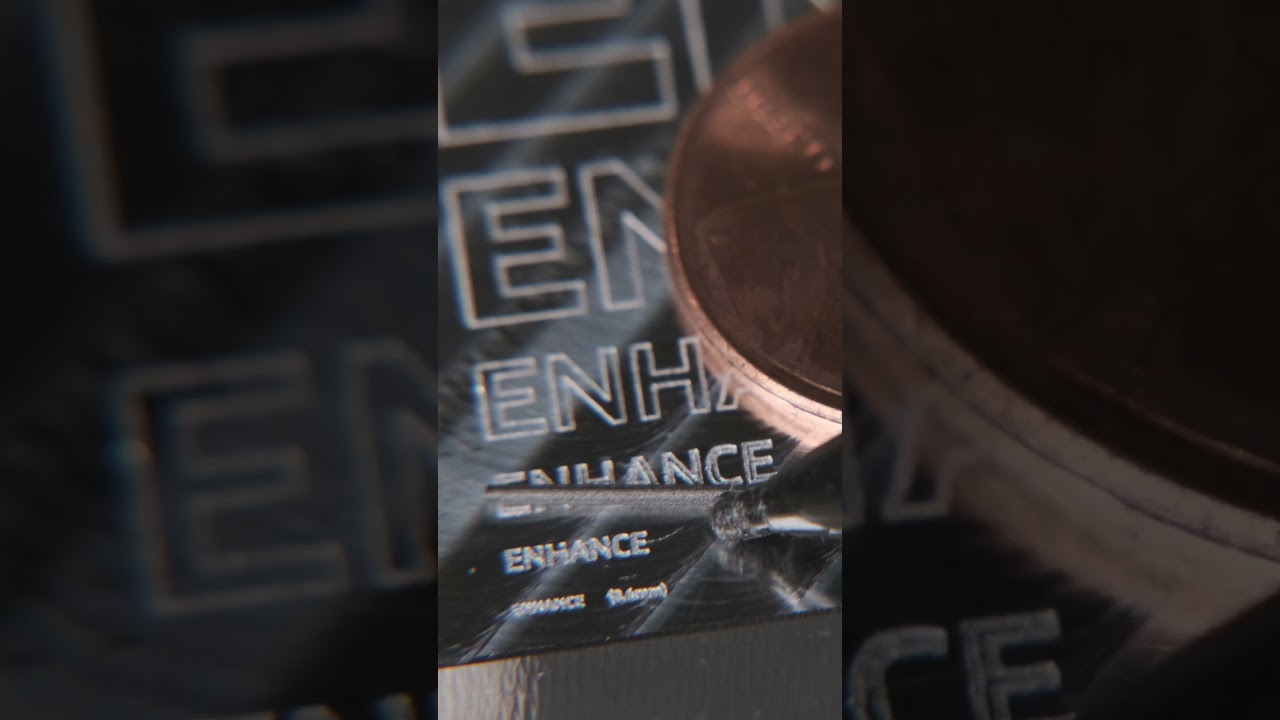

Speaking of small fonts… here’s a YouTube vid that Winston did

Thanks for all the help I ordered some 1/32 bits see how that works On acrylic it wasn’t so bad But smaller bits should help Now to solve the single line font issue
If engraving acrylic (or aluminum, esp. if anodized), why not use an M.C. Etcher?
I’m cutting color core And in small text logo it’s chipping out I tried acrylic because it’s harder to see whether it was the machine or the bit

As far as the panel, it was ruined because of the crap font cutting so it’s a mockup to verify the holes. I will take your advise with the reveal. Thanks !
