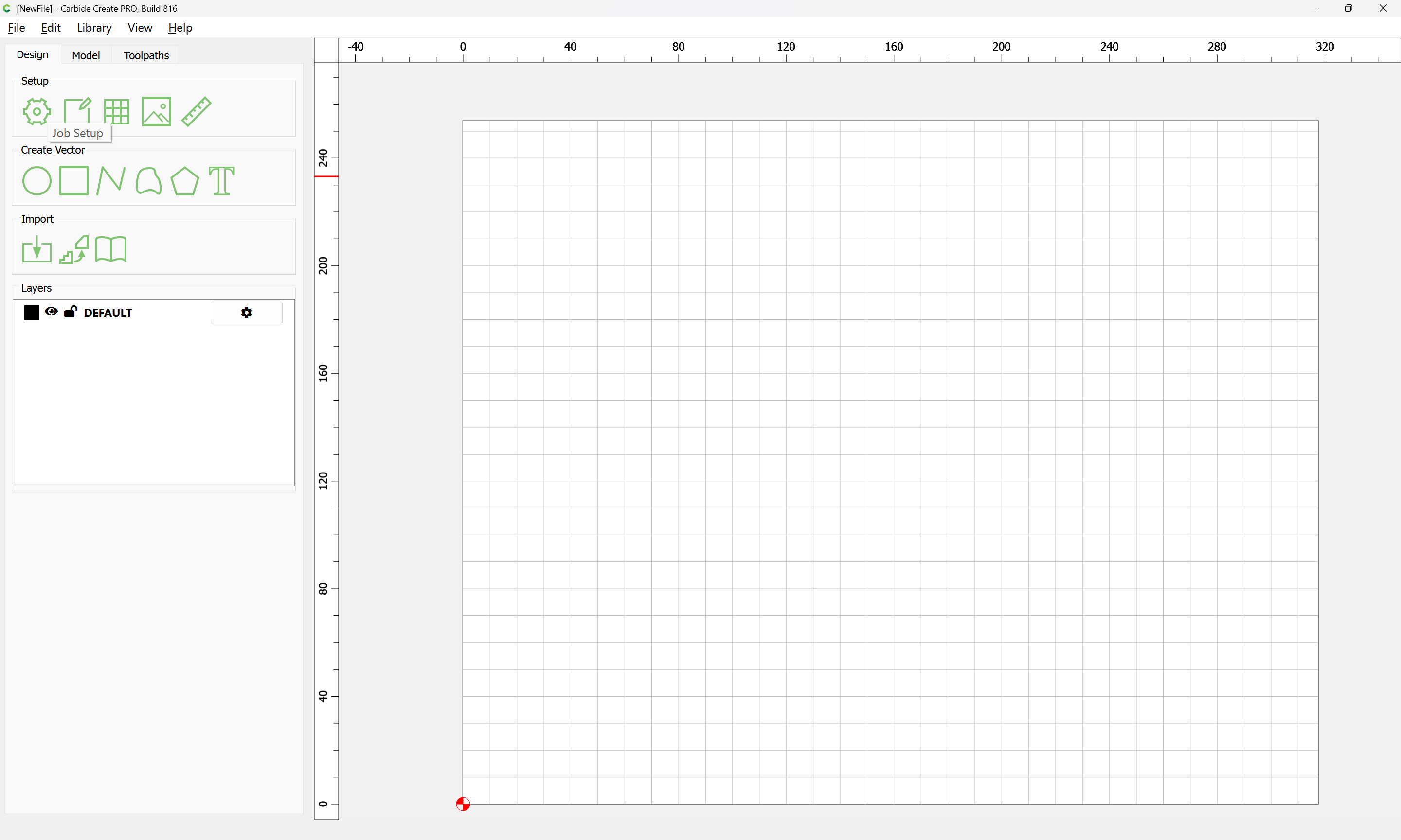

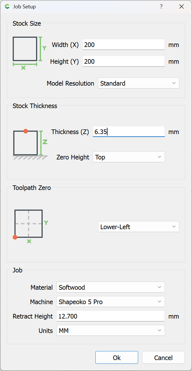

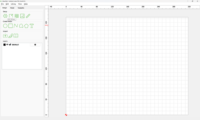

Launch Carbide Create:

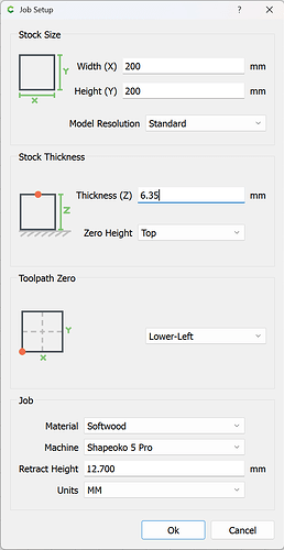

click on “Job Setup”
and fill in the desired parameters.

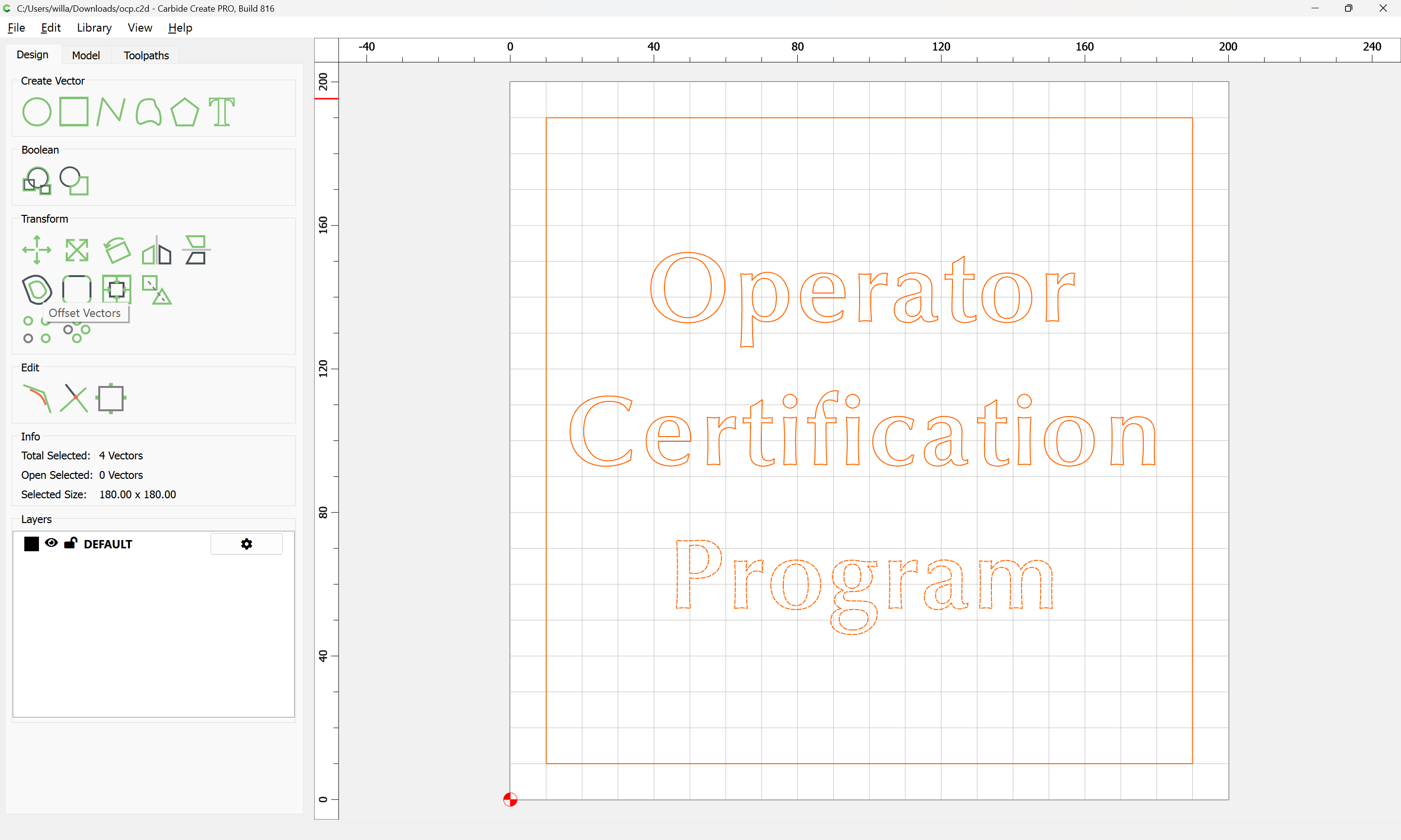

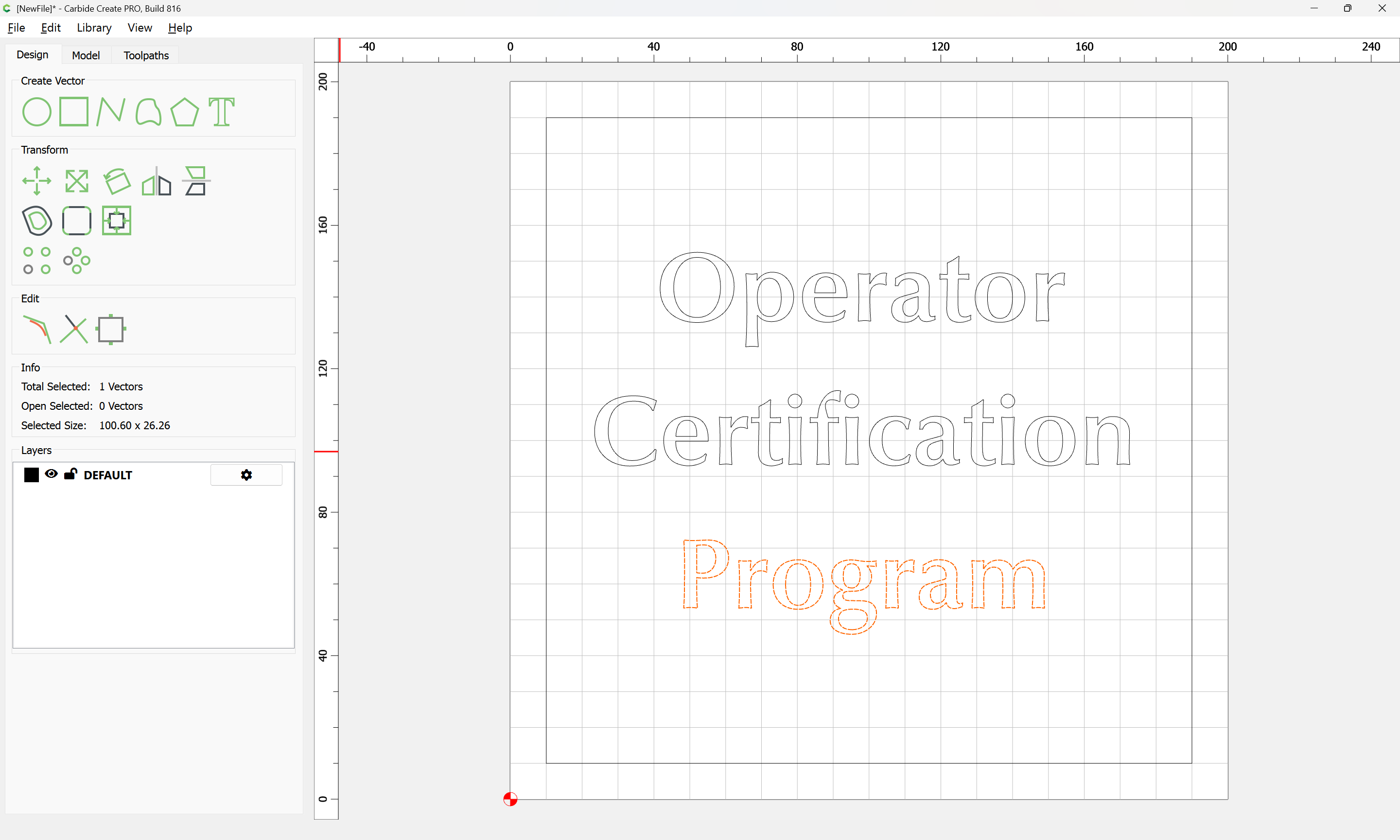

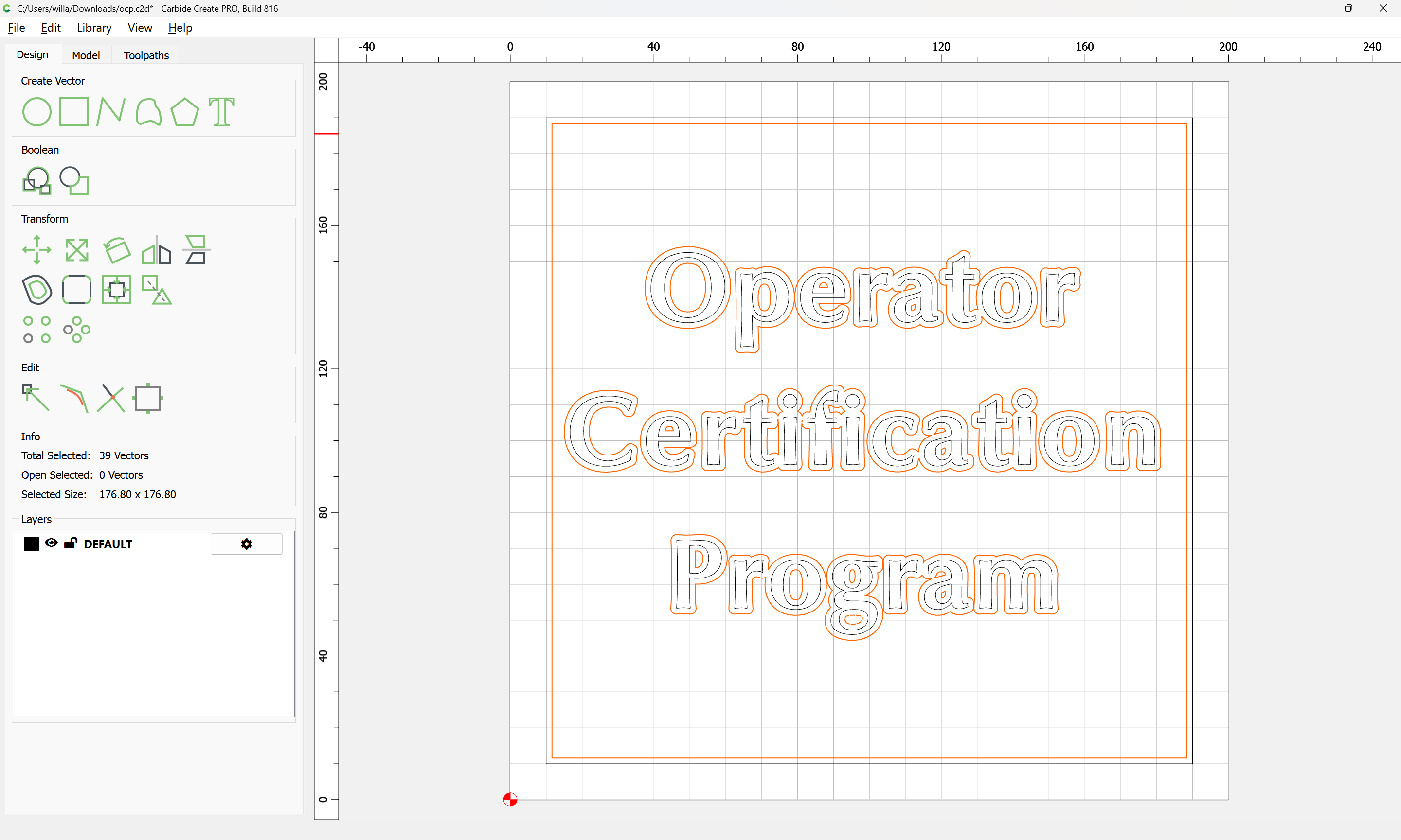

Then, create the design in the Stock area using the drawing tools:
See:
https://carbide3d.com/hub/courses/create/shapes/

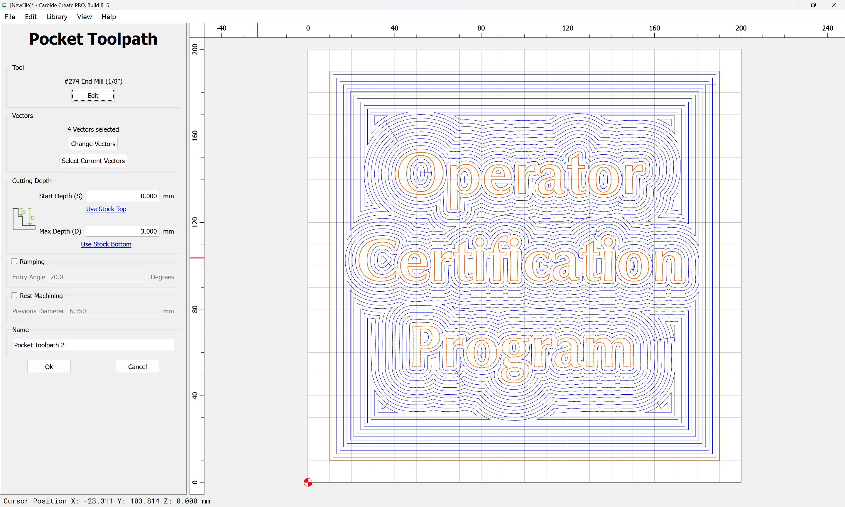

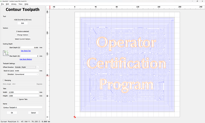

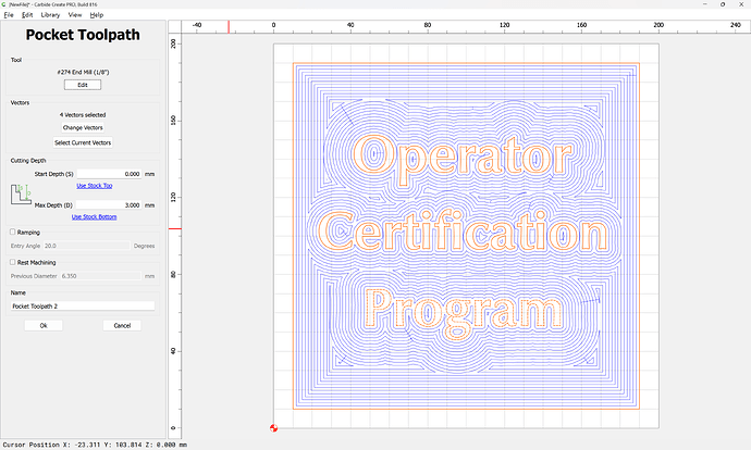

Then assign suitable toolpaths using appropriate tooling:
For a discussion of toolpaths see:
https://carbide3d.com/hub/courses/create/toolpaths/
and for tooling and feeds and speeds see:

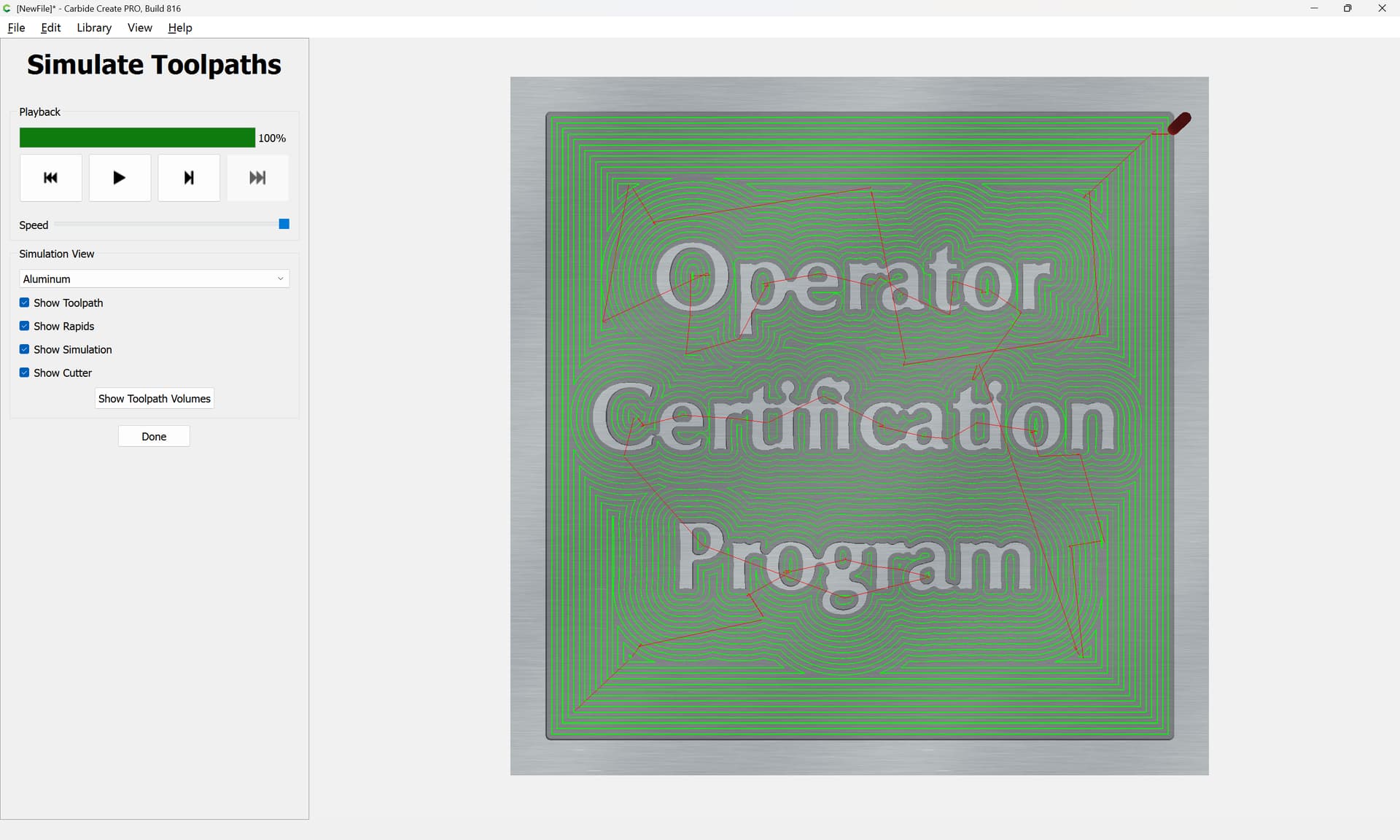

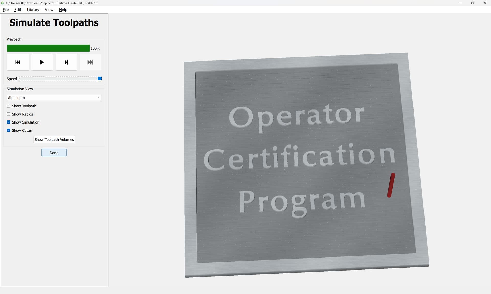

Check the simulation:
by clicking on “Show Simulation” as discussed at:
https://carbide3d.com/hub/courses/create/simulation/
If it is not as desired, adjust the settings, or add additional toolpath(s) so as to arrive at the desired result:

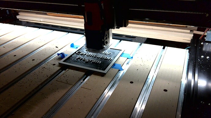

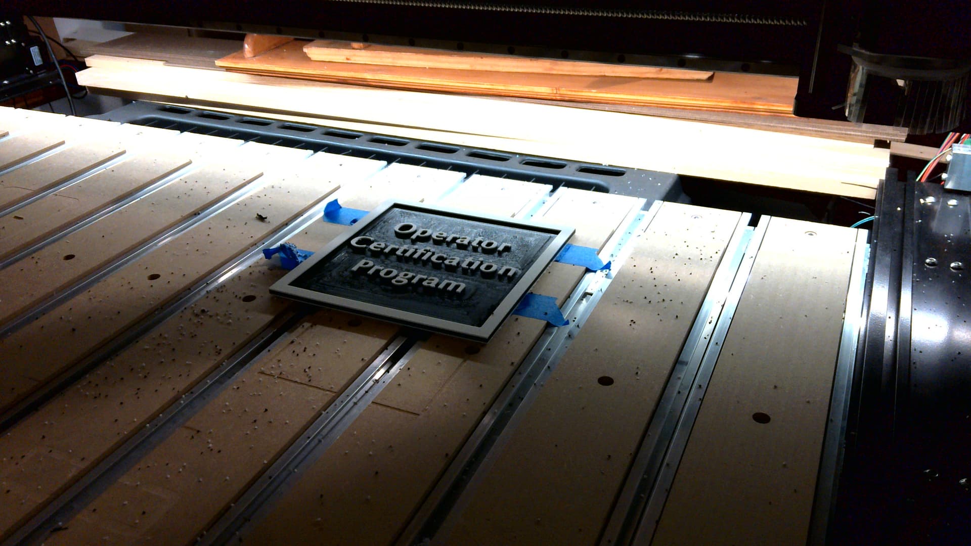

Secure your stock in place, ensuring that it is square to the motion of the machine and will not shift — since the material being cut is a sheet good which has concerns re flexing/bending, blue painter’s tape and cyanoacrylate glue will be used:
(note the metal bars being used as parallels against a lip machined into the MDF when surfacing)

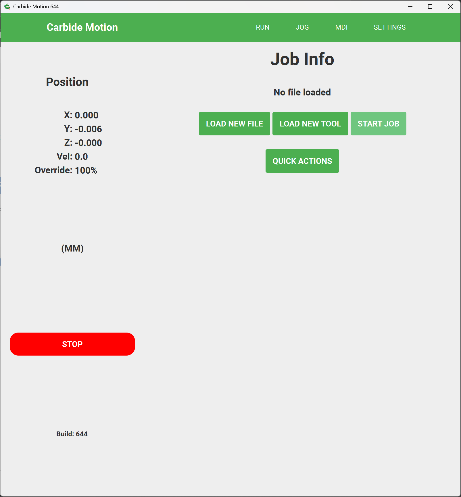

Connect the USB cable, power up your machine and launch Carbide Motion:
click “Connect to Cutter” to connect to the machine:
click “Initialize Machine” to initialize the machine — the machine will move to the back right corner, set the machine origin there, and then move to the tool change position:

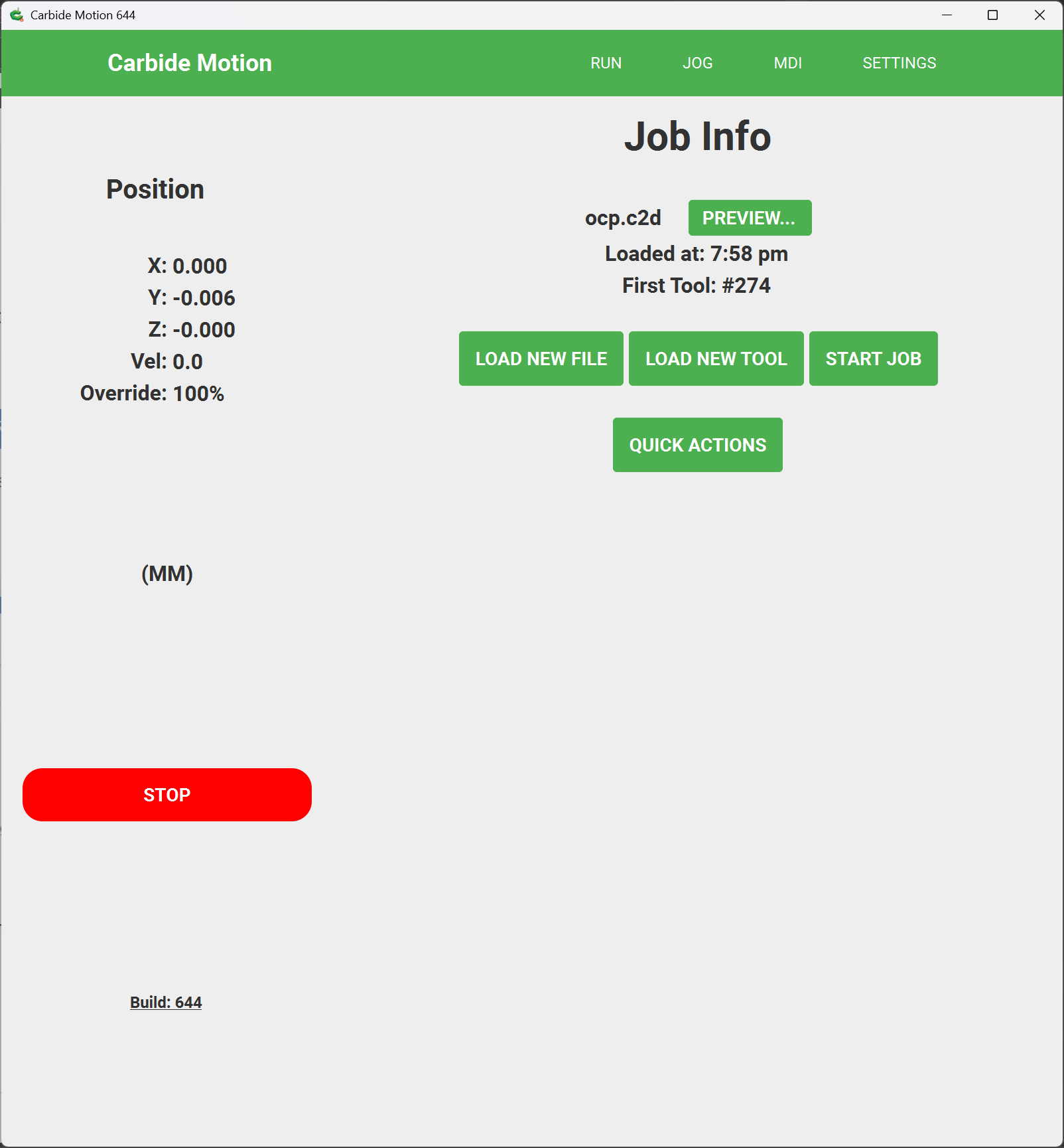

Click on “Done” and then return to the “Run” tab:

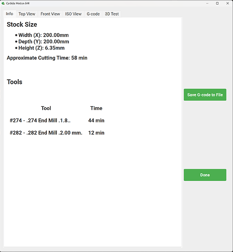

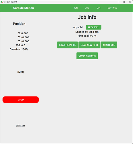

then click on “Load New File” to load a new file, selecting it using the file dialog:

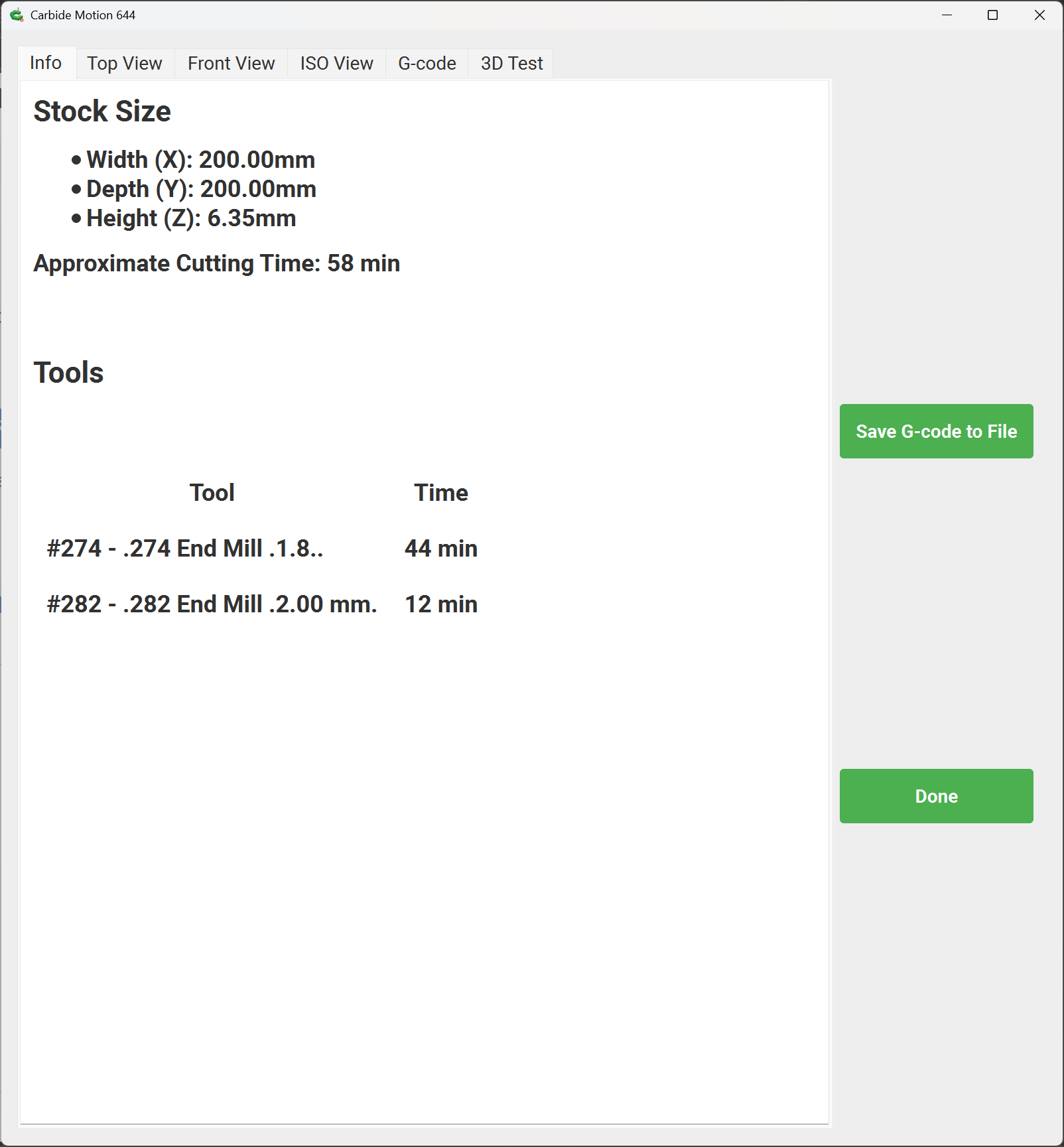

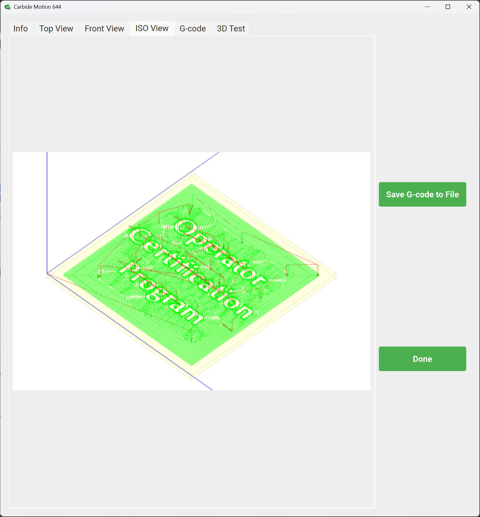

Review the previews and verify that the file is correct and that the origin in it matches the zero as set relative to the stock:

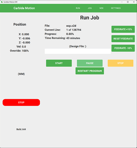

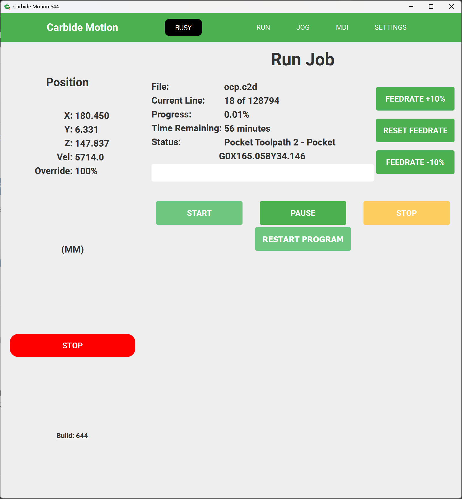

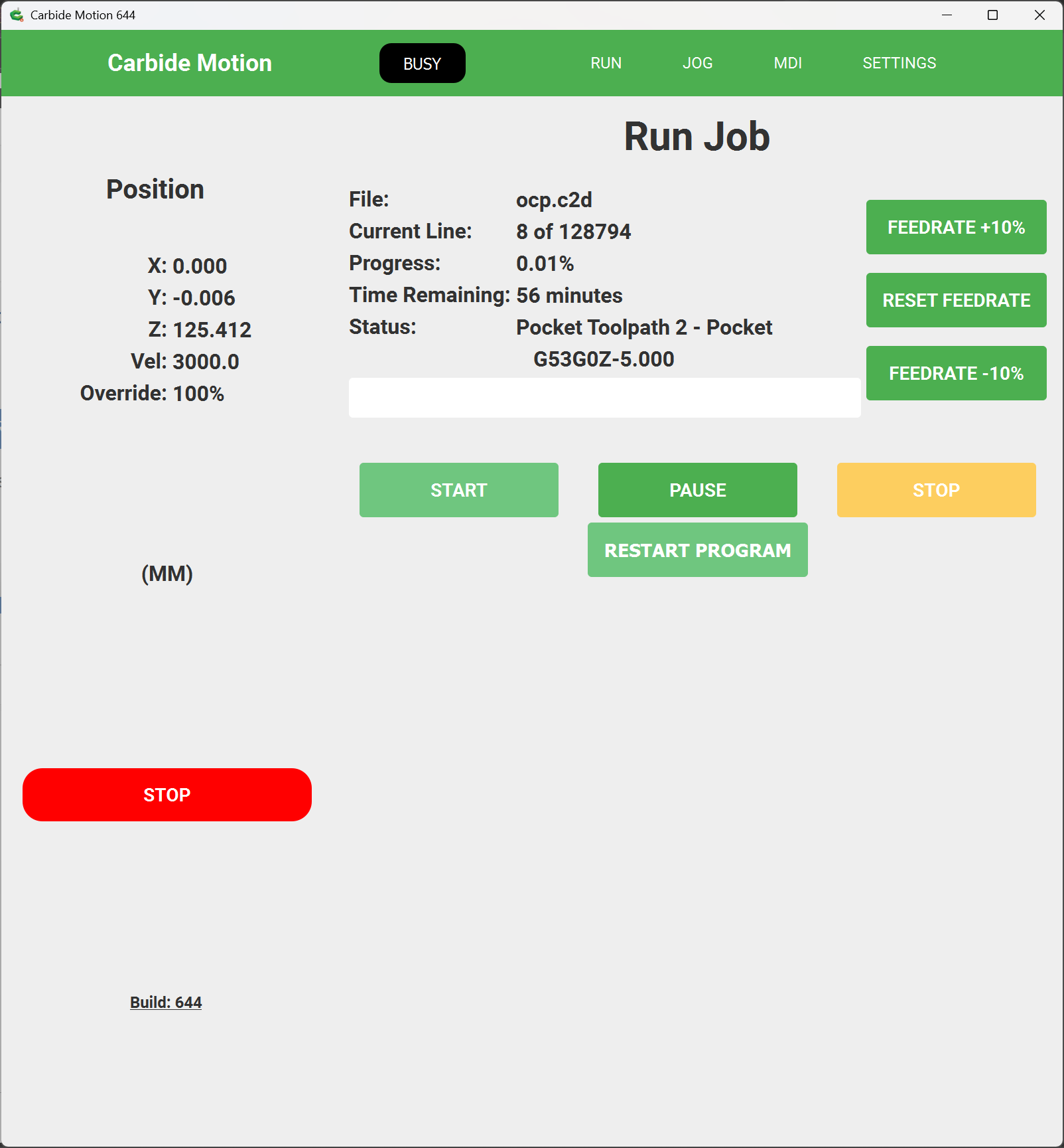

Click on “Start Job” to start the job:
then click on “Start” to start the process of cutting

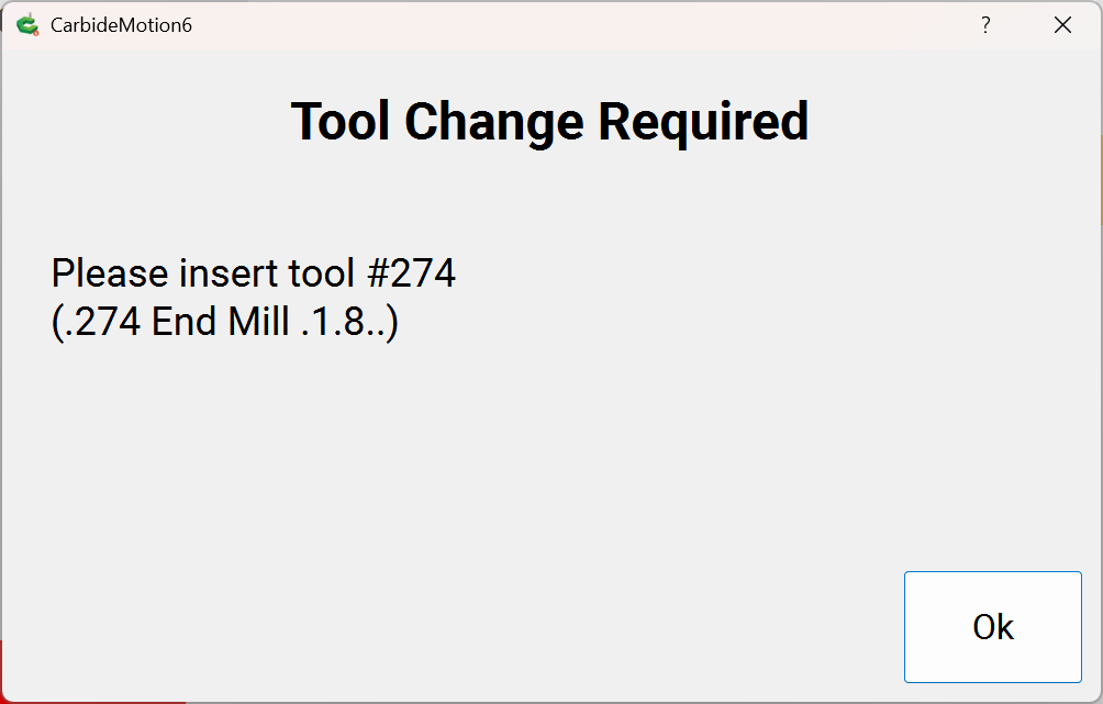

the machine will lift, and if a BitSetter is enabled, will move to the Toolchange position and prompt for the first tool:

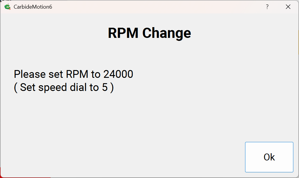

If necessary, load that tool and click “Ok” — the machine will measure the tool — if you have a BitRunner it will power on the spindle and prompt for setting the speed:
if you have a spindle, it will power on, set the speed, and so forth.
Don suitable PPE (eye and hearing protection at a minimum)
If need be, click “Ok” and the machine will begin cutting:
Monitor the machine as it cuts…

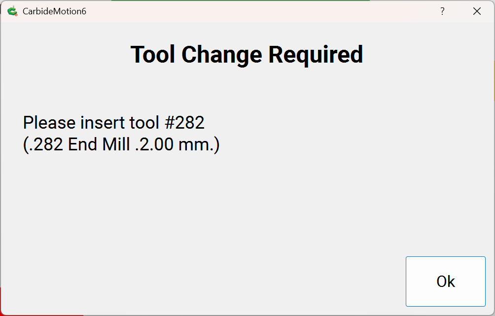

Once a tool is done cutting:
if there is a second tool, the machine will move to the Tool change position and prompt for the second tool (and repeat this process for successive tools):
Change the tool and click “Ok” to have the machine measure the tool using the BItSetter and repeat the process of power up, setting speed, and resuming the cut:

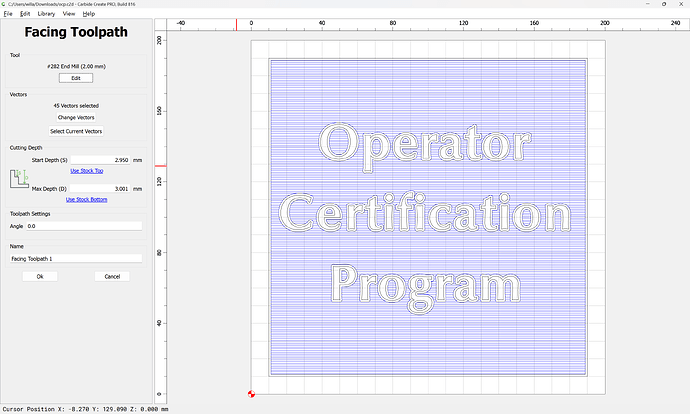

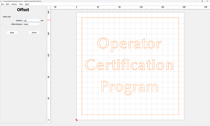

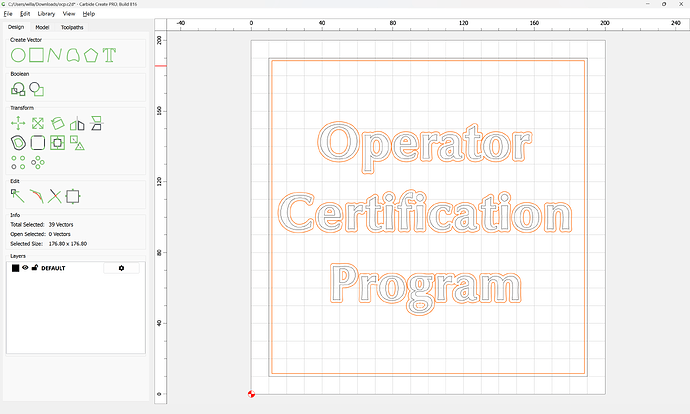

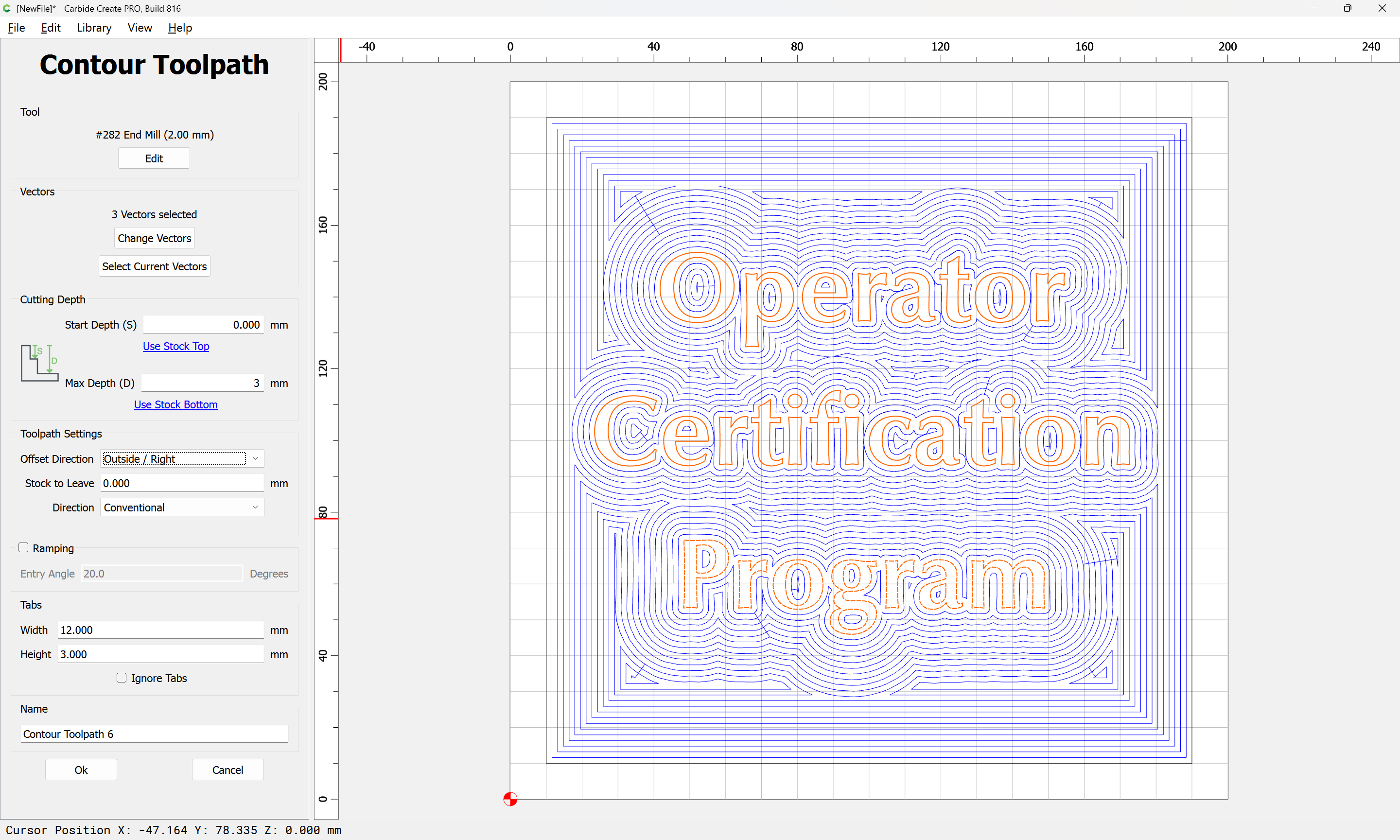

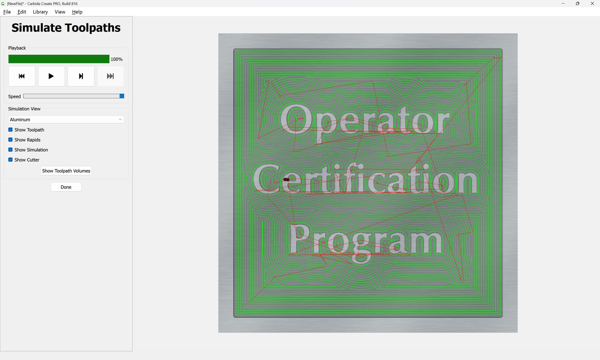

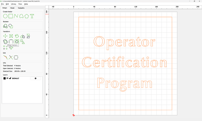

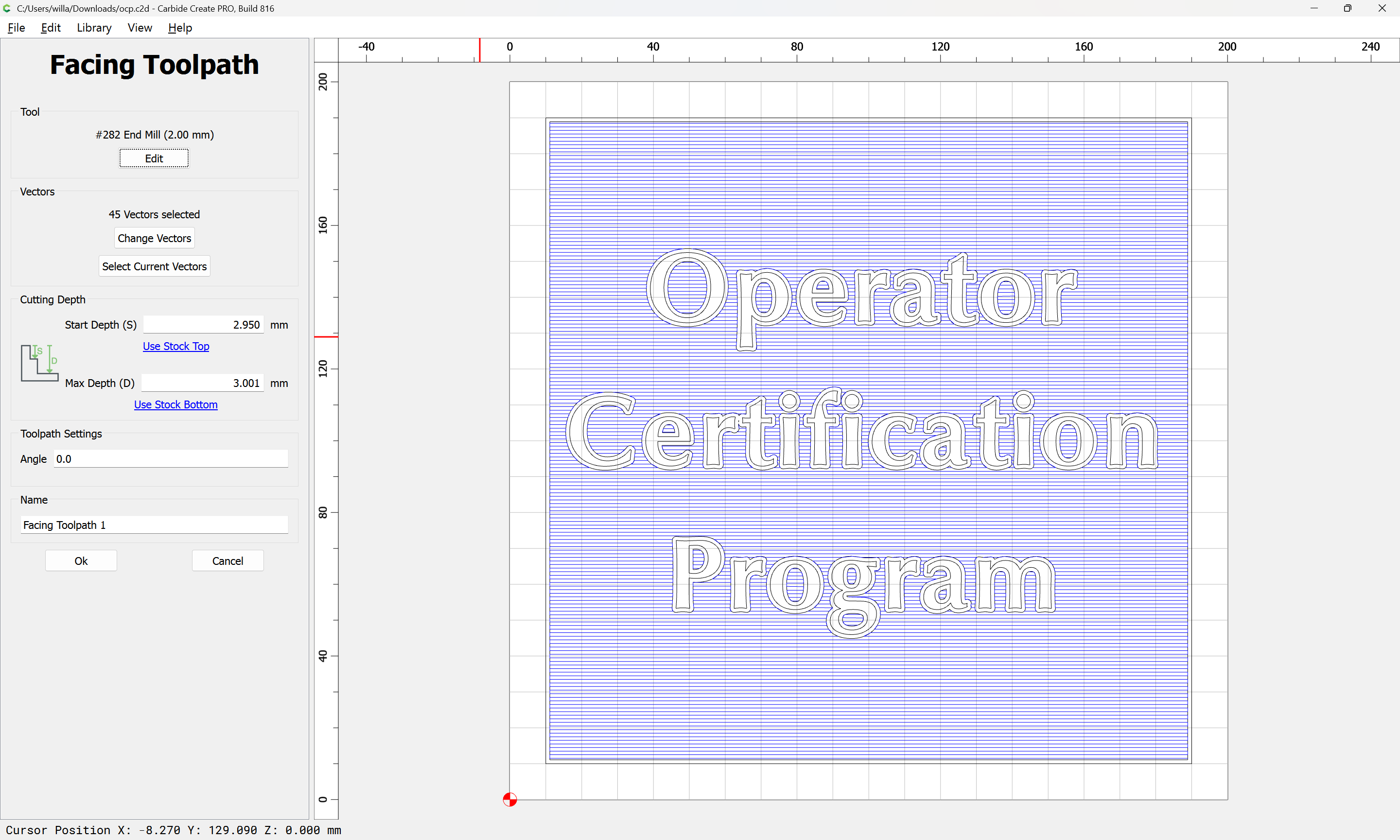

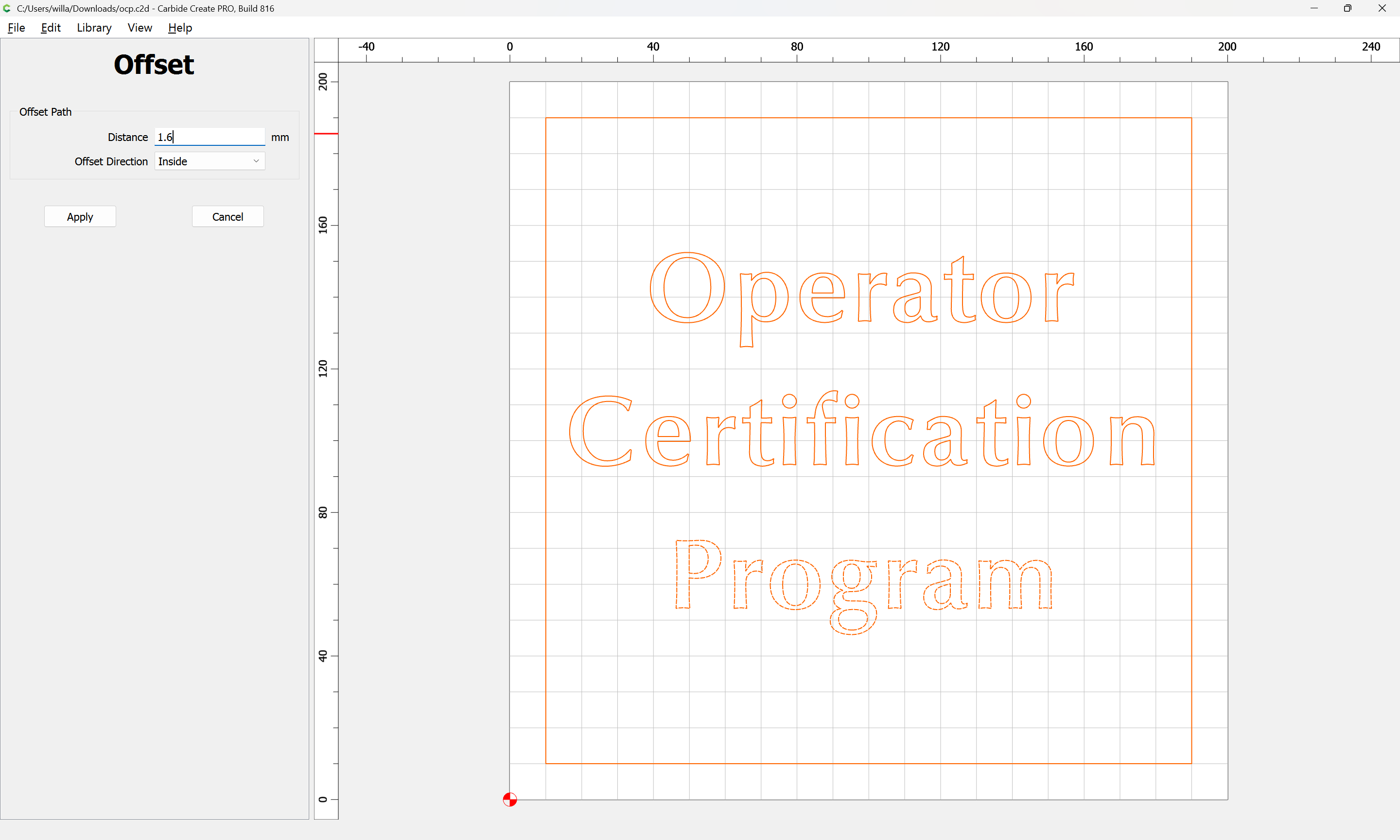

If there is anything further which needs to be done to the part using the machine, it should be done before removing it or losing the zero position — in this case we will return to Carbide Create, select everything:
Offset Vectors:
Apply
and apply a texture toolpath in an effort to remove the patterning of the Pocket operation:
checking the preview:
and adjusting as necessary until a reasonable result is arrived at:
then the second file is run with the appropriate tooling with the same zero as before (after disabling the original toolpaths)
Or, perhaps a 1.1 offset w/ a Facing toolpath:

For compleatness’ sake, here is the prompt which will be seen when running a file w/o a BitRunner:
