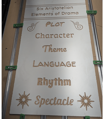

I’ve been having fun using the Library files and also SVG files converted from PDFs. While it “generally” works, I see a lot of sneaky vectors that cause issues with toolpaths. These vectors are extremely close to the main vector and can cause plenty of issues with cutting paths. Is there a way to identify in Carbide Create vectors that are within say .01" so that a user doesn’t have to zoom WAY into the lines? Examples of files with extra vectors here: https://elements.carbide3d.com/

I was working a large sign for my wife’s school. Workflow was Google Doc → PDF → Adobe SVG conversion → Carbide Create. Then 3 hours of zooming and troubleshooting. It turned out FANTASTIC. Now that I have created one, I was hoping there was a more efficient method for the next request :slight_smile:

I find it’s a little quicker to program a toolpath & fix where it breaks. Rather than trying to fix everything. On a lot of designs I find that some areas that look like they might break, don’t. And other areas that look OK do break. It’s usually overlapping or touching corners, or very narrow corners, or occasionally self intersecting vectors with little loops or narrow areas that converge to zero width then cross each other.
TIL: Inkscape. Turns out that this is a good shortcut to get from PDF to better SVG files. Then still zoom, zoom, zoom as @gdon_2003 mentioned after creating an initial toolpath and seeing the opportunities for improvement in design as @Tod1d said.
