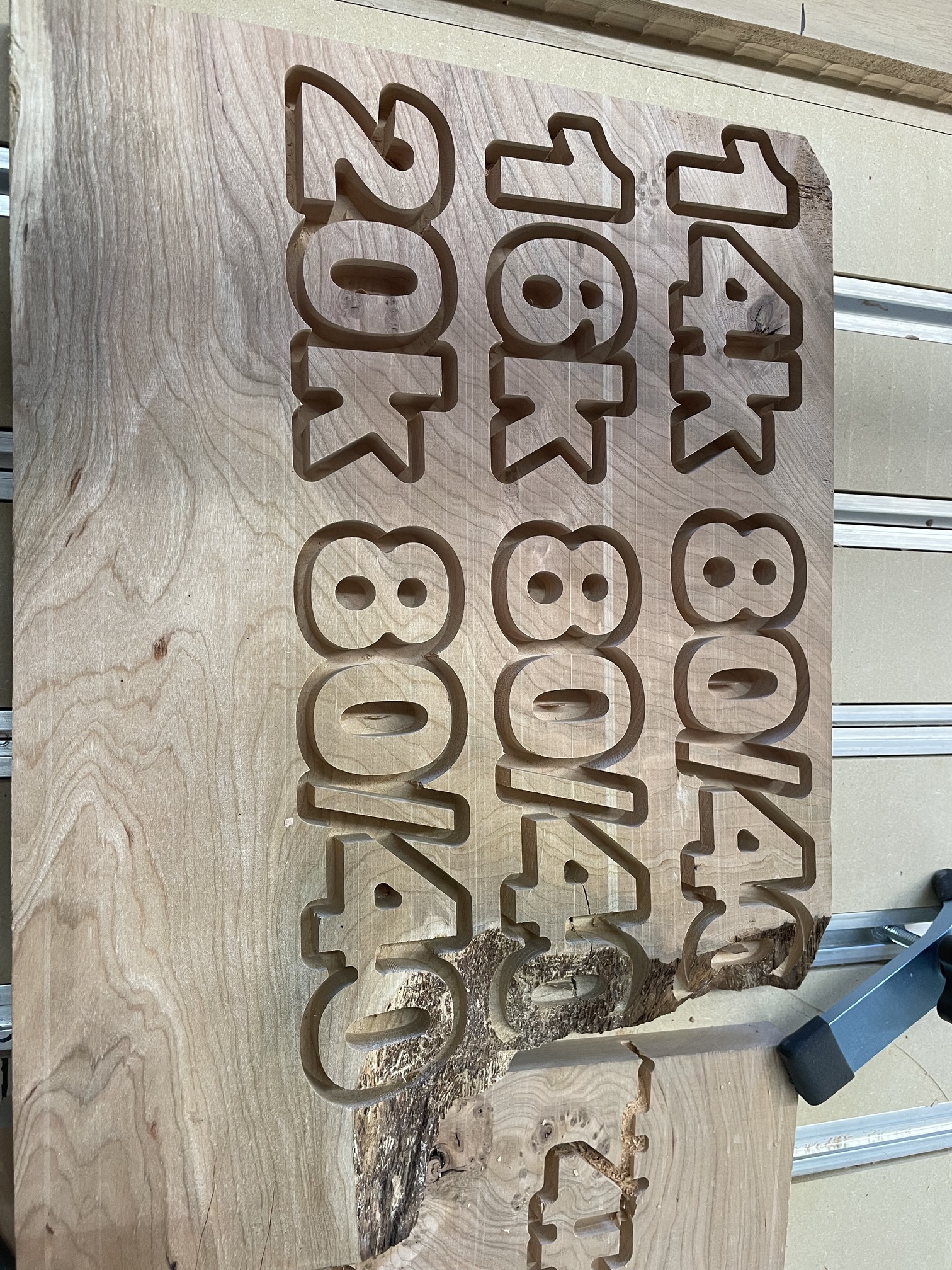

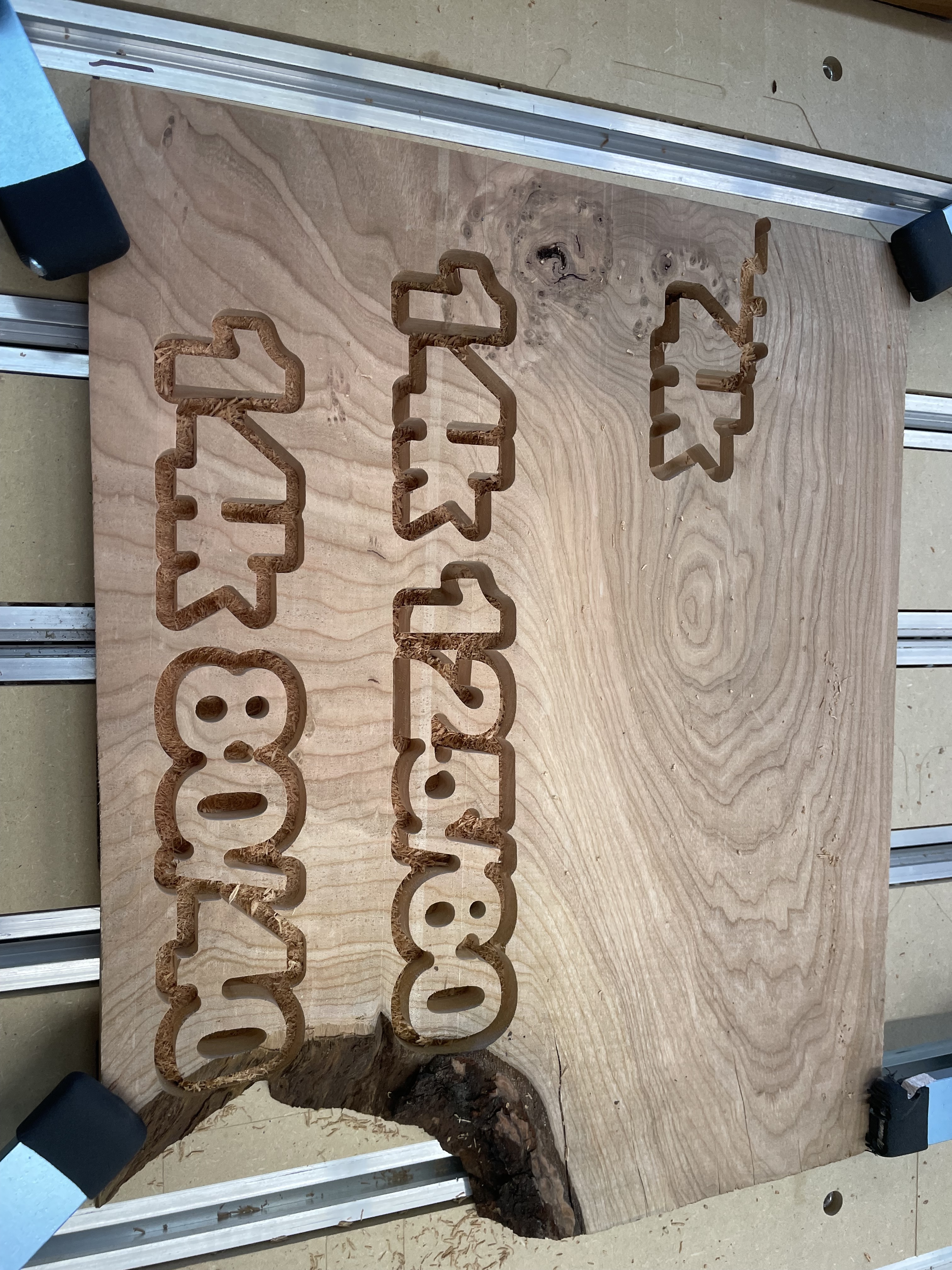

I did some testing and cannot get anywhere near what you guys are reporting , I have carbides VFD.
Trying to run 14k 170-75 with .25 doc I just crashed
14k 125/80 did not sound good and nor did 80/40.
I had better success on the test and was able to up the speed to 160 ipm manually. But I can’t remember my DOC on this code as I accidentally overwrote it.
