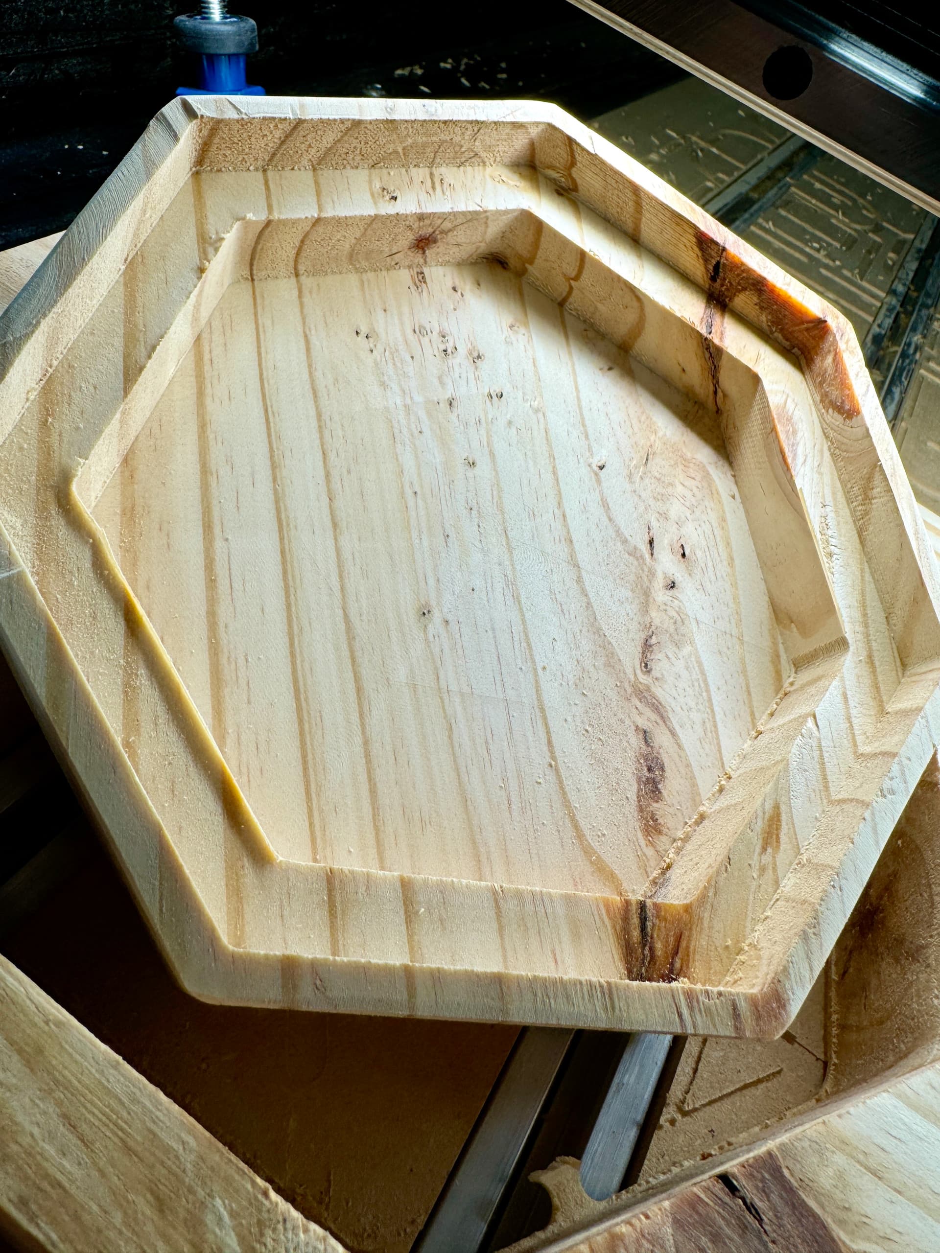

I don’t need to be a max/min person but I’d like to be optimal and also found base numbers just slow or at times screeching and knew it needed to be fed more. Grabbed a trial of gwizard to see what it’d say and came out today for pine using #201 & Carbides VFD .25”d / 40%step / 15k / 200ipm, ran the same for the contour and it performed well except the vac was having trouble pulling out the last pass or two of the 1.75" depth and you heard it.

You also asked someone if they were doing the profile path at the same speed as the pocket and I did. Ramped in but it took down 1.75" in < 1m. Now that bit was pretty hot so I’m not sure how often I’d slot that deep off #201 but it did it and it only yelled at me on the last pass mainly because of the kerf buildup.

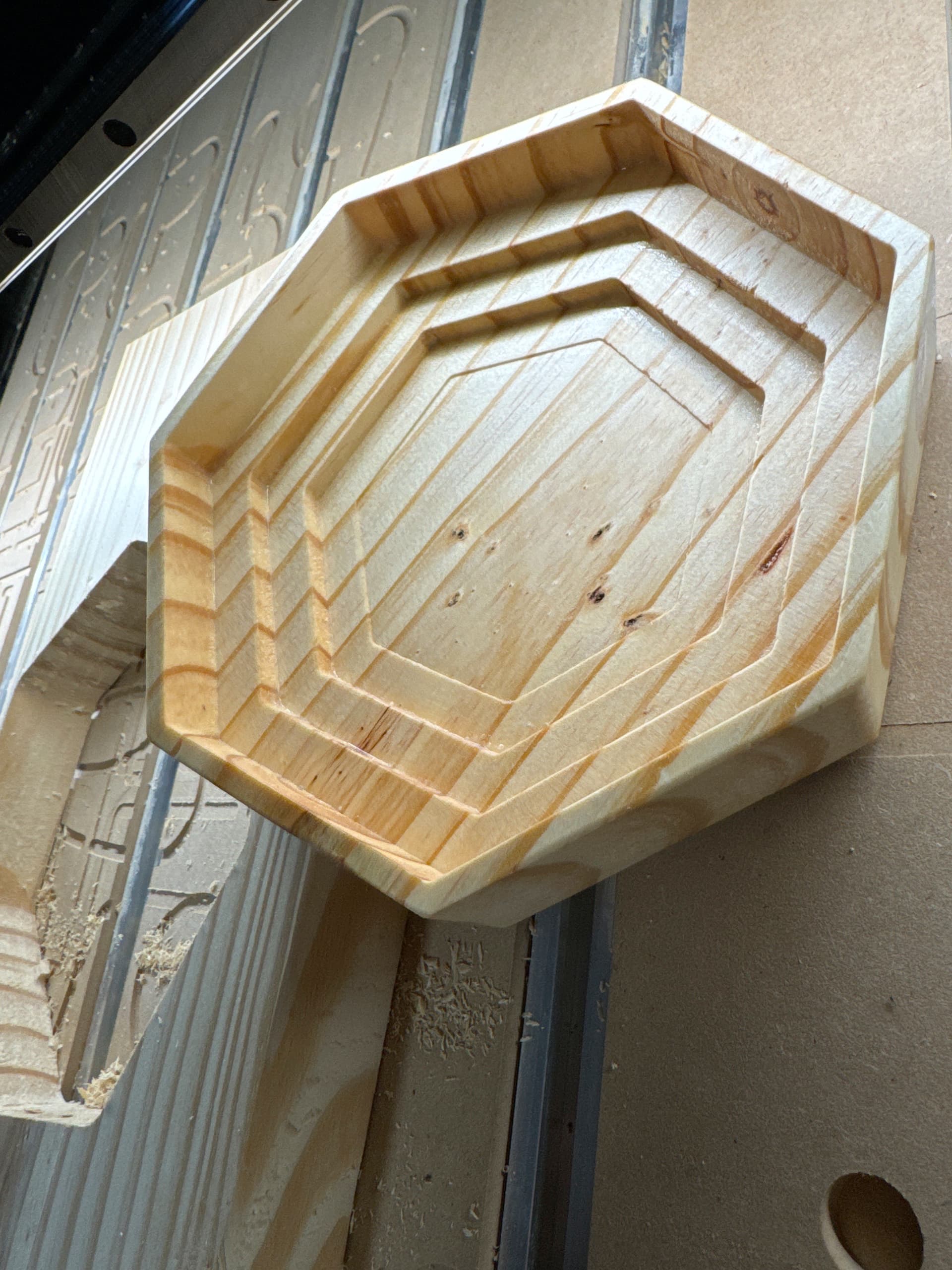

I did 0.5 DOC with 18k rpm and around 170-180 IPM using the beast from IDC Woodcraft.

Not an IDC bit but a roughing bit, doing .75doc / 16k / 155ips, it was yelling a bit and will need some tuning. Torqued hard enough to turn my work surface. :laughing:
