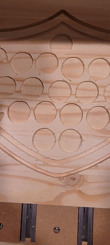

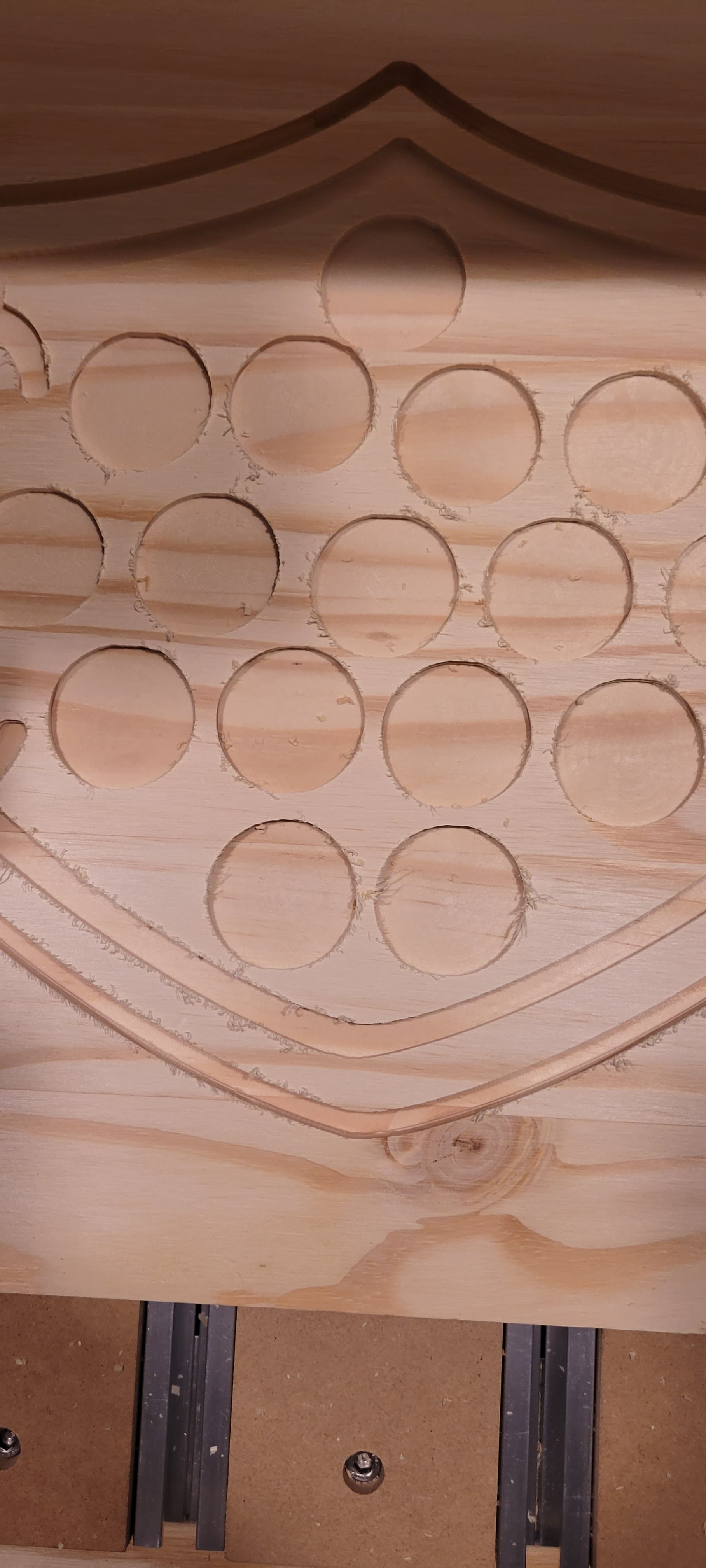

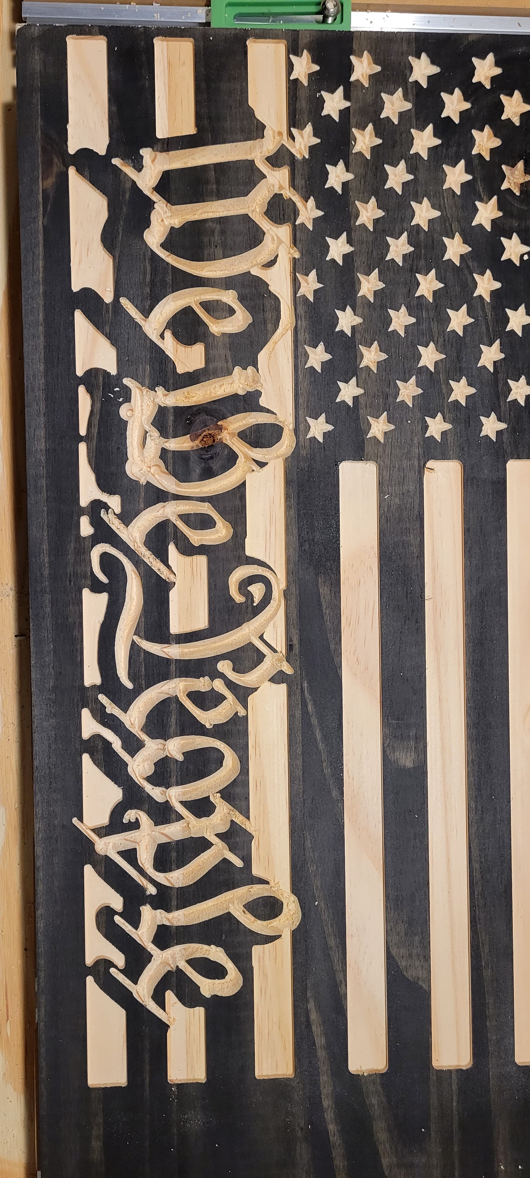

Looking at the last 2 pictures I only see some fuzzies that can either be brushed away or hit with light sanding, that’s perfectly normal. The quality of wood and sharpness of bits dramatically affects the amount of fuzzies you get.

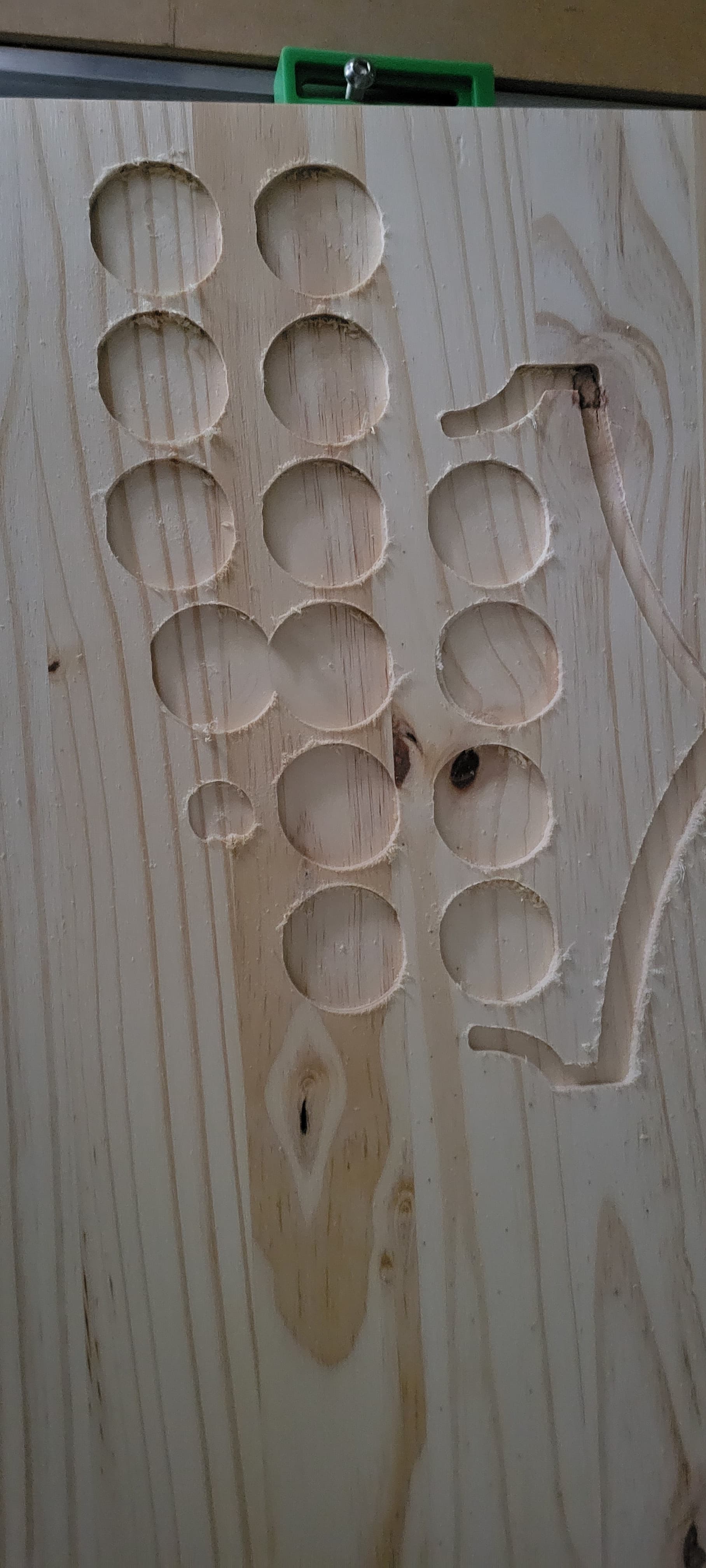

Hi Nick fuzzies i could handle its the circles not staying stright circles overlapping and line in flag on left moved up along with wording.
Machine seems to jump lines up or down whenever it chooses.

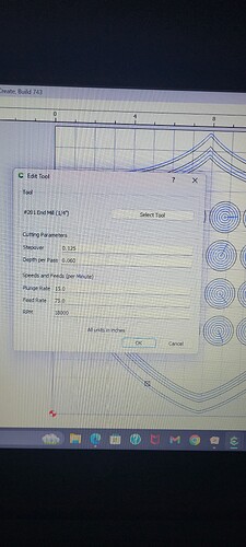

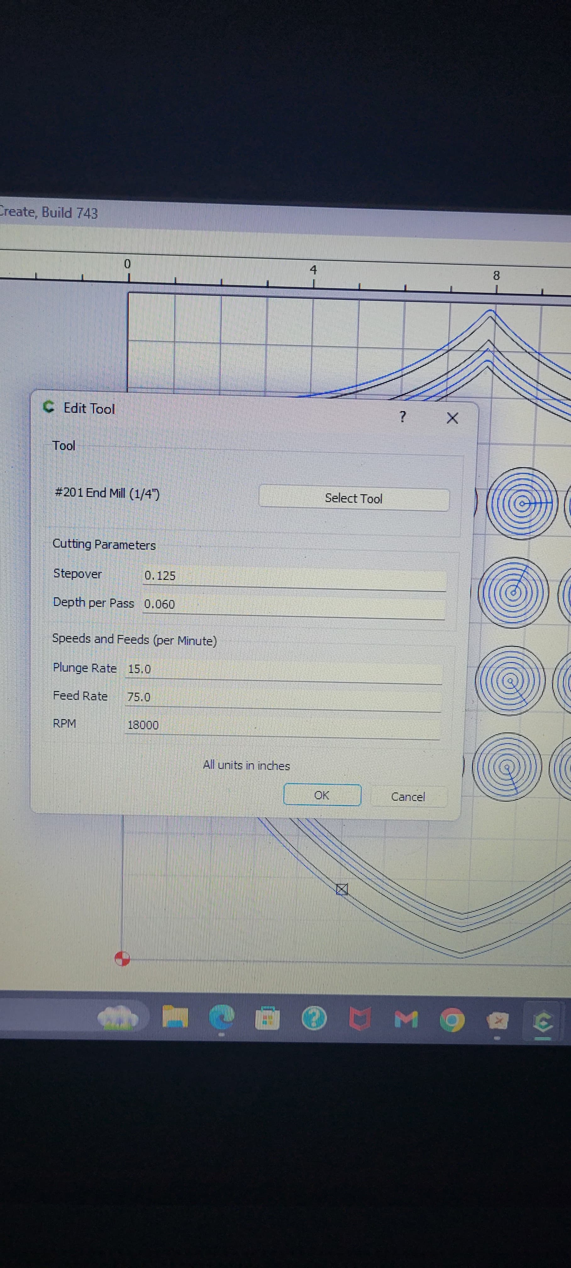

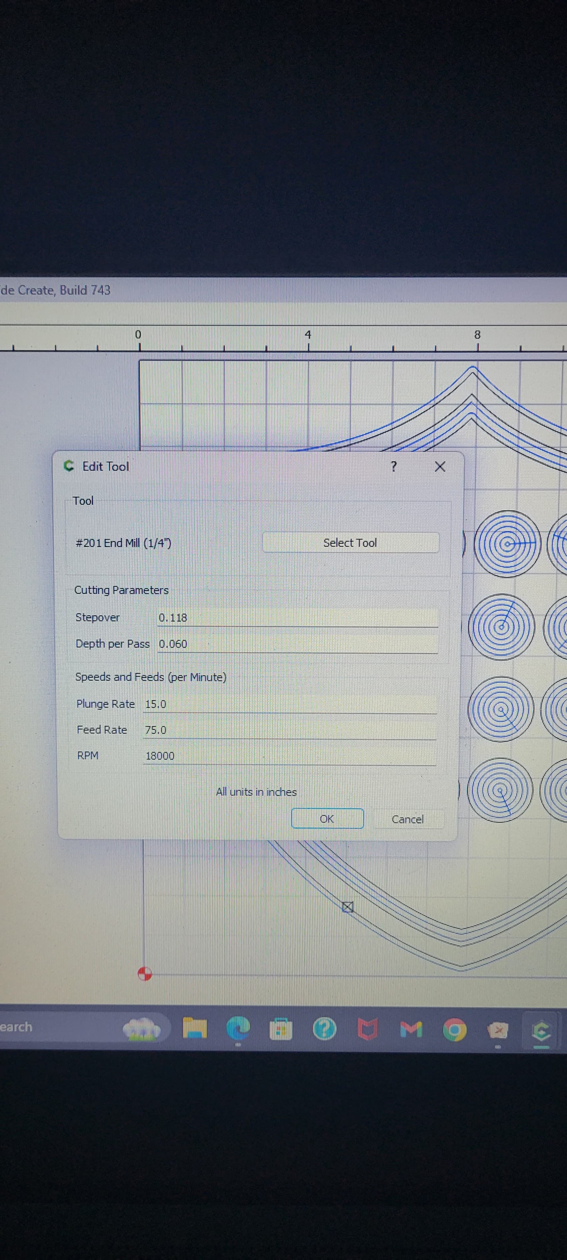

based on those pictures it looks like you are missing/skipping/losing steps at some point during your gcode being run. What feeds and speeds were you running on those projects? Might be that the machine is being run to aggressively, and skipping/losing steps at some point.

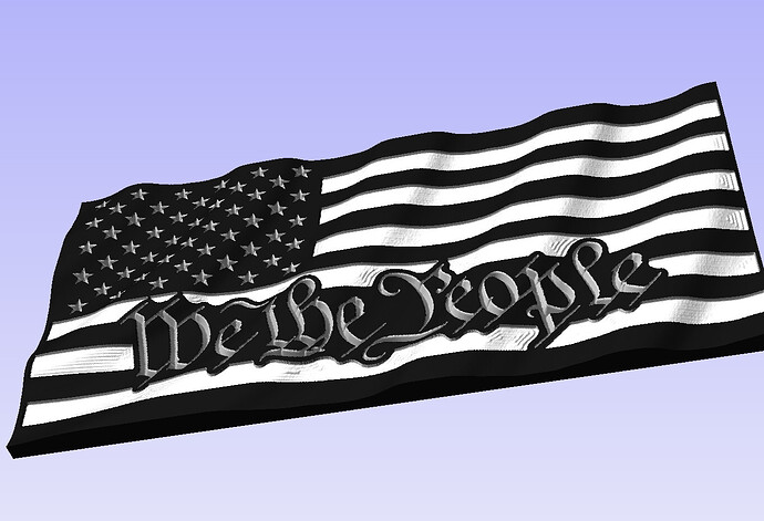

This is the file i was doing and the speeds.

In my opinion you may have several problems
Lose belts and maybe wiring issues. All of your circles look to be flat on the same sides and this could be belt tension. As far as wiring issues I would check all the connections and make sure the pins are all pushed in properly.

The photos you posted look like work-holding errors.
I put a brad nail into the stock on all four corners for Flags. This locks the work in place and helps it stay flat.

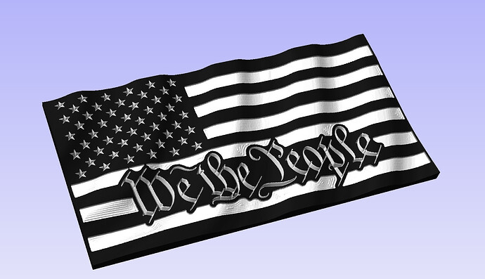

Looks like you are doing a WTP flag and a Poker Harley Davidson Shield. Those are both great starter projects. The WTP flag is a bit advanced, but it looks like you followed Full Steam Designs video.
I use tape and super glue plus clamps to hold down I will try the brad nailer and see if that helps thank you
Yes I do follow Full Steam Designs but I actually brought the C2D file for the flag.
WTP Flag 21 x 11.c2d (232 KB)

I use double stick woodworking tape. It usually is great but I had a project I was working on for over a week due to waiting for epoxy to dry and ended up having it bow up slightly in the middle. A couple of brads resolved that issue easily. I did have my piece on a piece of MDF on top of my normal spoil board.
Thank you so much Fleming for doing a video chat and help find the issue with my machine and expedite the parts to me. Hopefully i will be posting completed projects soon and loving my machine. Thanks again Julia
