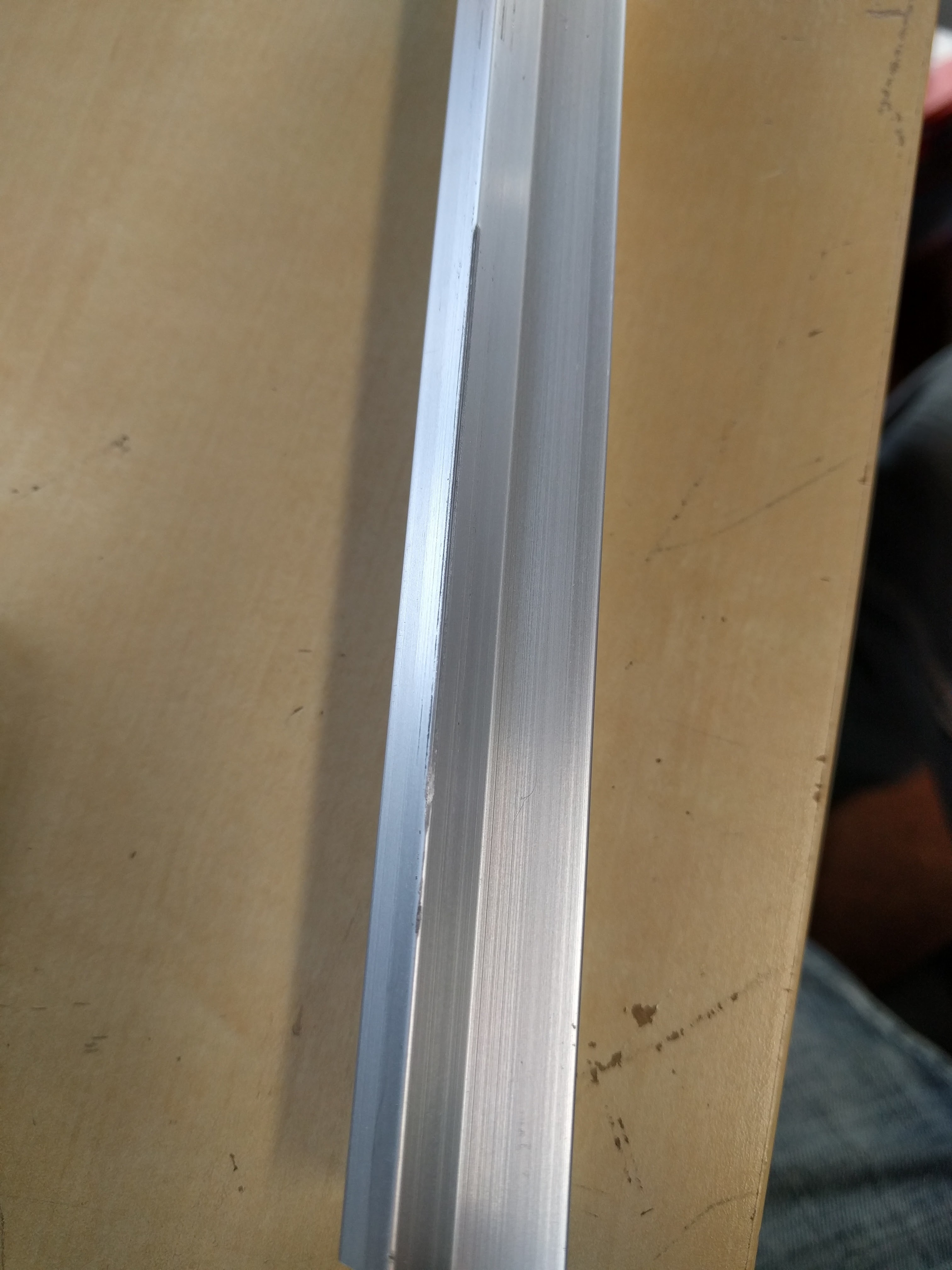

On March 3rd, I noticed the X-Carriage had begun missing steps and the part I was cutting was now offset. Suspecting wood chips or ? had gotten under the belt I dug in and found a portion of the belt was smashed and actually look as though it had melted.
Now if you look closely at the image you can also see scratches on the x-rail.
Here is another angle.
So now let’s find the source of the problem…
That was easy, it’s the idler bearing for the X-Belt. It is actually supporting the top of the X-Carriage.

Fast Forward to March 31st. Had not heard from Ed or anyone on the team, so in the meantime I replaced all the belts on the machine, cleaned up the x-rail as best I could and added some shims in the mounting holes for the x-carriage v-wheel bolts. Everything was working well enough to knock out a few more “SIMPLE” cuts. Until the Z-Carriage started to stick and miss steps.
I disassembled the machine again and investigated.
In case you can see it very well, one of the z-rails had been flattened (the dark line is actually the area ground down by something). This is the Left z-rail to be exact. What could be causing that???
Again, a little hard to see, but if you look closely at the stationary z-belt pinion gear, there is a dull spot between the two set screws, it is rubbing on that z-rail.

I have had this problem myself.
I didnt get an answer from anyone there so i did a bit of digging and found one of the top V wheels had a bent bolt. Easily done as the stock fasteners are done to a budget and I probably over torqued the bottom wheels,i changed the bolts to a hardened socket cap and I have been drag free ever since.
There is a solid chance you were perhaps over zealous with the wrench,Im not pointing fingers as I made the same mistake so I know what im looking at…and its easily rectified with new fasteners.

This was more about over torquing the eccentric v wheels to the rail causing the bend. Not general fastener practice. Its perceived as good practice to get everything tight as possible,in the case of the V Wheels this is not so.
The fastener/wheel assembly looked straight,it was only when I removed it from the machine that it was seen. It could do with a precision bushing tbh but the cost would be a turn off for some.

Appreciate the thought, but unfortunately this is not the issue in my case. For my machine it is simply the fact that the mounting holes for the bolts are too large and over a short time of use, those bolt move their way to the top or bottom of the hole allowing for the parts to touch.

It sounds like a QC issue with the plate supplier to me. I have machine #0004 and i don’t have this issue with the holes being too big.

Ed called me on Friday and we discussed the issues with the machine. It seems the holes for the V-Wheel bolts should have a nominal margin of play, approx .4mm and it turns out every hole on all my X,Y, and Z plates has anywhere from .8-1.4mm of play.
Bolt diameter is ~4.8mm and the holes range from 5.6-6.2mm depending on how much powder coat has worn off during assembly / dis-assembly.
With the new design having PEM nuts pressed into the plates, I suspect the problem should not creep up for any new machines shipped past this point, but there may be others out there with similar characteristics as mine.
As for the stationary pinion gear on the Z-Axis, not 100% sure if the bolt holes caused this or what, but suspect again, that the new design might eliminate the potential for future troubles in the same regard.
