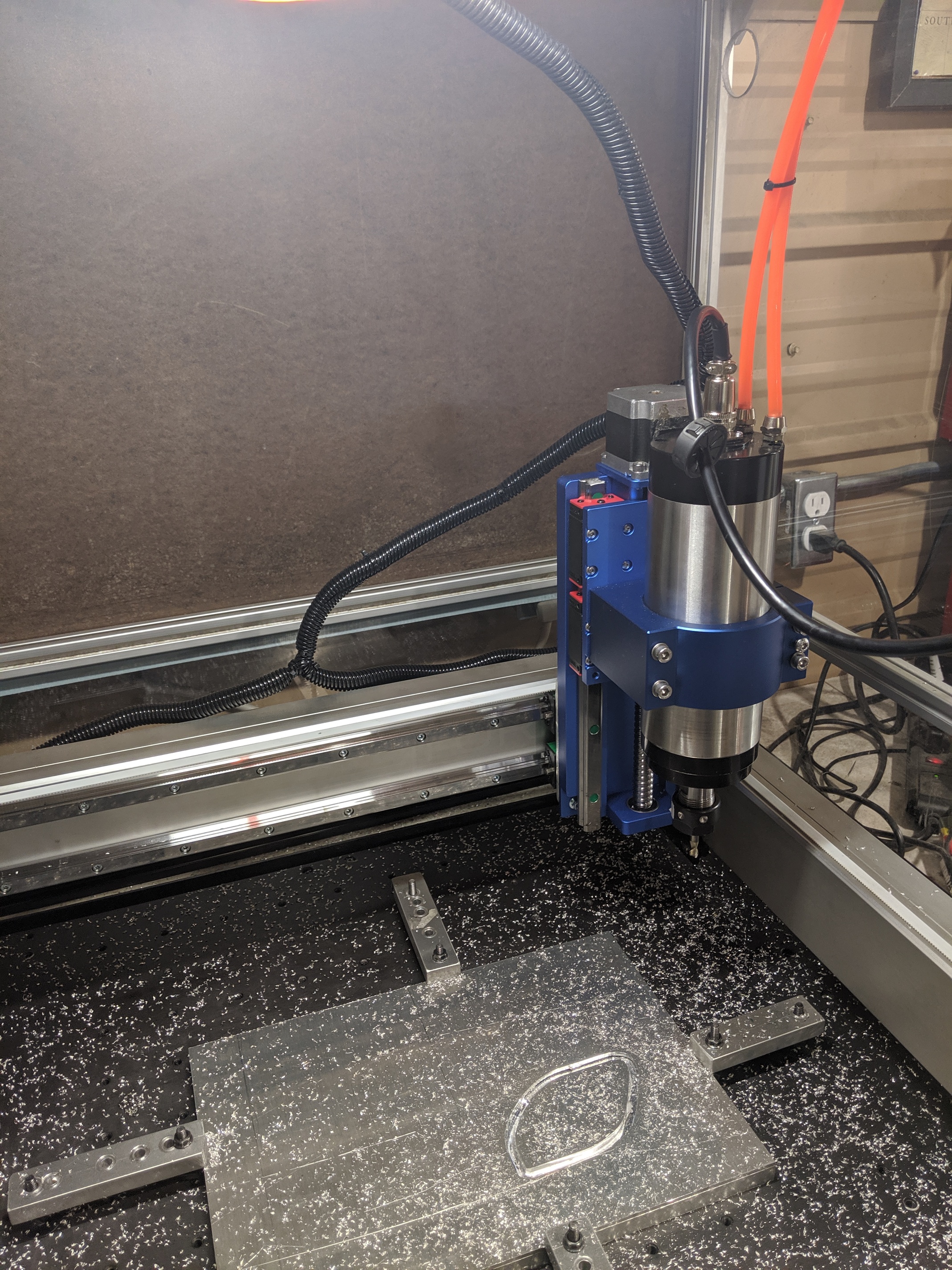

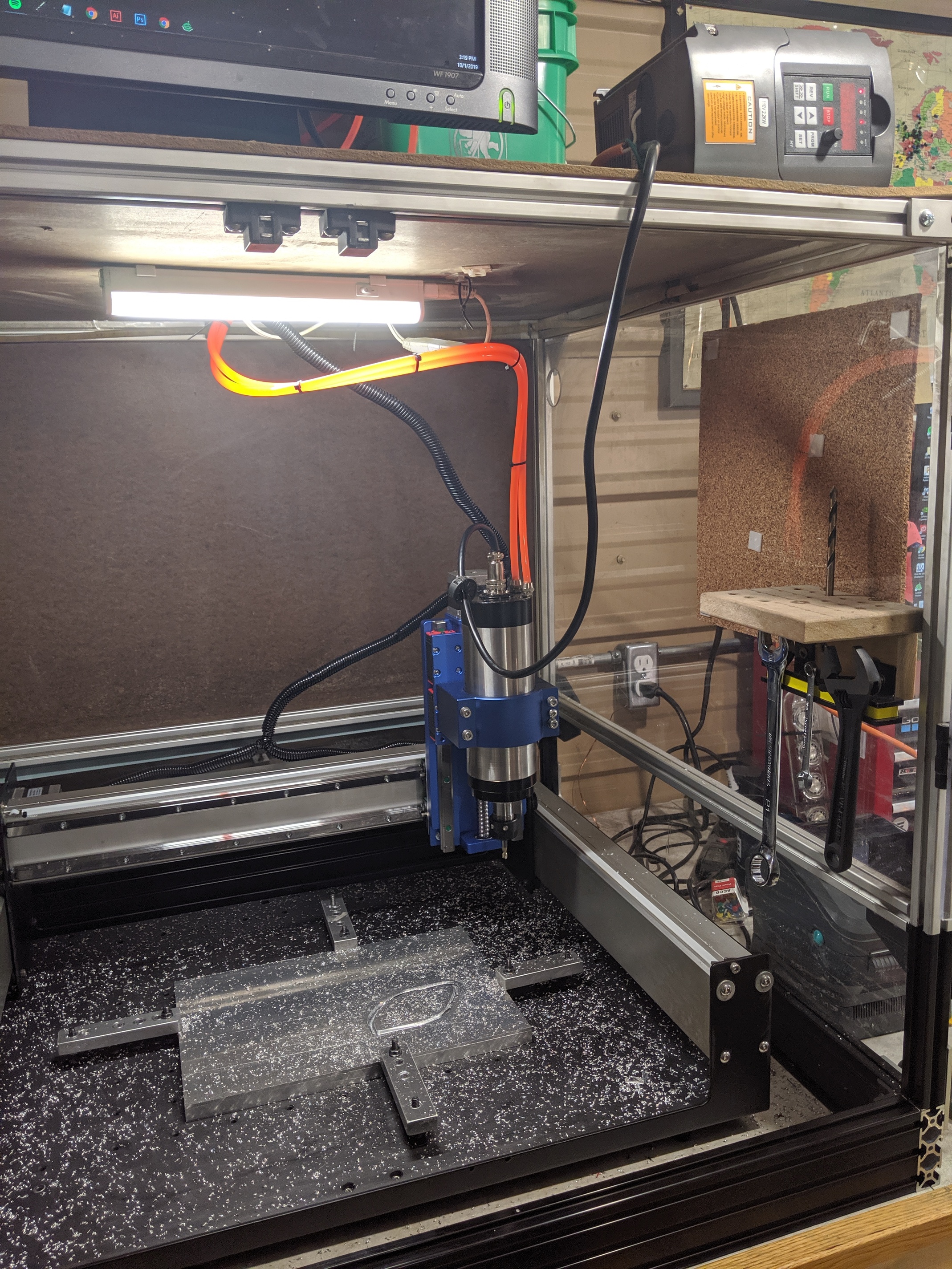

So what I’ve done in this series of upgrades is change the X travel to use a linear rail, upgrade to HDZ and a 2.2kw water cooled spindle.

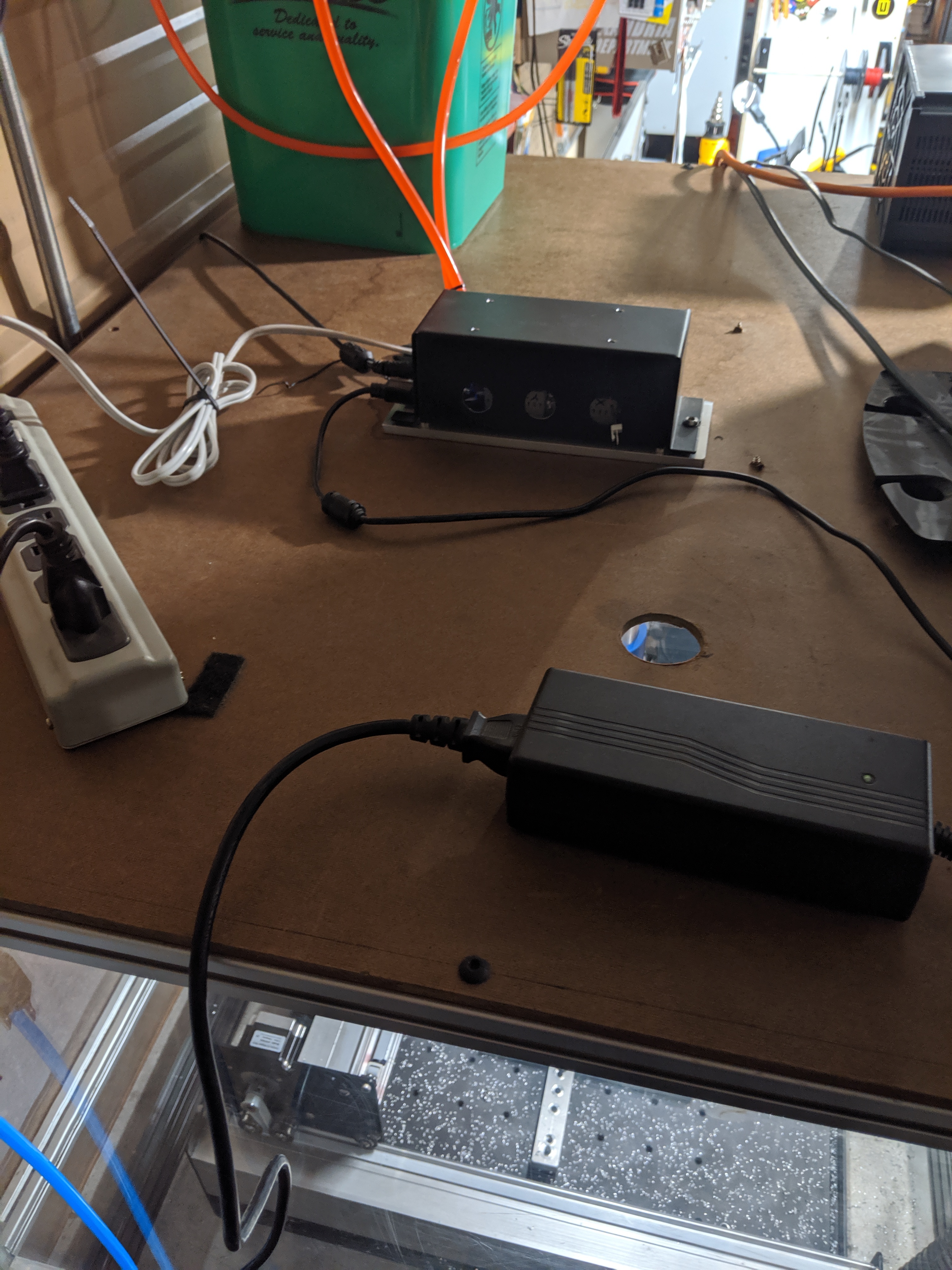

I wanted to get everything installed and confirm that it runs properly before finding a permanent place for everything like the VFD, water pump etc.
Before booting up the spindle, the machine can rapid and jog in all directions flawlessly.
The issue: Once the spindle is turned on GRBL outputs “Error (x) GRBL ERROR: Serial Port: Unkown Error” and the machine becomes disconnected. The issue is directly related to the spindle turning on. The VFD can be powered on and the machine will move perfectly fine, but repeatably once the spindle is turned on the machine disconnects. I put an “x” on the Error number as I have gotten a (3, 31, 34, 35, 39 &41) and those are just the ones I’ve written down.
I’ve had issues like this with my SO3 and SO3 XL (seems to be a pattern) but usually have been able to solve it by making sure there are are no other cables touching the power cable or USB cable since as far as I know the EMI messes with the controller or something. I’ve had this problem before on this exact machine and solved it with some combination of moving around power cords and USB cables until it was happy again.
It seems no combination of moving the cables will resolve this. The power cable and USB cable is not touching anything else. I even moved the spindle cable going to the VFD out to the front of the machine to see to make sure it is not touching anything.

I have grounded the machine, The threaded table is bolted to the countertop with M6 screws and the screws are connected to a earth wire going to an outlet.
The only thing I can think of to try next is to change the cord going from the spindle to the VFD. It came with a 12/3 cord, so no grounding wire. I could get a 12/4 cord and use the grounding wire and see if that makes any difference?
