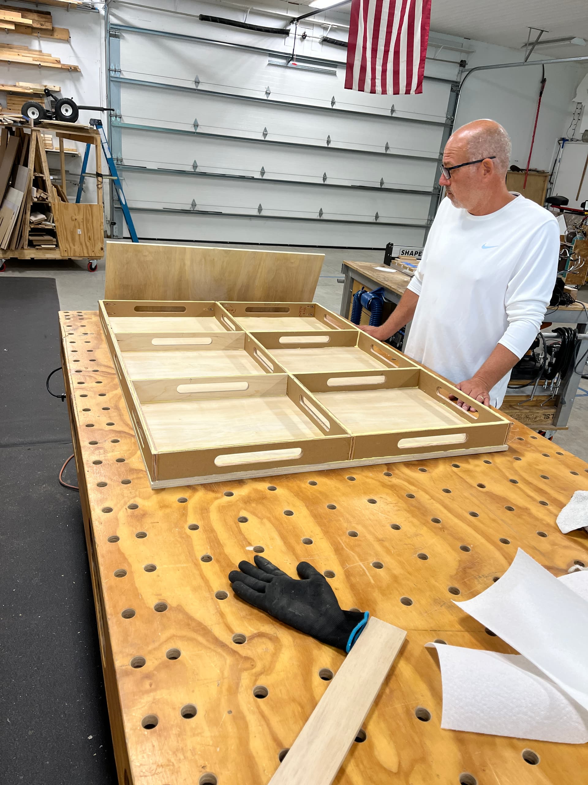

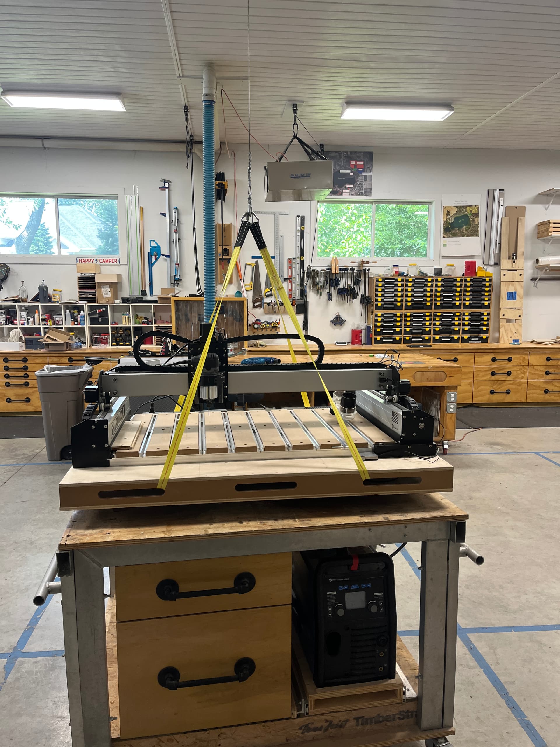

Yes, folks have done this.
We recommend making a torsion box and blocking the machine in at the corners — directly using straps creates the possibility that uneven tension on the straps could torque the machine out of square.

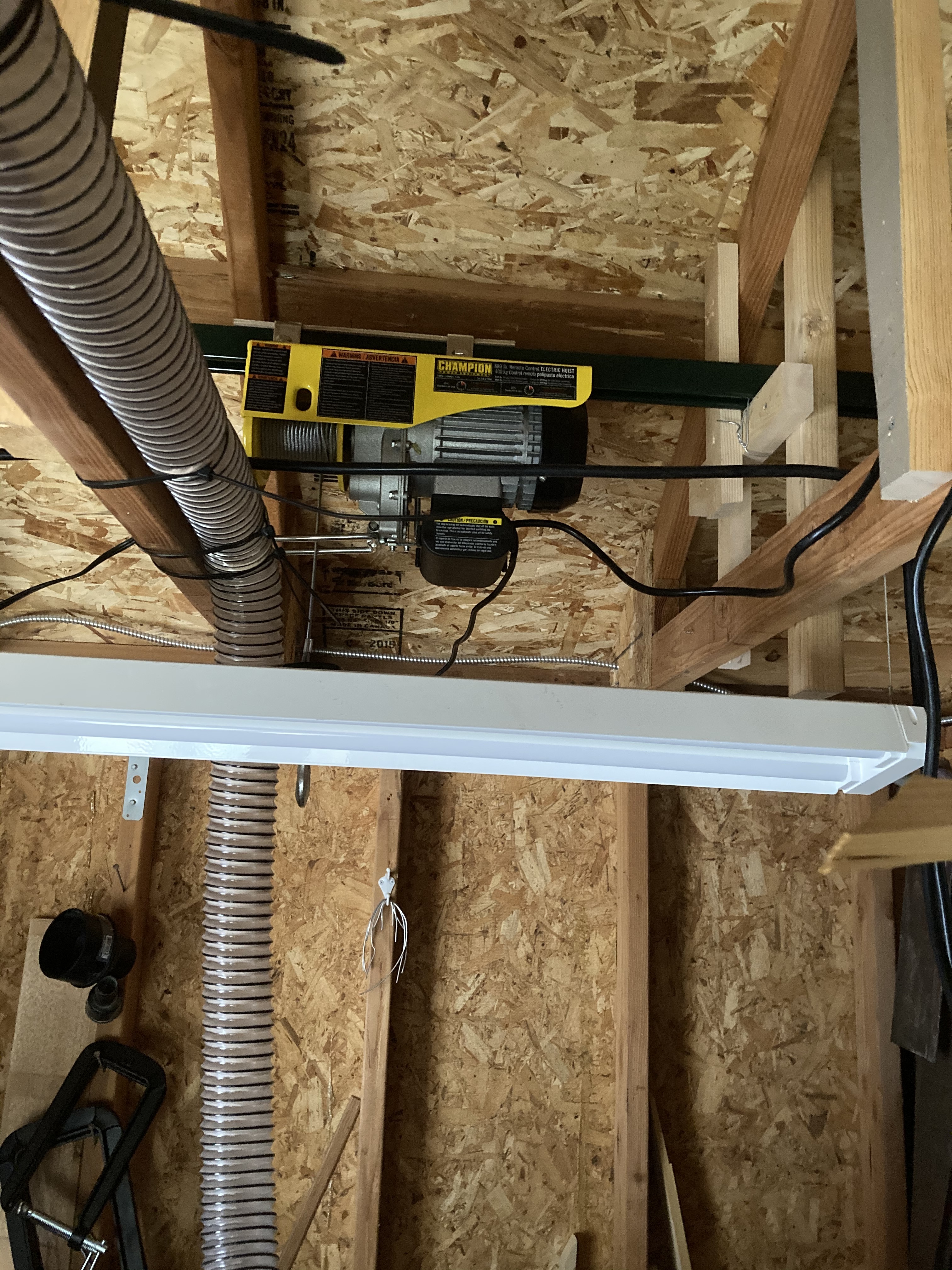

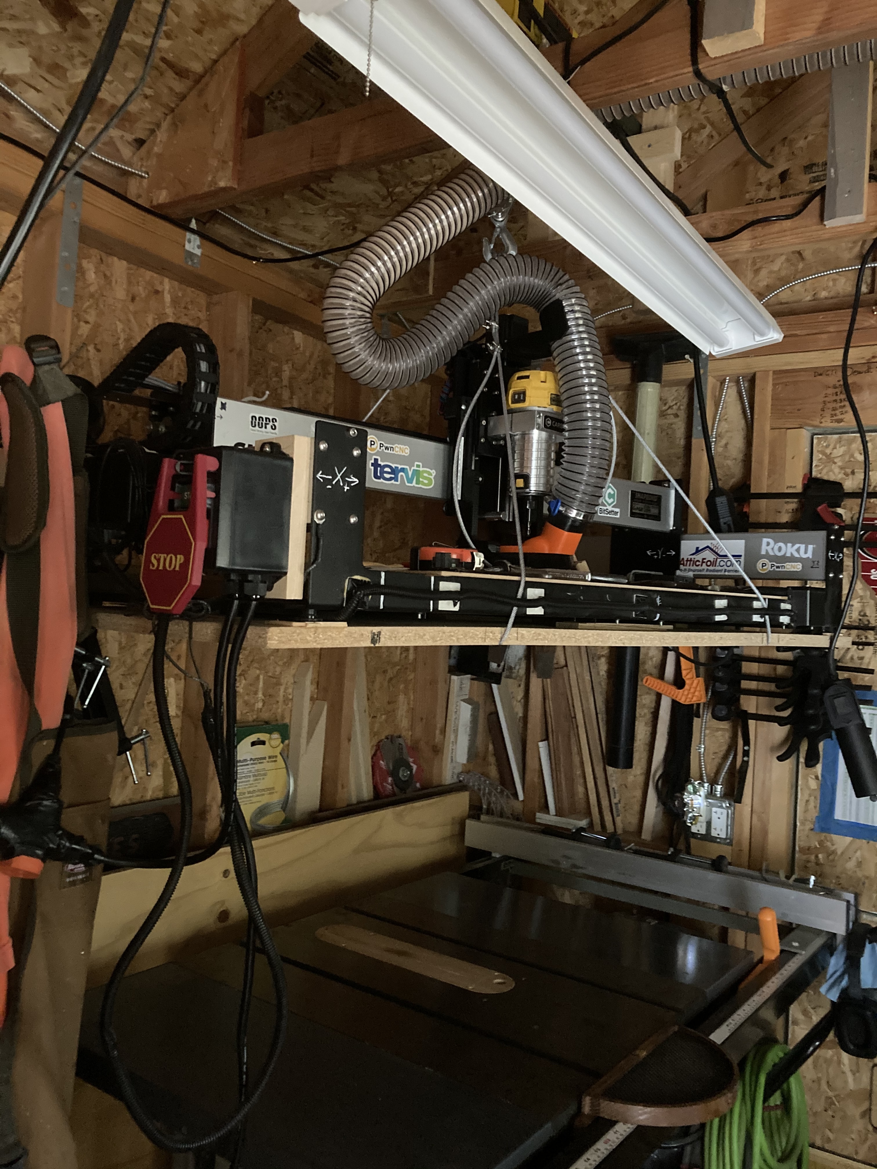

Yes, I have the Shapeoko 3xl. I have a piece 1”plywood under it. Small 1500lb Champion winch in rafters. I reinforced the roof rafters for winch mounting ran 1/4” vinyl covered cables under plywood (made small grooves in plywood for cables to lay in) when lifting machine cables do not slide. Works great for my needs. My CNC lays on top of Delta table saw. I
Just raise it up out of the way as needed. My shop is only 10x14. So every inch counts.
That is exactly what I was thinking. Thank you for the pictures, helps a lot.

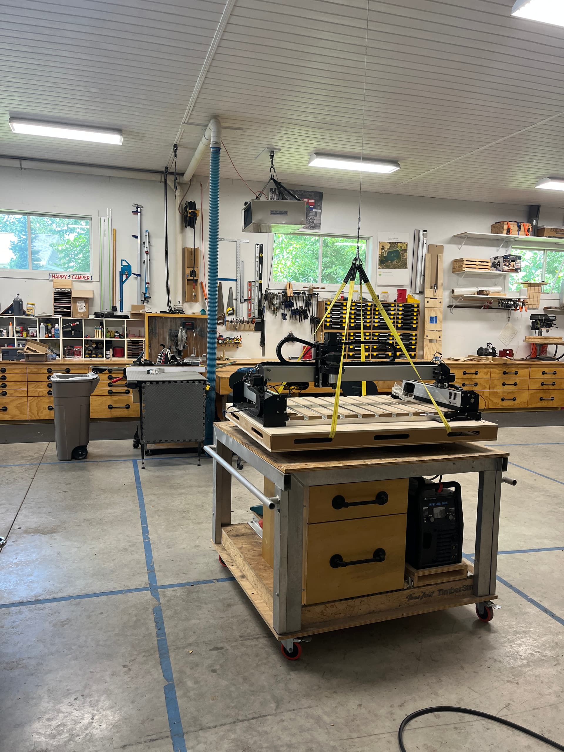

Torsion Box built and definitely the way to go. If someone ends up here in the future looking to do the same thing here are a few pictures to help you get some ideas.
