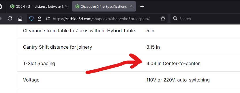

I’m trying to add some additional features to my spoilboard MDF slats, thinking about 8 mm holes that can take wooden or metal dowels. Would like to produce a regularly spaced pattern with known distances true to the X and Y axis, etc.
The following file shows the dimensions of the individual slats:
Is there an ‘official’ reference that shows the distances between the centers of each slat? I know I can measure it, was just looking to see what the real answer should be.
On my HDM they are the same width & they are on 100mm centers.
Its on the specs page. Technically 4" + 1mm, so 4.03937"
Thank you, that’s what I was looking for.
