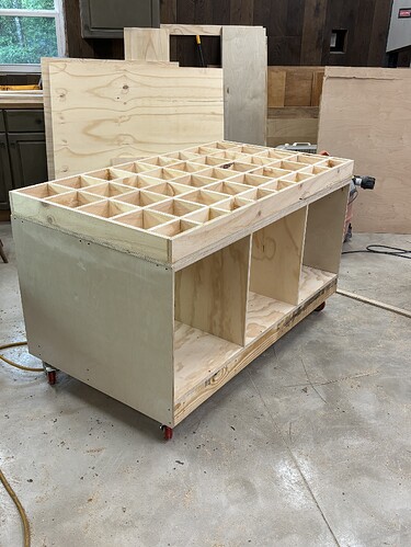

Mine is a torsion box. I worked on it being dead flat and it won’t warp AND is very solid. Grid is 3" with 2 - 3/4" skins. I made the surface so it was the same height as my table saw and work bench so that I can use them as a support table when I need to index for larger signs. And on four casters that double lock.

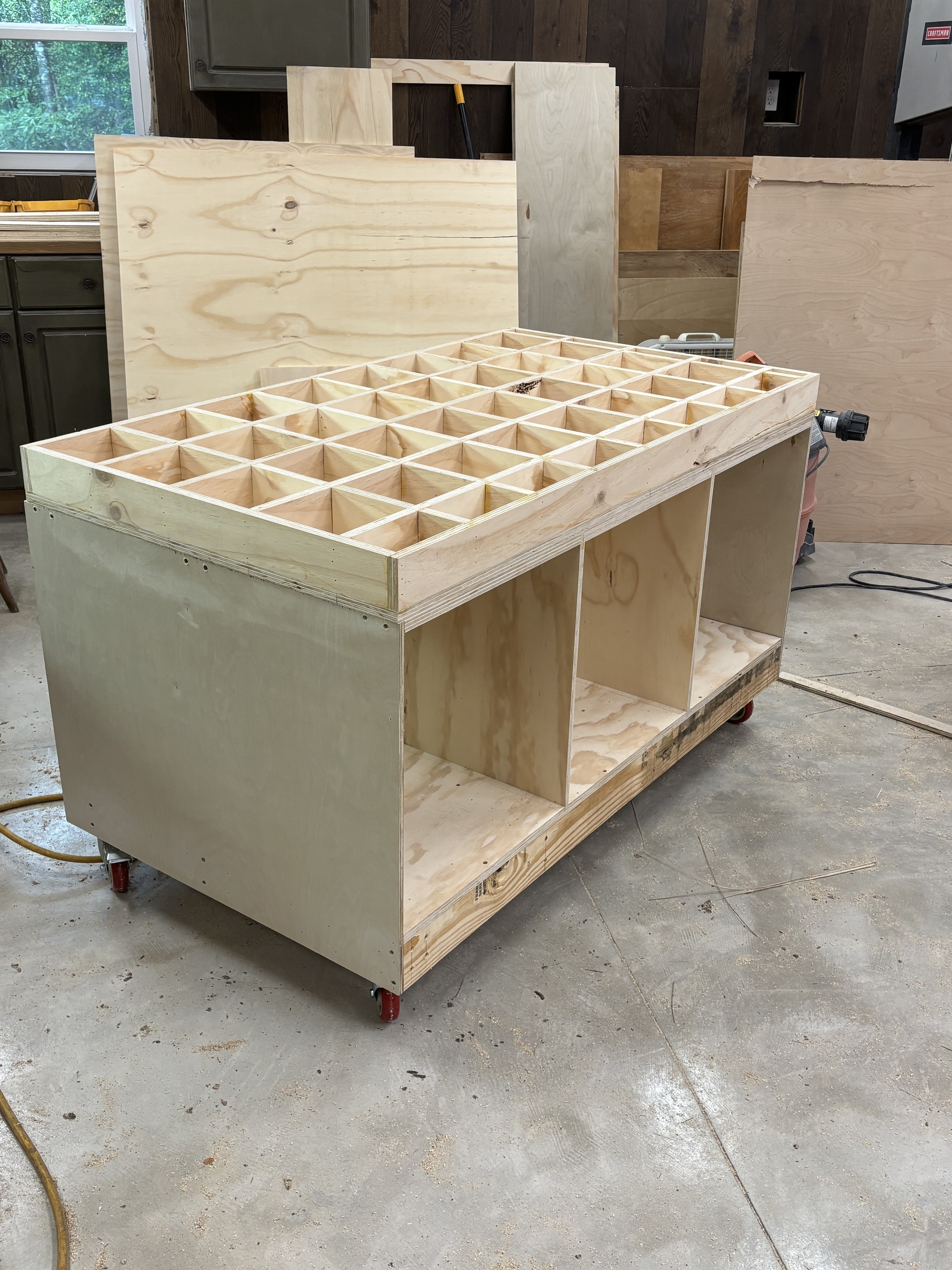

Here it is without the top skin:

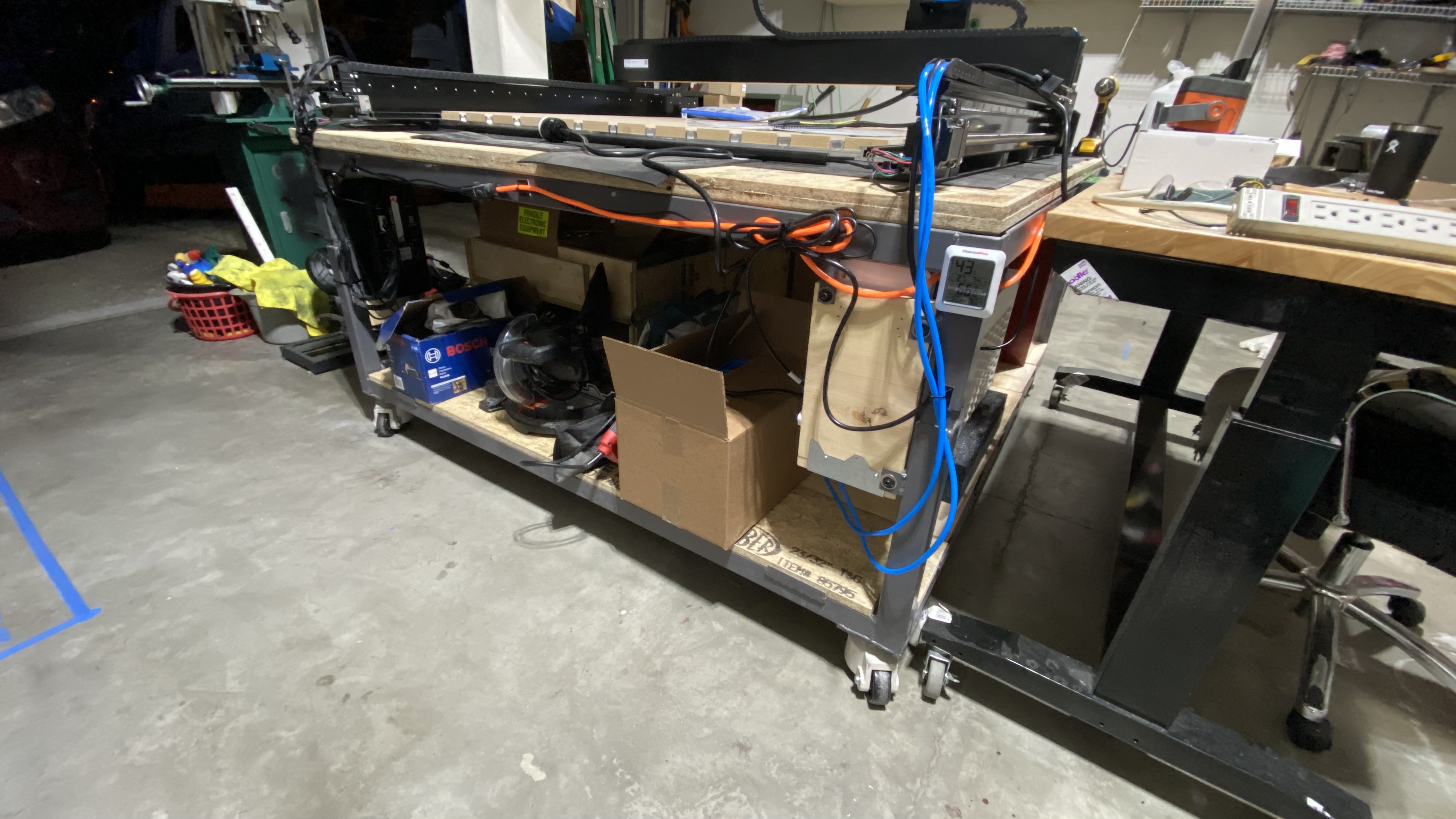

Finally got the Table done and Shapeoko wired up. The main hardness that came with it has minor alligator clip missing/damage and Carbide 3D overnight me a new harness!! What a customer service.
Hopefully getting coolant soon and few mod on my 220V circuit and we’ll be ready for to fire it up.

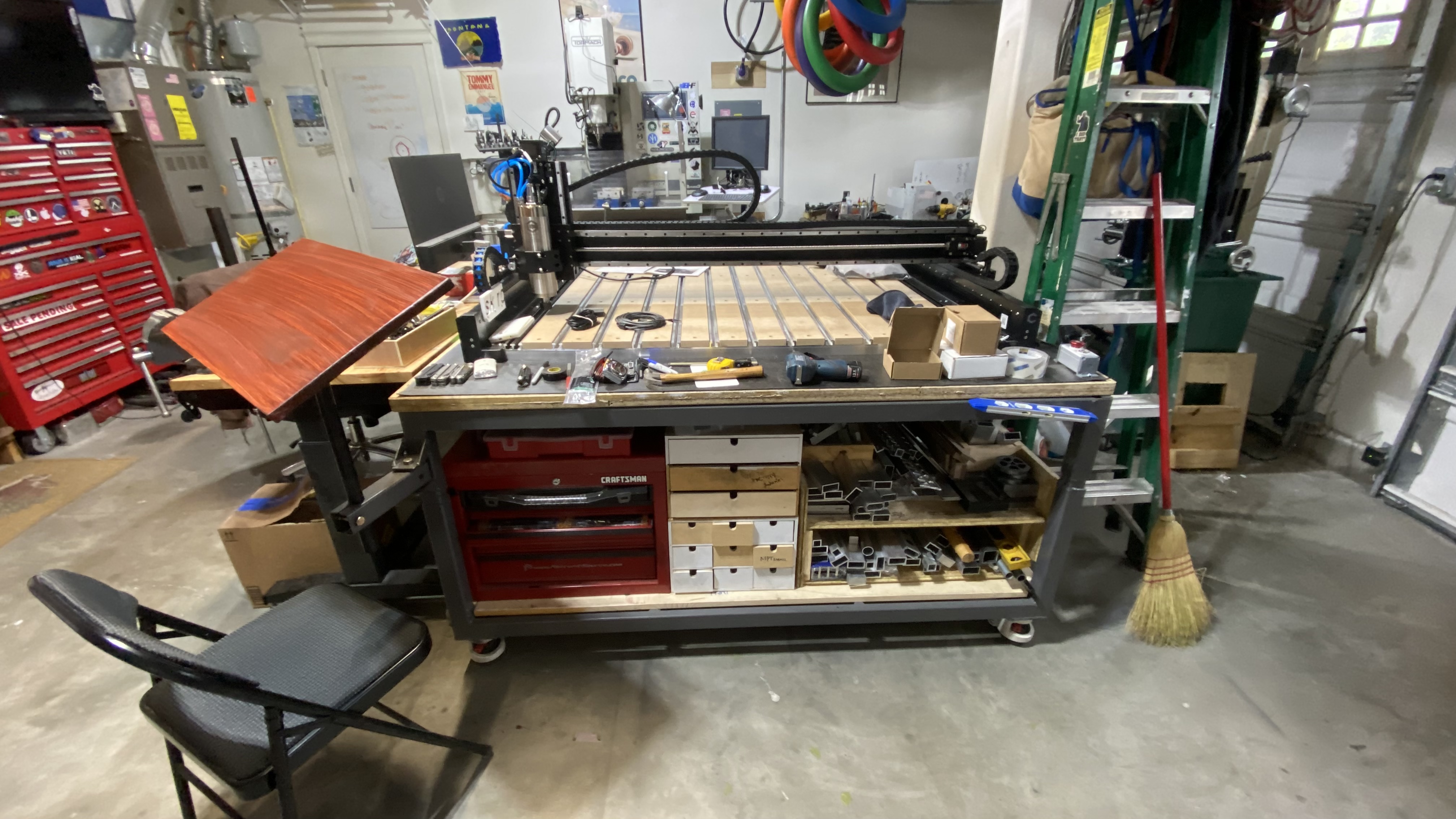

I used a solid core door for my 2x4 machine.
