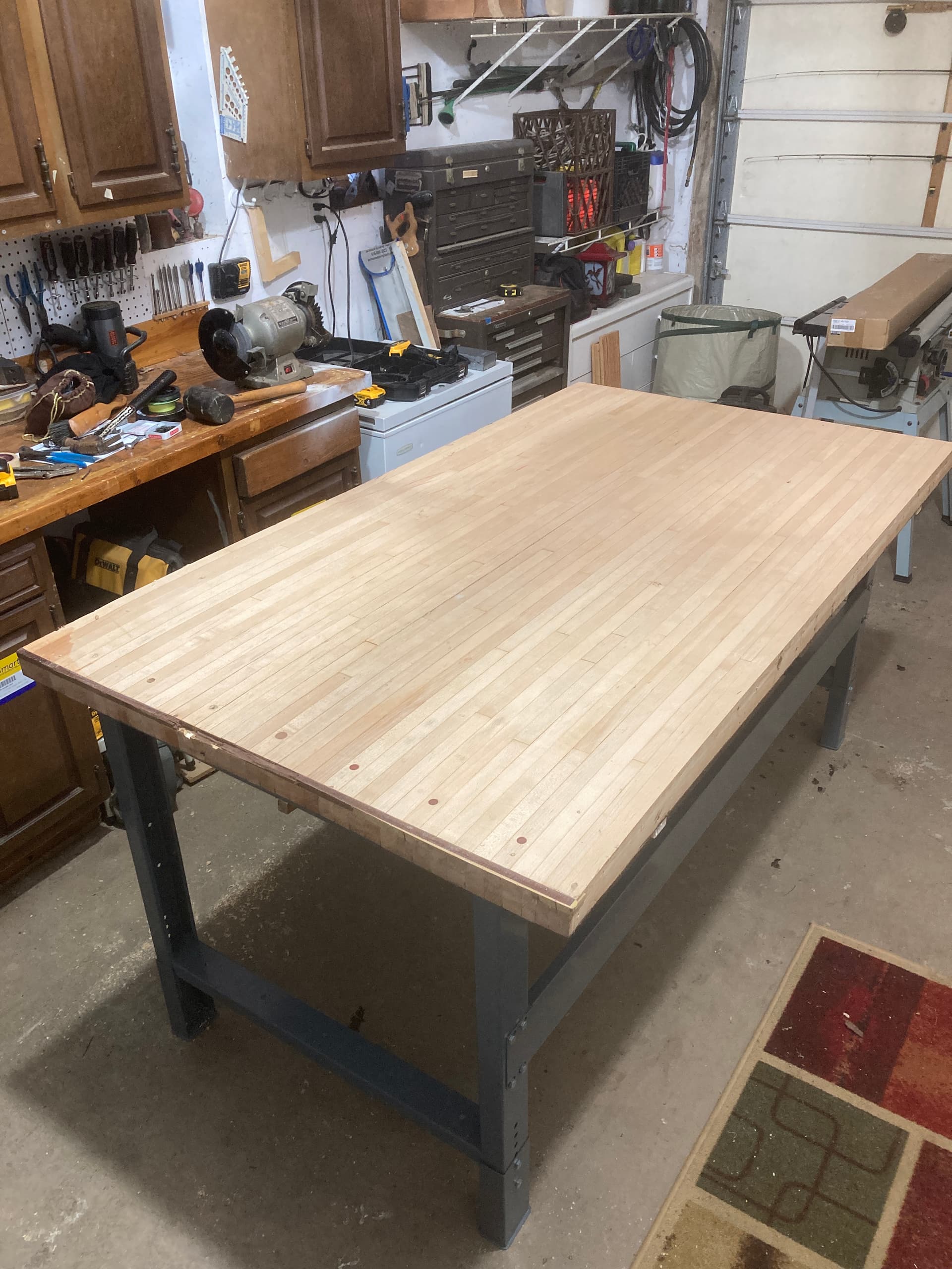

I went with a chunk of surplus bowling alley. 2 1/2" butcher block style maple.

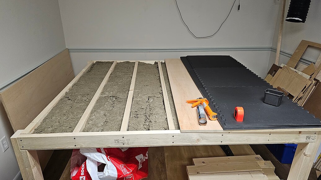

Here is a pic of the floor of my enclosure:
It is 3/4 plywood on top of a 2x4 frame with the cross members 10" on center. If I had to do it again I would have used 2x6, but I mostly cut sheet goods and most of the machine weight is transferred down on the outer edges.
What’s the insulation for?
Sound deadening. Here is the mostly finished enclosure:

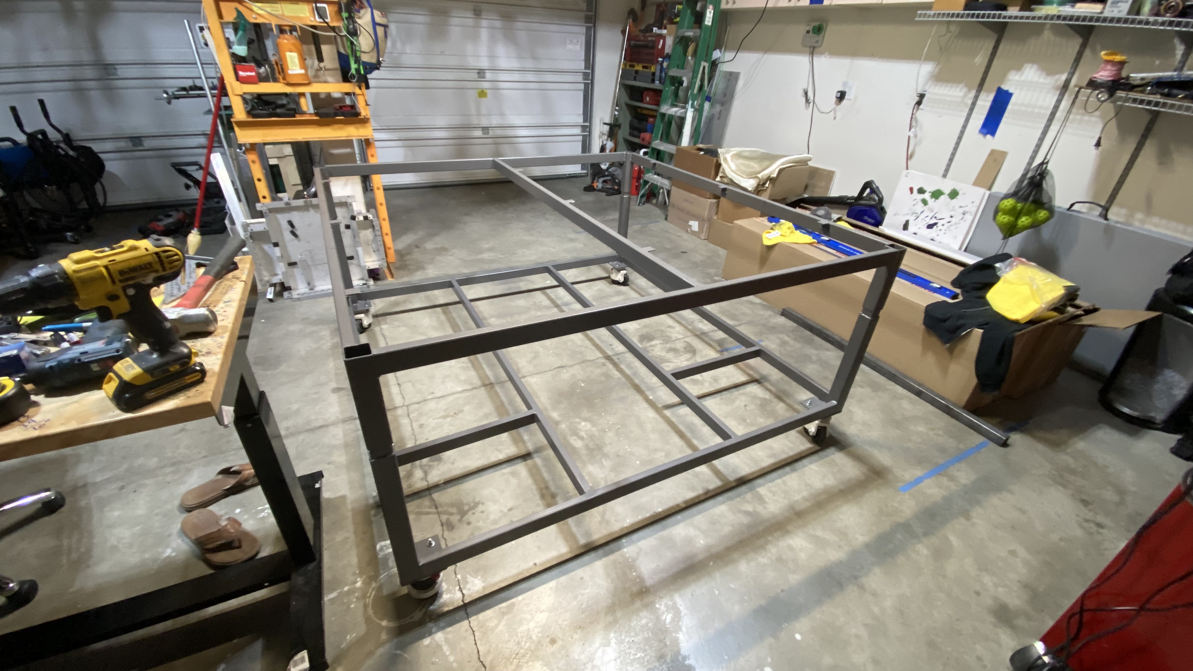

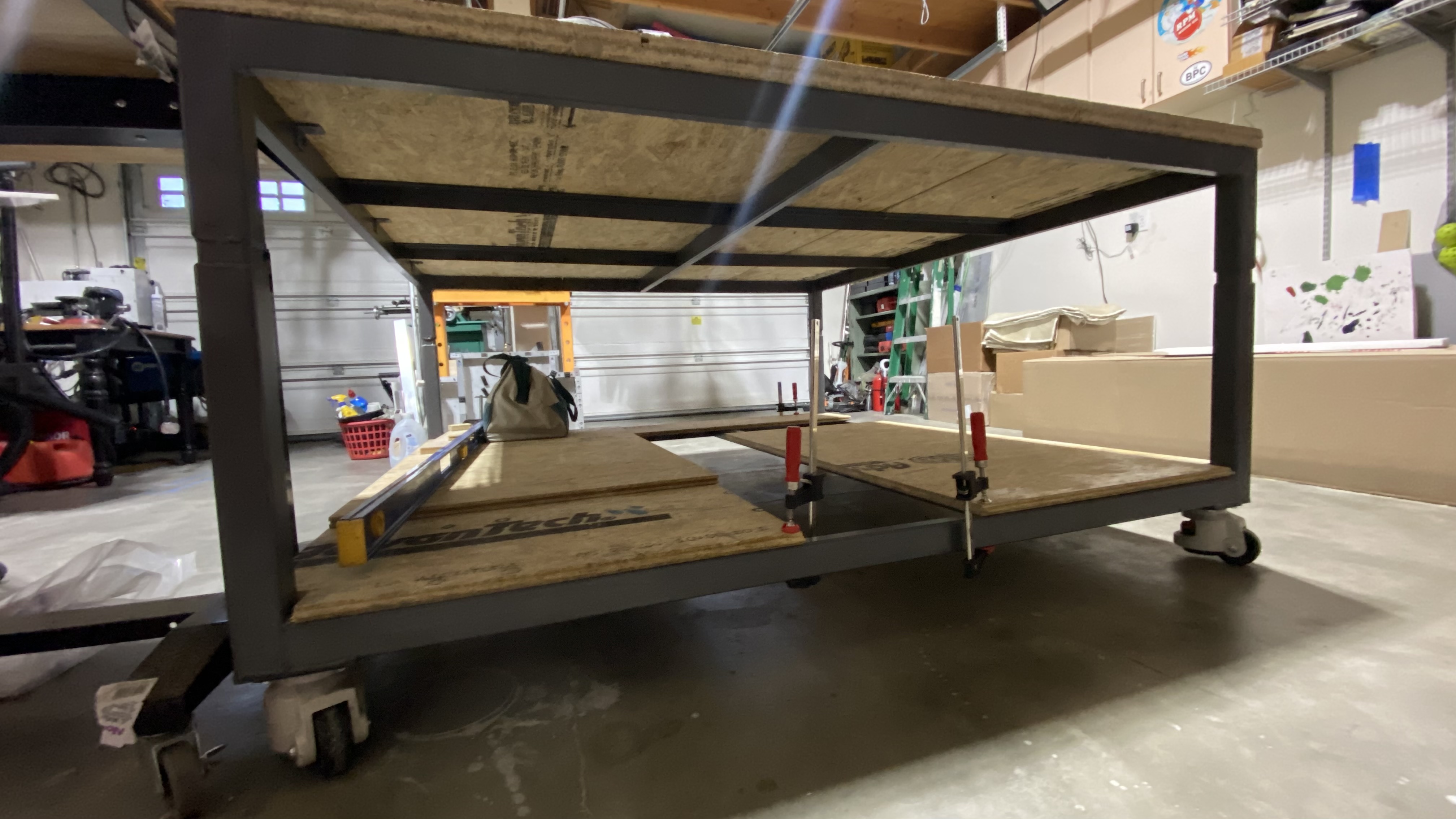

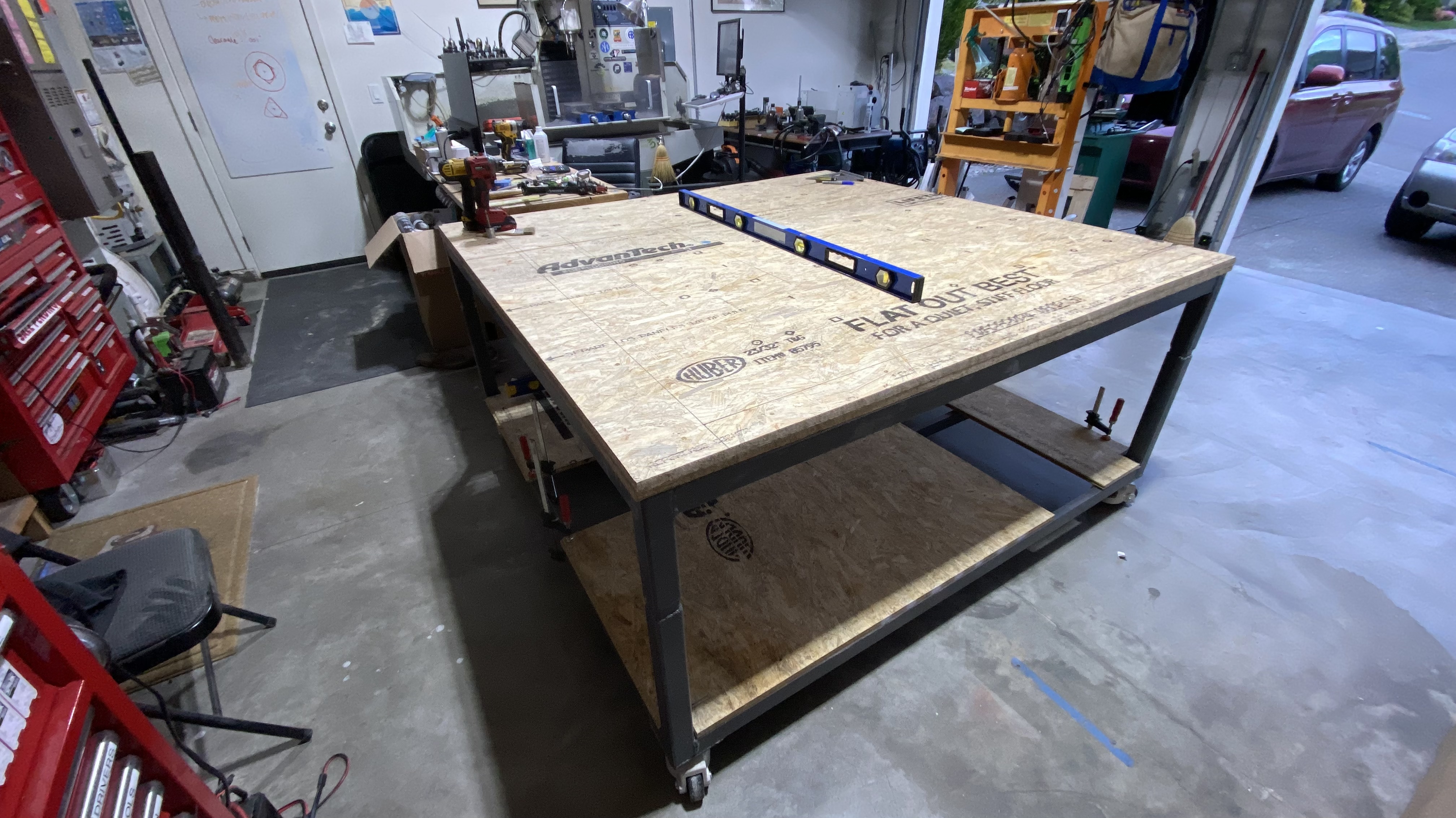

I ended up with using AdvanTech Subfloorings It’s .72” thick and I doubled it. It’s way stiffer and denser than any plywood, so it is heavier too. It bites screw really good. I got the table dead level by shimming on certain locations. When I dropped the casters feet down, it is rock solid, this thing is not going anywhere. I hope that this setup will give the Tormach 1100 run for its money.
I also dropped the height quite a bit. Now it’s 33.5” from the garage floor to the top of the subfloor base.
I see you added more cross bracing under the top.
