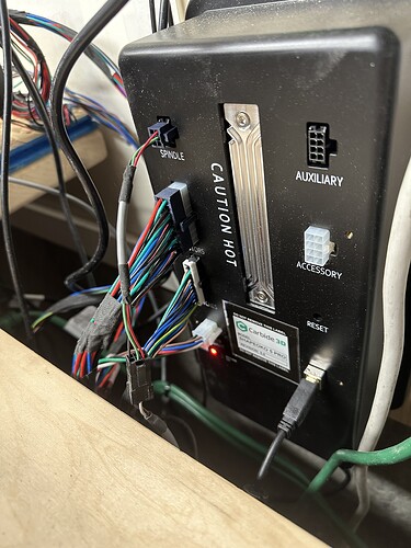

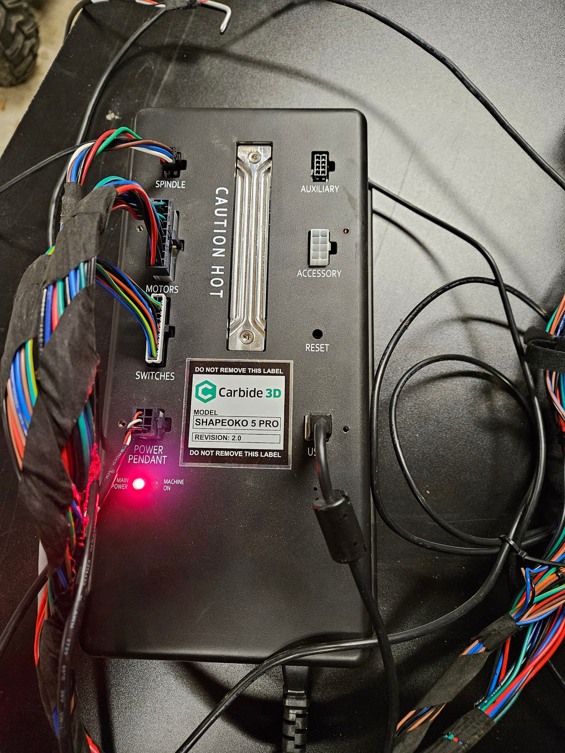

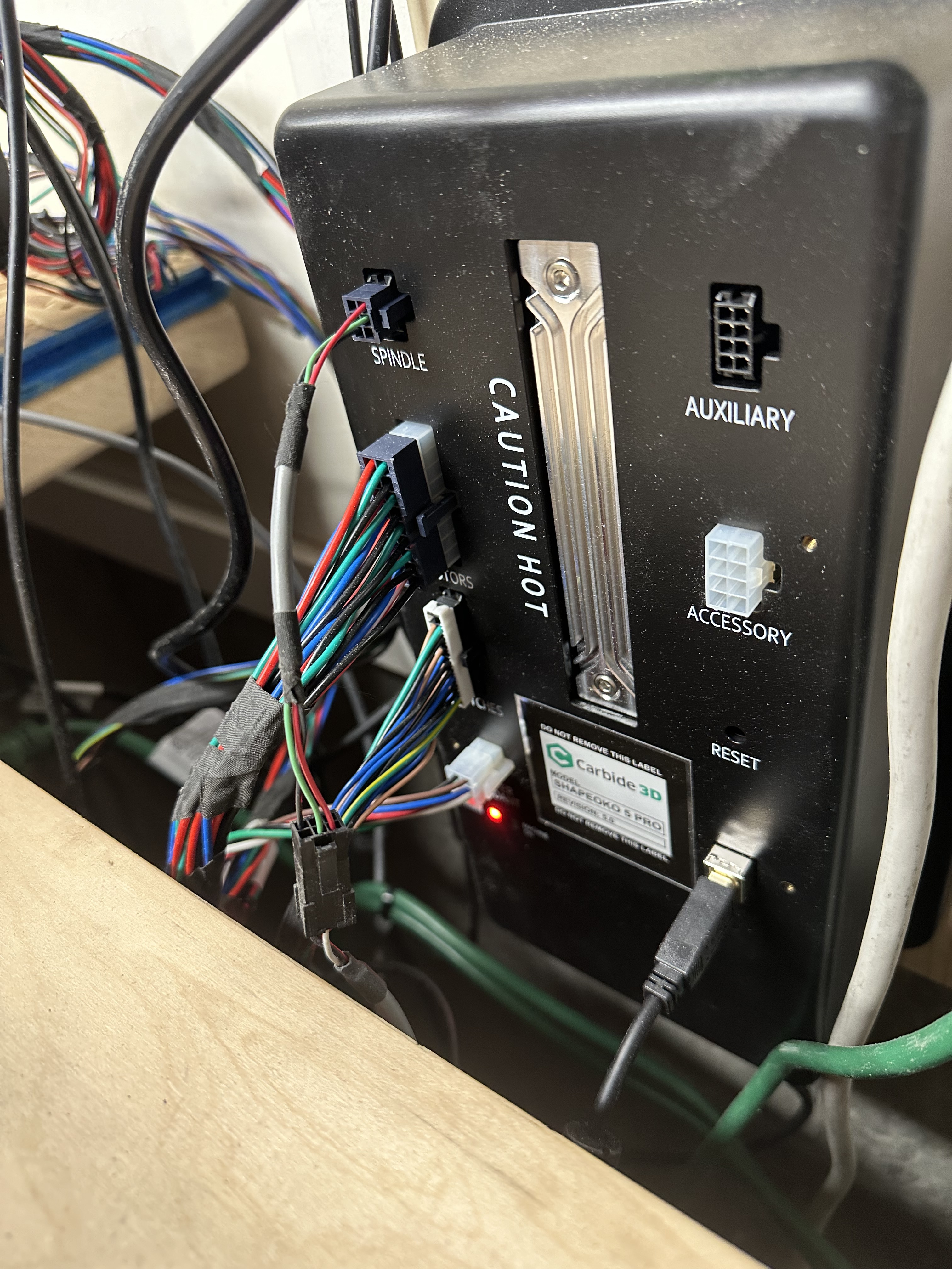

Piked up a SO5 4x2 today from a family member that had owed me some money, purchased software and was ready to go (thats what i thouht anyway) got it home hooked everything up and i have a red power light on power supply but machine wont power up any help would be appriciated.
Maybe a stupid question, but have you turned on the power pendent?
yes i even unpluged it in case it was bad
tried pushing the reset button as well , not sure if that has anything to do with power but i was trying everything i could think of.
Can you take a picture of the front of the control box?
Got pic just have to figure out how to get it on post
Do you actually have a spindle with it, or the trim router?
Spindle the light is on at the pendant
I removed end cover and checked all connections also
I can run the spindle manually from vfd
It looks like your spindle is in the power pendent plug, and your power pendent is in the spindle plug. Switch them and hopefully it works and didn’t burn anything up.

The spindle is only 3 wires and should have an adapter for it.

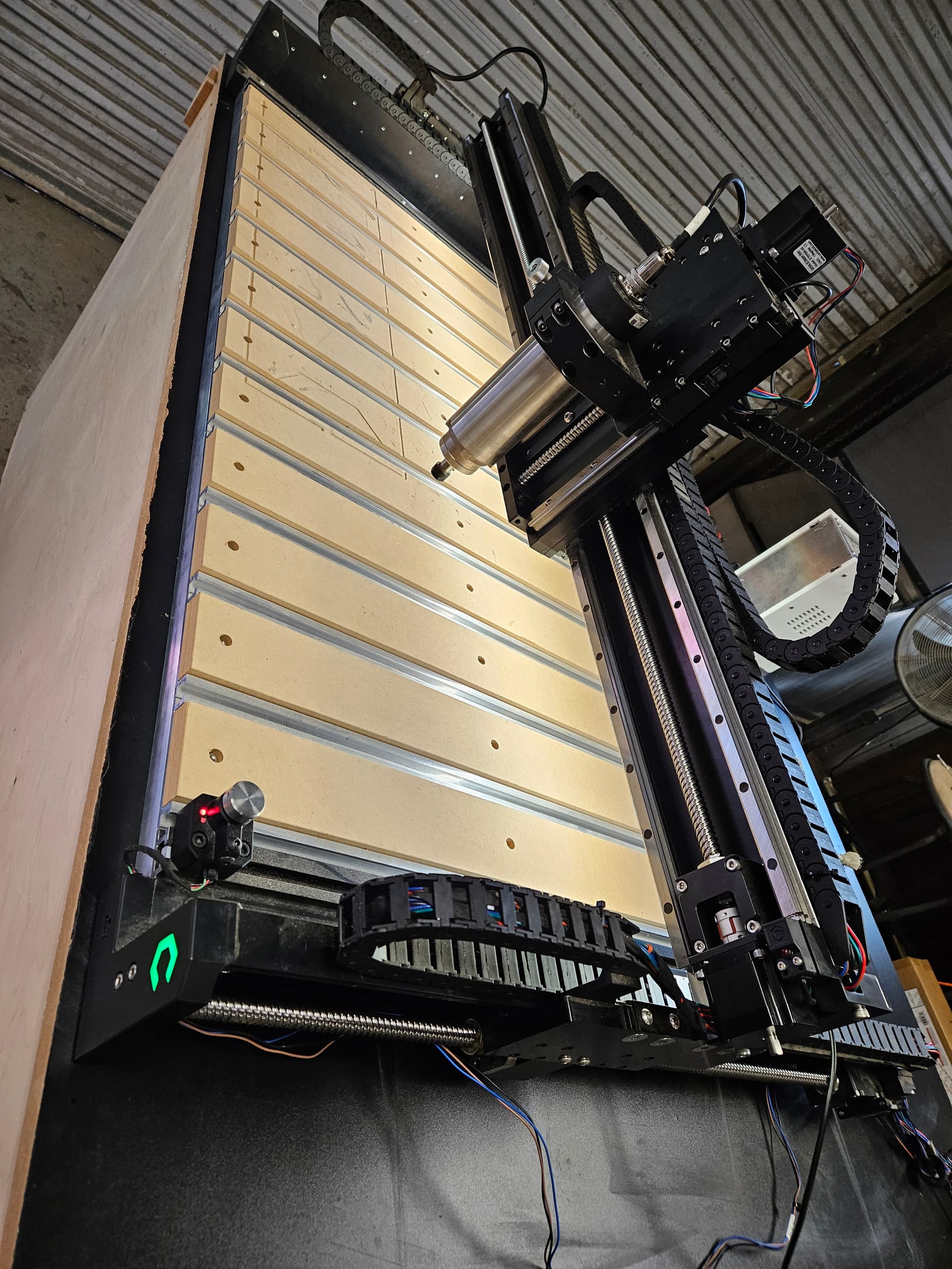

Man you are the bomb :bomb: thats exactly what it was i guess i shouldn’t have said not possible when im the dummy lol thanks again for taking the time to help me out now lets see if i can cut something
Might want to raise that spindle in the mount some.
Loosen the spindle clamp and run the z to its lowest limit, Put the shortest bit you think you have in the spindle collet. Let the bit touch the spoilboard and tighten the spindle clamp.
