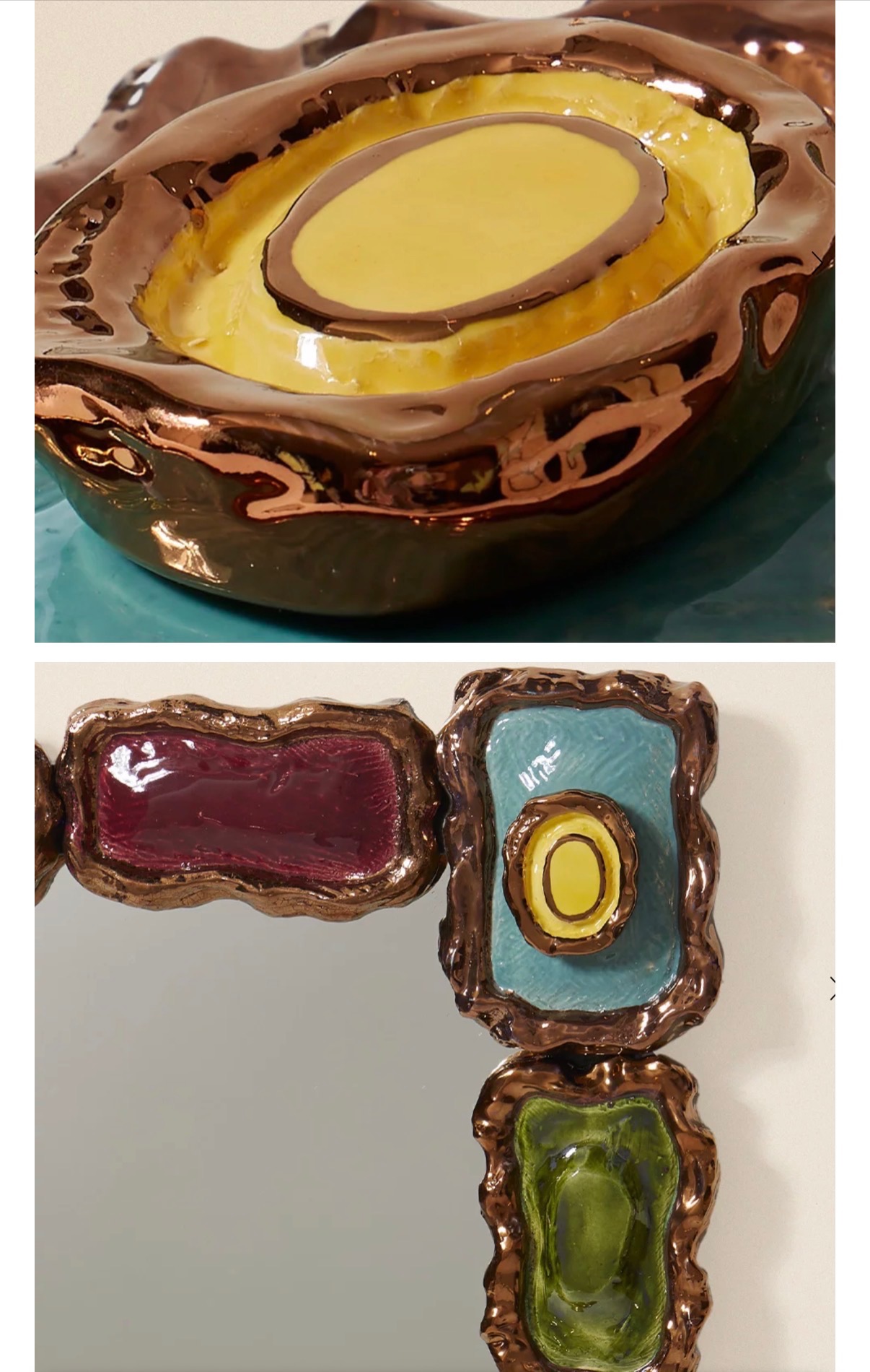

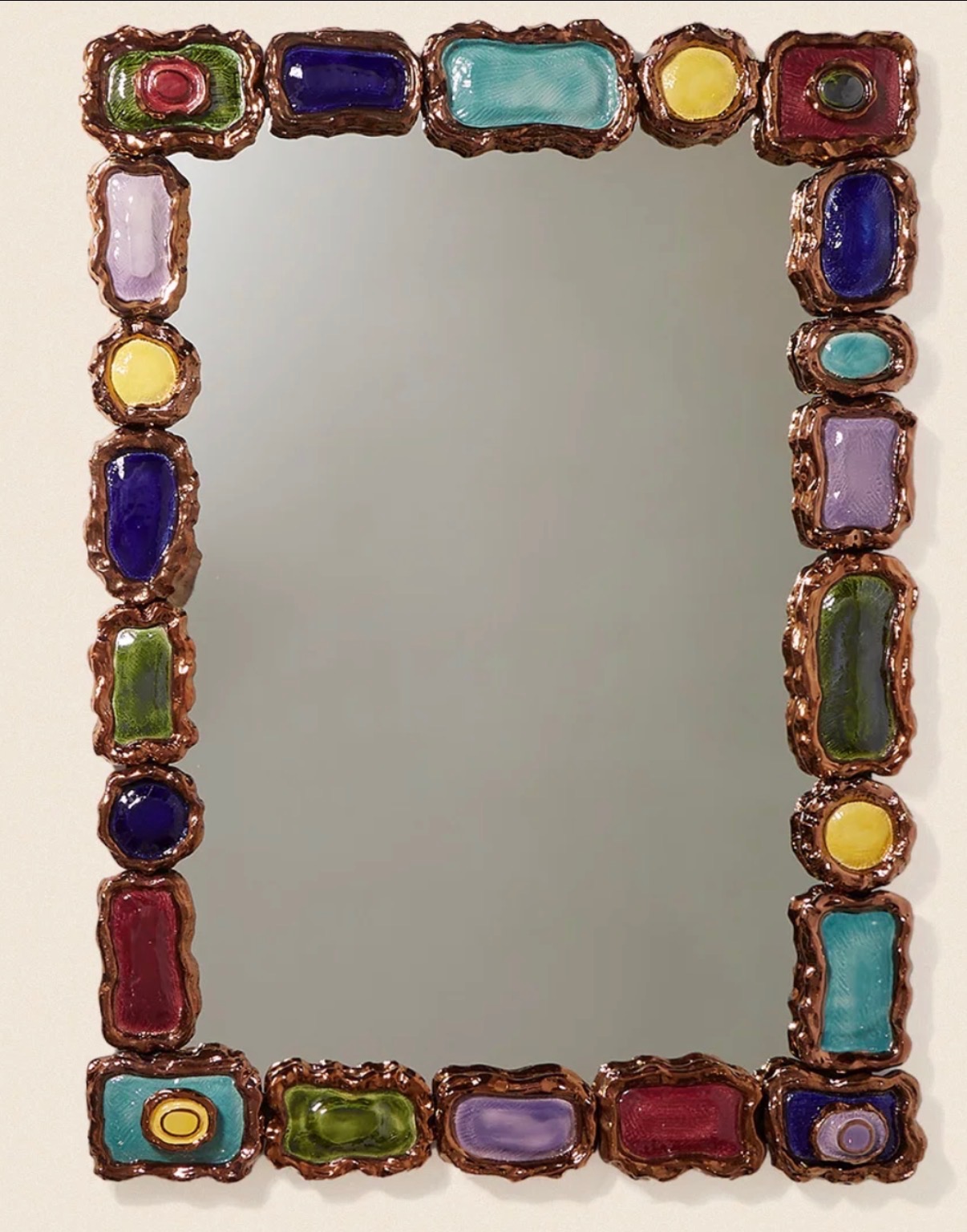

So my wife wants this mirror, but wants it out of wood. I wanted to see if anyone has any suggestions on how to design this. She wants the outside edges to be 44 inches X 32 inches. If I can carve out 4 sides, I can easily join them as a frame for the mirror.
Any help getting started would be great!

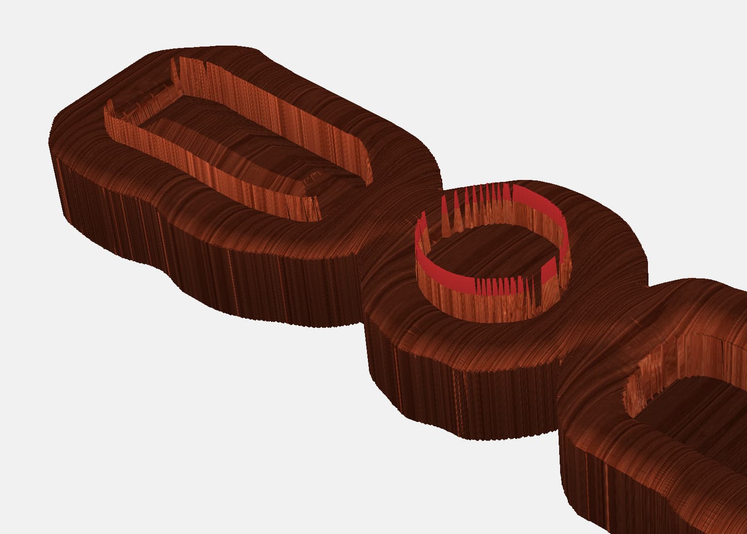

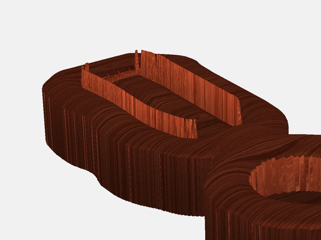

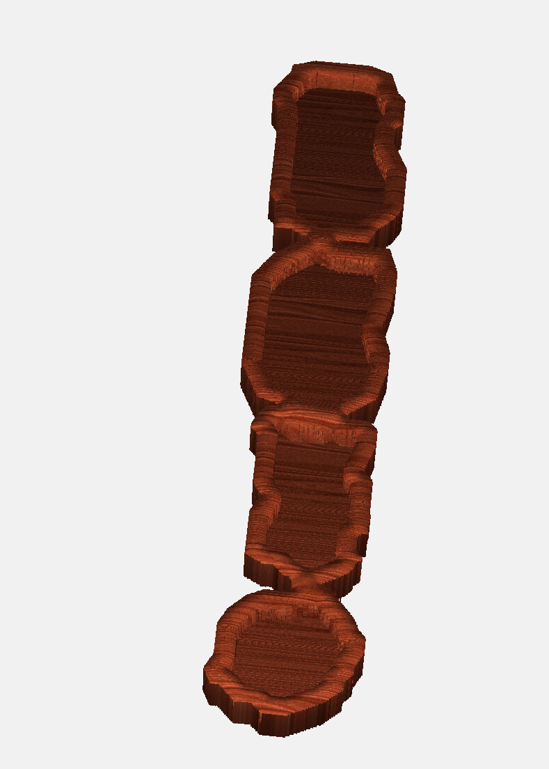

I can’t get this to stop happening when I add components to the center of the cutouts
You need to be careful of re-using geometry — offset to one side or the other.
I see.
I offset it .05 and I recreated it. Will this carve out a gap or no?
It will cut according to the settings of the 3D toolpaths and how they interact with the selected tooling.

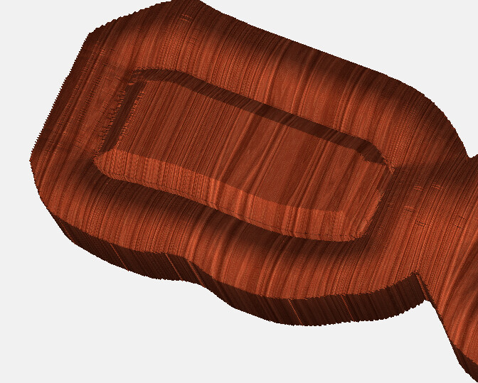

See:

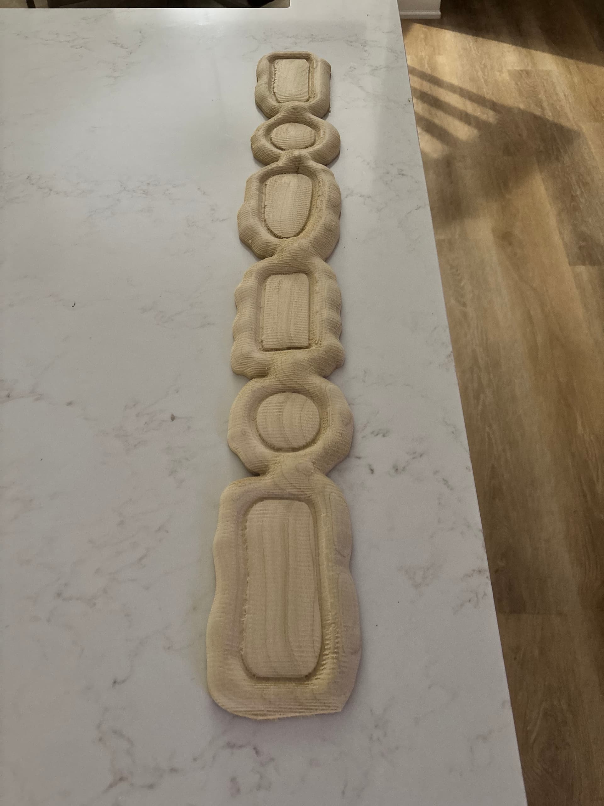

Not too bad. I used a 1 inch piece of stock, poplar. I wanted the piece to be thicker and not cut as much off the top. If I add some base to it and do a little math, i feel I will accomplish my goal.
Any suggestions?

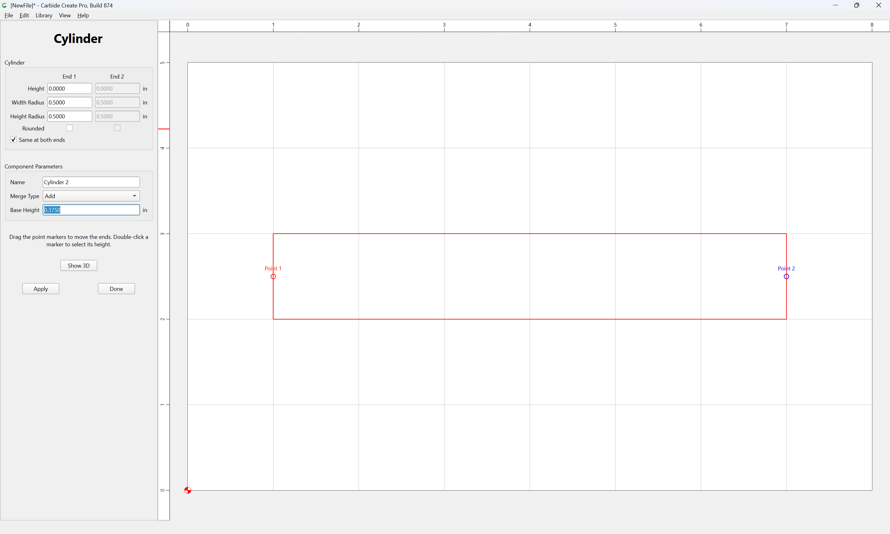

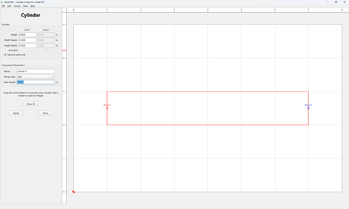

If I wanted this to end up thicker, do I add a base to it with thinker stock material? Can I use the same tool paths?
When working with a 3D model you can increase the Base Height:
to control overall thickness beyond what the 3D model wants.
While it’s possible to leave material/stock uncut. I find it makes the most sense to just model at the desired size/thickness.
