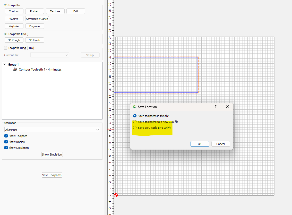

If you buy the “Pro” version of CC then you can export G-code.

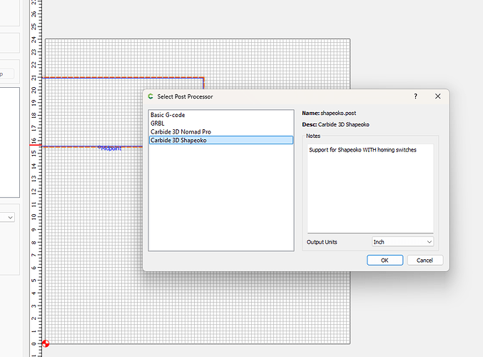

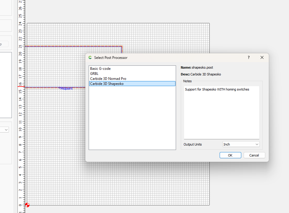

Carbide Create Pro
allows choosing post-processors which match a given machine — if the options (Basic G-code, Grbl, Carbide 3D Shapeoko) then a custom post-processor may be worked up:
https://carbide3d.com/hub/faq/create-pro-custom-post-processor/
IDK about that version. I am running 757. I do have pro.
Post Processor options:

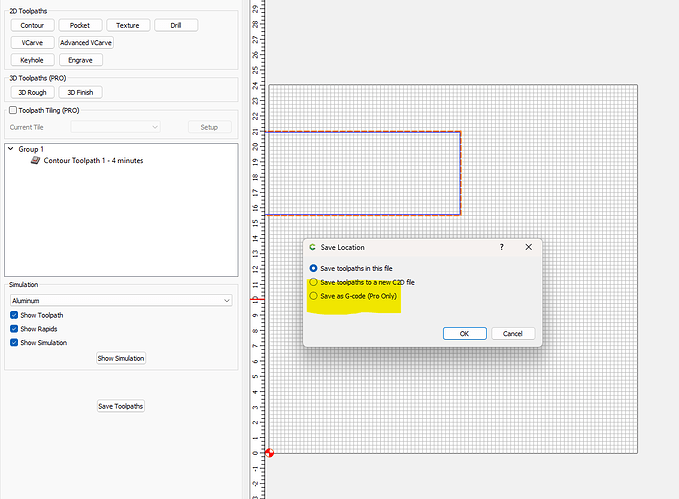

This is true. (NOT!) Sorry, I replied erroneously. I have the current CC Free version 8 and didn’t know (until reading Will’s post below mine) that gcode output had changed. The only way I can export gcode to examine is to save it out from Carbide Motion, the gcode sender that is bundled with the C3D machines. Otherwise, as has been pointed out, the gcode is embedded in the .c3d workfile on versions 7nn and up.
Carbide Create v6 would output G-code.
This was changed in v7:
https://carbide3d.com/blog/carbide-create-v7/

For that, you just need a Carbide Create Pro license:
