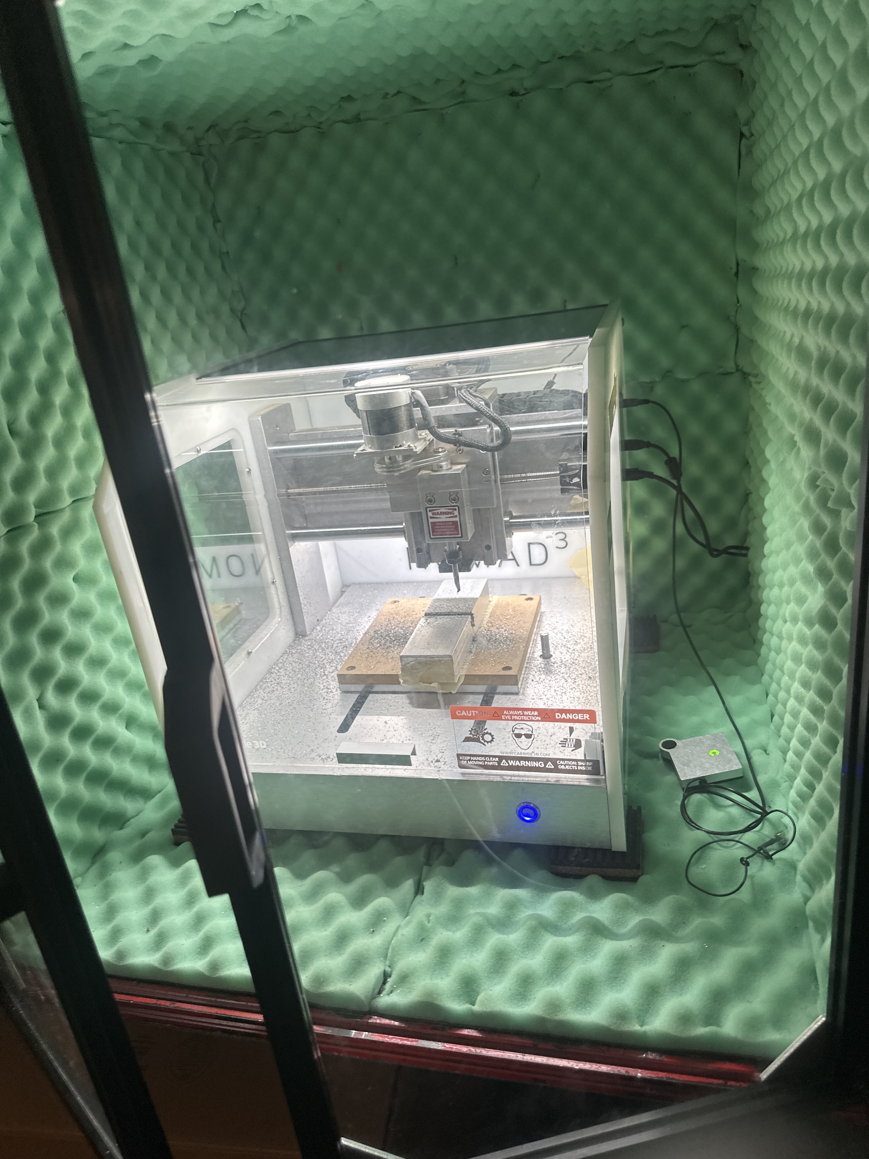

I recently created an enclosure with 2 mass loaded vinyl layers one on the inside and one on the outside with an egg crate sound foam on the inside. I still have quite of noise being produced while cutting aluminum. How does the idea of putting foam in the interior of the machine sound? Do you guys think it’s a good idea? I need feedbacks and don’t want to just waste money and buy things

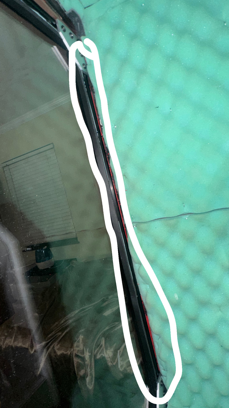

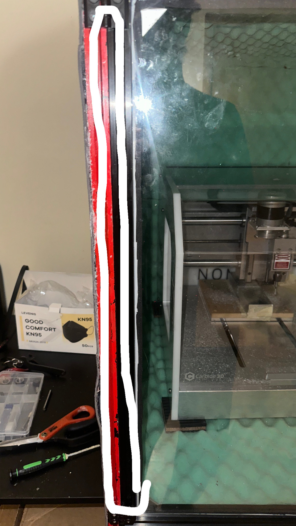

I got done insulating the panel edges on one of the door with weather strip and adhesive tape you can zoom into where the edge of the panel is to see it on the second picture, only problem is where the hinge is located near the structure of the door. I can detect a gap. As you mentioned “applying wool around the edges of the door” especially on the inside where the hinges are will it help out closing the gap and reducing noise escaping? I will then remove the foam on the inside then apply wool then reapply foam. But I’m just curious if wool is all it takes to block sound in the gap proximity of where the hinge are located. Here is a picture for reference. The circle is where the location is.

You’re quite right, the foam won’t be doing much to absorb noise or prevent it escaping the enclosure. This sort of light foam is largely ornamental at the frequencies from a CNC.
This porous structure with low mass and little thickness will have a small impact dispersing the highest frequencies within the enclosure, but the majority of the audible spectrum will pass straight through it, reflect off the solid backing behind it and carry on as if the foam wasn’t there.
Some diffusion or absorbtion on the inside of the enclosure would likely reduce the sound passing through the doors by reducing the noise level in the enclosure, rubber carpet underlay or similar high density, and less flammable, materials are a common choice for that.
Otherwise, as suggested above, some nice thick rockwool, something like the heavy acoustic grade knauf earthwool if OP can find it, in a sandwich to absorb sound energy on it’s way out of the box is likely the best bet, once the sound leakage via the doors is managed.

  • Figure out a way to make the enclosure door close onto a foam / rubber type seal, there’s lots of weatherstripping products out there for draft proofing doors that should work, then the noise isn’t leaking around the doors. Remember you’ll need some way for air to get into the enclosure to make up for the extraction though, a length of 4" pipe with a couple of 90 degree bends for an intake can block quite a bit of noise

  2. All sides of mine have doors. So one in front half of top, two on each side and two on front. All these bring gaps, so I put a wool felt bead buried half inside the door edges. Makes a big difference
