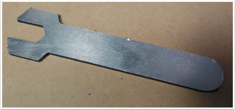

What about using ACM instead of solid aluminum?
What’s ACM? Some kind of laminate?
Aluminum composite. Really thin layers of aluminum with a hdpe core. Machines like plastic. If you get the colored kind, I think you could laser off the color (never tried that).
As @neilferreri says it’s an aluminium composite. I think it’s pretty much the same thing that makes up the lid and base of the nomad, and a piece is made available for making the “spanner” project.
One problem might be that it is pretty much plastic, it has a plastic sound when tapped, and the edges are rough and hard to finish.
If you are aiming your Eurorack at a certain market, they probably won’t like it in their rack.
