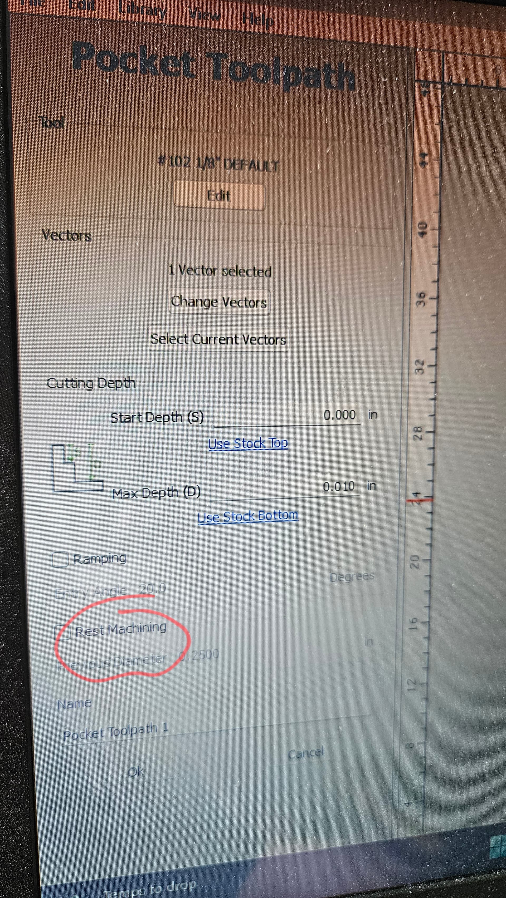

Actually, since you have PRO, you can use REST machining instead. Create one pocket for the 1/4" bit, then create another pocket using the same vectors for the 1/16" bit, and check the ‘REST machining’ box. Enter the previous size (1/4", or 6.35mm), and the 1/16" bit will only machine the parts that the 1/4" couldn’t reach.

Just adding a pic for extra help
