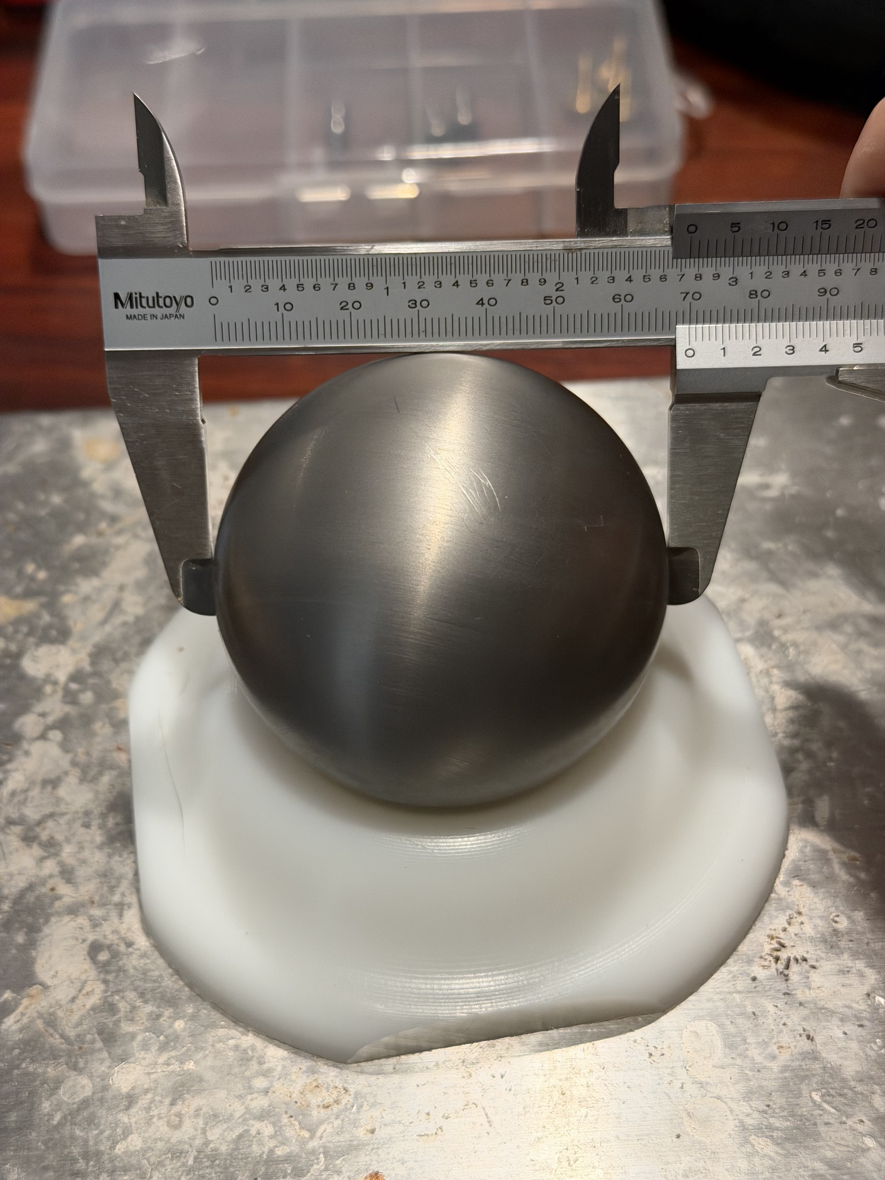

First up, we’ve got to figure out the size:

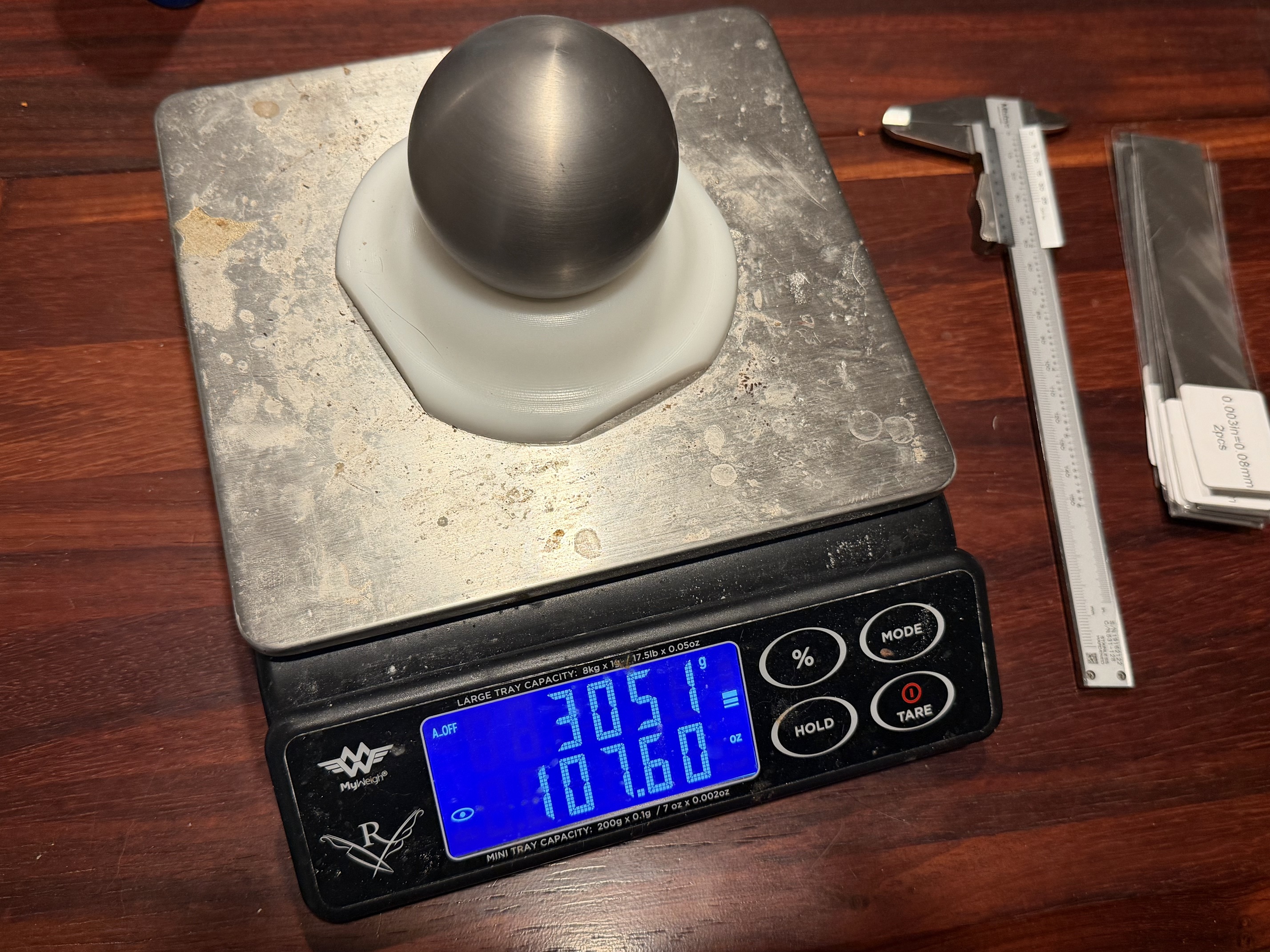

Tare the scale with the prototype holder and we get a weight of 3050 grams.

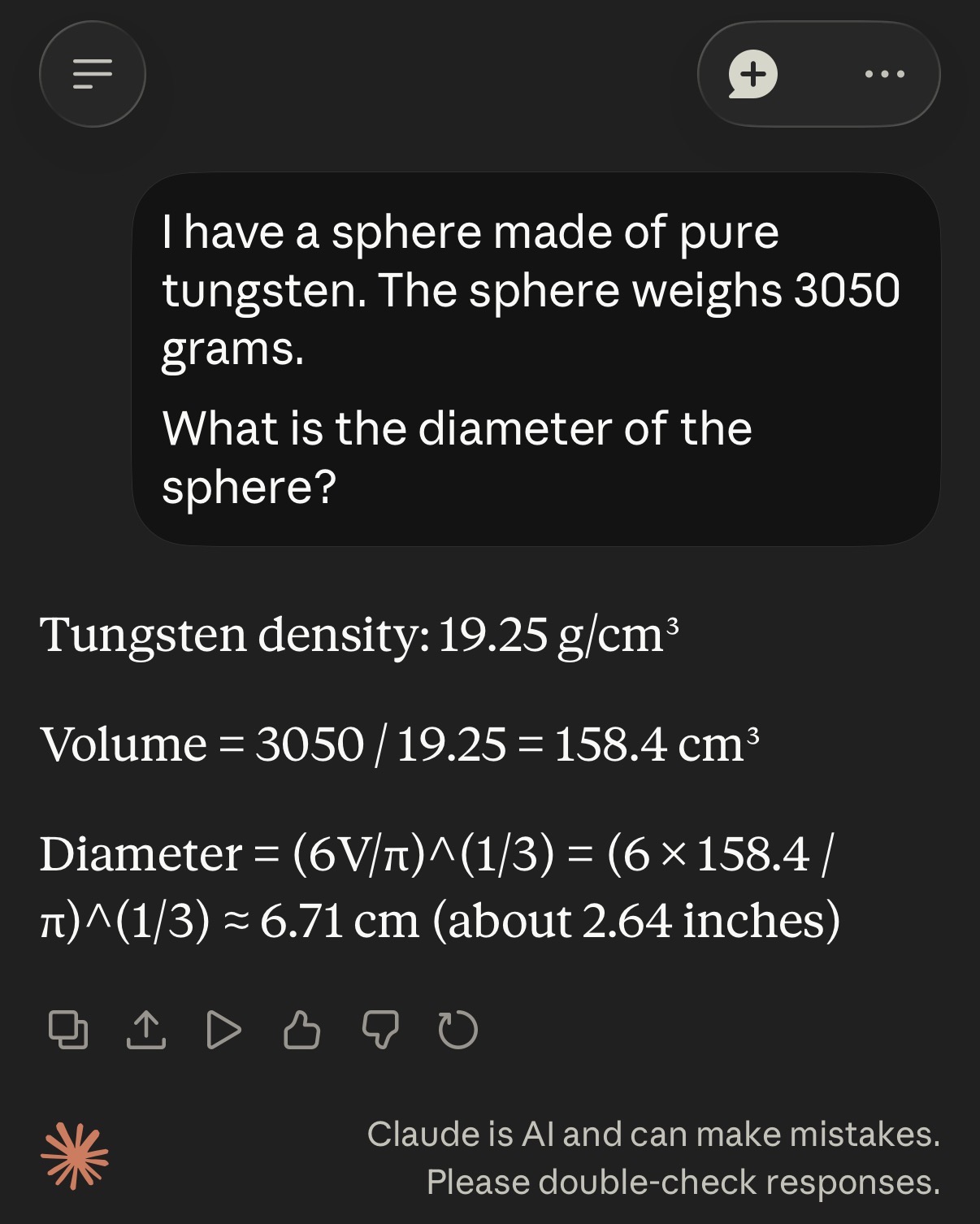

Luckily we can just ask Claude to figure out the diameter:
We know the density of tungsten is: 19.25 g/cm³
Volume = 3050 / 19.25 = 158.4 cm³
Diameter = (6V/π)^(1/3) = (6 × 158.4 / π)^(1/3) ≈ 6.71 cm (about 2.64 inches)
Now there’s always a disclaimer with ai so we should double check it’s work:
Meh, close enough.

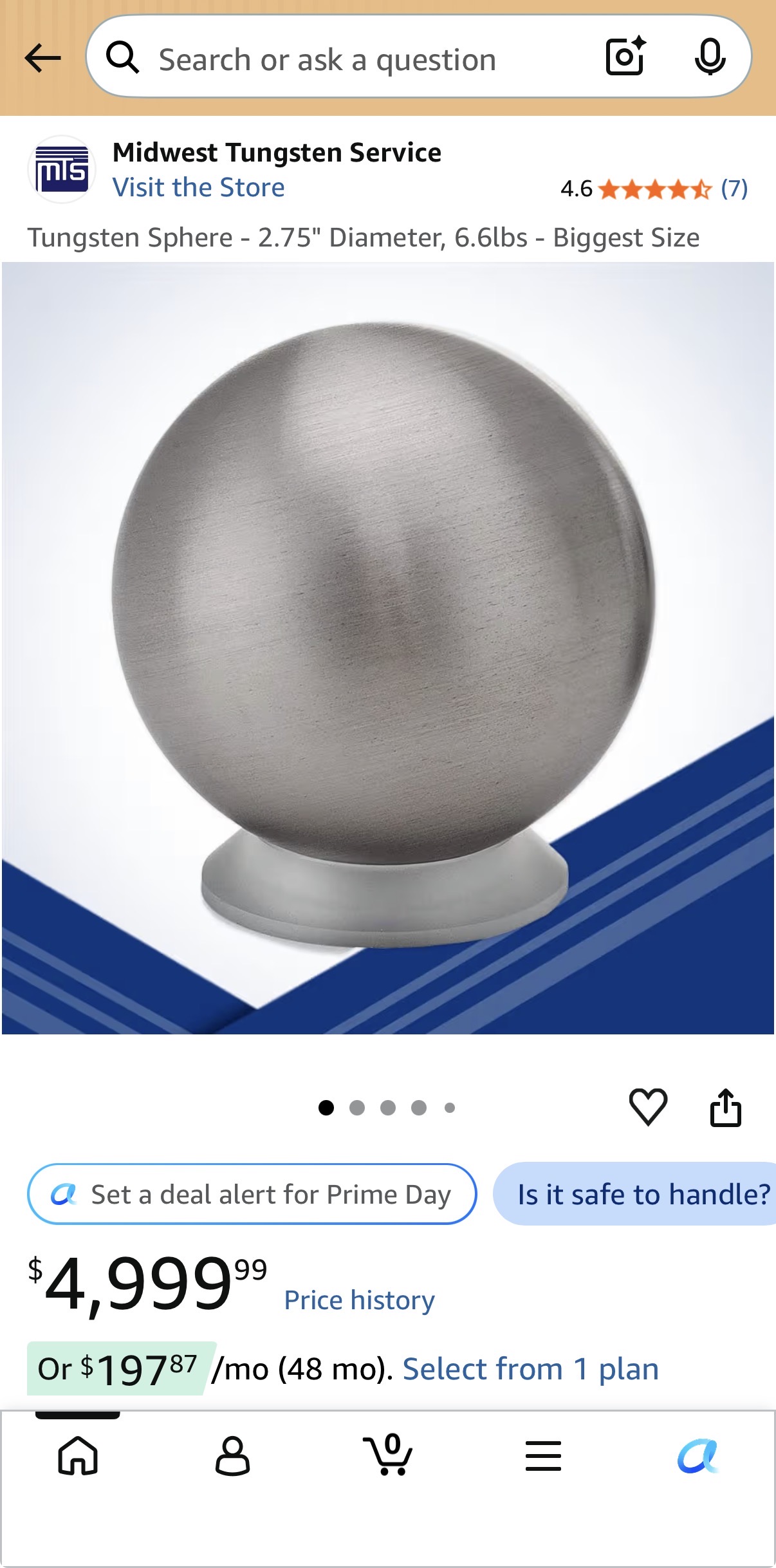

Oh I suppose we can check the listing for a similar ball:
Yep, checks out at ~2.75”
Aaaaand wait. What. This thing is a liability just to have in my house. All the more reason to get it out of here…and charge that friend for the commission. Jesus.
