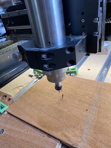

I ran a project yesterday with my new spindle. There was no problems. It was all the carving same RPM I believe there was like three tool paths.
Today I tried to run my A slightly more complex set of tool path really just more of them and on the second tool path the spindle just never turned on also it’s shut off and told me to change the RPMs, which I felt was something I should not be seeing. This is my second time attempting to use the spindle so I’m not sure what to expect . Any advice is welcome thank you very much.
Here is a picture

OK, so now I have downloaded the newest versions of both Carbide Create and Carbide motion but the same problem is happening. It turns on the first tool path then shut itself off and then it starts continuing trying to cut without turning back on at this point. I’m at a complete loss what to do.
Can you try running the machine setup wizard again just to make sure the machine and software has the right settings for a VFD spindle?
Also, if you have a gcode or C2D file, could you share that?
I’ve only had the spindle not turn on once when I was expecting it to. and it was because in carbide I told that toolpath to spin at 1800rpm instead of 18000rpm (typo)
You should probably upload your C2D file so we can check that out too.

You’ve got the RPM at 2000, which is too low to trigger a VFD spindle to come on.

Ok I’ll try this ! Do you have a setting suggestion?
I’d try 20,000 to start.
