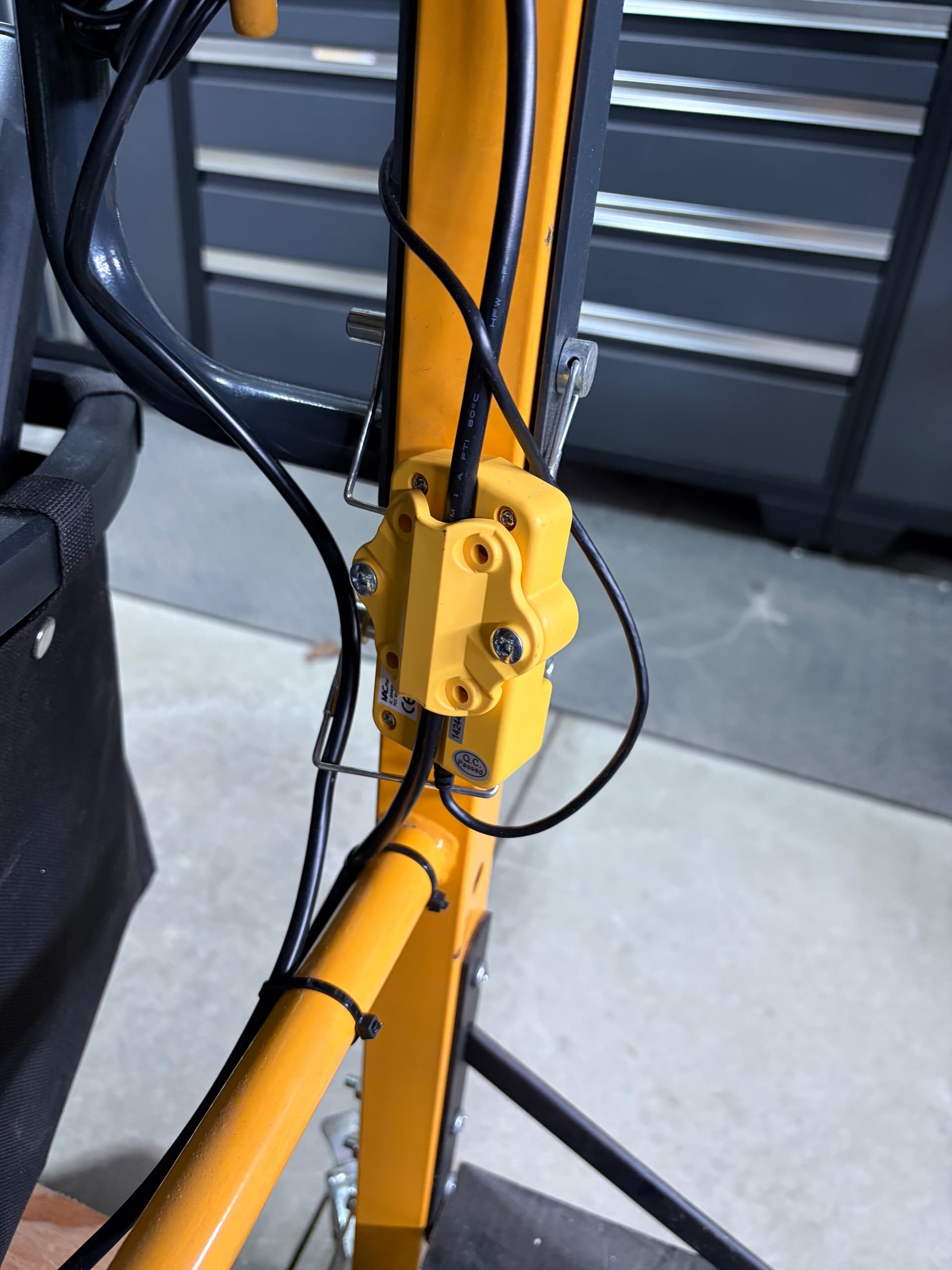

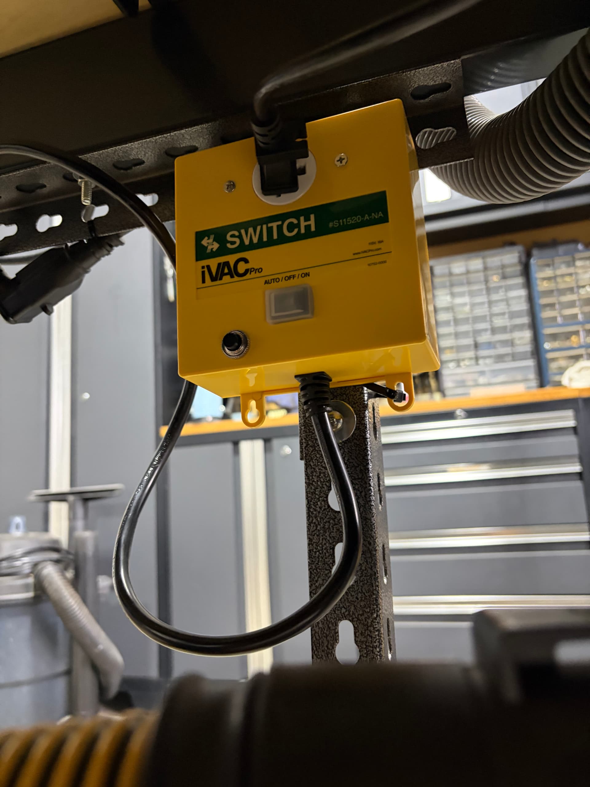

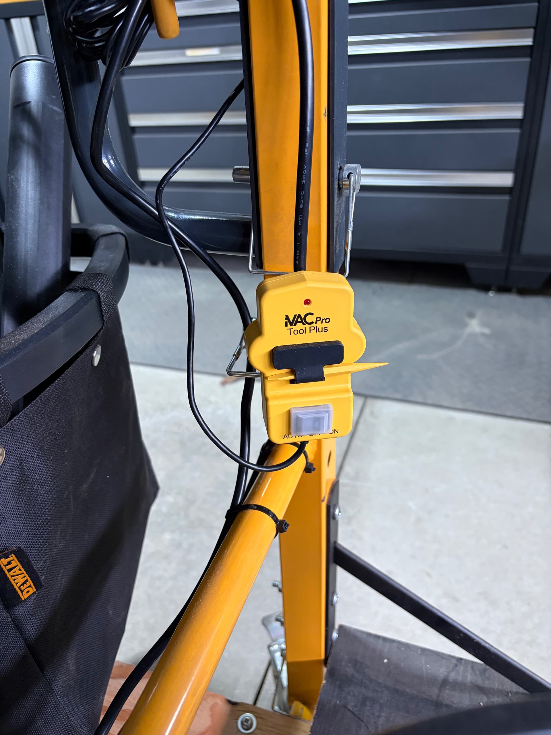

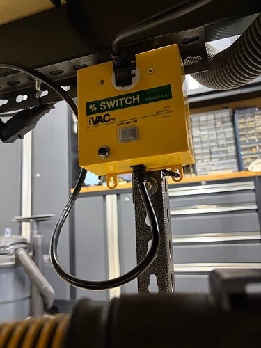

Here is the setup I have:
The shopvac plugs into the iVac Pro Switch and it plugs into 110v power. The iVac Pro Tool is installed on the cable going from the VFD to the Spindle. It also plugs into 110v
When the VFD sends power to the spindle the Pro Tool senses the current and sends a radio signal to the Pro Switch which turns on the shopvac. When the VFD turns off the spindle the Pro Tool senses no current and sends a signal to the Pro Switch turning off the shopvac.
I found in my setup that if I secure the Pro Tool with a tie wrap to the steel leg of my workbench the shopvac will turn on but not turn off so I just left it on the spindle cable without securing it and it works fine.
